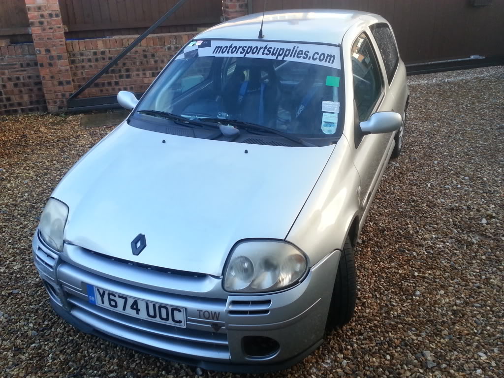

that silver ph1 looks alright tbh, much done to it?
Id just use that one for track days lol, still got the ugly ass turbo thing?
Cheers that's the plan to be honest. . Other than cage, buckets, harnesses, gaz golds and pagid brakes its standard... Not sure what ugly ass turbo you mean ;) That's not going anywhere!
I like the Ph1 looks better than I expected for some reason. Better exhaust needed though ;)

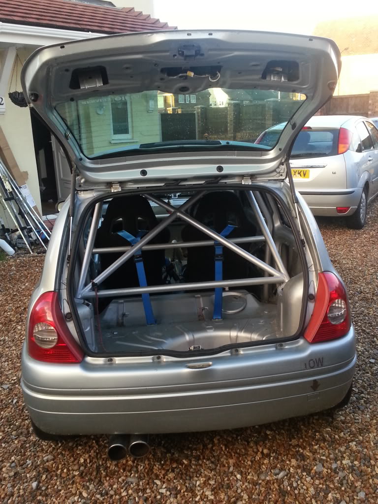

really need to change those harnesses and get some proper 4/5/6 point bar mounted harnesses instead of those 3 pointers going over the bar like that.
never been a fan of poorly mounted harnesses and I still see it so often

I was thinking that but going over the bar changes the angle?

4point fitted properly to that harness bar would be the perfect angle.
The 3 points shouldn't be fitted then 'pulled' over the bar as they are not designed for that.
Also the rear mounting point should be fitted centrally to the seat they are going to not offset like they are, as in the event of a big crash they are not pulling centrally and can cause a twist.So many people just cheat by screwing them into existing mounting holes rather than fitting new ones.
