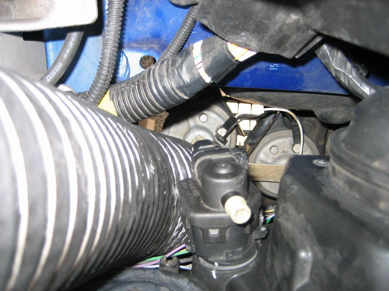

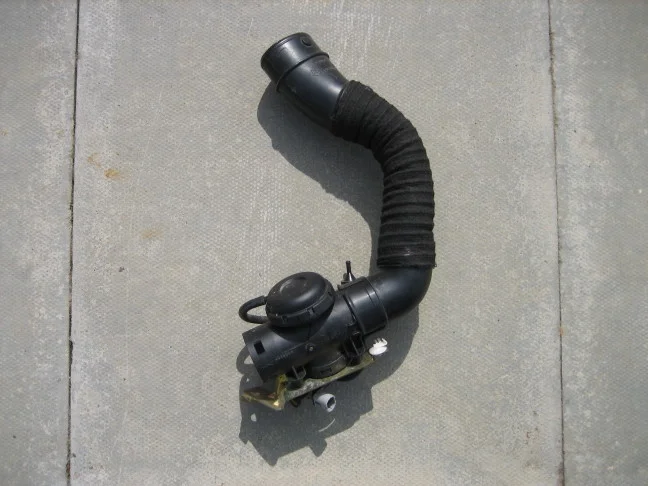

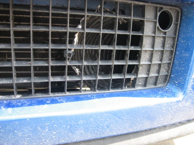

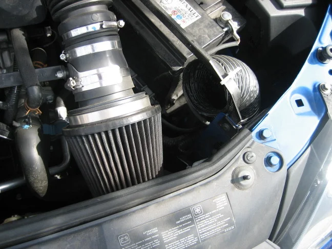

Hi guys, decided the other week to remove the acoustic valve as I wanted more air flow onto my open (heat soaked) K&N 57i. I recently ordered some air tubing from ven air (thanks andy905)
I did a quick experiment after with a hair dryer to see how much air was getting there and I must say I was pleasantly suprised. :D Car feels slighty better in the low down pull in second gear around 2000rpm, :evil: where it previously suffered heat soak. It still egts very hot under there, but Im sure it has improved. MAy look at heat shielding next!

was thinking about putting the end piece in the grill, but spraying it black. Does the standard CAF pipe fit from the grill up to the viper? Im sure mine looks too small and wont reach.
standard viper caf doesn't reach.

The kick is still there, so I can only assume that this acoustice valve is for road regulations, and the IIRC the first 172 never had this vavle. By removing it I was able to fit the big 85mm tubing rather than the skinny 58mm standard stuff. Also think car sounds slighty louder!:evil:

Not as loud with standard air box, plus with the removal of the acoustic valve it has meant more air gets to the filter sooner, rather than standard where the valve opens up fully after higher revs are reached via a vacuum :cool:

Nick Hill told me it's to do with emissions and noise mainly...

I suspected this was all it was for. Think how many people get de-cats, they aren't worried about emissions!! :dead:

What size ducting have you used iam going to use 70mm willl that fit in my 182
I went for the 85mm mate. Get as large as you can. Speak to andy905 on here for some £19.00 delivered. The 85mm JUST fits behind the headlamp ballast on Full fat 182's, and the 1metre length is just long enough. :)
