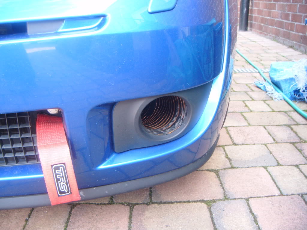

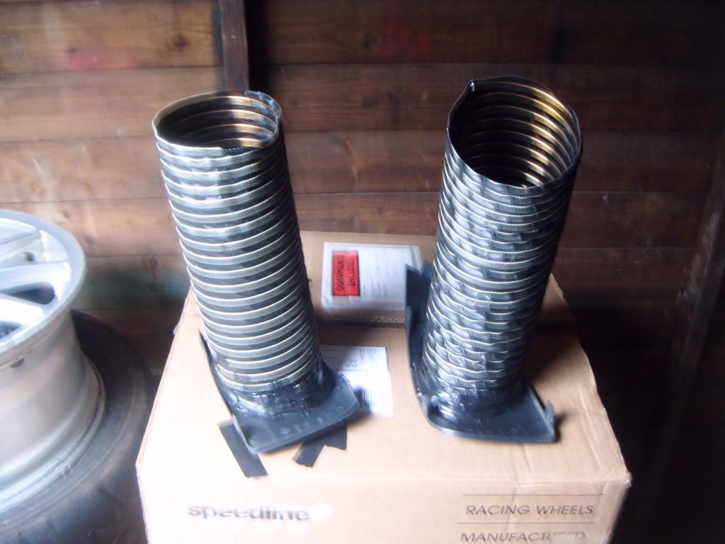

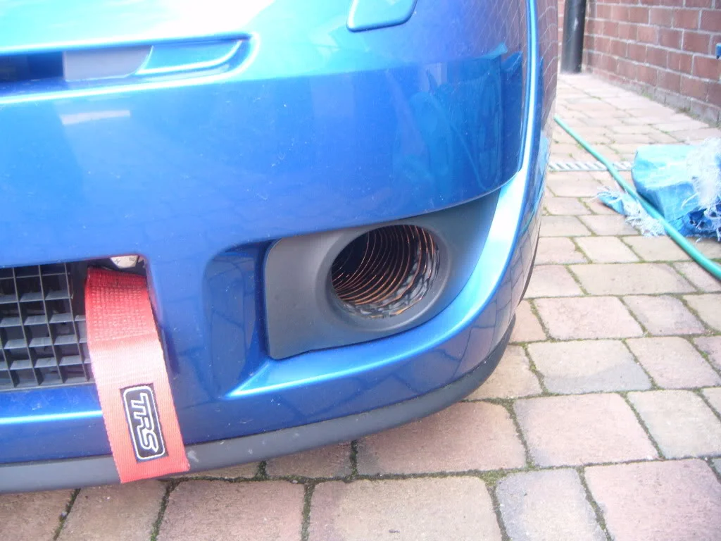

Just use the old fog light surround and use ducting that roughly fits the opening and seal it with adhesive sealant. Thats what I did for my brake ducts.
right, so i just measured the gap at the back of the fog surround is 79mm which the duct pipe will have to fit through, so im thinking I get a 76mm trumpet with 76mm tubing and then I try and bond it on with something.. sound good?
or i can get an 80mm trumpet and try and sand 1mm off the surround so itll fit snug and wont require as much bonding, just a bit of glue..
Also how much duct tubing would I need to get from the fog light hole and the air filter, because I was thinking about getting this stuff, but they only do it in 1m a peice, I dont think that would be lond enough, especially from the driver side one as it has to go further to reach the right side of the engine bay.. hmm
