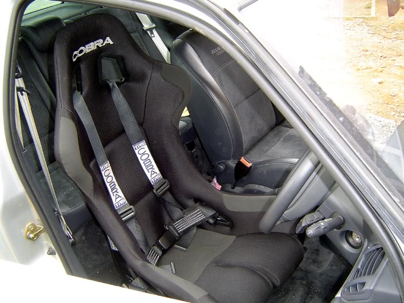

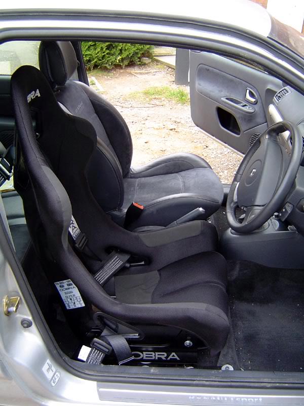

new bucket seat and afr meter pics
Makes a really big difference must be sitting 3inch lower in the car pretty much on the floor. Once you do the harness up you really cant move at all which took a bit of getting used to but it is surprisingly comfortable.

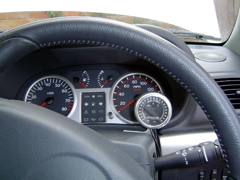

afr meter

How you getting on with it now its all in properly Mark?
Its hard work getting in and out and doing the harness up. It is a vast improvement over the standard seat though once you are strapped in.
It is as low as it can go which is very low and where it should be IMO. The car feels slower now because you are so solidly locked in. You can fly round a corner or stand on the brakes and you dont slide or move around at all which reduces the sensation of speed.
Very nice quality seat aswell.
Overall the struggle with the harness is more then made up for by the driving experience.
As you no doubt know yourself it is a very good modification.

Mark, car is looking very sweet, love the seat. Whats the use of the afr for? :eek:

AFR meter displays the air fuel ratio in the exhaust fumes. The meter is attached to a wideband lambda probe in the exhaust. It is used to map the car. You increase or decrease the fuel to achieve a 12.9 (I think, lol) reading when out of closed loop. Because I have an OMEX I can adjust this on my laptop.

Airbags in a car protect your head from hitting the steering wheel or a post/side of the car or any solid item in the event of a crash. Whilst strapped into a harness and cocooned in the seat you dont move full stop. If car manufacturers could incude this as a safety measure I am sure they would. But the general public do not want to squeeze into a bucket seat and then strap themselves tightly down with a harness. You can not even reach the stereo or close the door when you are in.
The seat itself is also FIA approved and a one piece design that is built up around your legs and sides of your body. In the picure of your friends crash where the seat is creased that is because it is a metal frame with foam inserts, in other words offering you no protection in the sort of accident shown in the pics.

good one mate - but your afr meter is blocking your speedo - what happends if youre doing over 120??? lol

Which seat is it? Monaco. Looks well smart, gettin me a couple soon and some other goodies hopefully.
