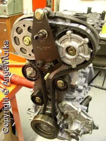

which pulleys should I be looking at? don't suppose you have an image?

Here is a quick picture i found and up loaded while in the shiter ;)
It still has the timing tool attached but you will get the idea
cheers mate, so i'm looking at the 3 smaller black tensioners?

So you removed the covers to see this belt ???
If you just looked in the engine bay without taking anything off with tools, you would have seen the aux belt and not the timing belt !!!
I haven't removed any covers yet, not with the car unfortunately. Correct me if i'm wrong then, but I thought I can see the cambelt as it goes over the large top/right pulley (in your pic) from just looking town into the engine bay?
Thats not the Aux belt is it?
You CANNOT see the cambelt without removing covers.
You are looking at the Aux belt.
OK fair enough, thanks for that. I guess that's why its looking a little older then.
