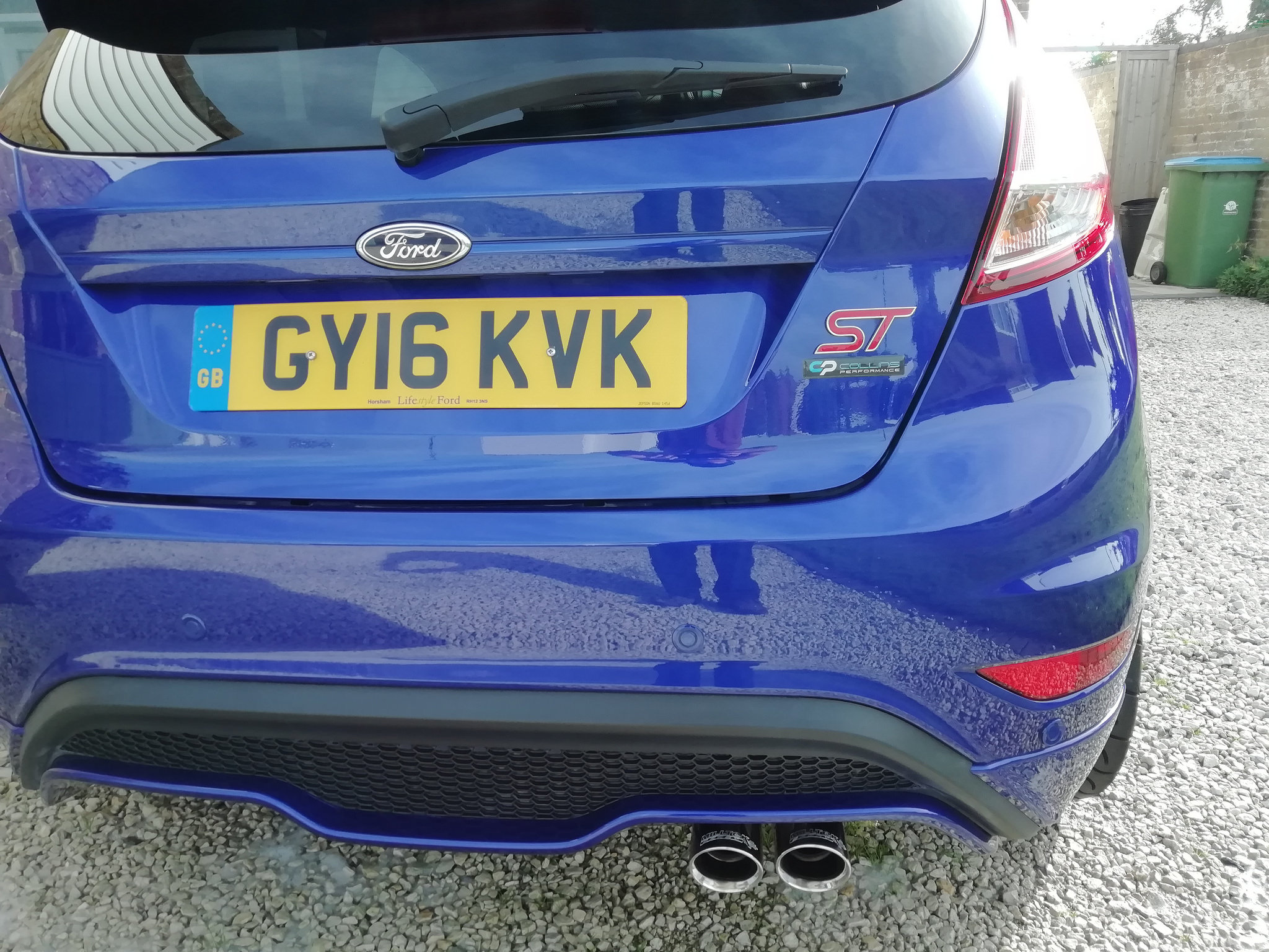

It looks and sounds just like OEM so wings or loud exhaust so a bit of a mild sleeper as I have still got the Mountune MP-215 badge on the back :)

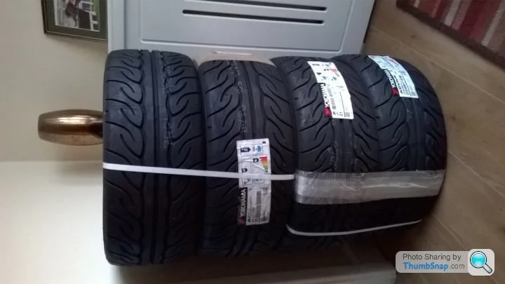

The only one thing that has been causing some issues has been the tyres .
I change the tyres to continental sport contact 5 units after the car went stage 2 and they were great in all conditions but after the last map and the diff fitted they are really struggling to put the power down in second gear as they would with 320 LB/FT at 3000K rpm .
Third gear onwards they cope well but even then are on the limits of what they can do .

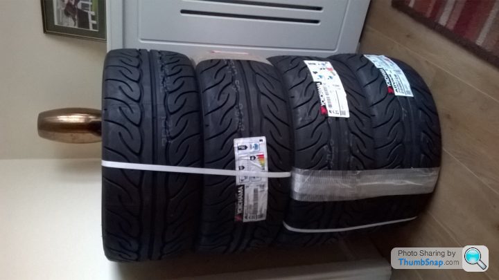

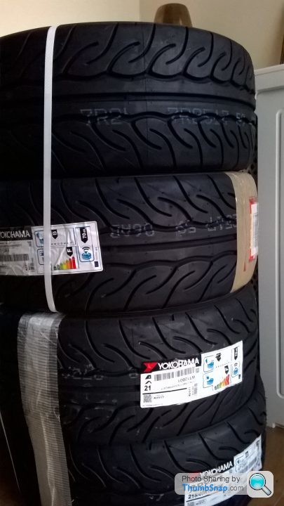

With this in mind and reading a few things I have got some wider and gripper Yokohama ADO8R tyres in 215/40/17 ( the stock size is 205/40/17 )
It will be good to see how they get on with the extra power and torque and the extra grip the diff offers .

Just an update on the tyres they do rub ever so on full lock so I have cut out a bit of the arch liner to fix this .

What is road noise like? Thinking of putting them on my MX-5, I probably shouldn't worry as its just a weekend toy but I don't particularly want overly loud tyres.
I'm going to facing similar issues though, going from 160bhp to 250bhp and already grip is not enough when driven properly.
A lot of people are going 215 vs 205 stock but I don't think I can chance it with spacers due to Wilwoods and the car being low.

Road noise is fine and I cant tell much difference to the Continental that they have replaced .
Its not so much the power as the torque that is the tricky bit in putting the power down ( my Fiesta is putting down 320 LB/FT at 3000 RPM ) as this comes in one big lump and then still has 300 LB/FT at 5000 RPM but with my set up of a Quaife ATB diff and Mountune suspension and the wider track spec tyres the car does put the power down well in all the gears bar second as this still will brake traction if you just mash the throttle so you need to have some throttle control in second but that's about it .

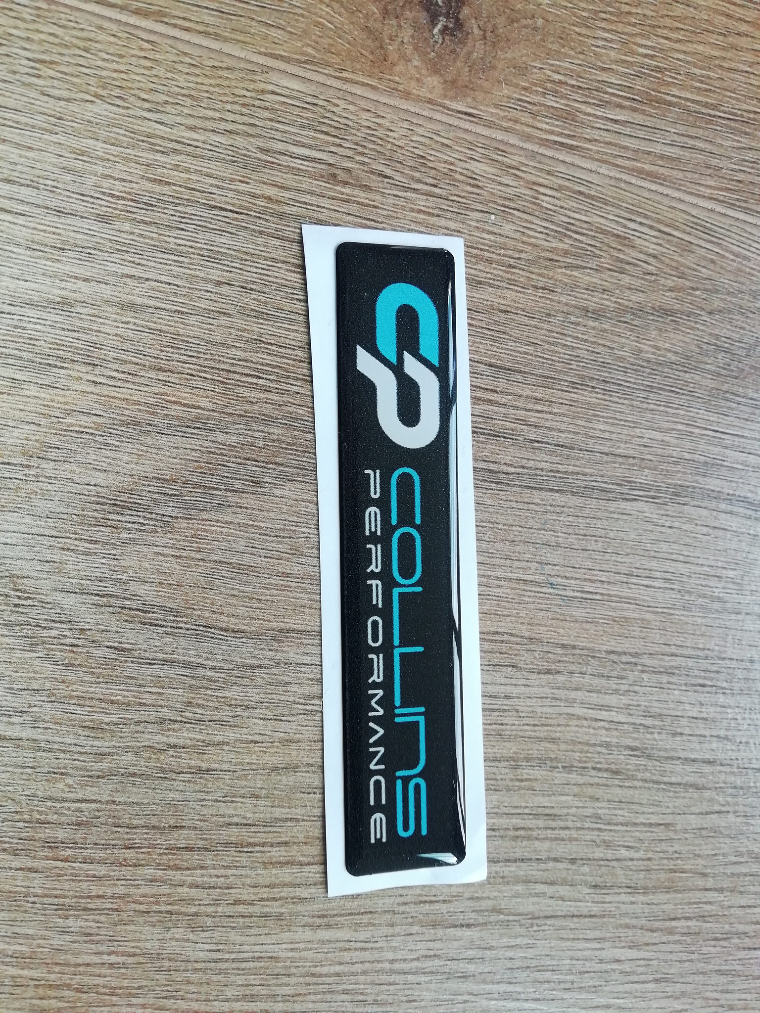

The Mountune rear badge was looking a little faded so I thought I would replace this with an new Collins one .
IMG_20181013_143527 by Alan Kaveney, on Flickr
IMG_20181013_145209 by Alan Kaveney, on Flickr
Apart from that the car is running great and is such fun to drive every day .

I have half a mind to take the badge off and keep it stock looking as this could be more fun as the exhaust and car is on the same noise level so does not look or sound like it is anything other than stock :)

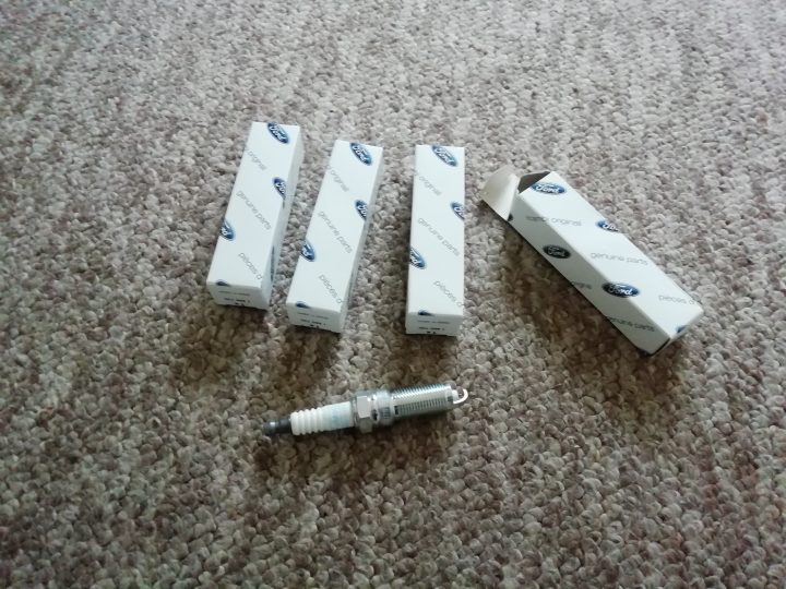

Over the Christmas holidays I got round to doing a few service jobs on the car .

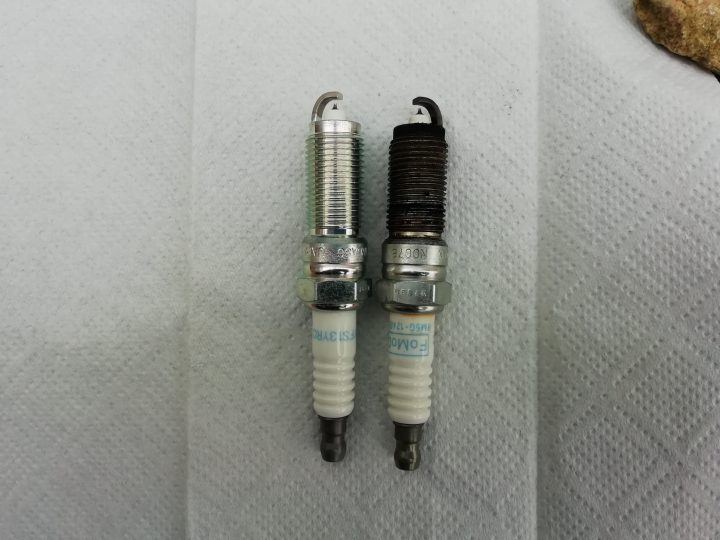

Firs up was some new spark plugs .
Not really needed as they were only changed last year but for £ 29.00 its worth doing .
New and old

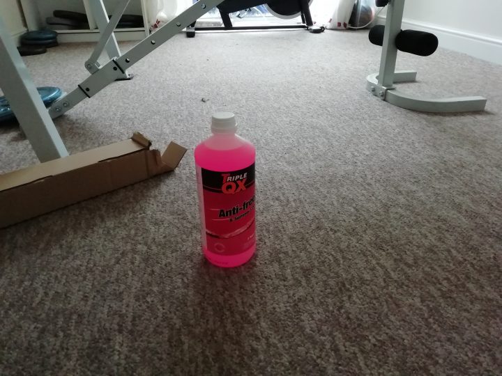

Then it was on to top up the coolant but this was only about a shot glass needed to have this back on the max mark .
