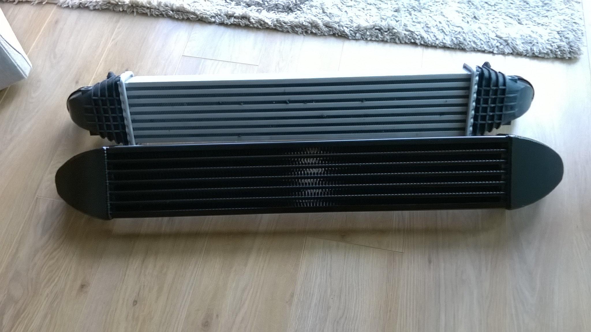

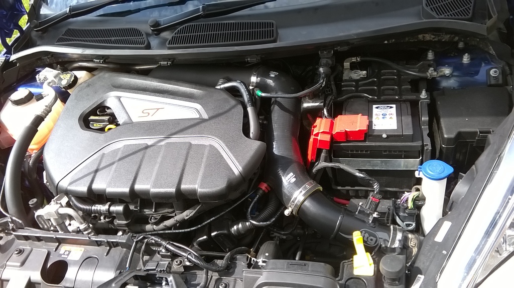

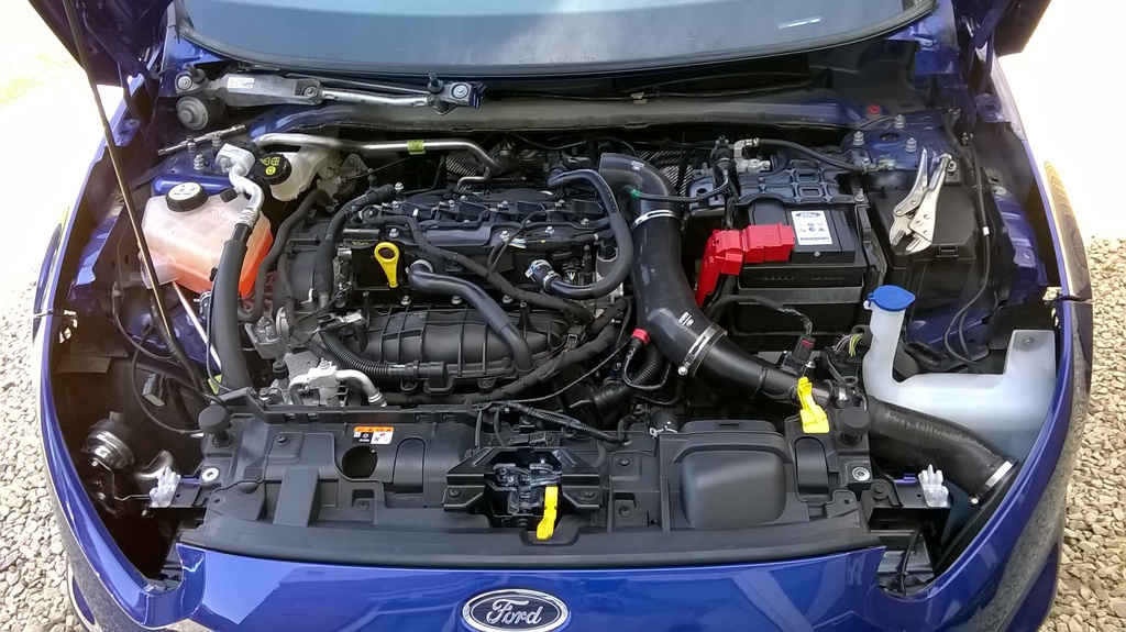

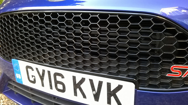

The Airtec intercooler in black hides so well with the stock front end that you cant really see it unless you look hard .

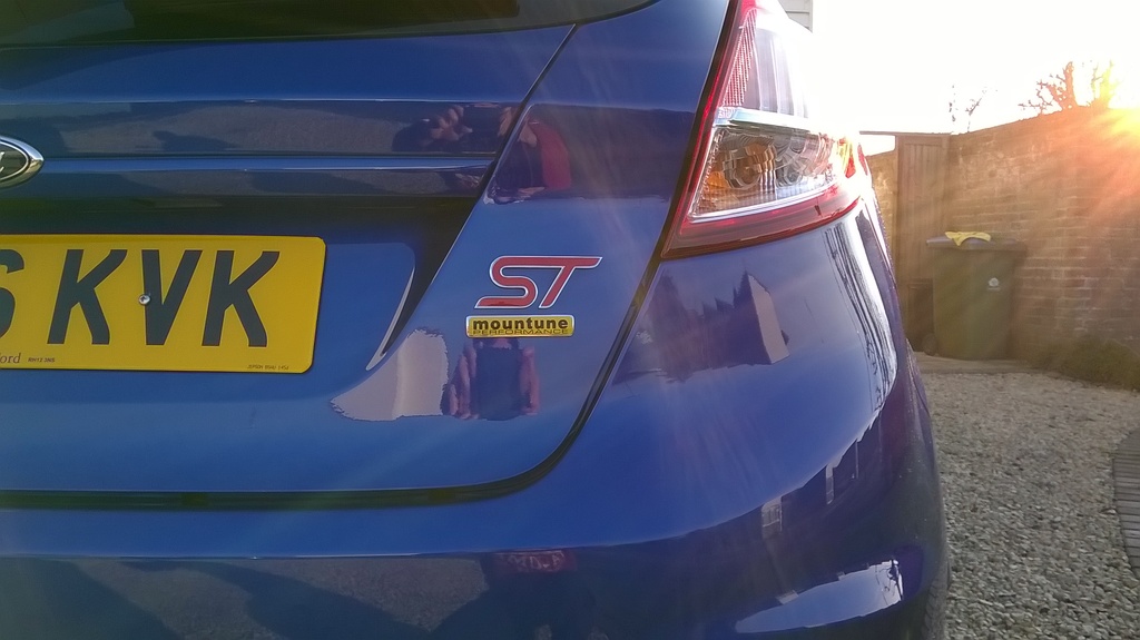

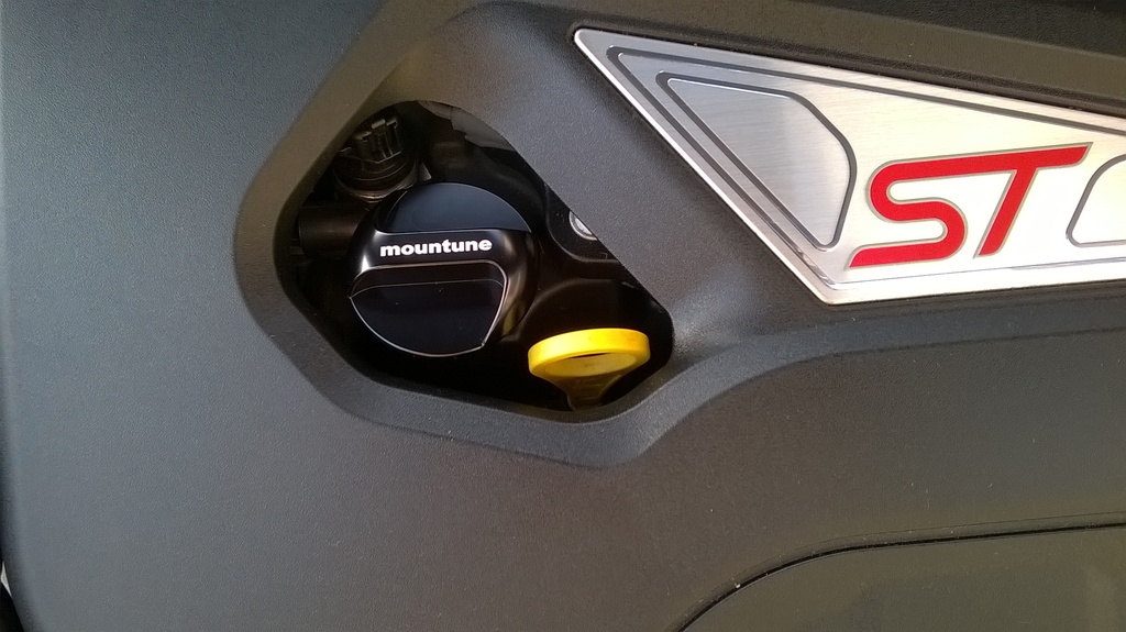

The best thing for me is that it looks totally stock bar the Mountune MP-215 badge on the back and the Airtec intercooler at the front that you cant really see so it looks just like a little Fiesta but at the same time a little sleeper with this set up .

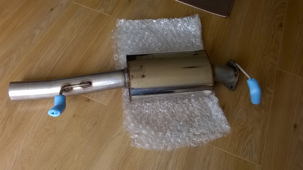

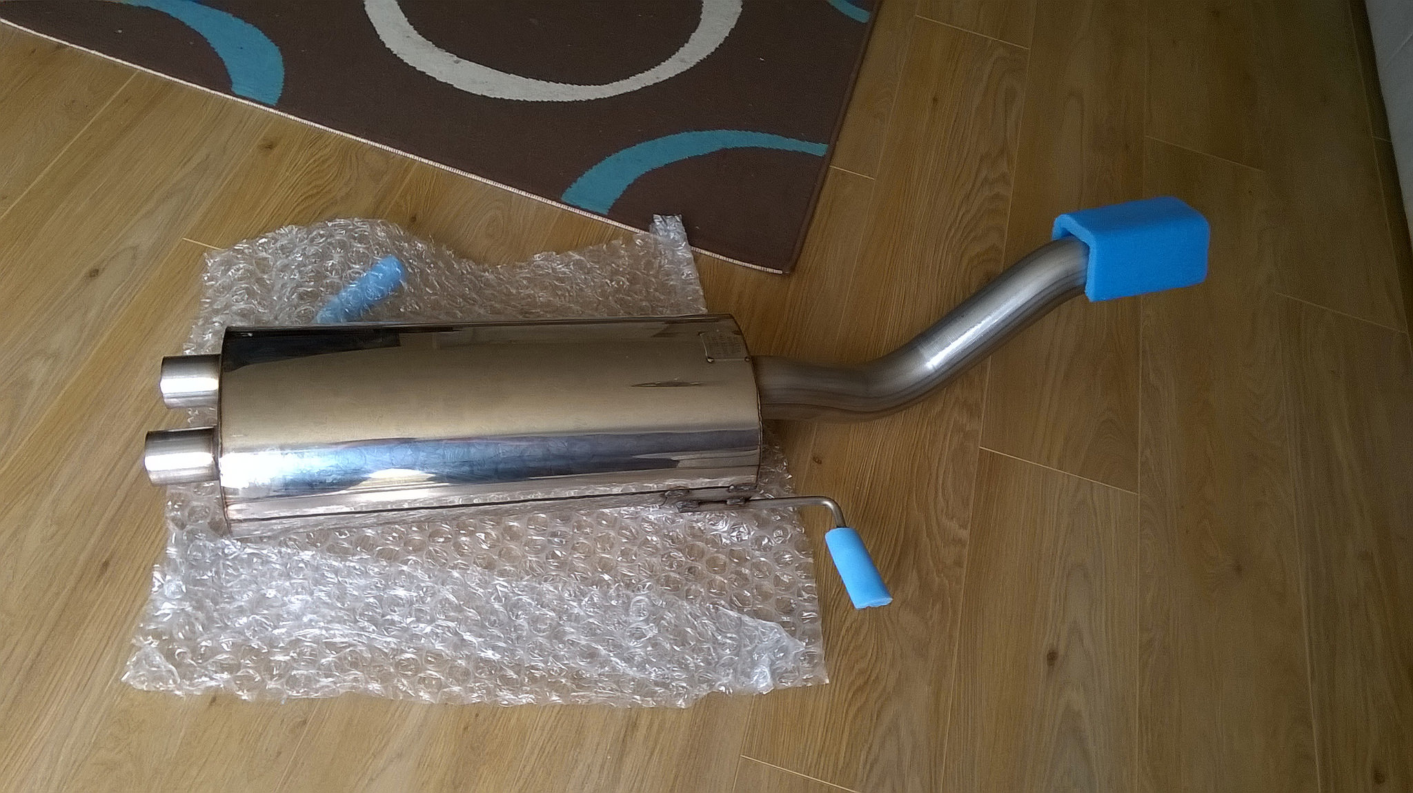

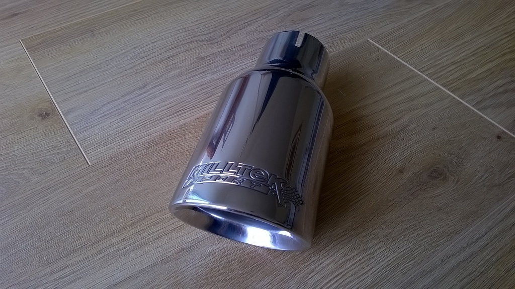

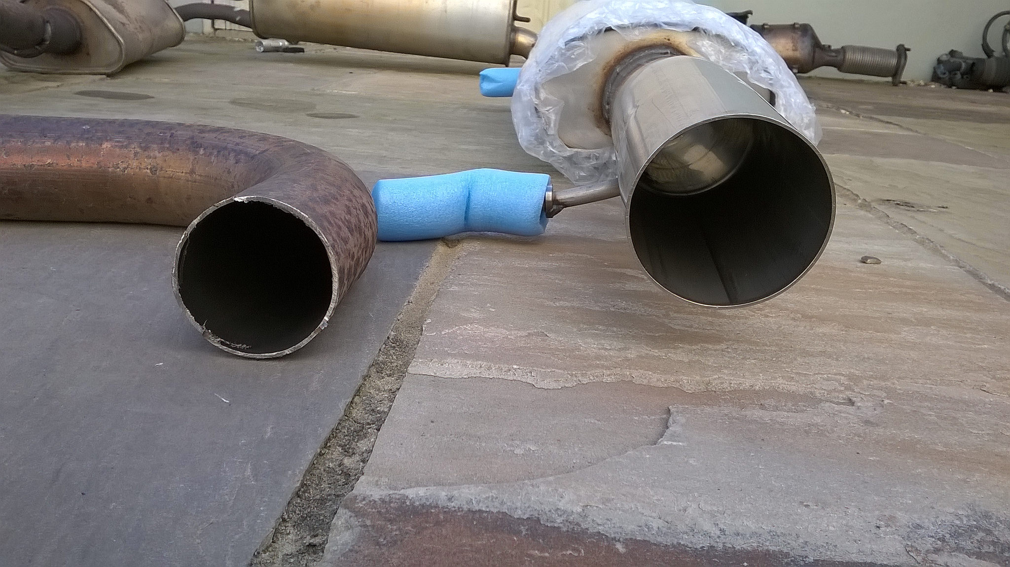

My Milltek cat back exhaust and sports cat has arrived so all I need is some good weather to get it fitted .
The system is 2.75 bore from the stock 2.12 bore .
I have chosen the OEM noise level option that 99.9 % of people do not go for .
Yo can get four different types from the first the loud to the last OEM style noise
Non res race ( loud back box and no centre section )
Res race ( loud back box and centre section )
Non res ( normal back box and no centre section )
Non race res ( normal back box and centre section )

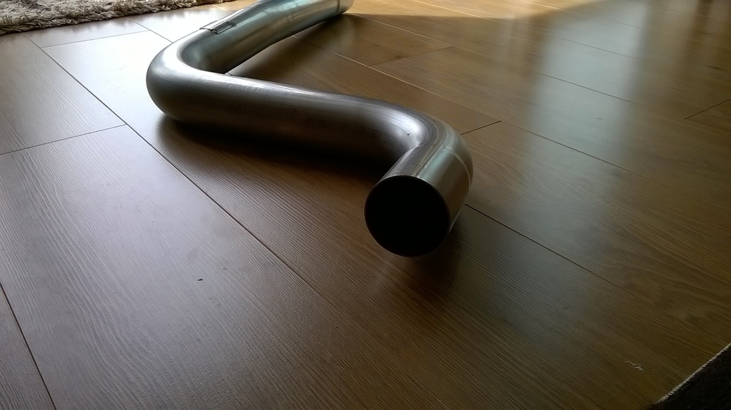

Centre section

Cross over link pipe
[URL=http://s50.photobucket.com/user/alankaveney/media/WP_20170528_10_08_57_Pro1_zpsx5owxkvf.jpg.html]WP_20170528_10_08_57_Pro1_zpsx5owxkvf.jpg[/URL
[URL=http://s50.photobucket.com/user/alankaveney/media/WP_20170528_10_08_43_Pro1_zpsfi4vgrfa.jpg.html]WP_20170528_10_08_43_Pro1_zpsfi4vgrfa.jpg[/URL
Rear box
[URL=http://s50.photobucket.com/user/alankaveney/media/WP_20170528_10_19_15_Pro1_zpsm6xxqnaj.jpg.html]WP_20170528_10_19_15_Pro1_zpsm6xxqnaj.jpg[/URL

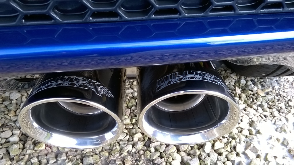

Tail pipe
[URL=http://s50.photobucket.com/user/alankaveney/media/WP_20170528_10_05_42_Pro1_zpsojghogt8.jpg.html]WP_20170528_10_05_42_Pro1_zpsojghogt8.jpg[/URL

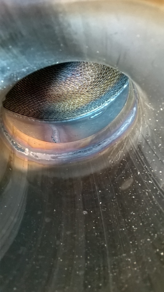

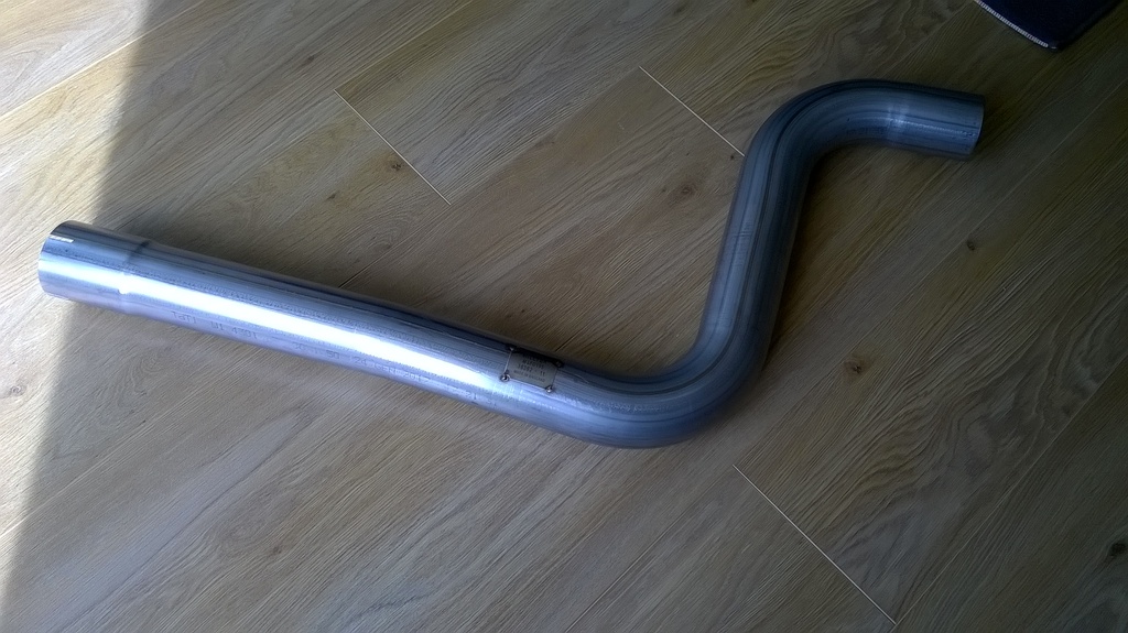

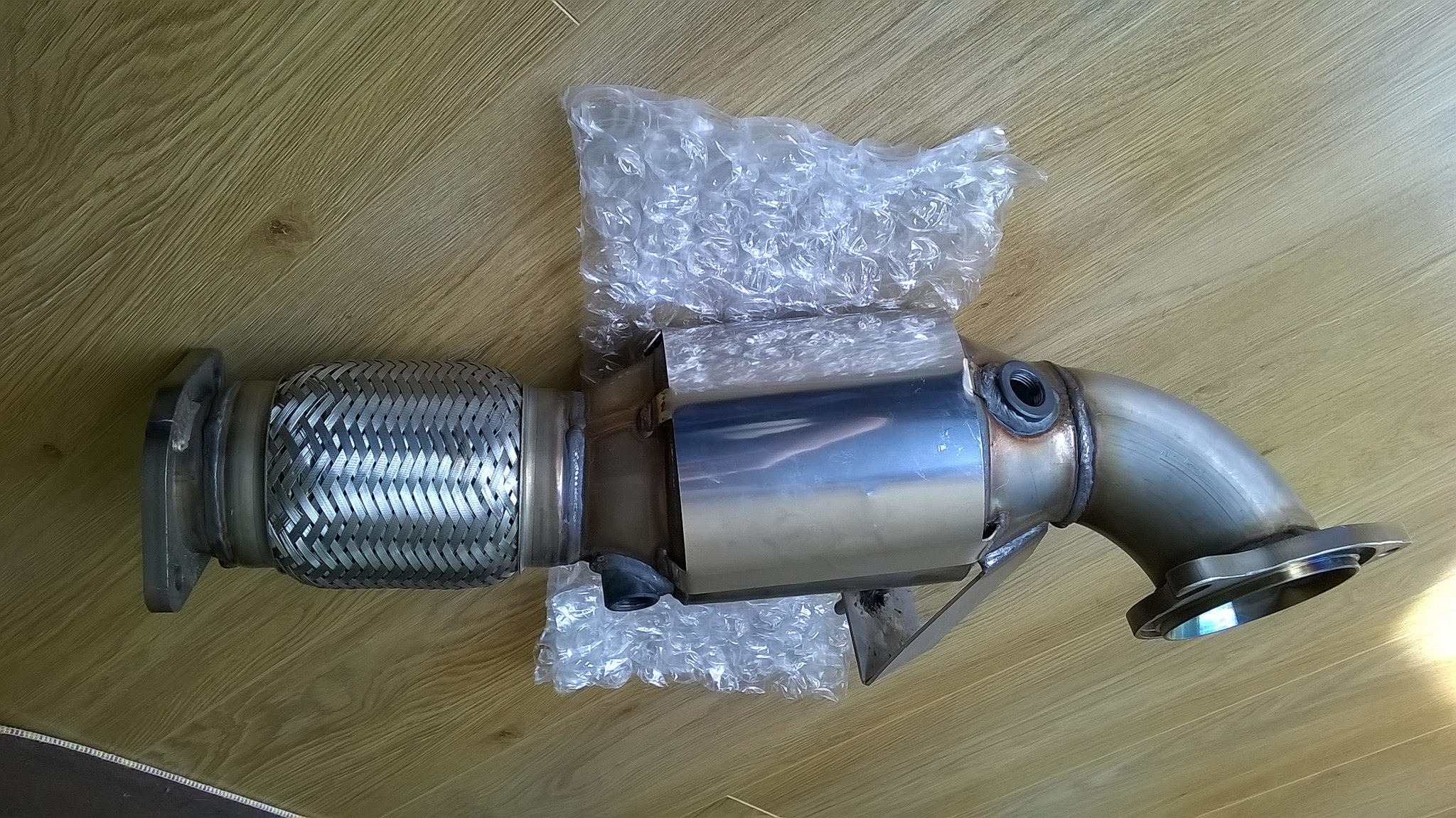

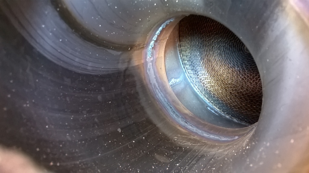

200 cell sport cat with 2.75 inch down pipe .
[URL=http://s50.photobucket.com/user/alankaveney/media/WP_20170528_10_15_03_Pro1_zpsg3ccmjow.jpg.html]WP_20170528_10_15_03_Pro1_zpsg3ccmjow.jpg[/URL

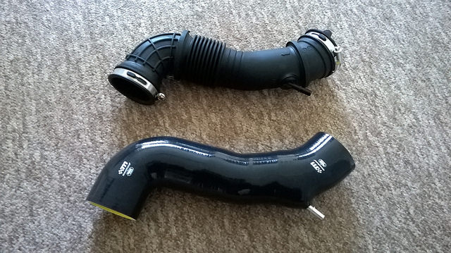

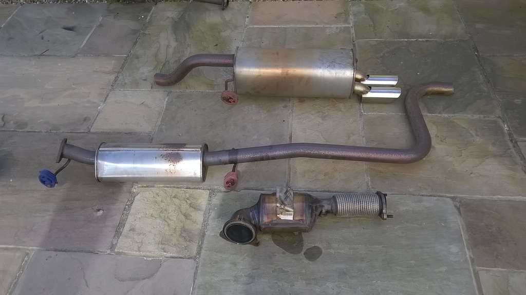

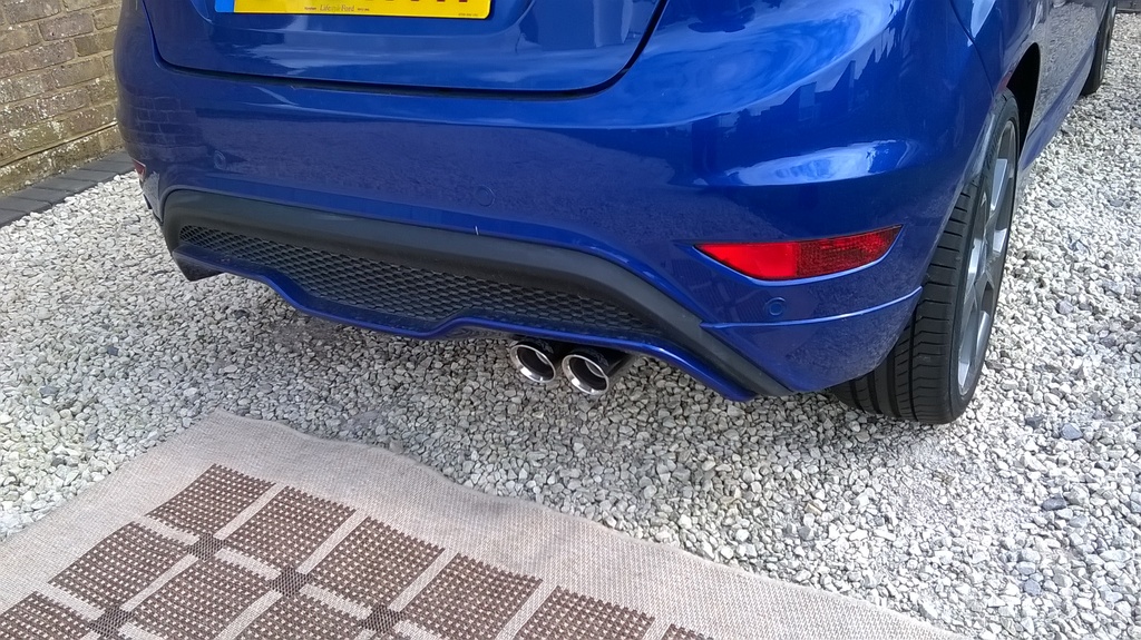

At the weekend I set about changing the exhaust system , cat and diverter valve .
First up I will say this was not an easy job made so much harder when doing this on a stone drive was with only jacks and axle stands .

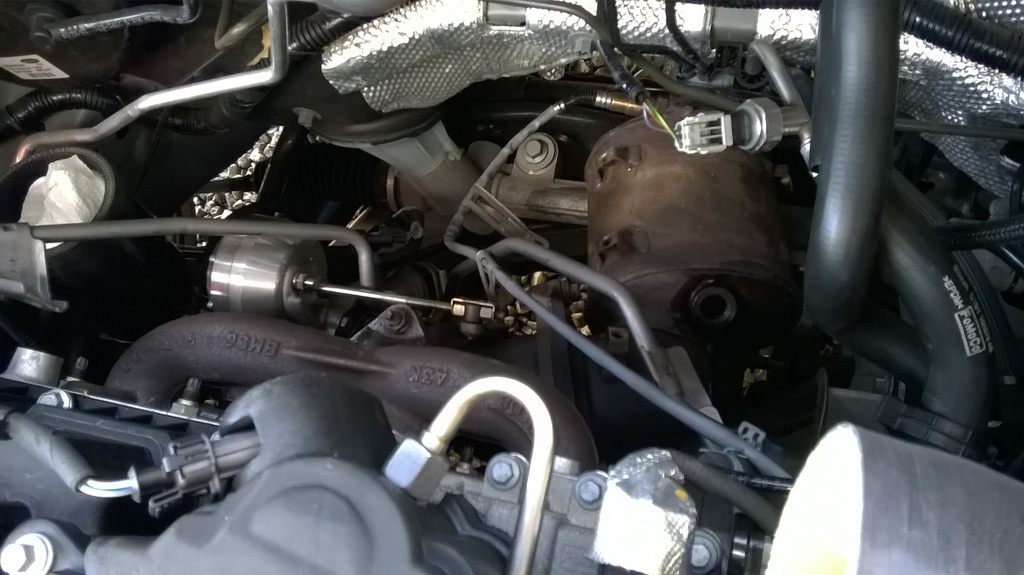

First up was to remove the engine cover , wiper blades , plastic cover , clips , turbo pipe , cross over pipe , headlights and induction system .
WP_20170603_12_54_00_Pro1_zpsnyca86uv.jpg[/URL
With this lot removed this gave access to the exhaust manifold and cat heat shield and after some wrestling they came out giving access to the cat .
[URL=http://s50.photobucket.com/user/alankaveney/media/WP_20170603_12_54_08_Pro1_zpslhrcxtvf.jpg.html]WP_20170603_12_54_08_Pro1_zpslhrcxtvf.jpg[/URL

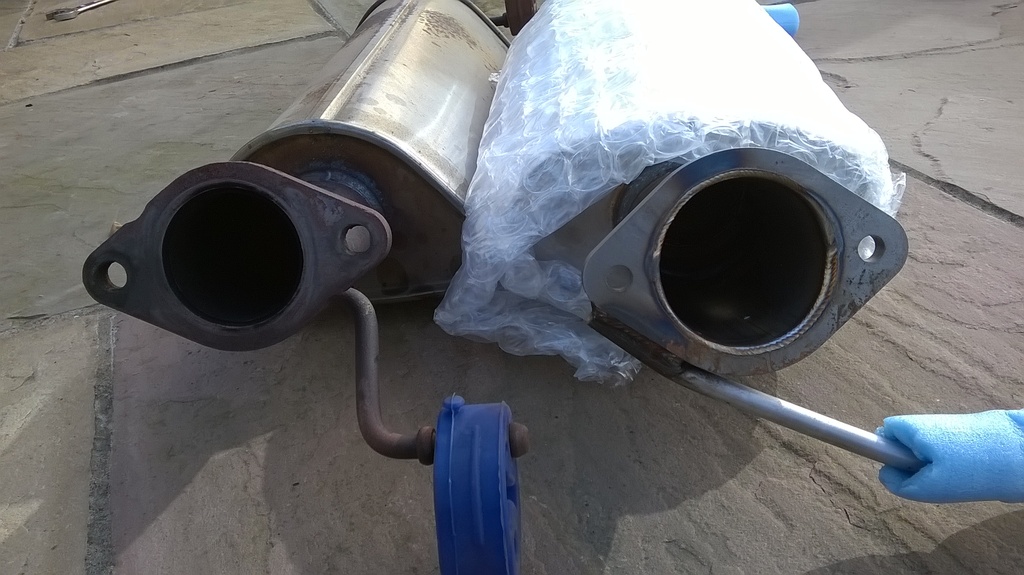

After unbolting the O2 sensors downpipe bolts and all exhaust bolts the complete OEM system was off the car
[URL=http://s50.photobucket.com/user/alankaveney/media/WP_20170603_16_13_22_Pro1_zpsre0pobni.jpg.html]WP_20170603_16_13_22_Pro1_zpsre0pobni.jpg[/URL

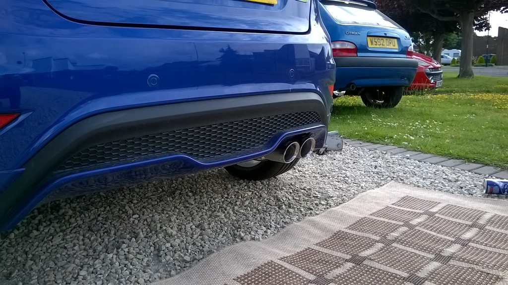

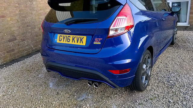

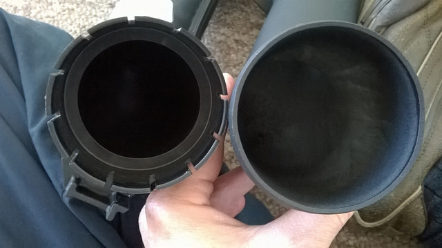

I went for the Milltek non race res system the quietest aftermarket system you can get for the Fiesta ST

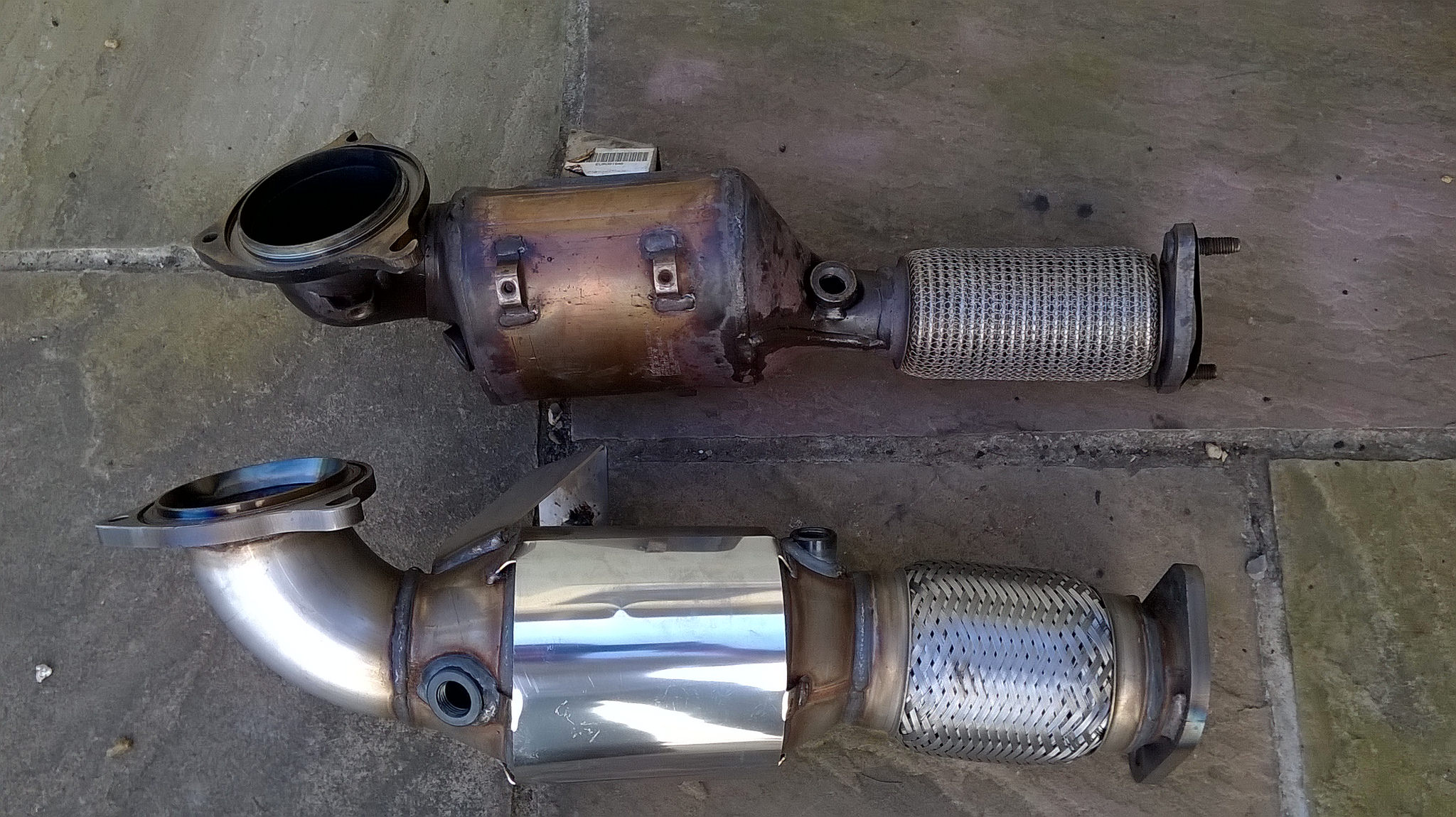

Old stock 2.15 inch vs new Milltek 2.75 inch pipe work
[URL=http://s50.photobucket.com/user/alankaveney/media/WP_20170603_17_23_28_Pro1_zps0zh0v4ic.jpg.html]WP_20170603_17_23_28_Pro1_zps0zh0v4ic.jpg[/URL
[URL=http://s50.photobucket.com/user/alankaveney/media/WP_20170603_17_23_55_Pro1_zpshwe6wnuz.jpg.html]WP_20170603_17_23_55_Pro1_zpshwe6wnuz.jpg[/URL

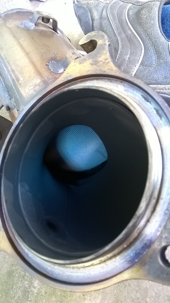

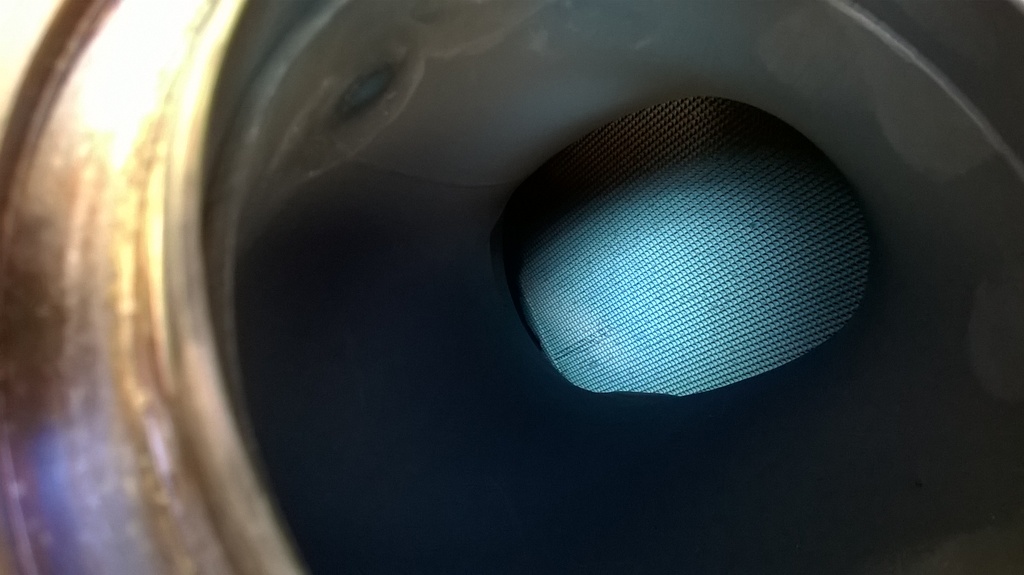

Old stock cat
[URL=http://s50.photobucket.com/user/alankaveney/media/WP_20170603_16_18_03_Pro1_zpsigbkscrg.jpg.html]WP_20170603_16_18_03_Pro1_zpsigbkscrg.jpg[/URL
[URL=http://s50.photobucket.com/user/alankaveney/media/WP_20170603_16_17_22_Pro1_zps1ab91lww.jpg.html]WP_20170603_16_17_22_Pro1_zps1ab91lww.jpg[/URL
[URL=http://s50.photobucket.com/user/alankaveney/media/WP_20170603_16_17_45_Pro1_zpsez1emzma.jpg.html]WP_20170603_16_17_45_Pro1_zpsez1emzma.jpg[/URL
New Milltek 200 cell sports cat
[URL=http://s50.photobucket.com/user/alankaveney/media/WP_20170603_16_19_06_Pro1_zpsb4nbamzm.jpg.html]WP_20170603_16_19_06_Pro1_zpsb4nbamzm.jpg[/URL
[URL=http://s50.photobucket.com/user/alankaveney/media/WP_20170603_16_19_18_Pro1_zpsvzm86wws.jpg.html]WP_20170603_16_19_18_Pro1_zpsvzm86wws.jpg[/URL
After some more wrestling and fiddling and checking and adjusting the system to stop any knocking or banning of the much bigger system and attaching Mountune stiffer exhaust hangers the new Milltek sports cat and system were installed and the end pipes bolted on
[URL=http://s50.photobucket.com/user/alankaveney/media/WP_20170604_15_46_59_Pro1_zpsqolmovui.jpg.html]WP_20170604_15_46_59_Pro1_zpsqolmovui.jpg[/URL
[URL=http://s50.photobucket.com/user/alankaveney/media/WP_20170604_15_46_50_Pro1_zpscv6w9zdn.jpg.html]WP_20170604_15_46_50_Pro1_zpscv6w9zdn.jpg[/URL
[URL=http://s50.photobucket.com/user/alankaveney/media/WP_20170604_17_18_49_Pro1_zpskkhg5wle.jpg.html]WP_20170604_17_18_49_Pro1_zpskkhg5wle.jpg[/URL

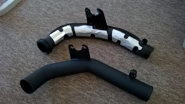

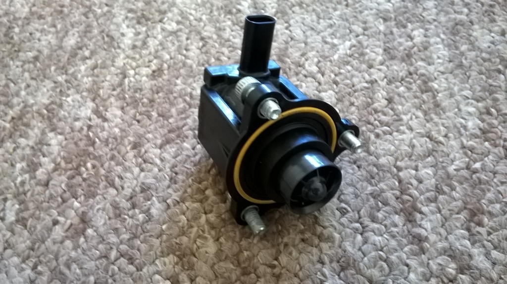

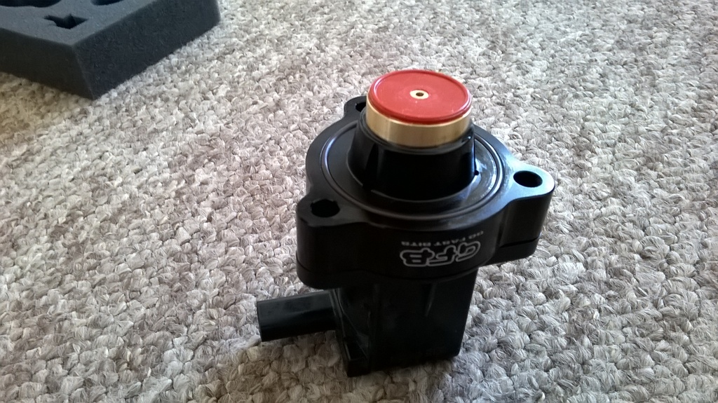

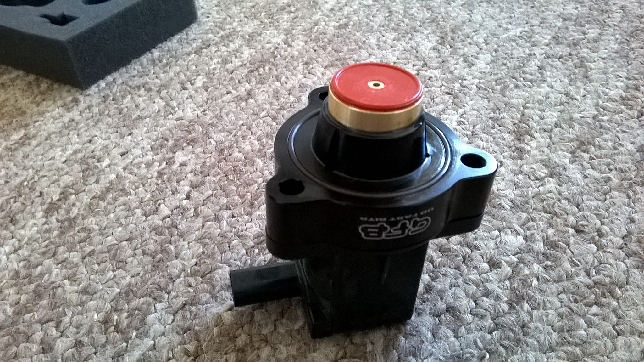

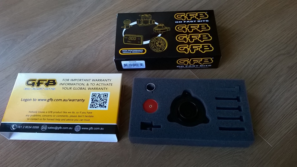

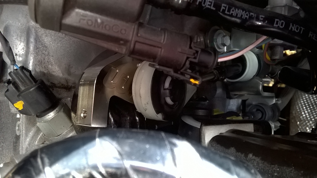

Last up was to remove the stock diverter valve and replace with the GFD upgraded unit
Old
[URL=http://s50.photobucket.com/user/alankaveney/media/WP_20170603_13_32_26_Pro1_zpsu1rf8kll.jpg.html]WP_20170603_13_32_26_Pro1_zpsu1rf8kll.jpg[/URL
New
[URL=http://s50.photobucket.com/user/alankaveney/media/WP_20170603_14_00_26_Pro1_zpsmvkgx3wr.jpg.html]WP_20170603_14_00_26_Pro1_zpsmvkgx3wr.jpg[/URL
Then put all of the pipes and covers back on and job done

On the test driver the throttle response is much better and the turbo spools up much quicker and the air brake woosh noise is now gone at low revs when coming off the throttle .
The car feels noticeable quicker now and revs quicker and just pulls harder in each gear .

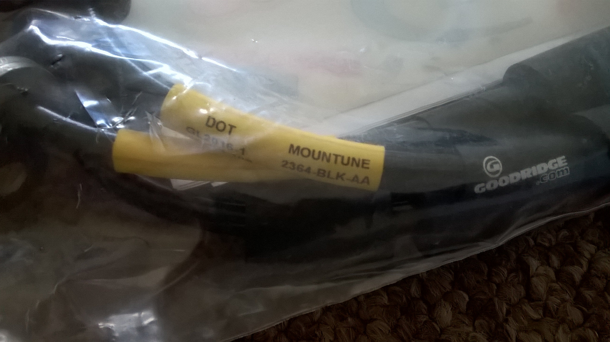

At the weekend I installed my Mountune braided brake line kit along with some other parts .

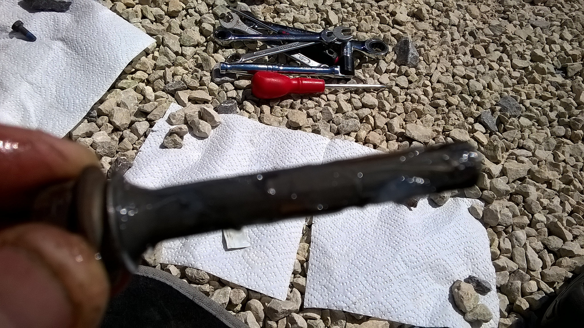

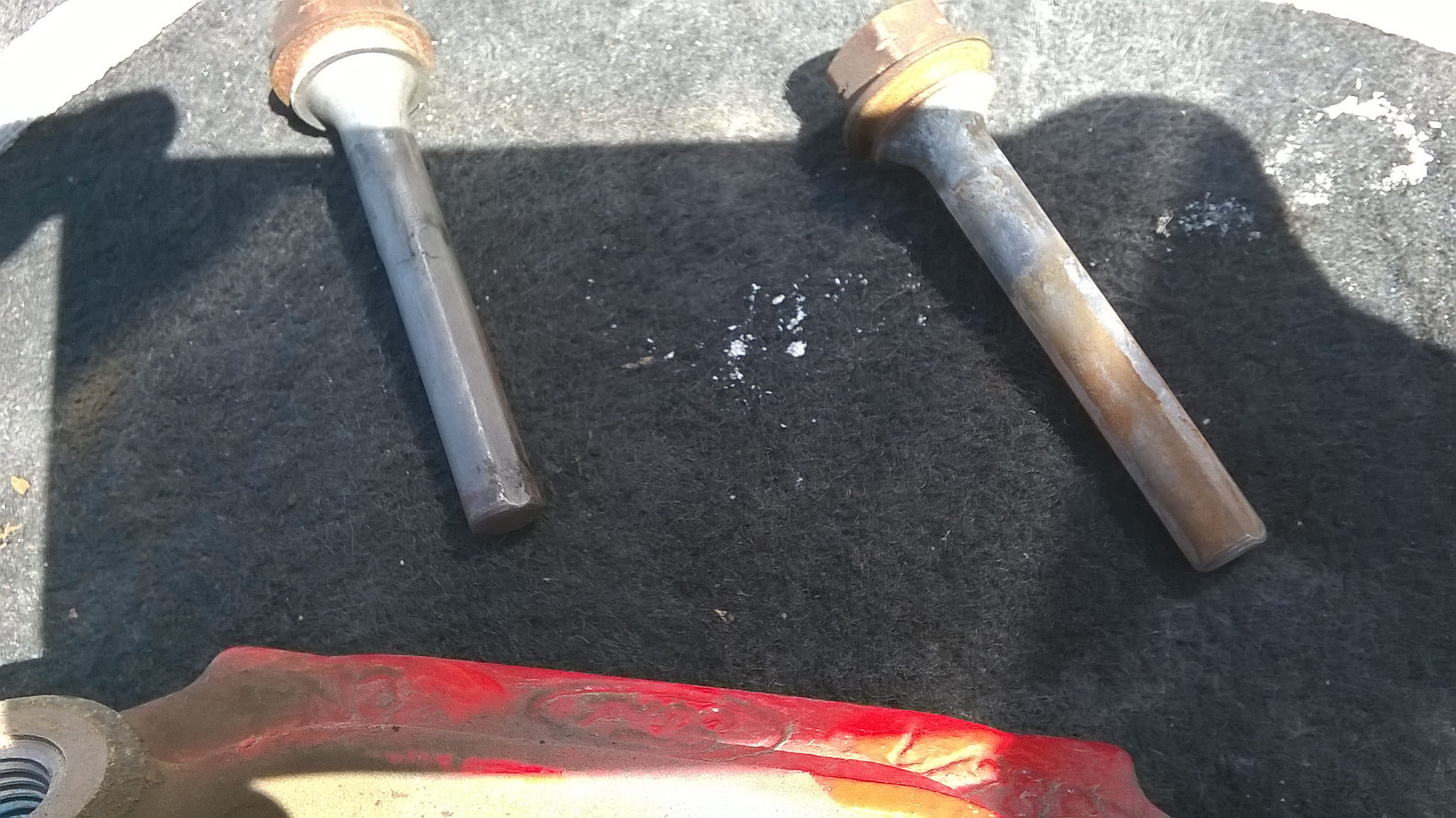

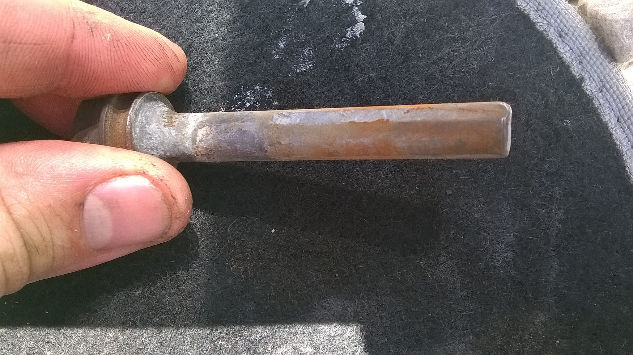

First up was to check the rear brake pin sliders as I have read that that they can cause uneven were on the rear discs if they are not moving correctly .
The NSR were ok but I re greased anyway but the OSR were dry as a bone and looks like they never had any grease in them from new as my car is only a year old .
https://www.flickr.com/photos/156687514@N04/shares/D403B3
https://www.flickr.com/photos/156687514@N04/shares/W487wZ
All re greased up and sliding well again
https://www.flickr.com/photos/156687514@N04/shares/H0Kkz2

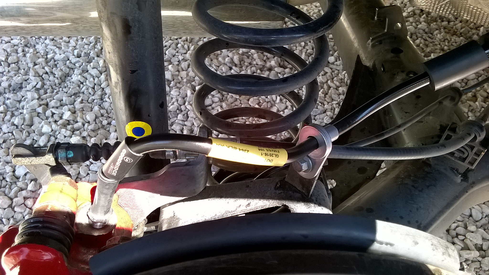

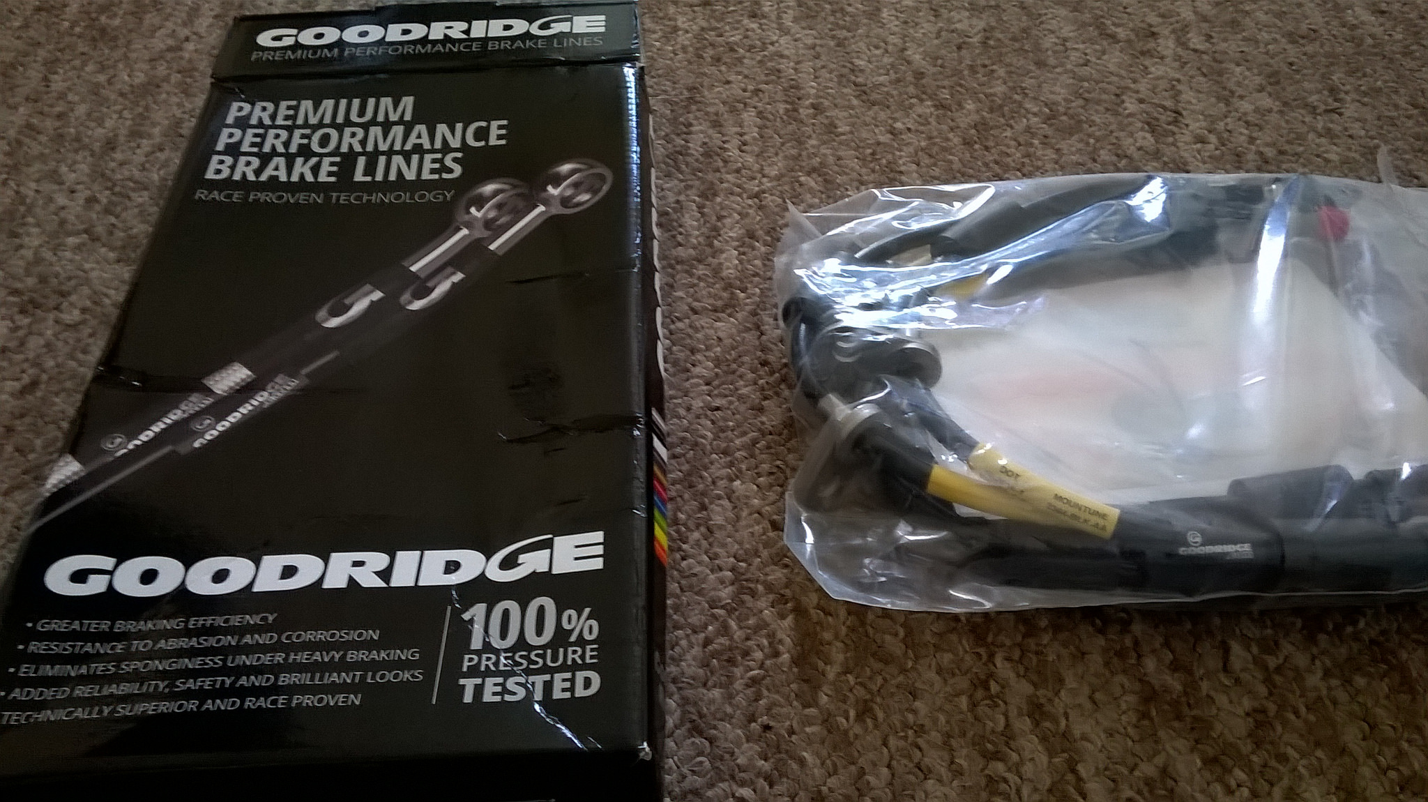

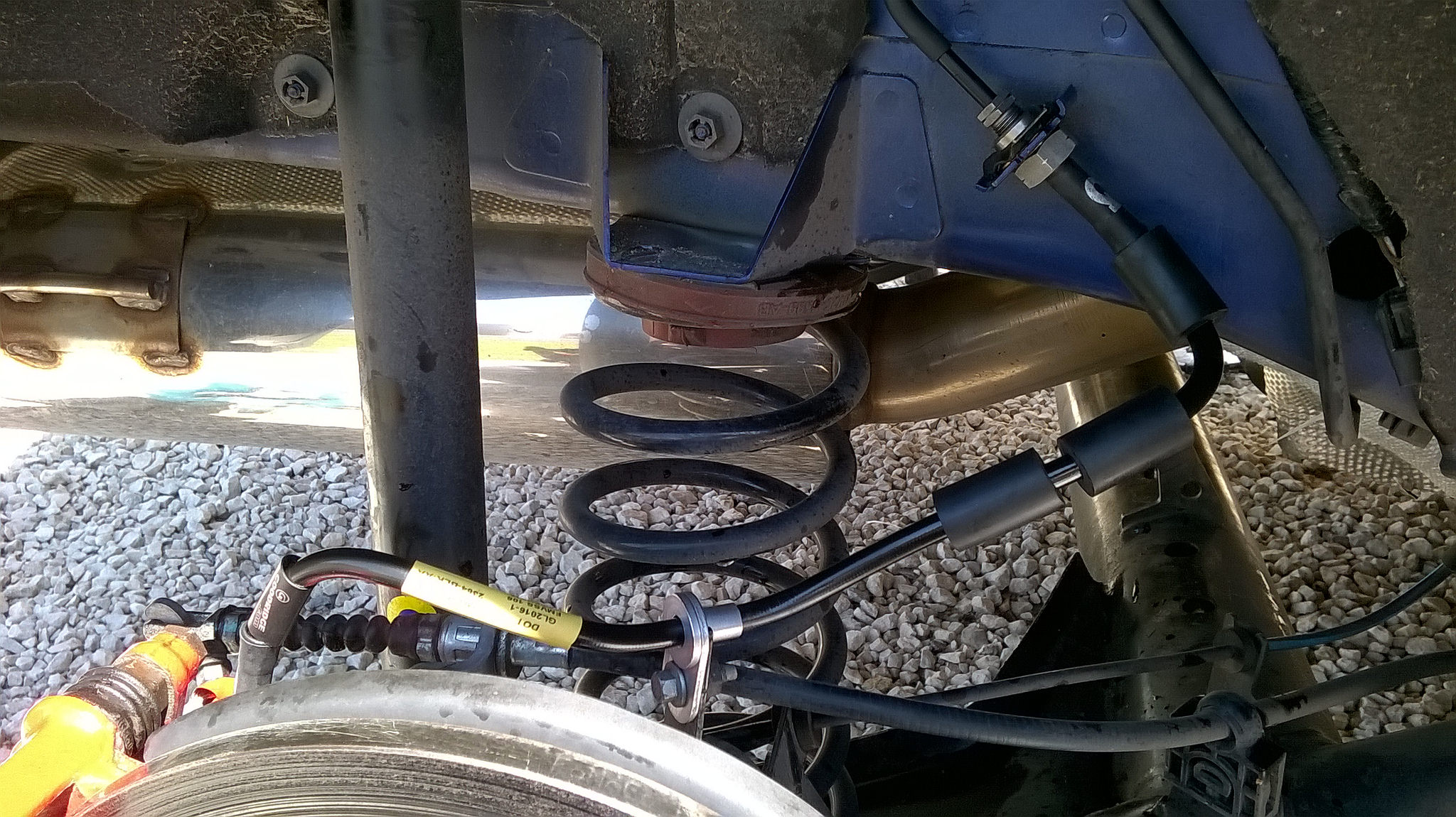

Then I installed the front and rear Mountune braided brake lines
https://www.flickr.com/photos/156687514@N04/shares/1F1012
https://www.flickr.com/photos/156687514@N04/shares/W1Q31C
https://www.flickr.com/photos/156687514@N04/shares/HuK94T
Then to finish off a flush of the brake fluid and change to Motul RBF 600 brake fluid
https://www.flickr.com/photos/156687514@N04/shares/8X31G6
WP_20170708_14_04_05_Pro[1] by Alan Kaveney, on Flickr
WP_20170708_14_03_57_Pro[1] by Alan Kaveney, on Flickr
WP_20170708_14_06_00_Pro[1] by Alan Kaveney, on Flickr
WP_20170708_12_52_14_Pro[1] by Alan Kaveney, on Flickr
WP_20170708_12_52_20_Pro[1] by Alan Kaveney, on Flickr
WP_20170708_14_35_39_Pro[1] by Alan Kaveney, on Flickr
WP_20170708_14_35_43_Pro[1] by Alan Kaveney, on Flickr

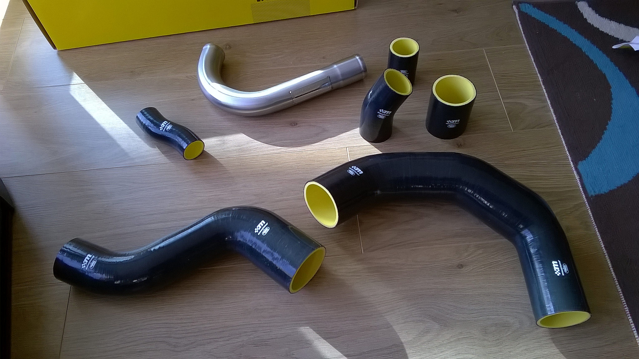

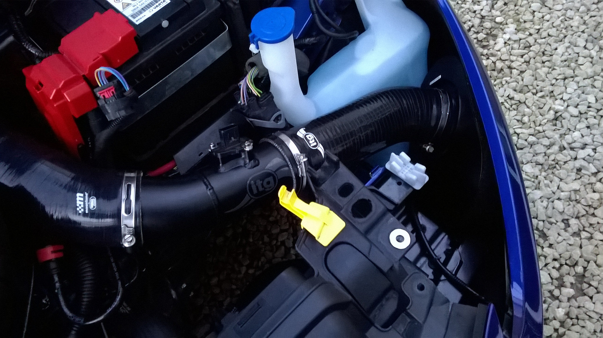

Then after another two months I installed the Mountune intercooler and charge pipes .
WP_20161022_14_35_40_Pro[1] by Alan Kaveney, on Flickr
WP_20161022_14_39_18_Pro[1] by Alan Kaveney, on Flickr

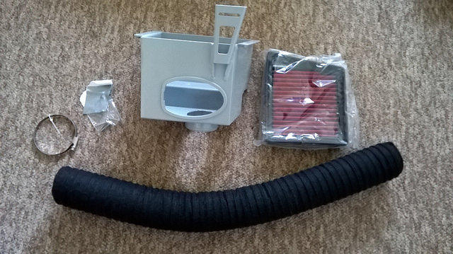

Then a Ram air cross over pipe
WP_20161204_10_22_41_Pro[1] by Alan Kaveney, on Flickr
WP_20161204_10_29_00_Pro[1] by Alan Kaveney, on Flickr

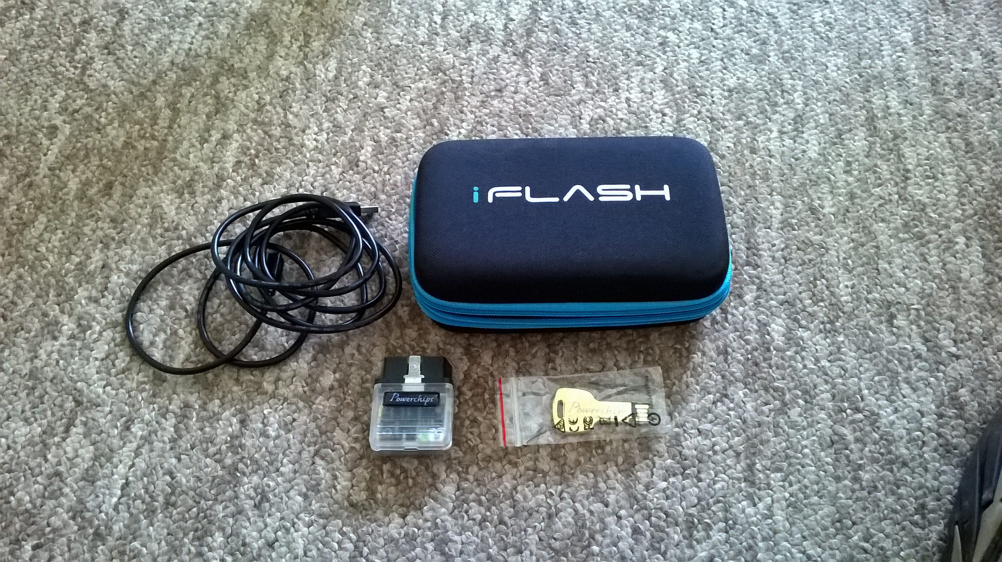

This was how it was until Christmas then I went for the Collins CP2 I flash remap and an ITG induction kit .
This took the car to 230 BHP and 250 LB/FT

Then in April this year I went up to Collins to have there CP4X pack fitted that was X-47 hybrid turbo , Airtec intercooler , CP4 remap .
Info below .
Featuring the awesome X-47 turbocharger, along with our own design uprated actuator, we have seen impressive results! Even during the early stages we have seen over 320bhp at a low 1.5bar.
We intend to run this turbo at a safe level, with all factory Ford safety measures intact, to maintain absolute drivability and reliability, with torque capped at 290lbft to maintain longevity of the transmission and to produce a very linear and smooth power delivery.
We believe this is a much better package all round compared to our previous CP4 package, as it is more drivable than the larger turbo we previously used .

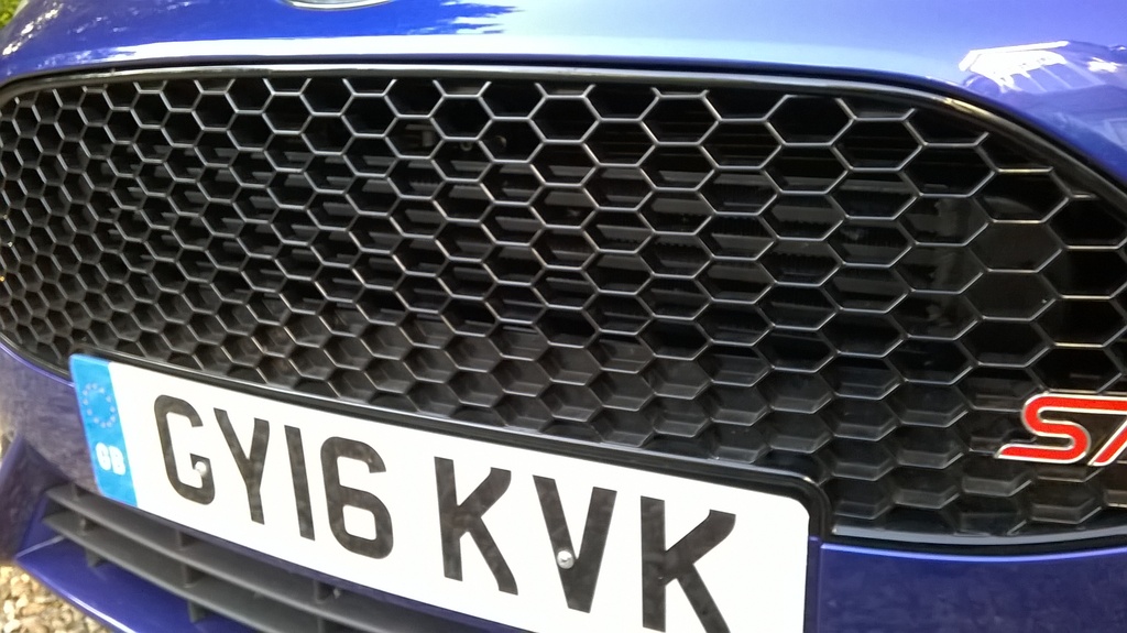

Pic of the Airtec intercooler looking very stock unless you look hard .
WP_20170509_07_09_19_Pro[1] by Alan Kaveney, on Flickr

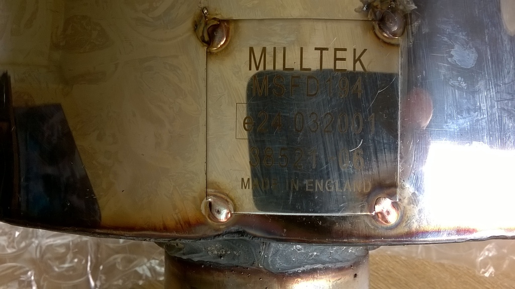

Then I install a Milltek non race resonated unit as this is 2.75 inch bore and a 200 cell Milltek sports cat .
WP_20170528_10_19_15_Pro[1] by Alan Kaveney, on Flickr
WP_20170528_10_15_03_Pro[1] by Alan Kaveney, on Flickr
WP_20170603_16_21_00_Pro[1] by Alan Kaveney, on Flickr
WP_20170603_17_23_55_Pro[1] by Alan Kaveney, on Flickr
WP_20170701_17_12_37_Pro[1] by Alan Kaveney, on Flickr
WP_20170604_17_18_49_Pro[1] by Alan Kaveney, on Flickr
Then a GFB DV as the stock one might struggle .
WP_20170603_14_00_26_Pro[1] by Alan Kaveney, on Flickr
Then I installed some Mountune S/S brake lines and Motol RBF 600 brake fluid
WP_20170527_11_37_52_Pro[1] by Alan Kaveney, on Flickr

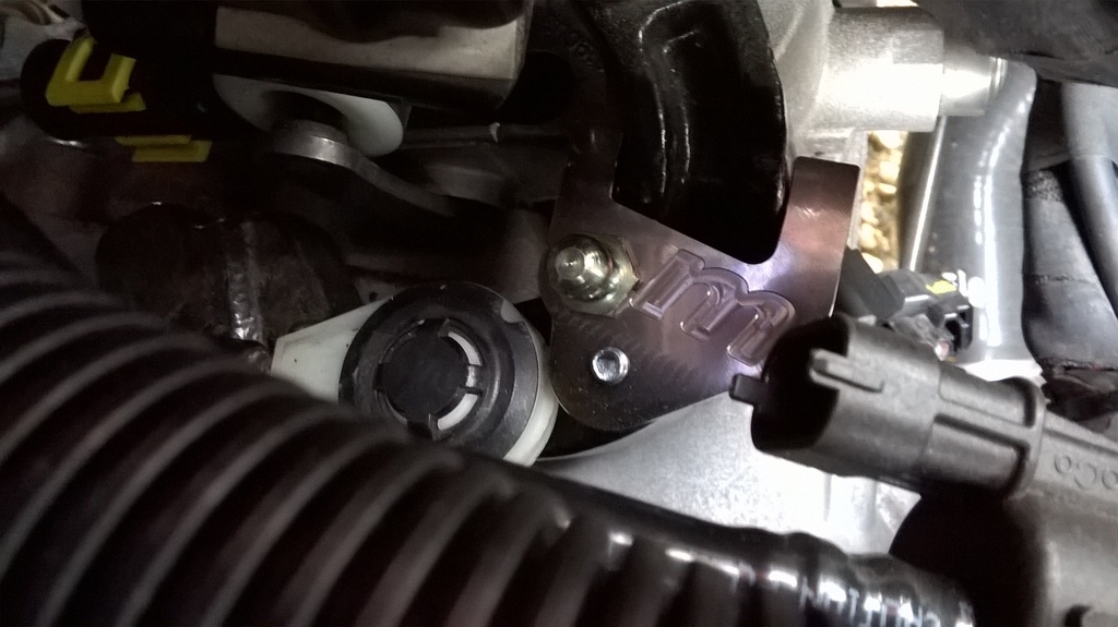

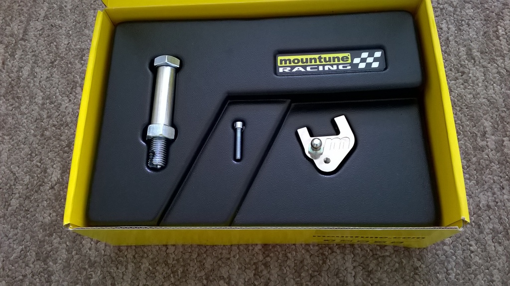

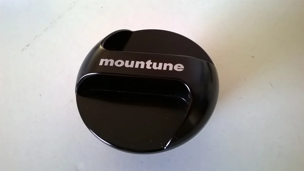

Next up was a Mountune short shifter
WP_20170701_15_27_36_Pro[1] by Alan Kaveney, on Flickr

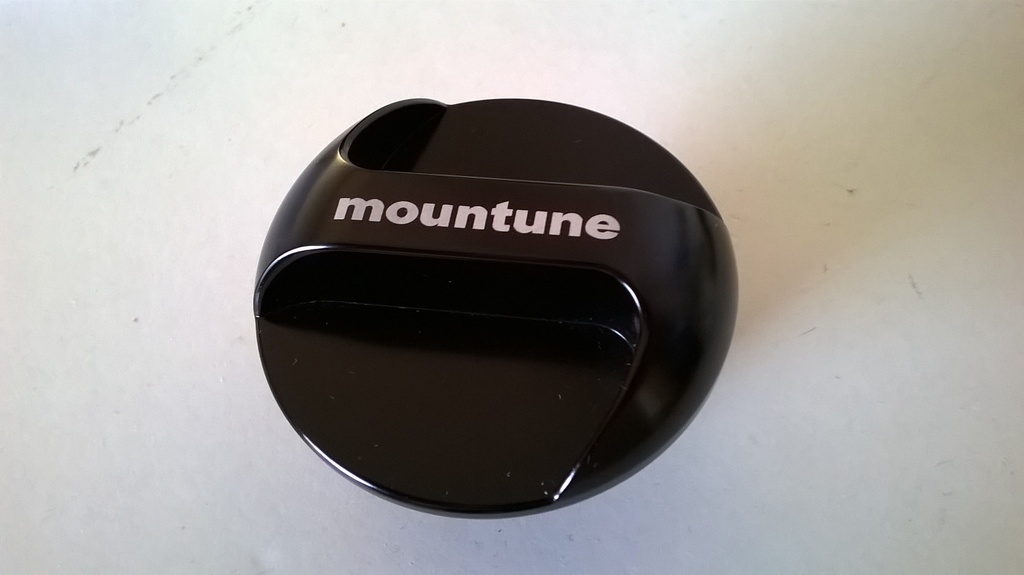

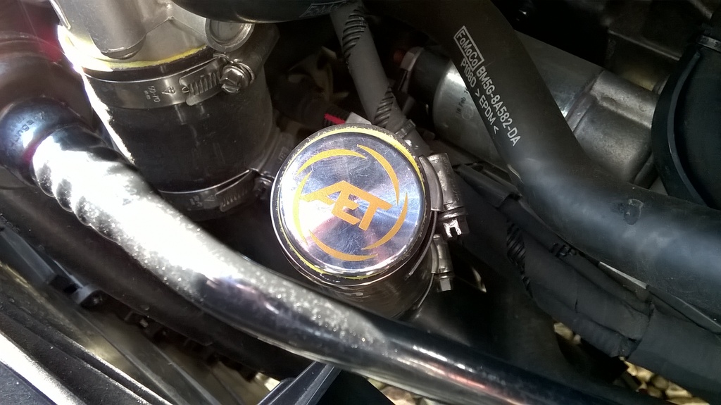

Then an AET sound symposer blanking plug as I think the sound symposer was leaking boost a bit .

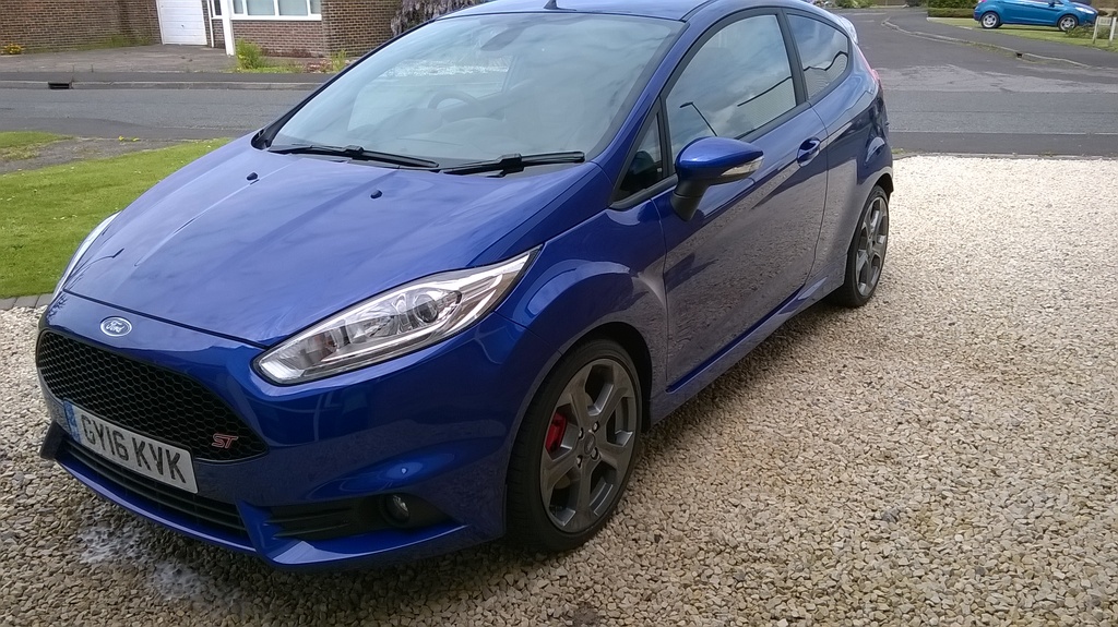

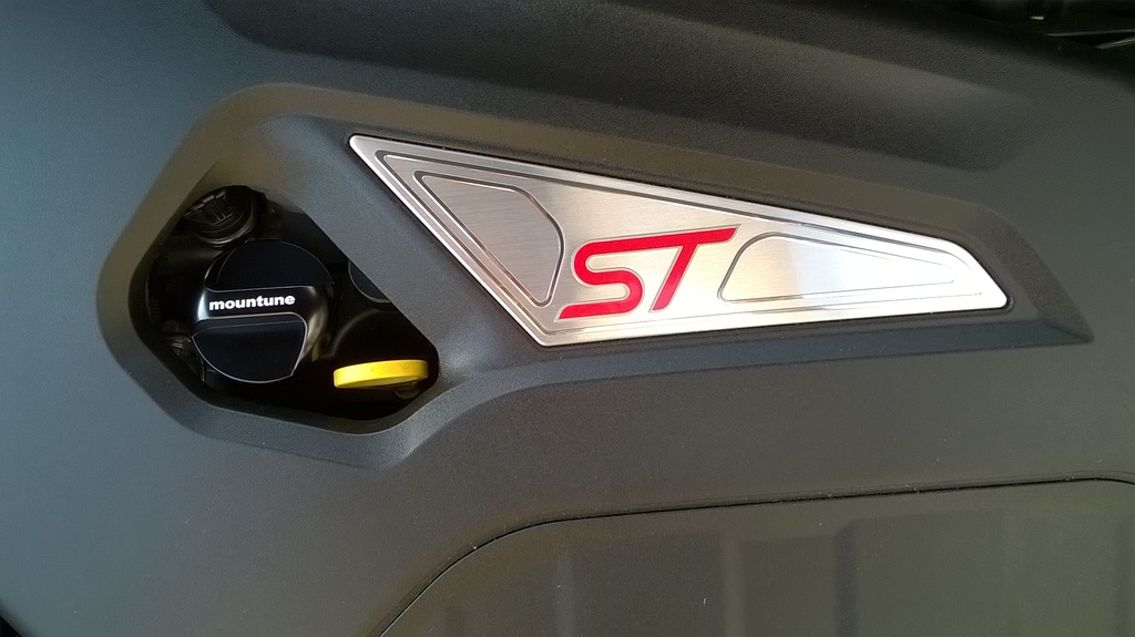

And that is how the car is now .
It looks very OEM stock but now drives and has the power I wanted from it and it a little bit of a sleeper unless you look hard .

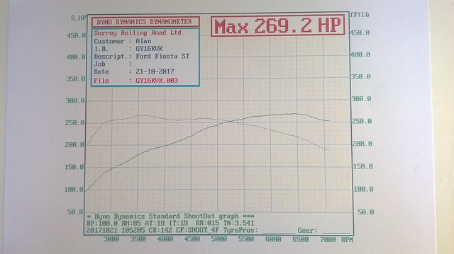

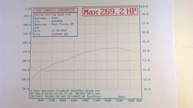

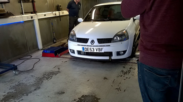

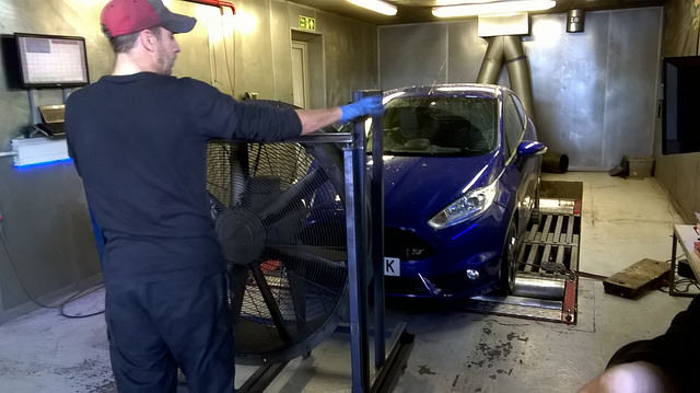

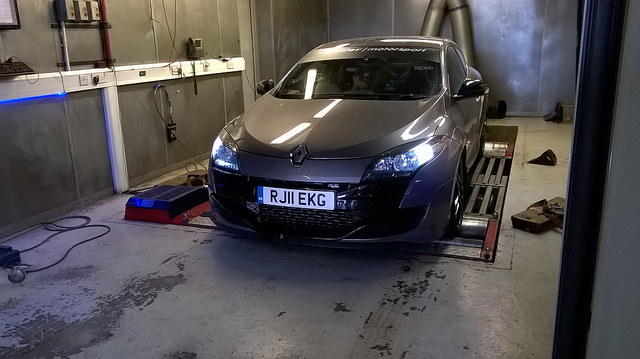

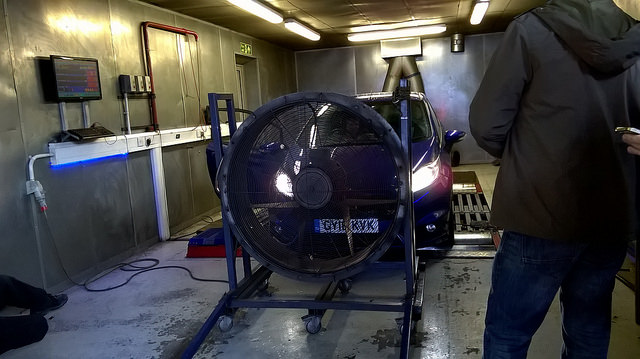

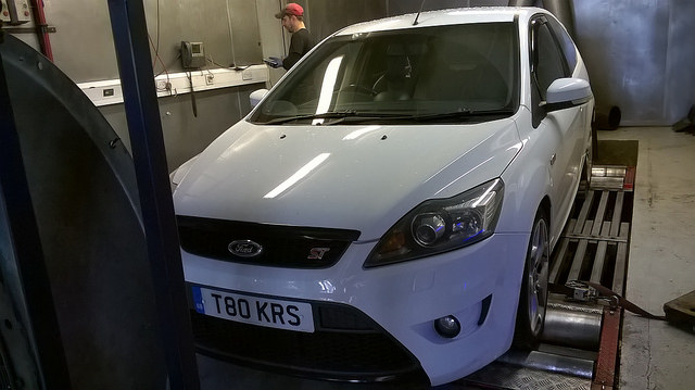

I took my car along to Surry rolling road for a Cliosport day on Saturday and put my Fiesta ST with the Collins CP4X on the rollers .
A few pics of the car on the rollers .
WP_20171021_10_57_13_Pro[1] by Alan Kaveney, on Flickr
WP_20171021_10_58_53_Pro[1] by Alan Kaveney, on Flickr

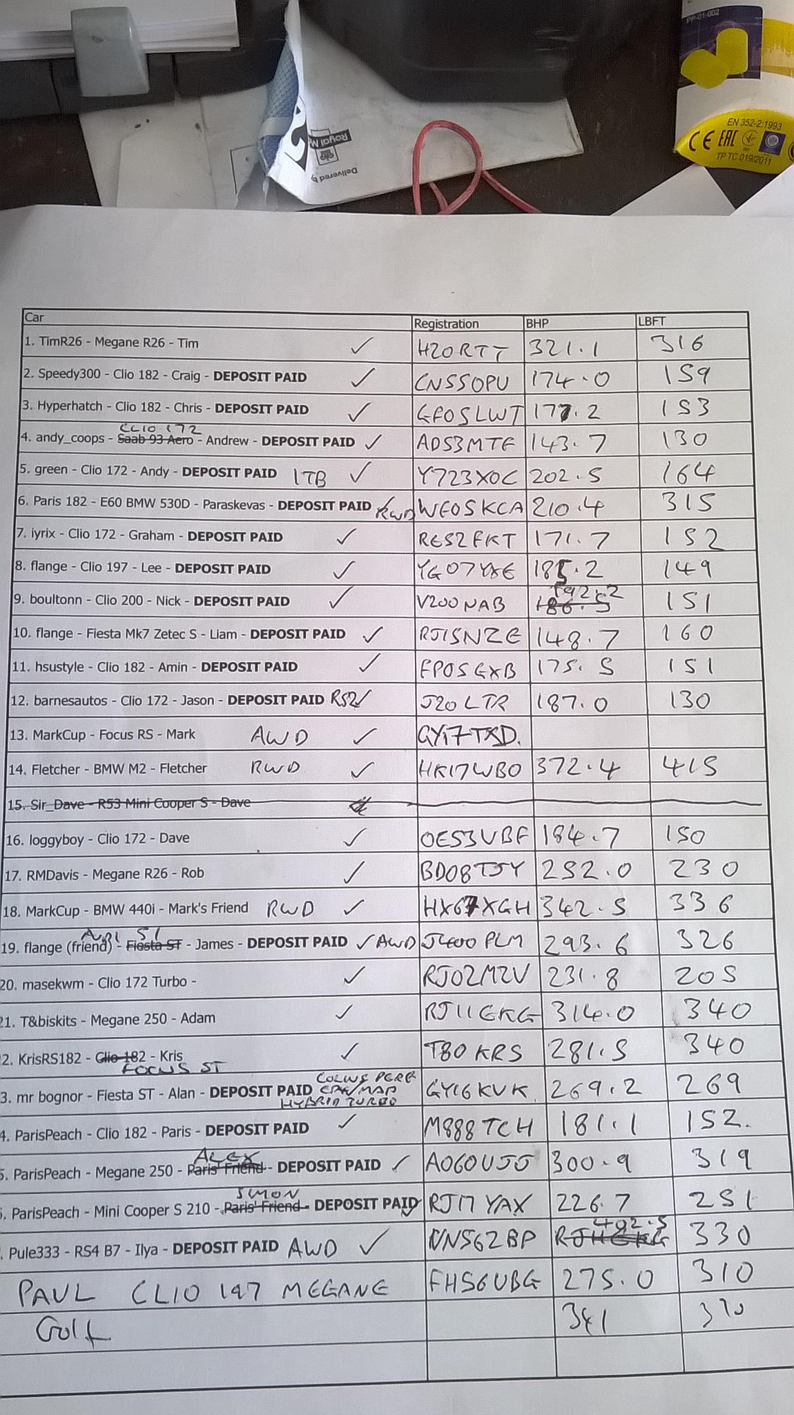

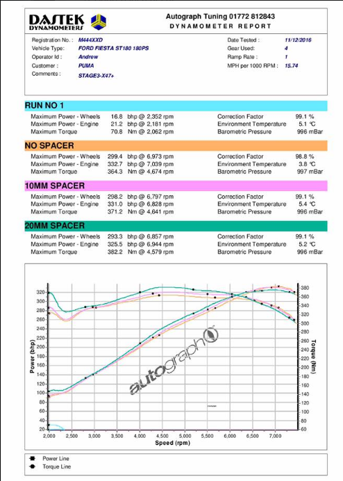

And the print outs .
269 BHP
269 LB/FT
A little bit down on the claim of 306 BHYP and 285 LB/FT but the car feels very quick ( as it would with 270 BHP ) on the road and the AFR are looking good .

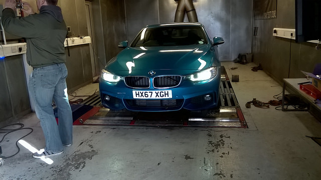

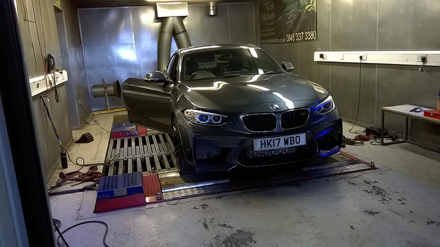

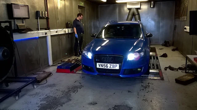

Some pics of the other cars on the day and what each car made .
WP_20171021_13_37_33_Pro[1] by Alan Kaveney, on Flickr
WP_20171021_13_36_55_Pro[1] by Alan Kaveney, on Flickr
WP_20171021_13_26_54_Pro[1] by Alan Kaveney, on Flickr
WP_20171021_13_14_53_Pro[1] by Alan Kaveney, on Flickr
WP_20171021_13_04_10_Pro[1] by Alan Kaveney, on Flickr
WP_20171021_12_53_10_Pro[1] by Alan Kaveney, on Flickr
WP_20171021_12_37_45_Pro[1] by Alan Kaveney, on Flickr
WP_20171021_12_20_57_Pro[1] by Alan Kaveney, on Flickr
WP_20171021_12_12_44_Pro[1] by Alan Kaveney, on Flickr
WP_20171021_11_59_19_Pro[1] by Alan Kaveney, on Flickr
WP_20171021_11_55_47_Pro[1] by Alan Kaveney, on Flickr
WP_20171021_11_40_10_Pro[1] by Alan Kaveney, on Flickr
WP_20171021_11_30_54_Pro[1] by Alan Kaveney, on Flickr
