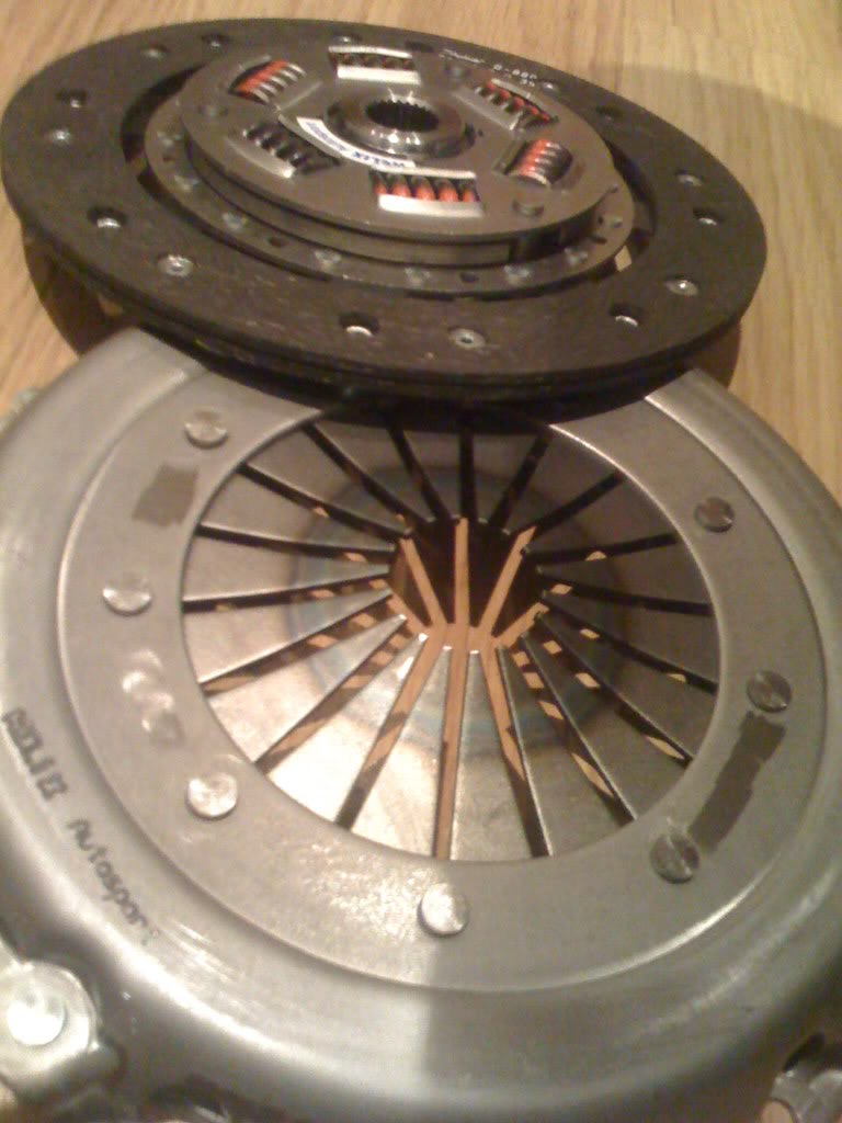

some of you may have seen my last thread regarding the last clutch

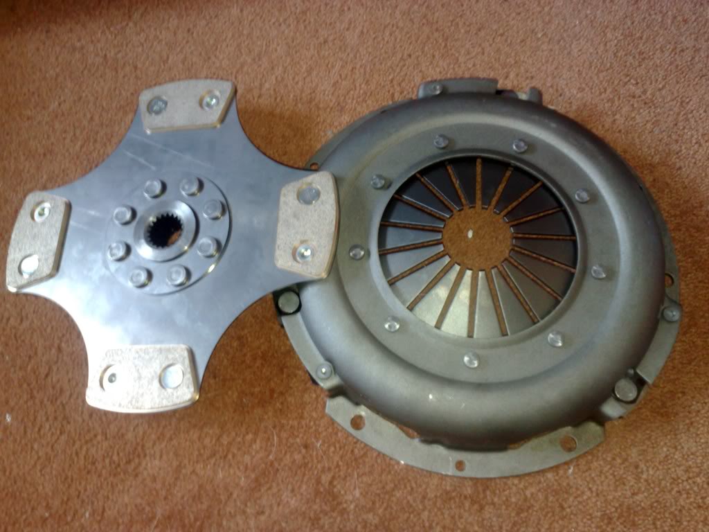

well its given up all hope after just 2 weeks, so heres the new baby thats going in :D
better luck this time
its had matched inlets, decat, s/s exhaust, remap, itg filter and i'm looking into cams too so wanted something a little more reliable and rugged, plus the other half wants to use it in the summer while i'm at work so the stiffer the clutch the less she'll want to drive it lol :clown:
Unsprung centre paddle clutch............. you were bloody brave! We don't even run those on the race cars! Paddle clutch? Oh yes - unsprung one? Not on your nelly!

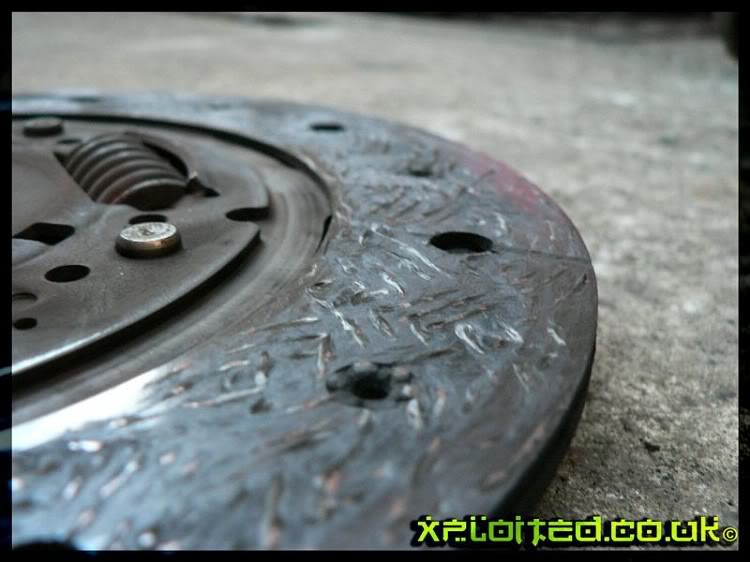

LOL, this is what i did to a standard clutch--
The paddle also had an uprated clutch plate. Was a monster, was like--
No power, no power, boooooooost, change gear and then a big clunk once it engaged. Could hear it. Was immense!

Unsprung paddles are bloody harsh on the rest of the drivetrain though. You tend to need the bit of give a sprung center gives you to smooth the delivery of torque to the box during rapid gear changes.
The sprung 4 paddle clutches we developed for the X85 endurance car are pretty impressive. Several thousand gear changes and 24 hours of racing and it came out looking as good as it went in!
