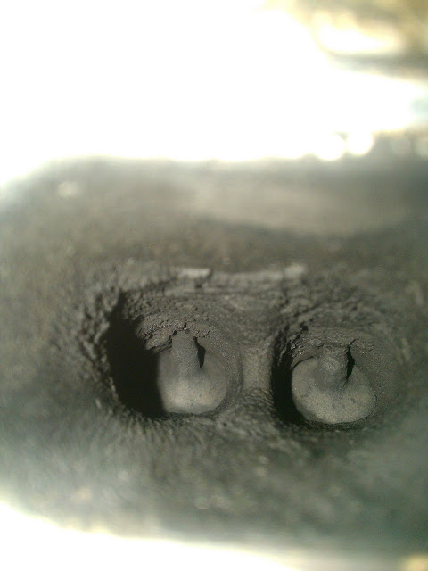

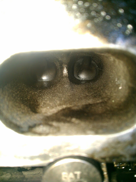

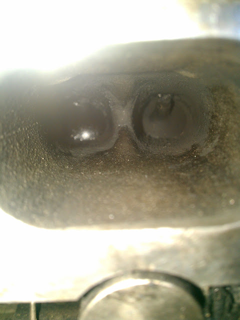

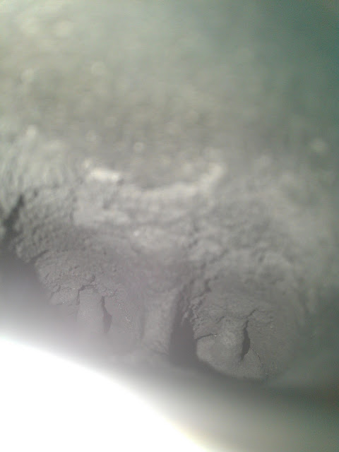

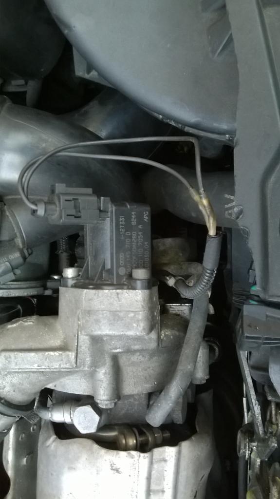

Over the weekend I took the inlet manifold off to clean the valves .
Also I changed the spark plugs , coil packs BOV , boost control valve , Canister Depollution system eletro valve and the BOV and cut and crimped the wires .
Also put a K & N panel filter in along with an oil and filter change .
some pic
The problem after 75 K miles with direct injection
50% cleaned
99% cleaned

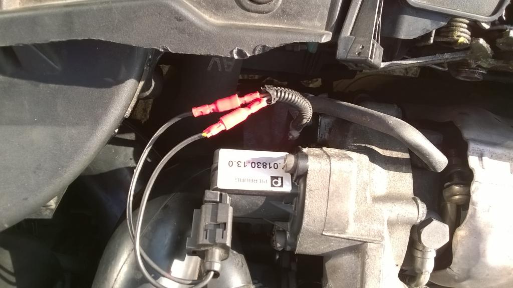

The old with solder bodge
New
The car drives so much better and pick up is so much moor .
I have been told that cleaning the valves can give the car back around 20 BHP :)
Next up will be to fit new discs and DS2500 pads and then look at a remap .

Inlet manifold off turn crank to get first 2 valves closed then sea foam brush dentist tools and other bits .
Took a long time but was worth doing by the looks of the state the valves were in .
Car drives much better now im guessing to the increased air flow .

3 days of cleaning the Fu*kers so not a fun job but worth it .
All of the spray in stuff does bugger all so it really is a inlet manifold off job FYI

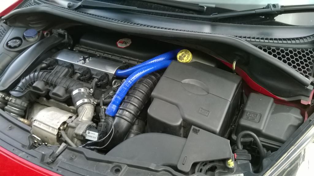

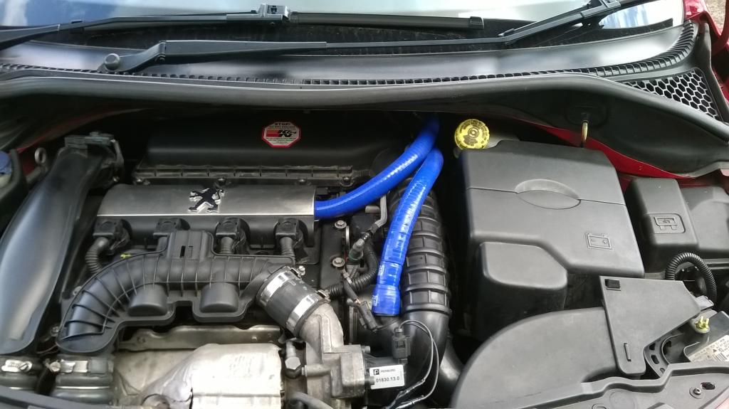

+ I have ordered a oil catch can for the front PCV so we shall see .

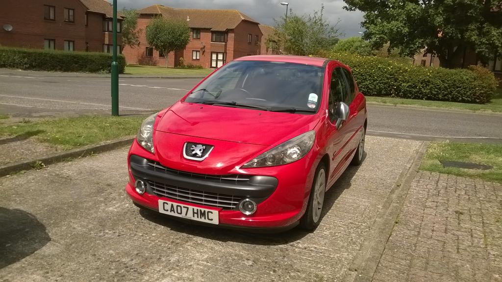

A few pic of the fresh wax job ( no tyre shine )
Also thought I would post my thoughts on the car as a whole after 5 weeks odd of living with it for people who may be looking at them now they are a good price .
Cost
The car £ 3500 and is a 2007 with 74K on it with FPSH and has the Octane pack so I would say they are GVFM on this account .

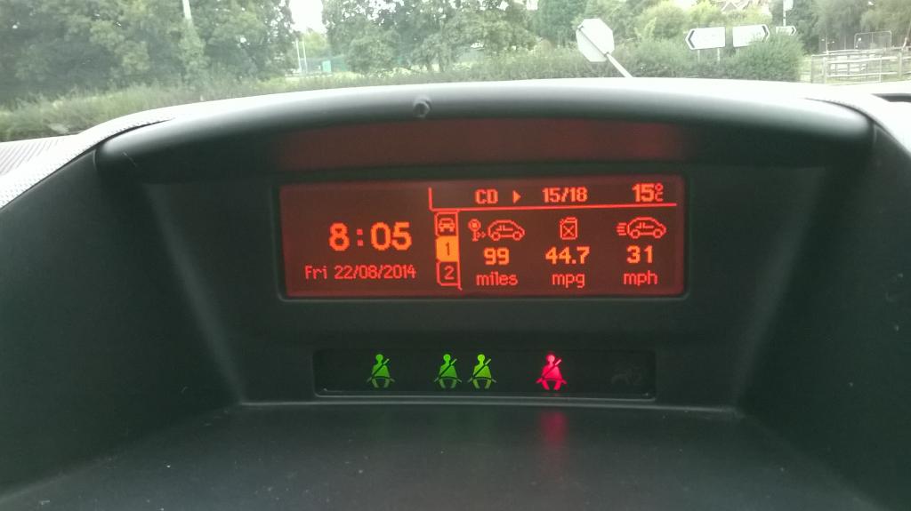

The MPG is 39.2 on the book but on the trip computer on my run to work its 44.7 MPG ( pic below ) and £ 20.00 will do me 165 miles of mixed driving .
Most of the parts can be got from Eurocarparts or other places and are not to expensive ( a set of x 4 Bosh coil packs was £ 58.70 )
Tax is £ 200 for the year and insurance is £ 201 for me at 31 years of age .

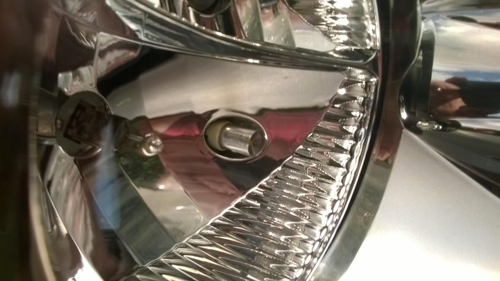

Small update I put in some Ring Xeon bulbs and some Cree LED side lights along with the oil catch can at the weekend .
