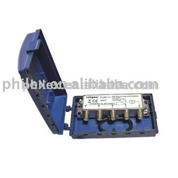

No worries... I imagine it will be either a white box...maybe black... it should open up from the rh side (hinge should be on the left)
It might look something like this
And there should be a power supply for it. Sometimes they are downstairs at the main TV point and people take them when they move thinking that is the Amplifier!! Noooo its the psu for it :)
