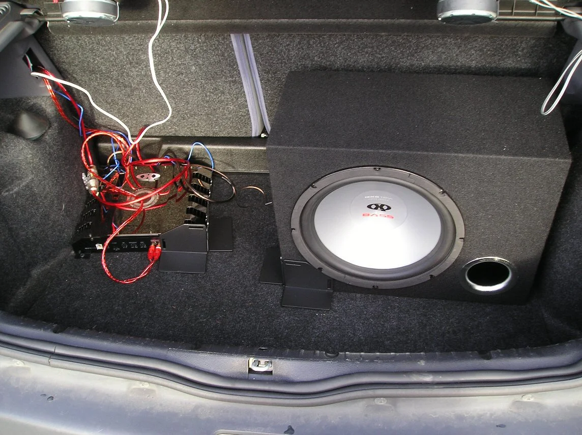

Heya guys,
This weekend I installed totally new sound system into the car.. did the whole lot, it now sounds awesome.. i mean mindblowingly fantastic.. :D

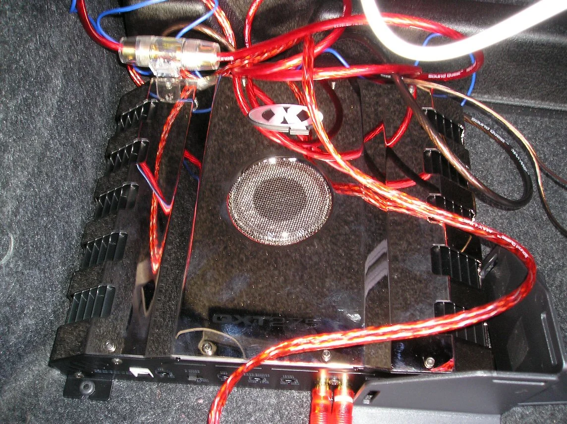

All i need to do is mount the amp somewhere, its currently held in by boot ankers, which works but doesnt look good at all.
Any suggestions.

I was hoping to mount the amp on the back of the seat but its made of this foam stuff unfortunatly.
I think ill try and find a way to mount it to the wheel arch in the boot.. but its made of metal, anyone got any pics of what they have done?
  RenaultSport clio 182 mk2
Mount the amp on top or back on the sub box?? Thats wot i've done saves space too :d
  Megane 225 Cup
i said that to the guy in the shop, he said not to as it
1. creates distortion
2. as the sub vibrates stuff in the amp will eventually come lose.. thats why sub and amp combinations arnt that good.
will have to see what i can come up with.. might try and work out a way to connect it to the rear seat,

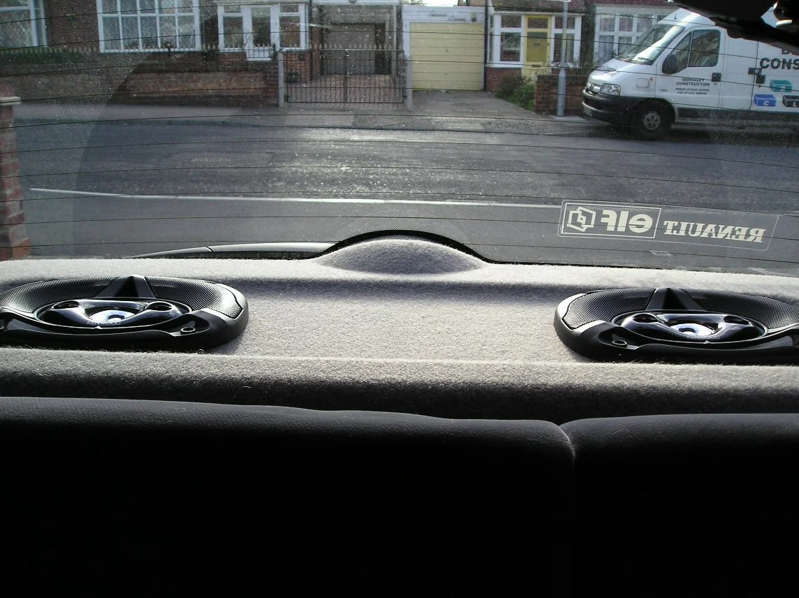

those rear 6x9's are just asking to be stolen, get a stealth shelf mate
OR, remove them, and throw them over your shoulder in the hope that they break and can't be put back in!!!
  Megane 225 Cup
any particular reason? they are quality speakers?
  Skoda Fabia vRS
you dont need 6x9's if you have a sub, they are a speaker designed to get more bass from a speaker that is still quite small, they have no point if you have a sub already and you can get better sound quality from a normal round speaker, or dont have any rears in at all, with a sub they are not needed, just amp the fronts for treble/mid and the sub sorts the bass out
  Megane 225 Cup
I owned the 6x9's from my old car, seemed like a good idea to put them in as they are good quality, i only bought the sub amp headunit and front speakers last weekend :D sounds wicked.
(also im not running much bass through them anyway.)

I'm sorry but you clearly know nothing about decent car audio, which shows by your choice of equipment!!! I'm not saying I'm an expert, I'm sure Dink and Muzz will show their faces at some point in the post who are probably the most knowledgable people on the site in relation to ICE. Just try posting this up on TalkAudio and see what they say. They are the true experts and will let you know what they think.
What is so good about surround sound in respect to music??? 5.1 and such are only of benefit for watching TV, films, etc. not listening to music. When you go to a concert they don't place speakers at the back of the room as you're not supposed to listen to music from behind you, it ruins the soundstage.
Just look at the top home stereo systems from the likes of Bang & Olfsun, 2 tweeters, 2 mids, and a sub. PERFECT!
This is all coming from someone who has had experience of 6x9s. In my naive youth I bought some and thought they were greta, until I took the advice of people who know their stuff about ICE. I'm running DLS MS6 components up front and a Phoenix Gold Xenon (X12D4) sub. Non of which are market leaders, but they are in a completely different league to the products you have used.

Sorry have to totally dissagree with you. I love people improving thier sound in thier car however there are a few things you need to sort. It looks a decent install and I apreciate the hard work gone into it so dont flame me!
1. 6x9s and sub sharing the same air is a terrible idea, the air from the sub will move the cones of the 6x9s causing distortion and eventually breaking them. If you really want them box them in.
2 Your wiring loks very scary dangerous! You do realise that amp will get hot hot hot!
3. speakers coming from behind drags the soundstage backward Would you go to a concert then turn your back on the band? Go to an IASCA event listen to the cars there 99.99% of us use components in the front and sub in the back. People spend £000000s on getting the sub to sound like its in the front.
sorry if I sound negative however over hte past 10 years I have learned waht not to do!
yep thats why im trying to mount it somewhere.. i have moved the wiring since taking those pics. The wiring is good (had it checked at shop i bought all the equipment at).. just needs hiding.
when they break or even begin to sound remotely dodgy i will remove them and just have the speakers in the reveals.

Just something I noticed, you do have a fuse at the battery as well don't you?, as well as before the amp because if you've only got the one in the pictures then the cable before the fuse is completly unprotected.
  Megane 225 Cup
No. i did this before i knew that it mattered, although after lengthy discussion with the guys at my local audio shop decided to leave it as is. there is not enough cable to swap it to the front. The cable is fire proof anyway, and to put it in the front i would have to buy new cable anyway so what they said is leave in back, if it burns then it wont do any damage (apart from f**k the cable). if it does f**k up ill just buy a new cable
I have talked to the guys at halfords, the guys on the net who i bought the kit off, my dad (who is an electrician) and the guy at my local shop, they have all said it is absolutely safe, although could result in £10 cable getting fucked, however to move it to the front id have to spend that anyway so may as well leave it.
  BMW M135i
Hmm, looks like a possible electrical fire waiting to happen to me, I don't care what the cables supposed to be I still wouldn't trust it, its only takes one thing to happen.
But hey its your car and up to you in the end.

only prob is that if the casing burns then the copper core touches metal You could get BIG sparks mate.
When I install its safety, sound then looks in that order of prioity. Seen a car go up in flames before due to an ice install, its not nice and plus insurance companies can go F you if you try to claim because the wiring is not standard
  Megane 225 Cup
yeah i know, although im not that worried about it, i mean i have talked to quite a few professionals about it (did realise the mistake i made) and they have all said there is no problem (although i could loose a £10 cable).
