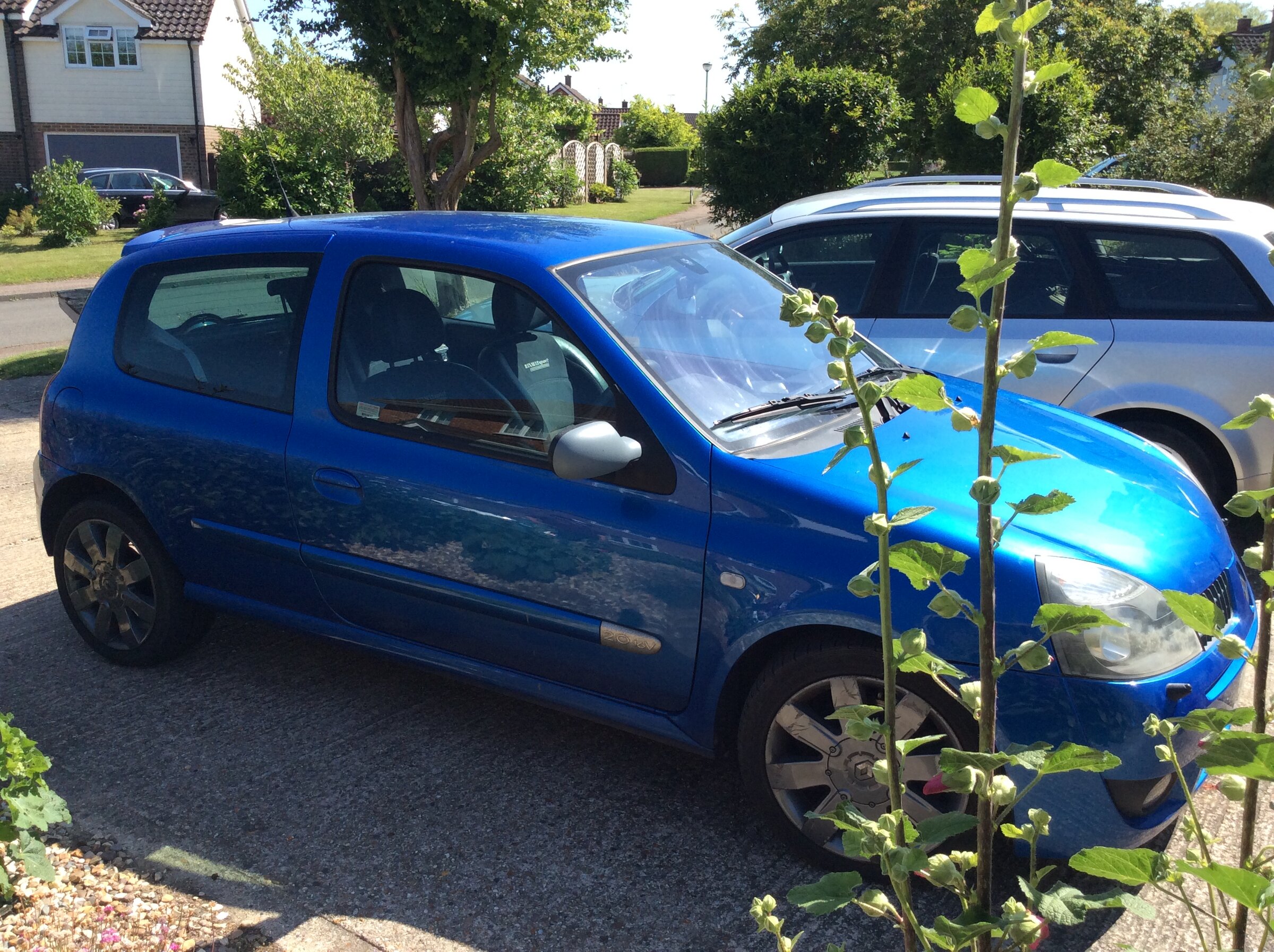

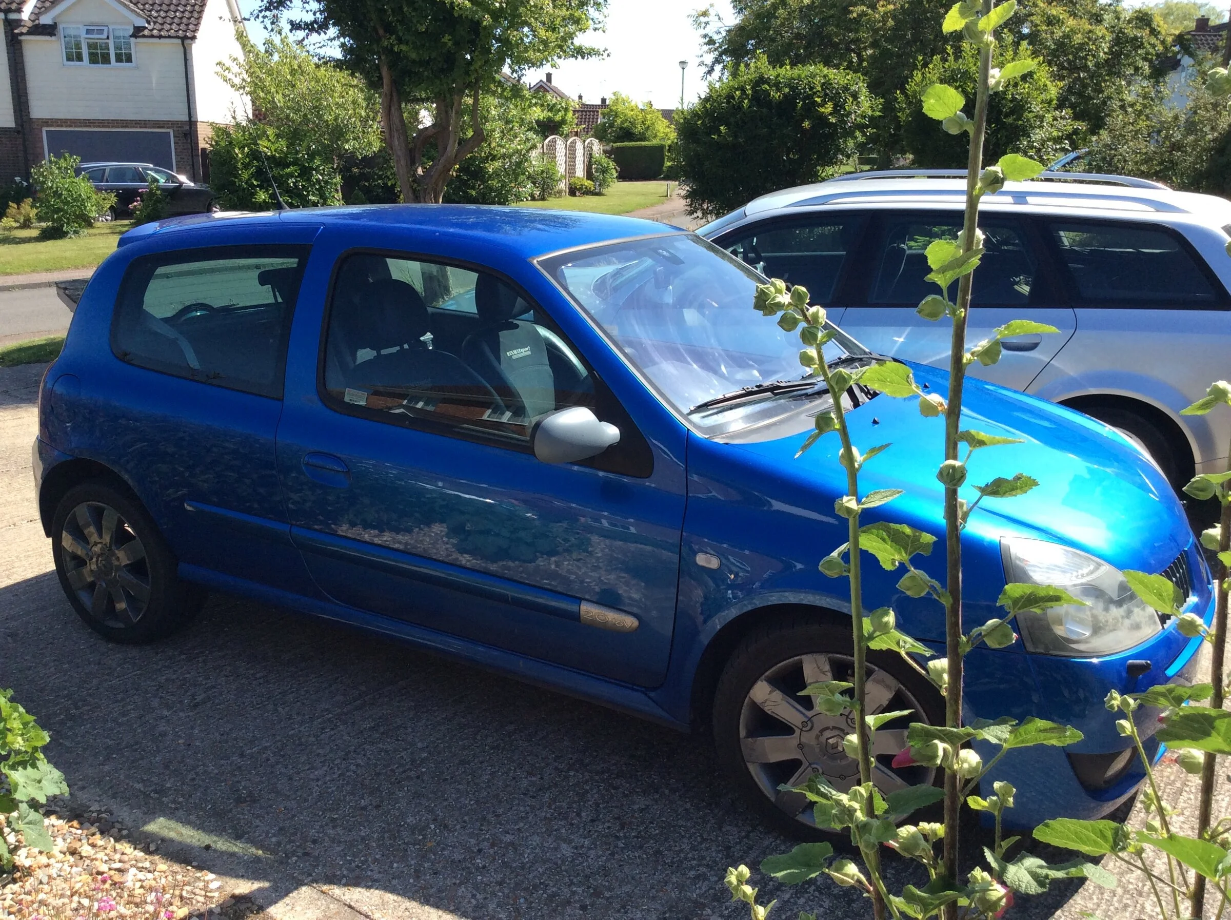

Hi all, I joined the Clio sport family yesterday buying a one owner 182 from the private seller. Drove it home after checking oil etc and it was fine. Took it out in the evening and it broke down. I was unable to start it, it was making a clicking noise when turning the key like the starter motor or battery had gone. Garage picked it up today and said that they took the starter off but the engine won’t move manually. Seller understandably doesn’t want to know. Anyone have any idea since as to what to do now?? I’m tempted to sell it as spares repairs and recoup some cash or is it worth getting the engine rebuilt.
Thanks in advance.
