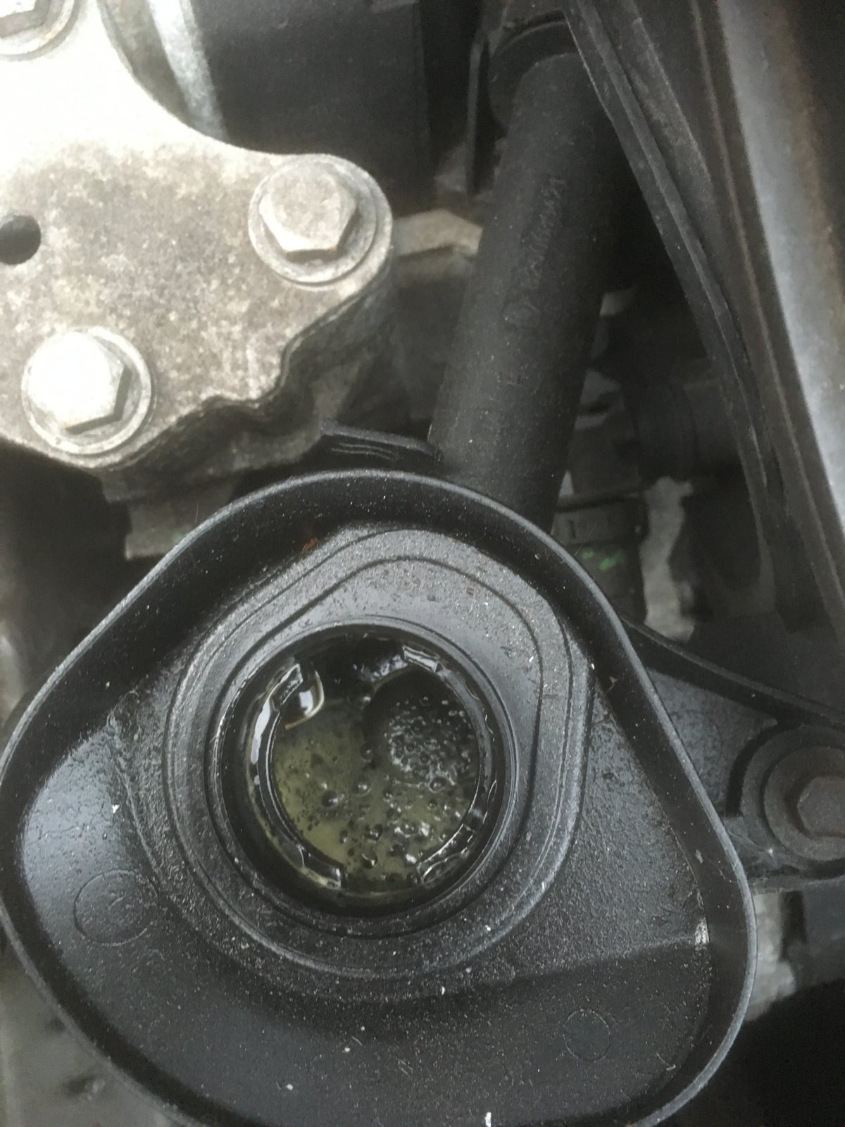

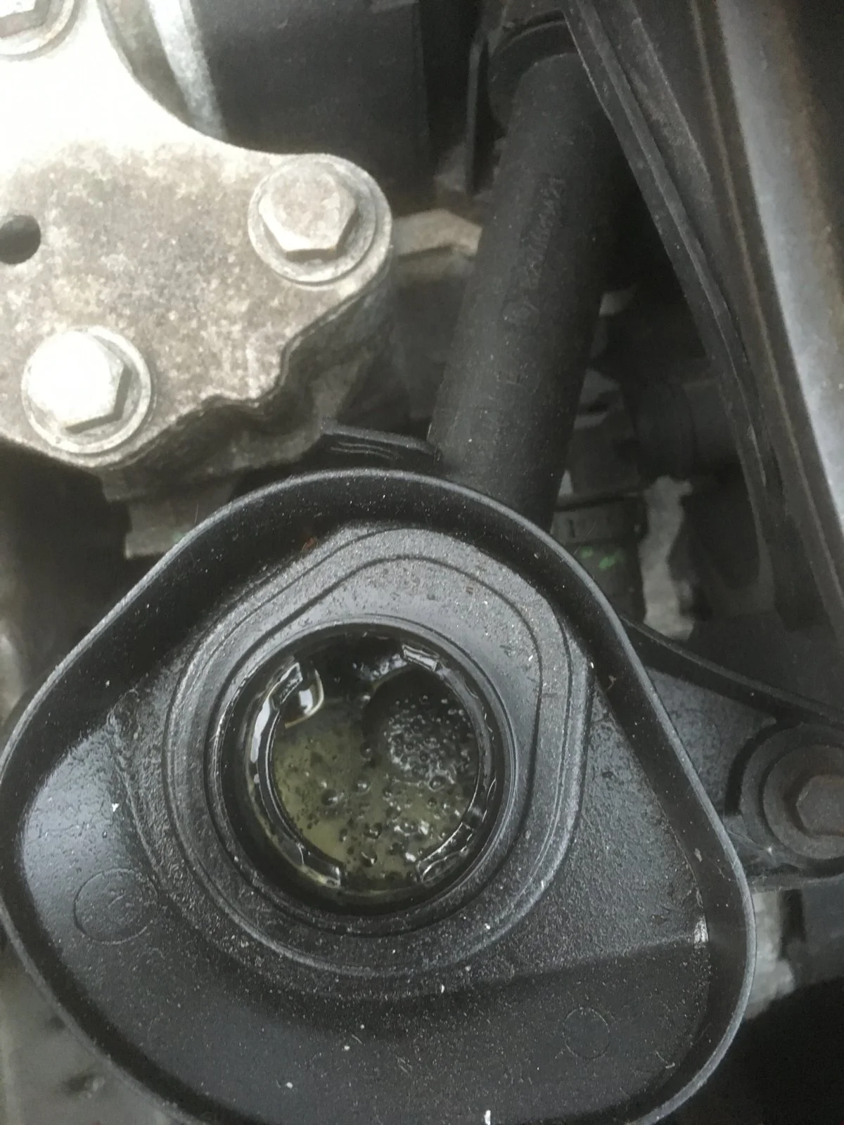

Anyway, this one we looked at is a 1.2l petrol on an 11 plate. Low miles, lovely condition throughout, very neat and clean around 60k on clock. Engine bay spotless, drives extremely well - speed bumps you hardly feel. All in, a nice car. However when I unscrewed the oil cap, inside looks a little gunky. Now, I have had a few cars over the years and if I recall correctly, my old Punto did this and I would wipe it clean and that was the end of it for literally months. It never gave me any issues at all that car, she was a beater but pulled like an ox.
From the pics, would you be wary or is this no concern do you think? We only took it around the block but everything seemed good. The owner (nice polite lady) handed us the keys and went back to the TV whilst we took the car out so they seem very honest tbh.

Guys, just general opinion. Owners and oil cap - do you think it sounds iffy? They want little over £2k for it but we plan to go in at £1500 as in my personal experience, private sellers who already have their replacement car tend to bite your arm off.

easiest way to tell if there is an issue is if there is mayo on the dipstick
Thanks for the quick replies guys, I should have checked the dipstick, slipped my mind. Will do on a second look I think.
I’ve heard condensation can cause that, it’s what I got told on my Punto I am sure of it so thanks for clarity.

As above, could just be condensation from short journeys, corsas get it really bad too
Check the dip stick
Header tank for contamination and compression/bubbling
Check the heaters get warm
and that it doesnt overheat and away you go :-D
