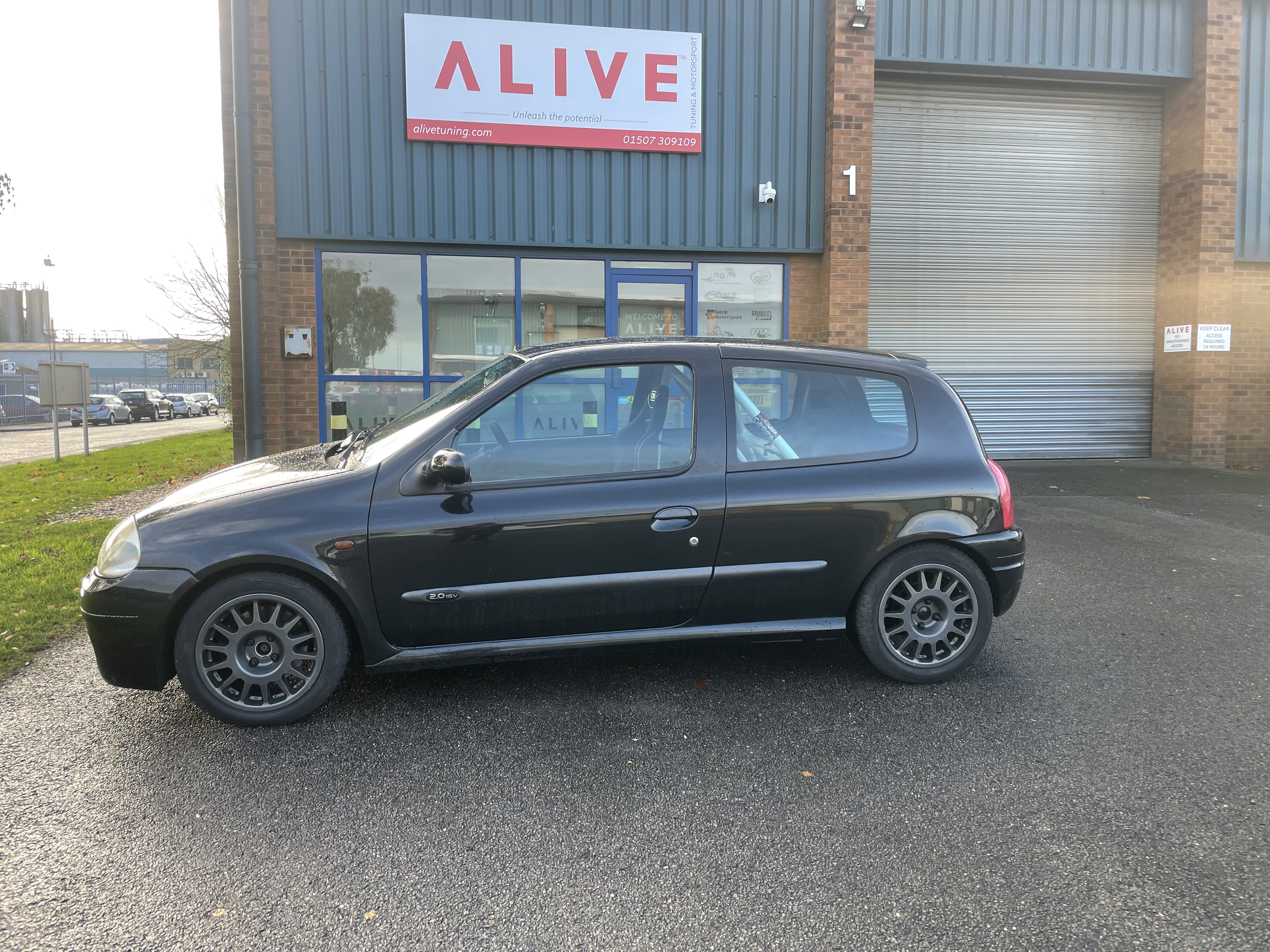

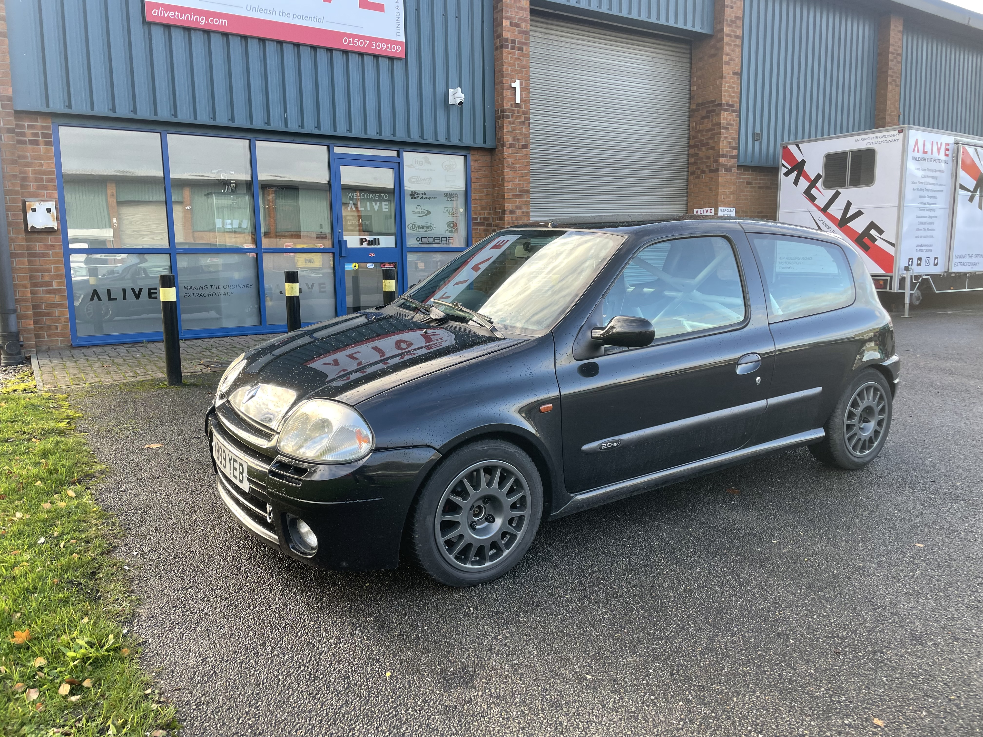

That’s brilliant coops! Thank you for the reply I will have a go this weekend at removing the spacers and lifting it up and see how I get on, Here’s a picture of how the car is sat at the moment

its not really low thats what i can’t understand, i’m thinking maybe when I replaced the suspension the driveshaft has come out of the gearbox and maybe it hasn’t gone back in perfect because it was perfect before I replaced the suspension even bouncing round bends at high speeds and it’s only a little bit lower than before so the suspension wouldn’t be travelling any more than it was

It doesn't look any lower than mine tbh. Did you take it for tracking today?
