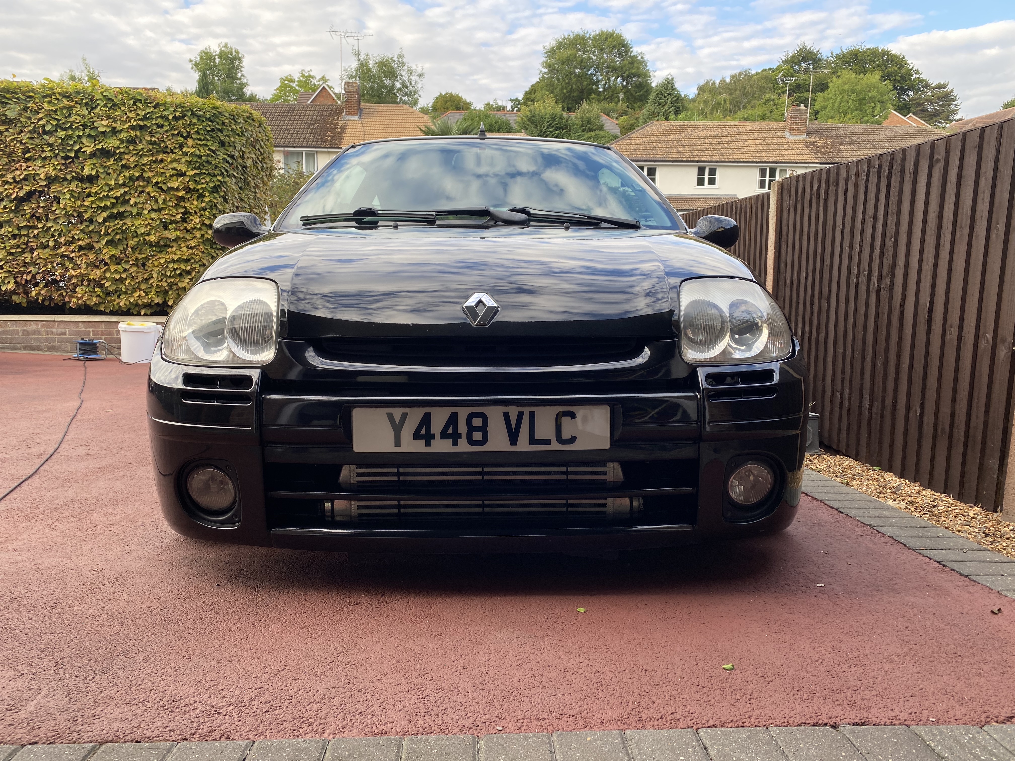

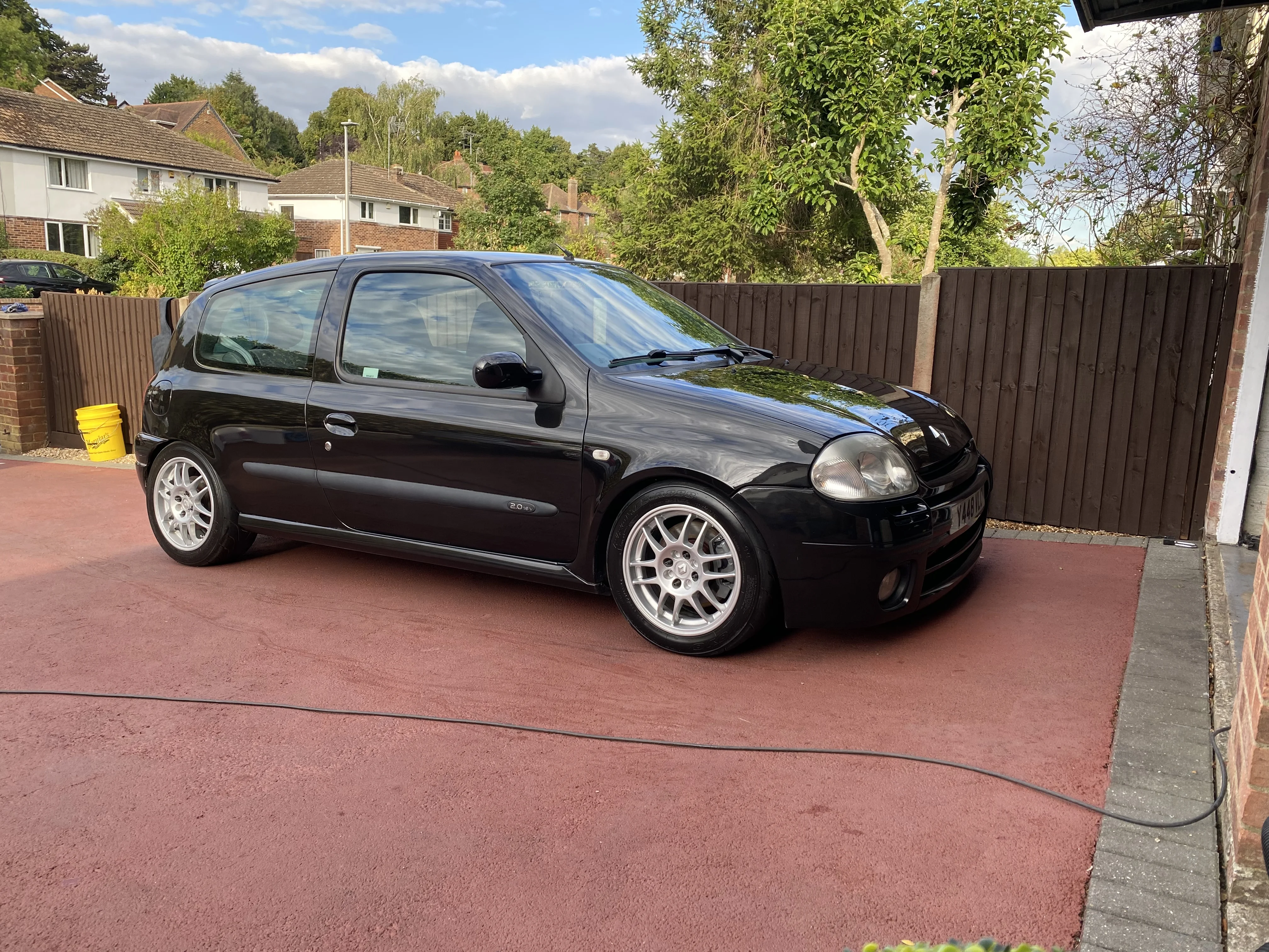

New owner of a clio ph1 which I’m sure some of you may recognise. Been about the forum before but ended up with a Megane 265 a while back which I sold couple years after ownership for a dc5. Car has had a pretty damn good restoration on it and running at 270 bhp down at EFI pics below;)

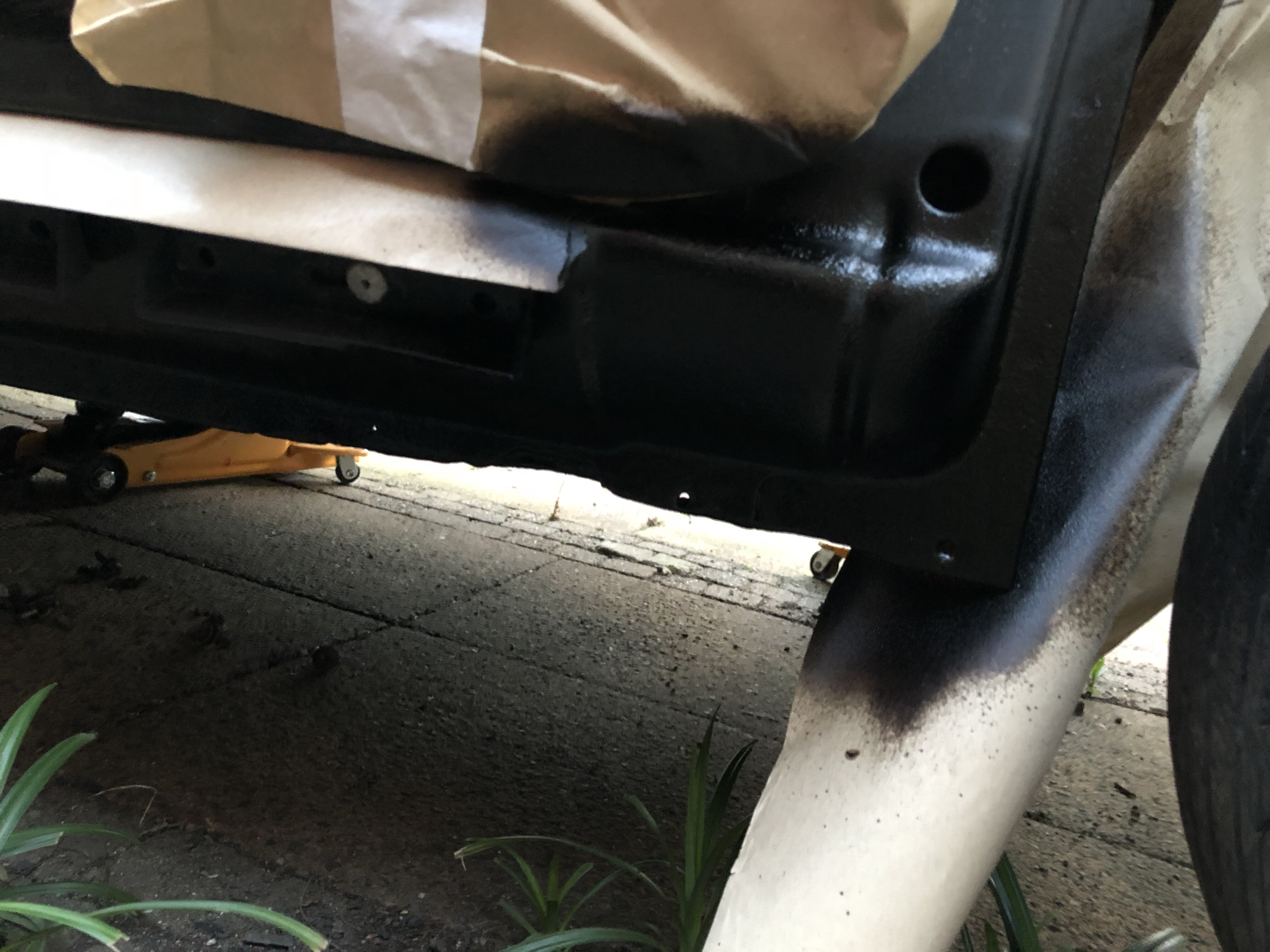

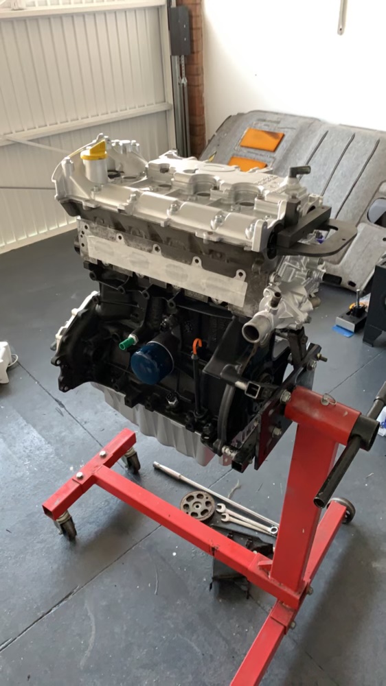

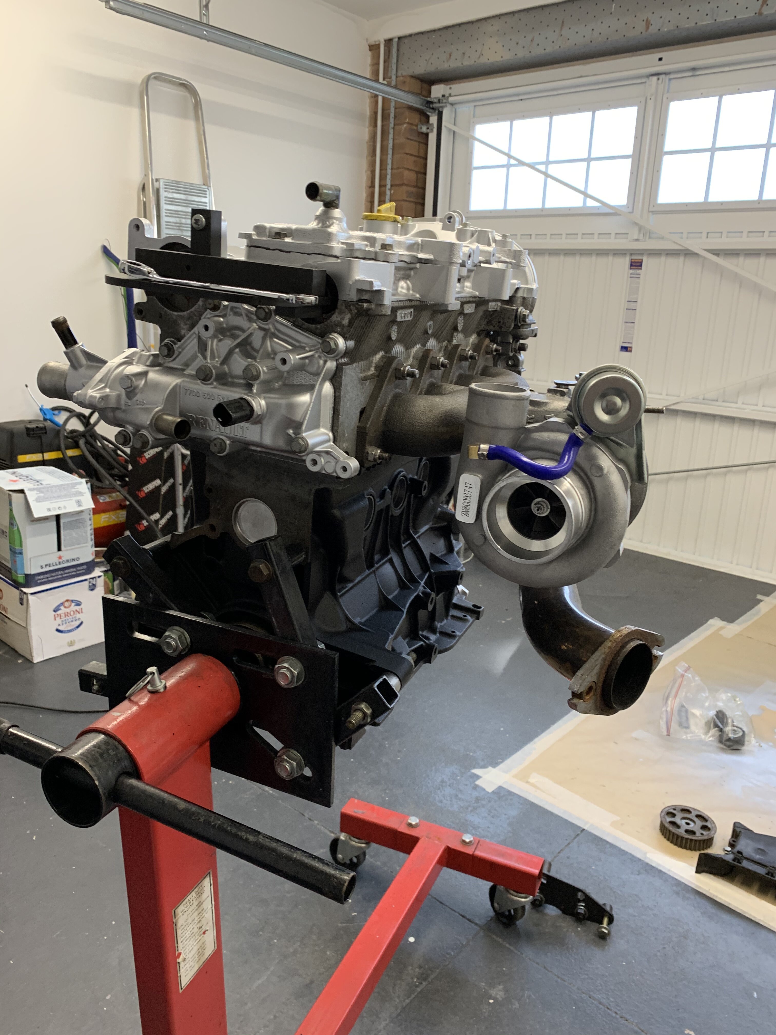

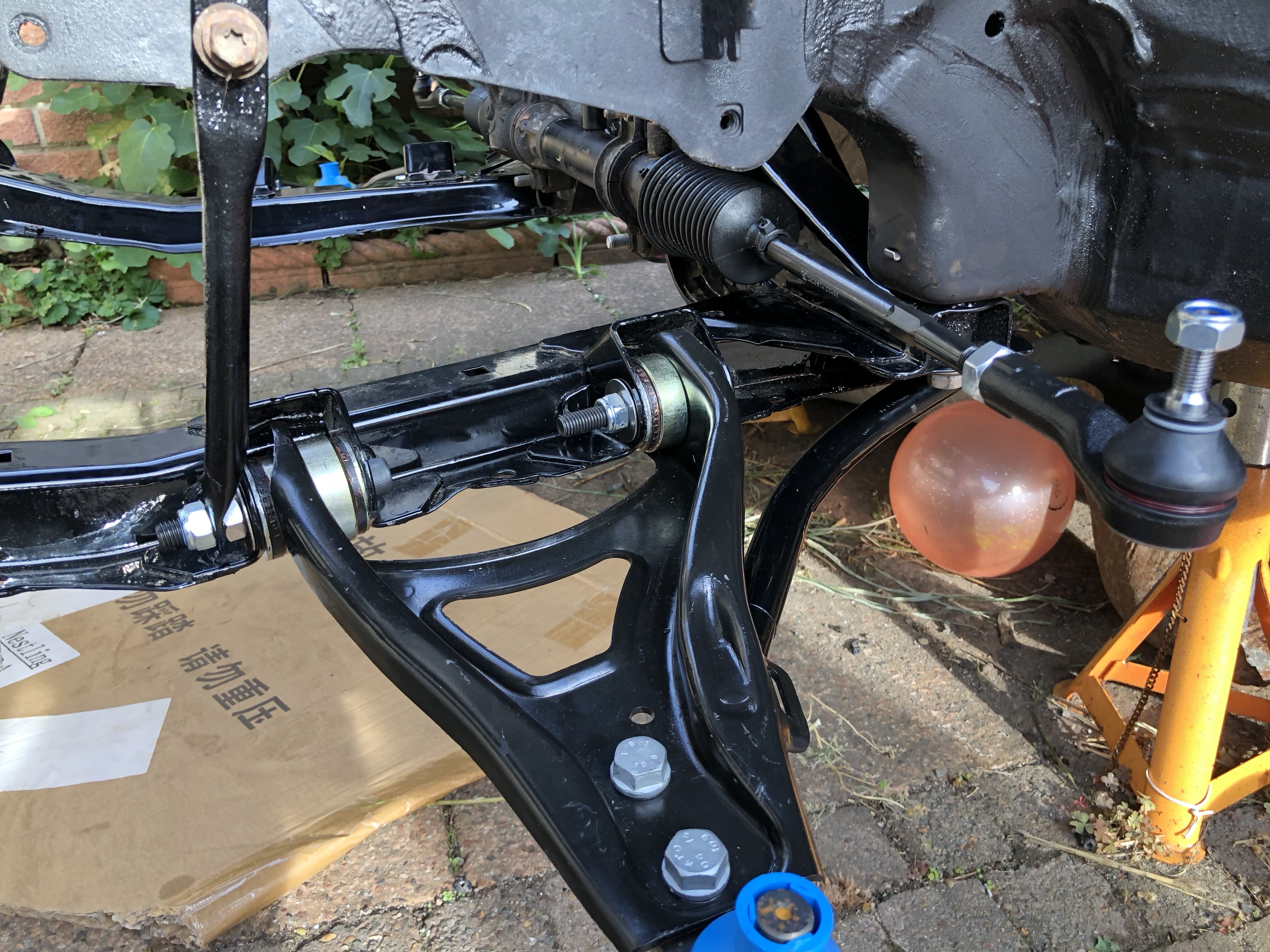

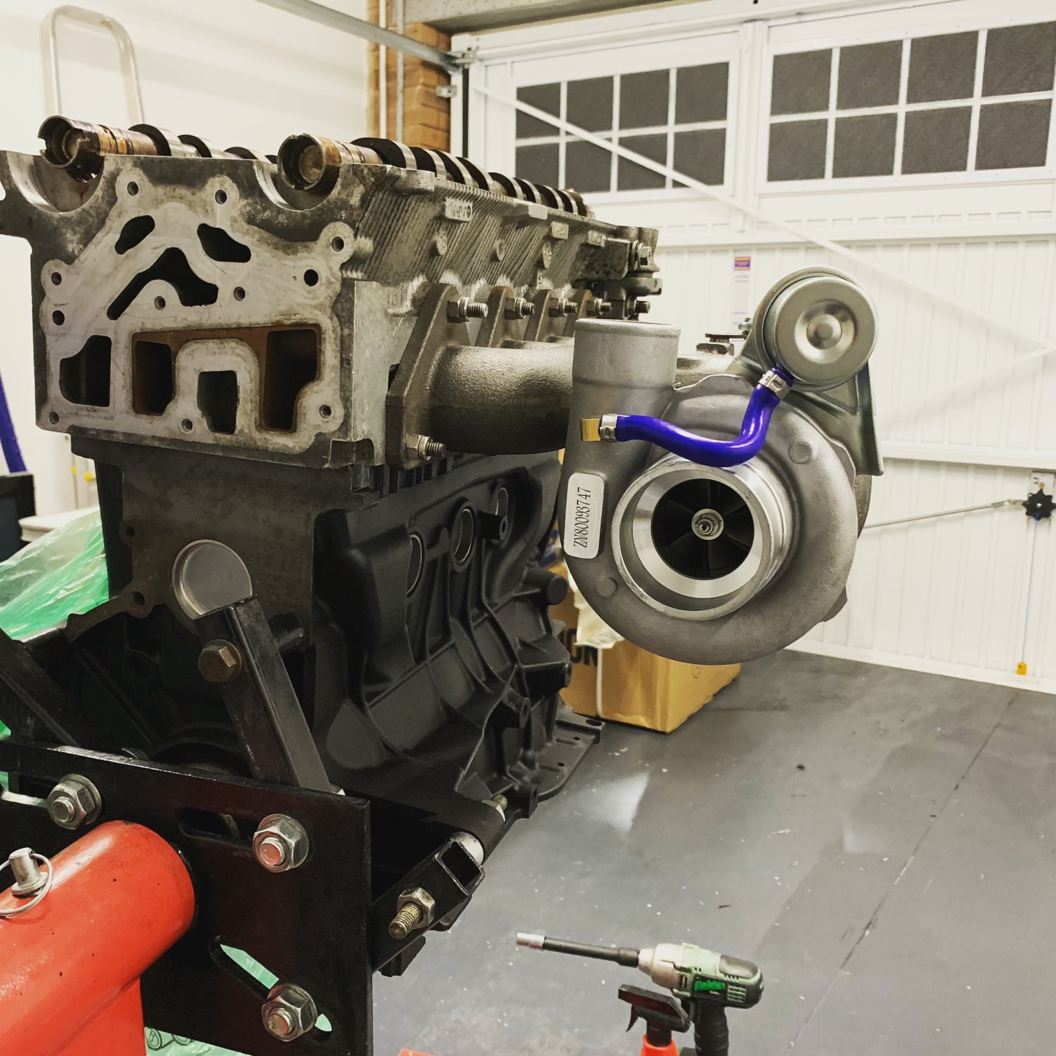

It’s was bought about 4yrs ago as a shell, been built pretty much from the ground up, new arms, joints, reinforced rear beam, new subframe, bushes, rebuilt box.
Engine was completely rebuilt all new gaskets/guides etc
225 rods+pistons
ARP rod bolts
Thicker head gasket
Gt2781 Chinese turbo
Engine dynamics intercooler kit
EFI mapped at 270bhp/250 lb/ft
