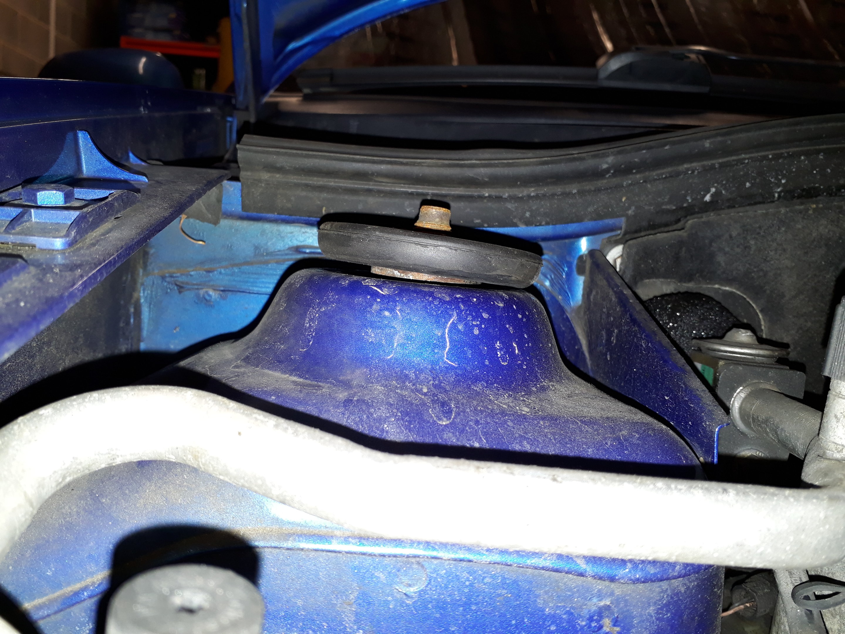

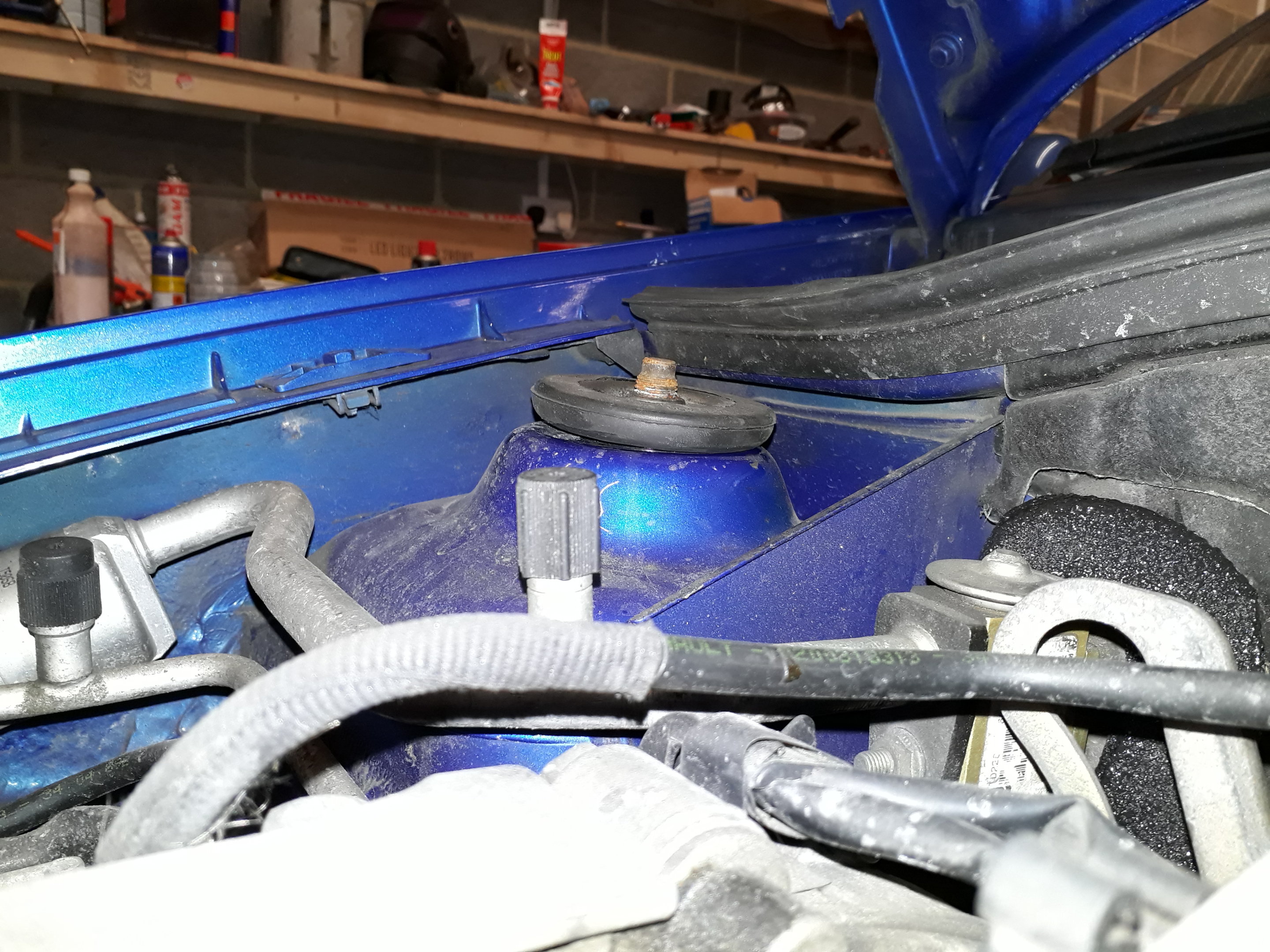

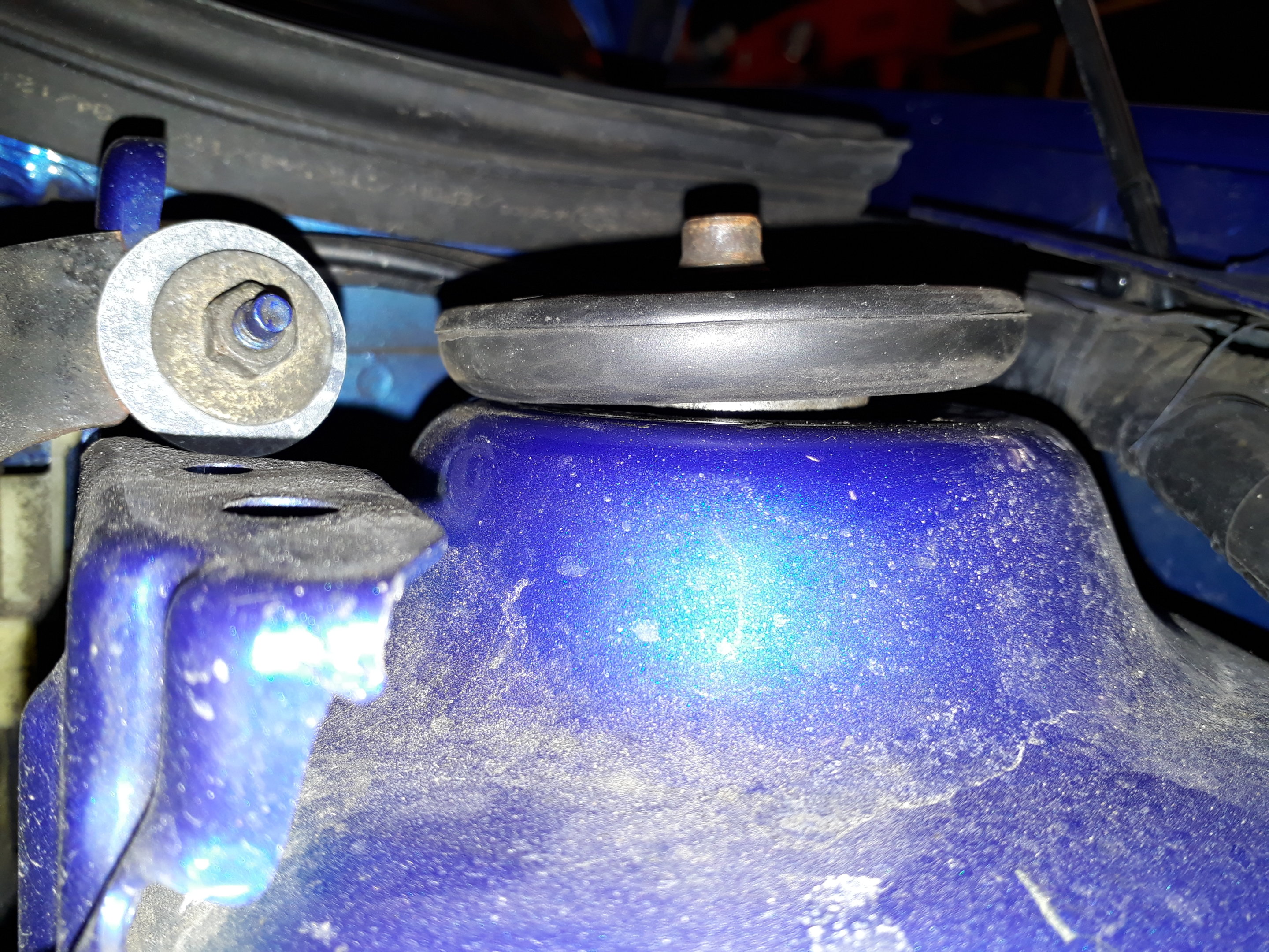

I've since had a check of the front suspension, and all fixings are tight and I can't find anything that moves or clunks. I have felt the suspension with someone going lock to lock and again cannot find anything untoward.
I have attached photographs of the top mounts and their position. I understand they are supposed to look slightly out of position, but as it's only on rapid rebound that it seems to happen I am wondering if it's a little bit of play between the top mount upper and the body?
(P.S. please excuse the dirty engine bay! The car is my daily driver and gets filthy very quickly)
