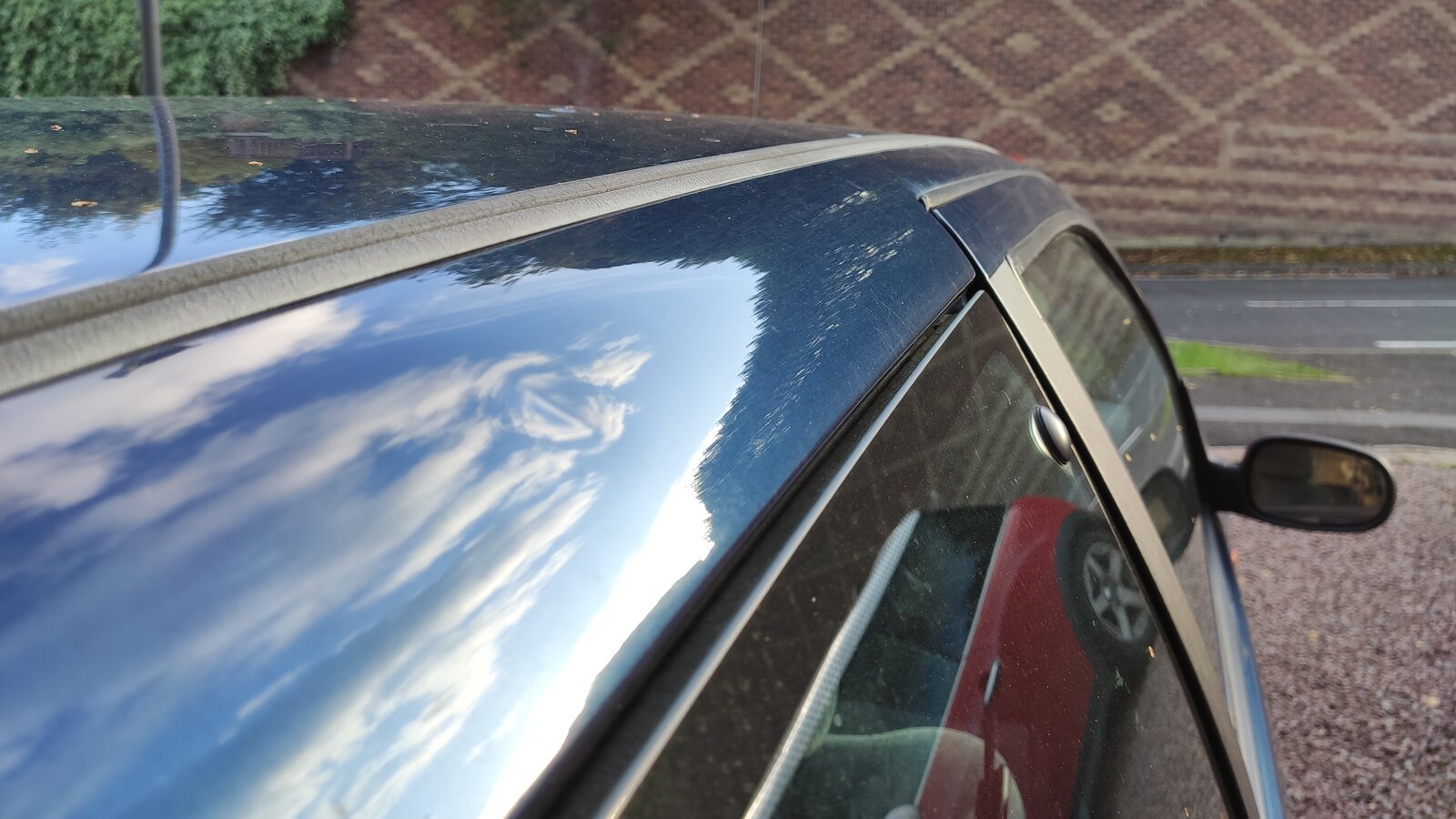

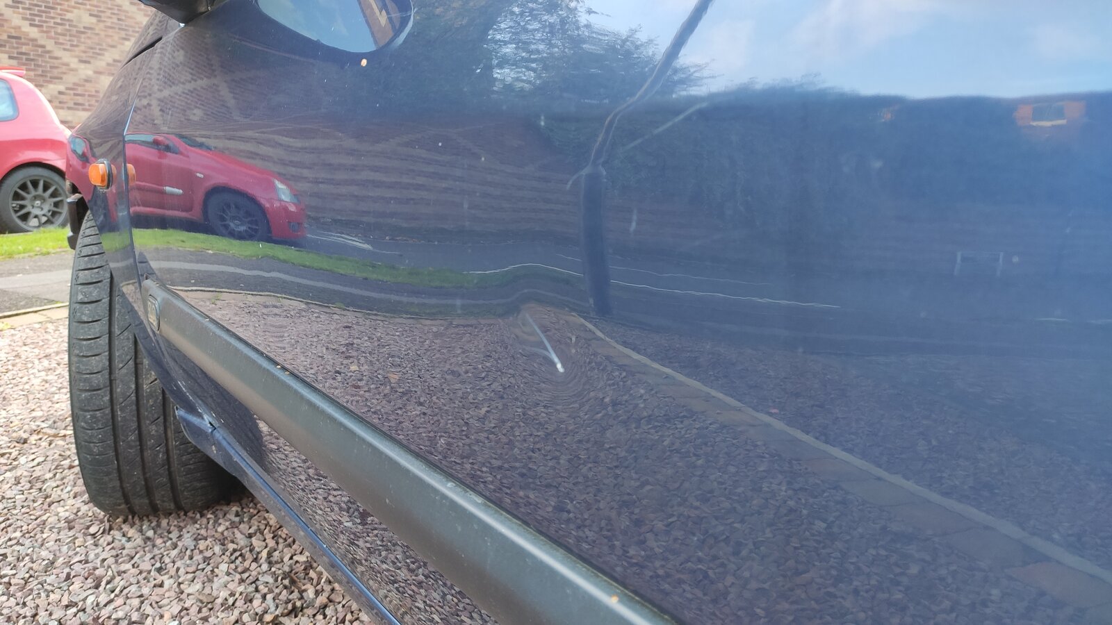

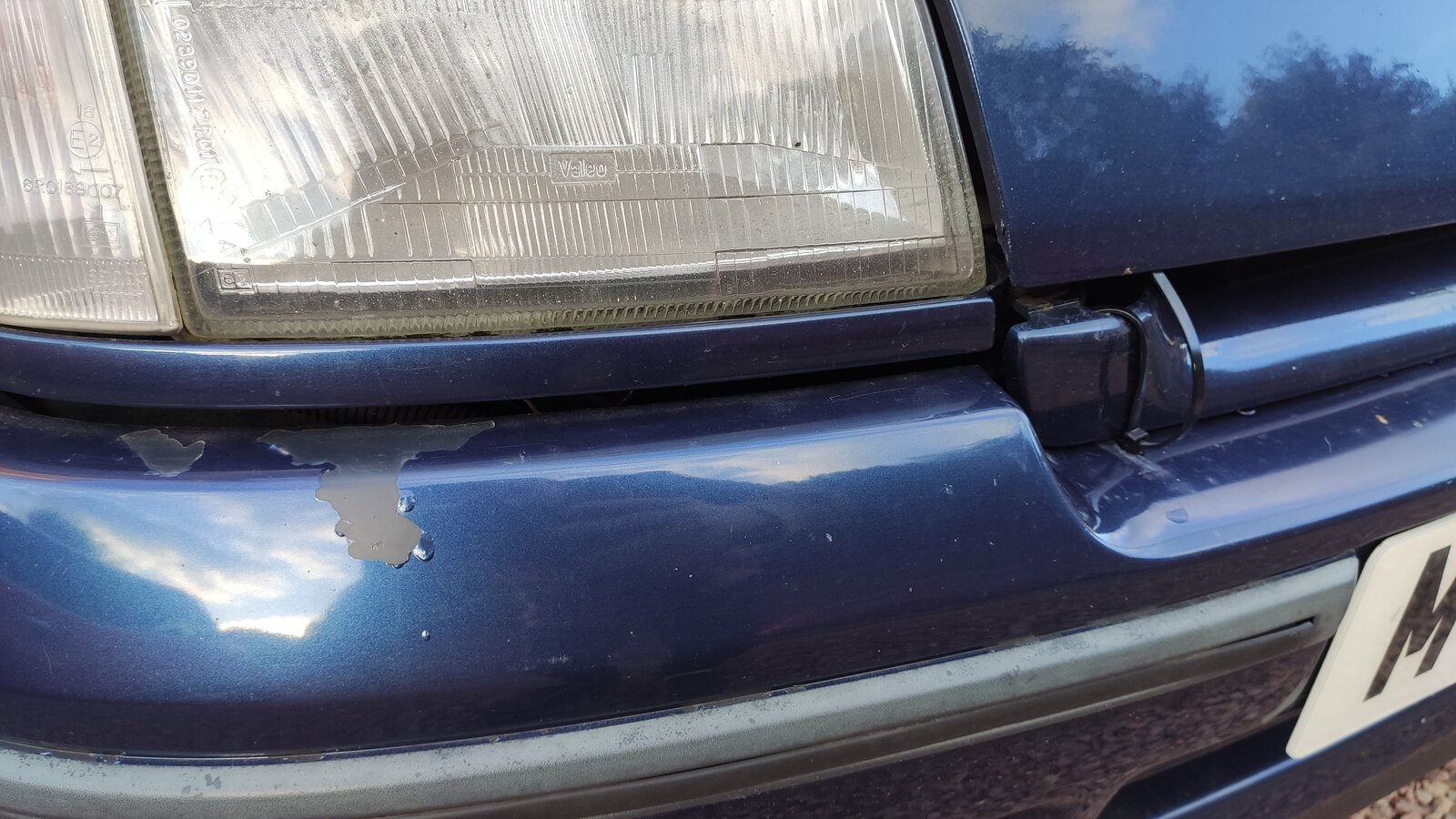

Time for some warts and all photos!
Starter motor on the Trophy failed last night, which will delay getting the Williams over to Floyd by a week since the Trophy gets used and has to take priority. Once it's back though the Williams will be going over to Floyd so he can have a look at it and start to formulate a long and short term plan. The suspension needs sorting immediately as it isn't really safe, but as soon as that's done I'll start driving the car and finding out what is and isn't working.
This post is a brutal assessment of what I already know needs work. As such it might seem a bit negative but in all honesty with what I paid for the car I am yet to find anything that terrifies me. Most of it is cosmetic stuff.

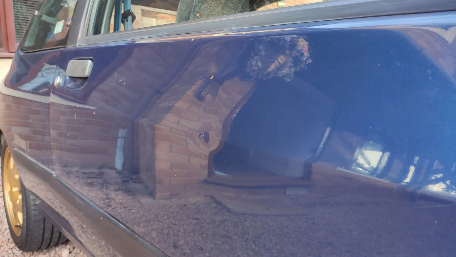

Firstly, some dings which will need pulling out:

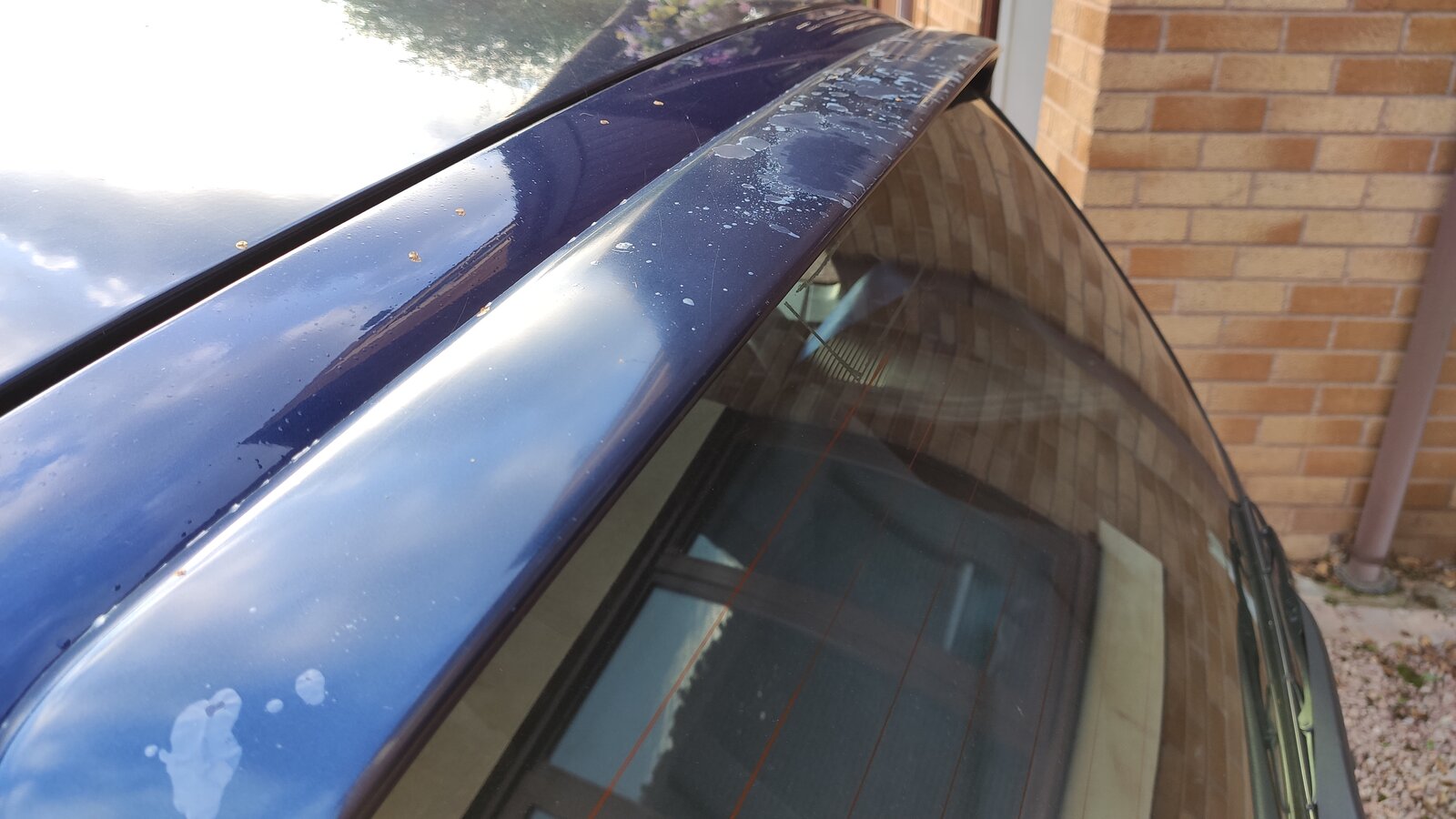

Then some delamination on plastic bits: (Note the cable tie securing the grill, the clip on one side has snapped).

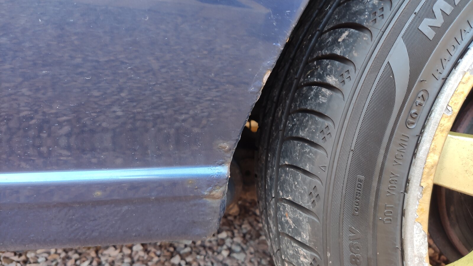

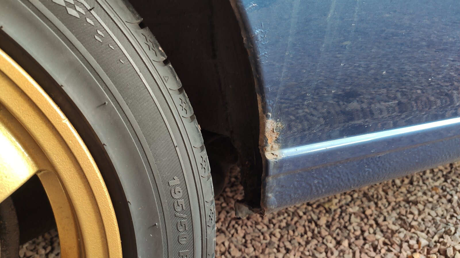

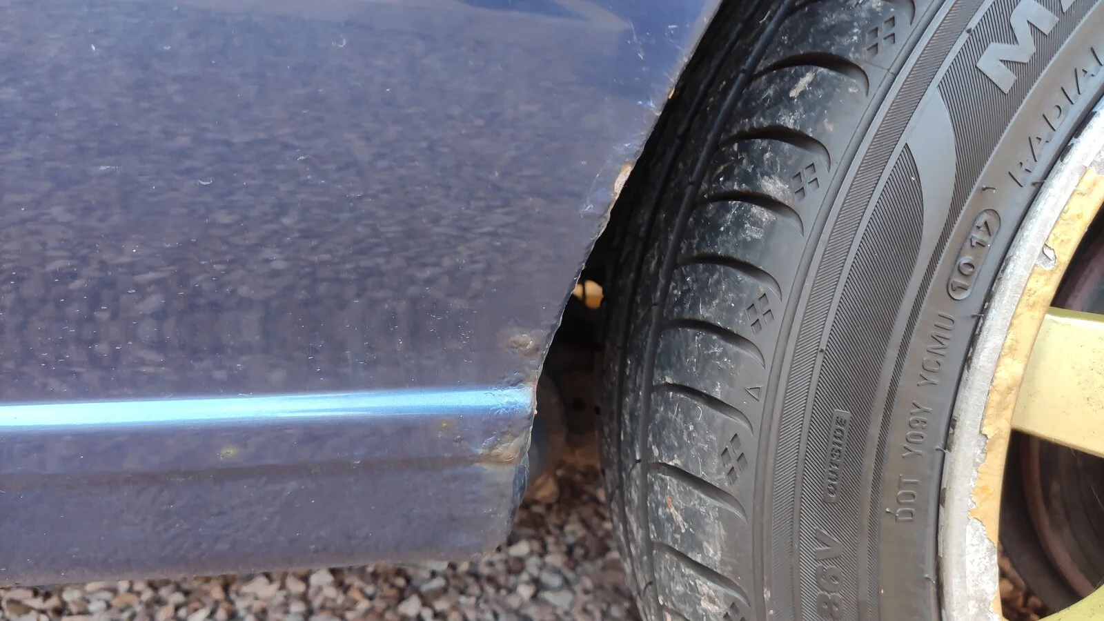

Then rust: (Also note the condition of the wheel).

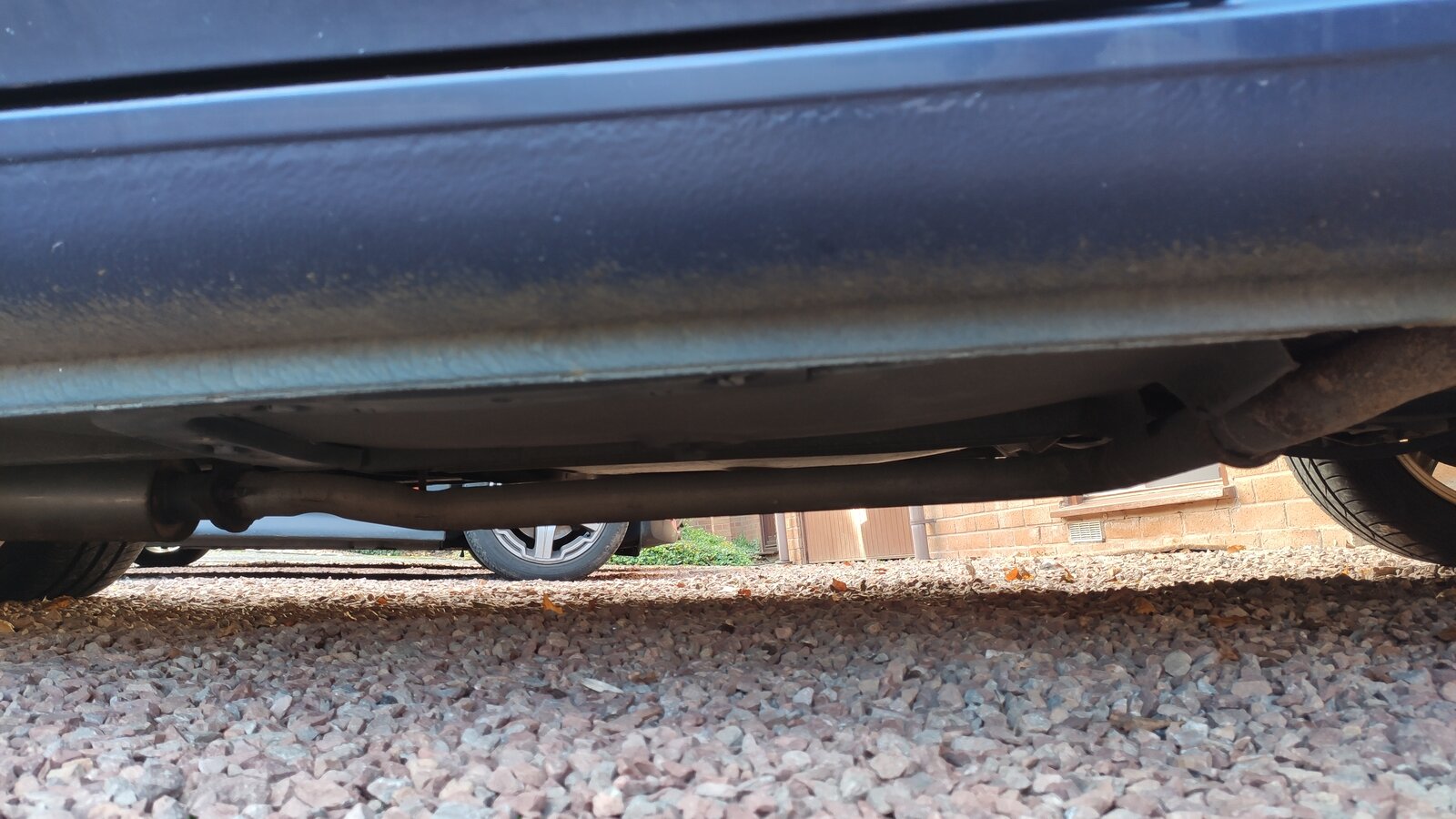

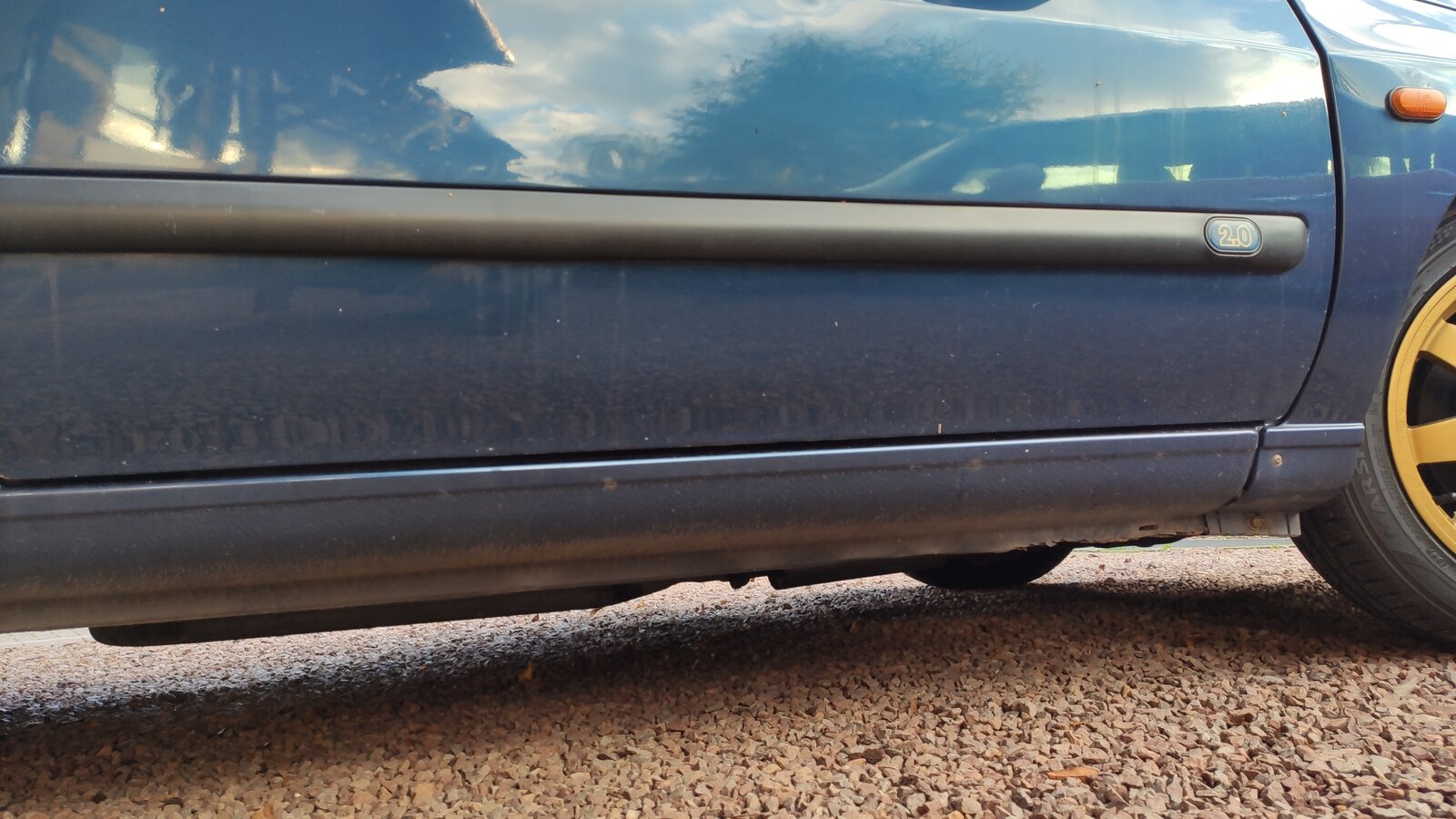

Picture of the sills on both sides:
In general the body is in better shape than I expected for a car of its age, but I expect I will be looking at a little bit of work to sort the rust. It might be possible to pollish the paint up and respray the delaminated bumpers and spoiler, but if an entire paint job is reasonable enough I might end up doing that.

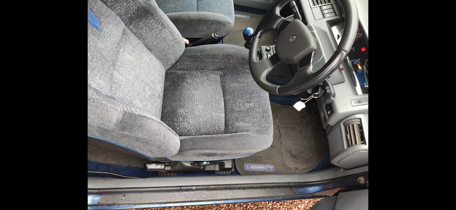

In terms of the mechanicals, nothing to report until Floyd has had a look, other than to say I've been starting it every day (much to all of my neighbours delight) and letting it run for a bit. It always fires up the second you turn the key. It hunts a little bit when cold but settles down to a nice even idle.
I've noticed that the oil level gauge works for the first few minutes and then gives up. The interior fan is either abysmal or just doesn't work, and the central locking and electric window on the passenger side doesn't work.

Hunting could be idle valve needing clean, common issue.
Oil level is fine that's what it is supposed to do, no point reading level when all the oil has been pumped up into the engine.
Fan usually it's plug to blower in scuttle that melts, so check that
Door issues if its both window and lock sounds like pinched wiring so check where loom comes out chassis into door.
Rust looks okay tbh, sills will want wire wheel back to metal though to assess fully and arches although not much there it's taken hold so chop out and new metal time to do it right
Overall though, decent purchase, loads of wiggle room in investment to sort it and still be in the money!
