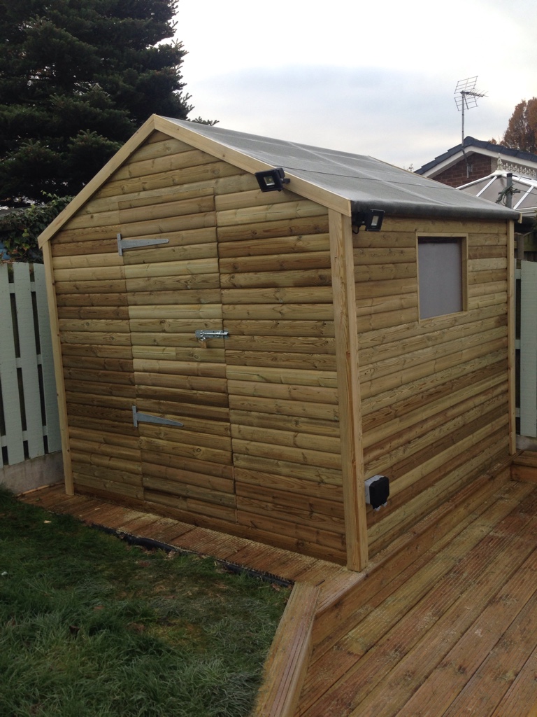

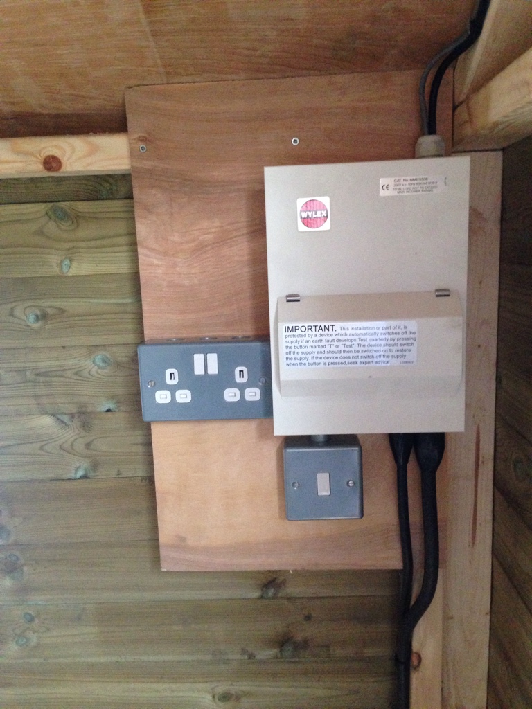

Been delayed by day to day stuff, work, family and garden shed building!

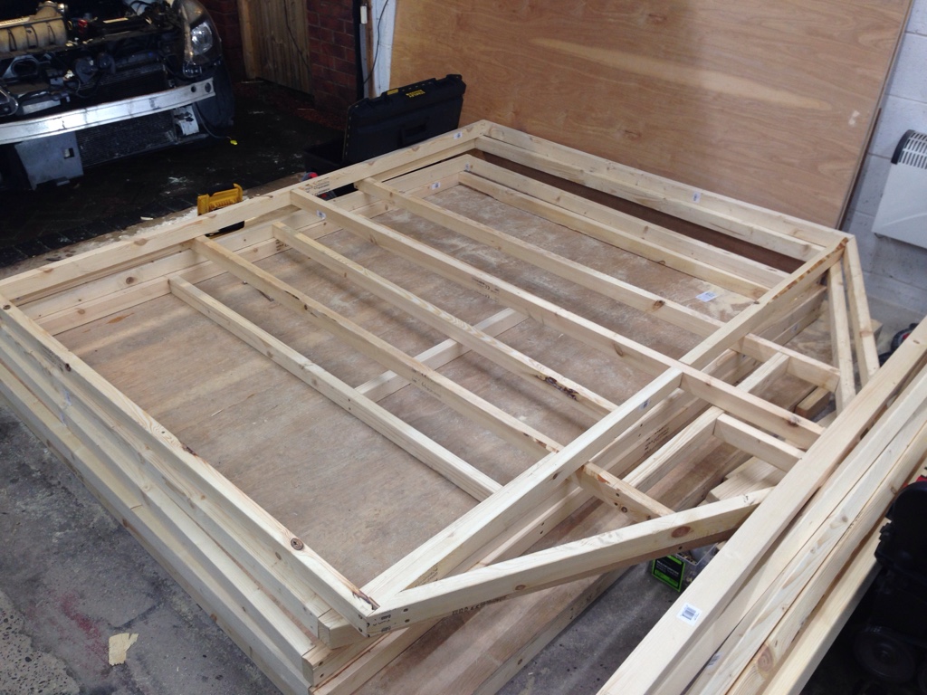

Sick of the garage being full of crap, lawn mowers etc so decided to build a new shed after being let down off a mate.
All the base and sides are done, just waiting on the cladding to finish it and put it up.

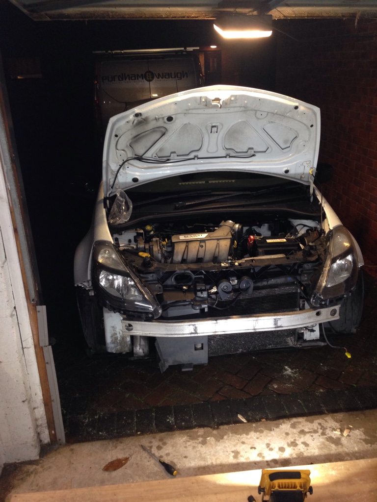

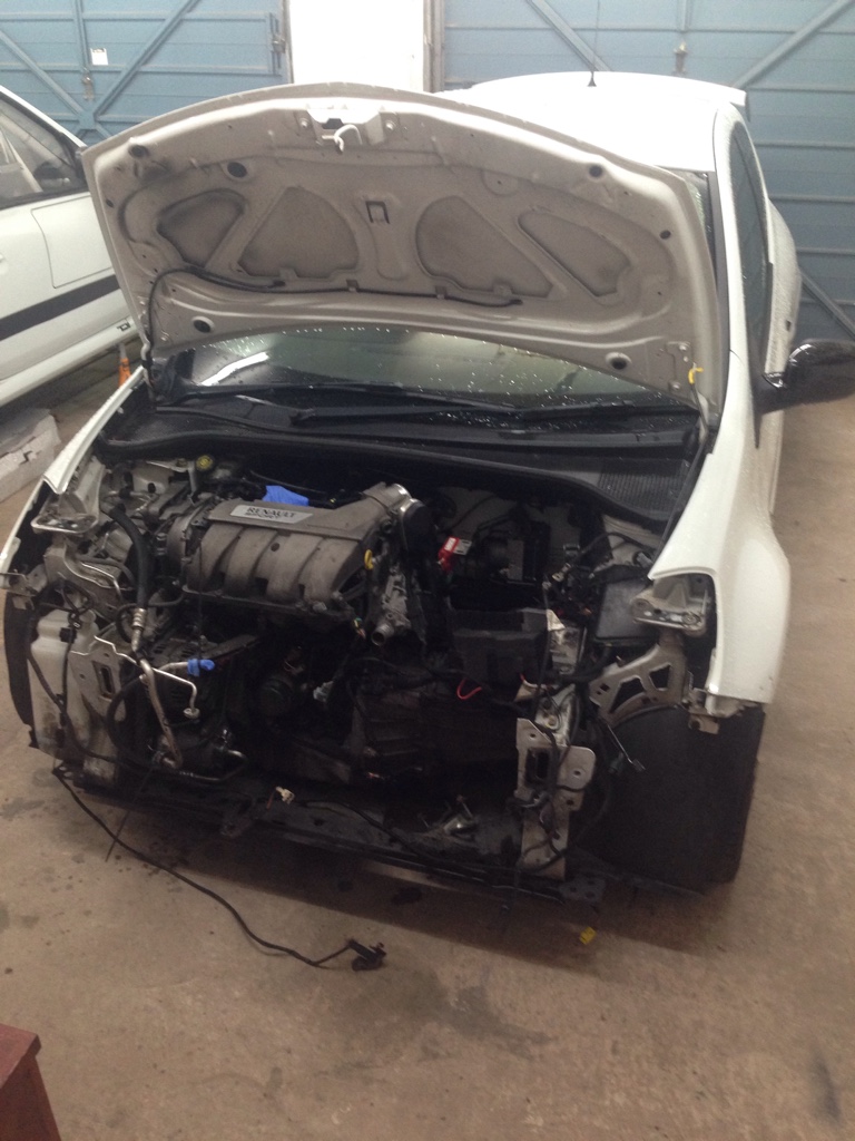

Have got a few more bits stripped off the Clio though. Front bumper, crash bar and front panel along with the rads and headlights.

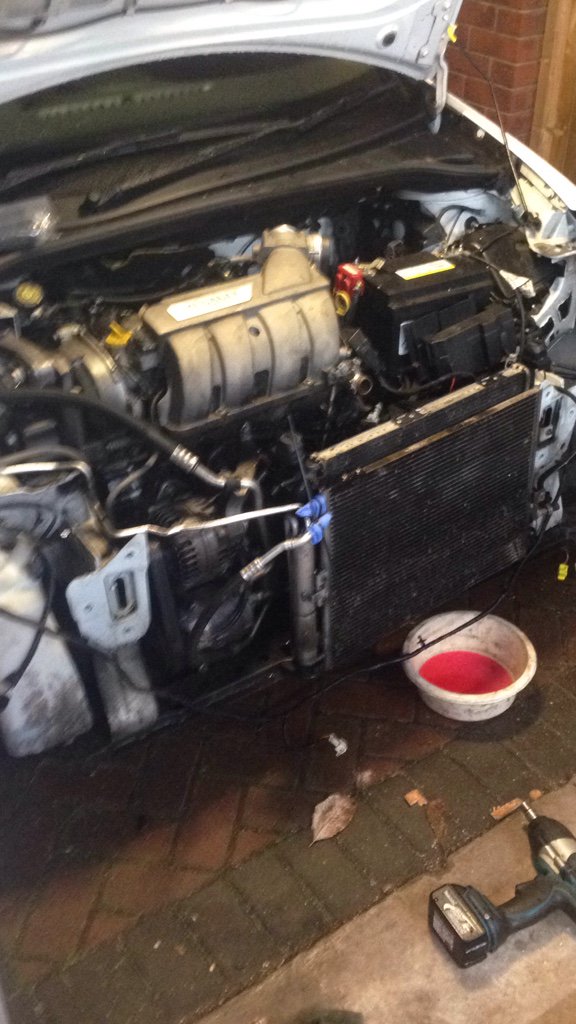

Having a bit of a crisis deciding what to do with the radiator and ac setup. I did want to keep the ac as it is a road car after all but the standard Clio rad is feeble when I've looked at it and I want a thicker core/alloy/megane rad (delete as appropriate!) so not sure if the ac rad can stay. Need to do some working out with that. Hopefully have the engine out this weekend.

After much deliberation I've decide to bin the AC off for the time being. Ordered an updated alloy megane radiator + fan. Also ordered an AC delete bracket and pulley from Nick @ Pure Motorsport.
The ecu is unlocked and on its way back so I'm only short of a radiator top hose, some boost pipes, air filter and maybe a couple of vac hoses.

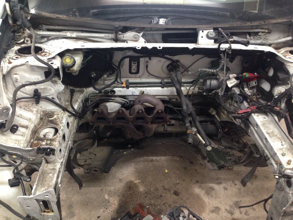

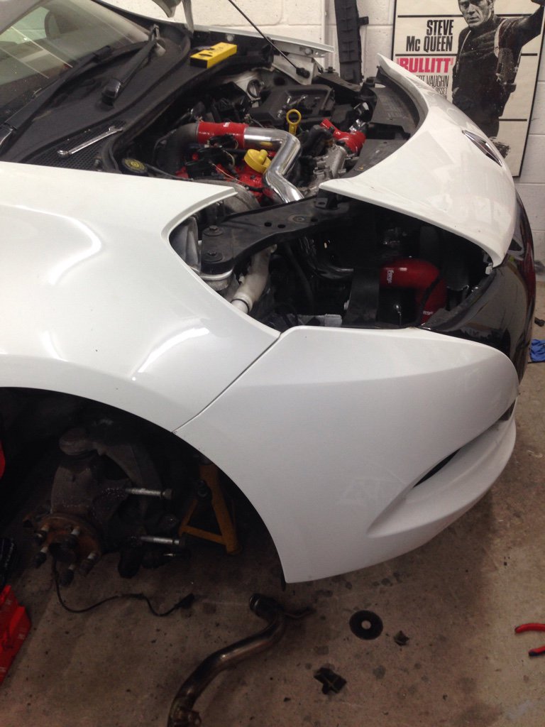

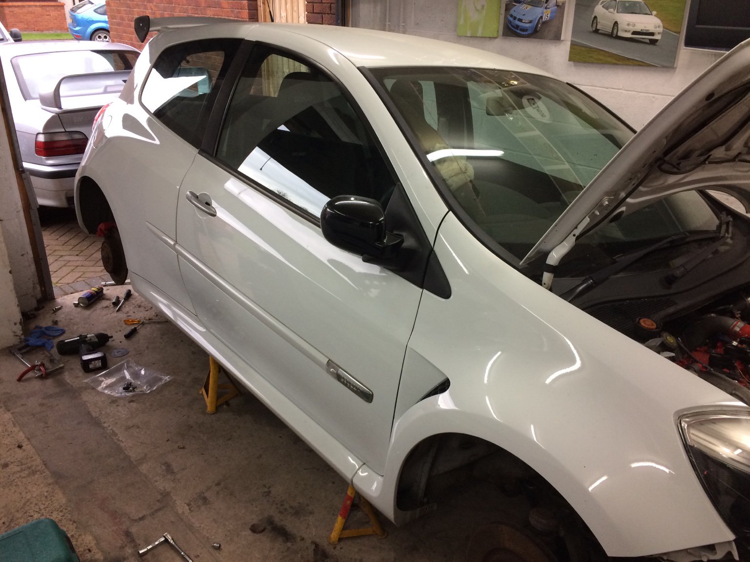

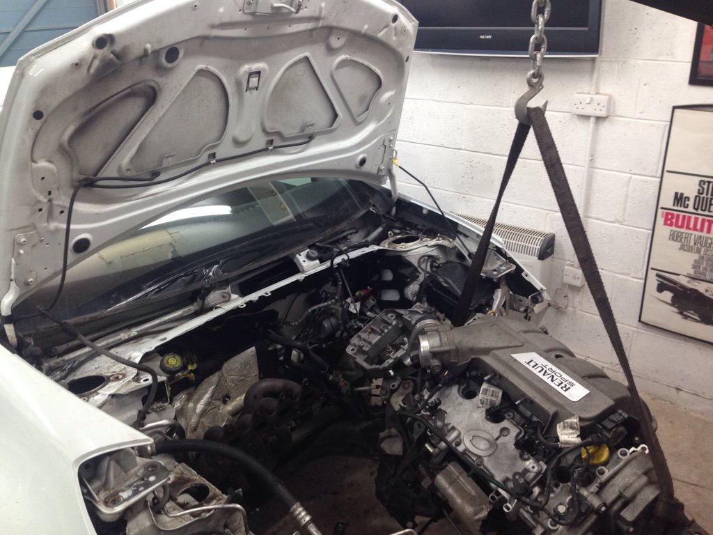

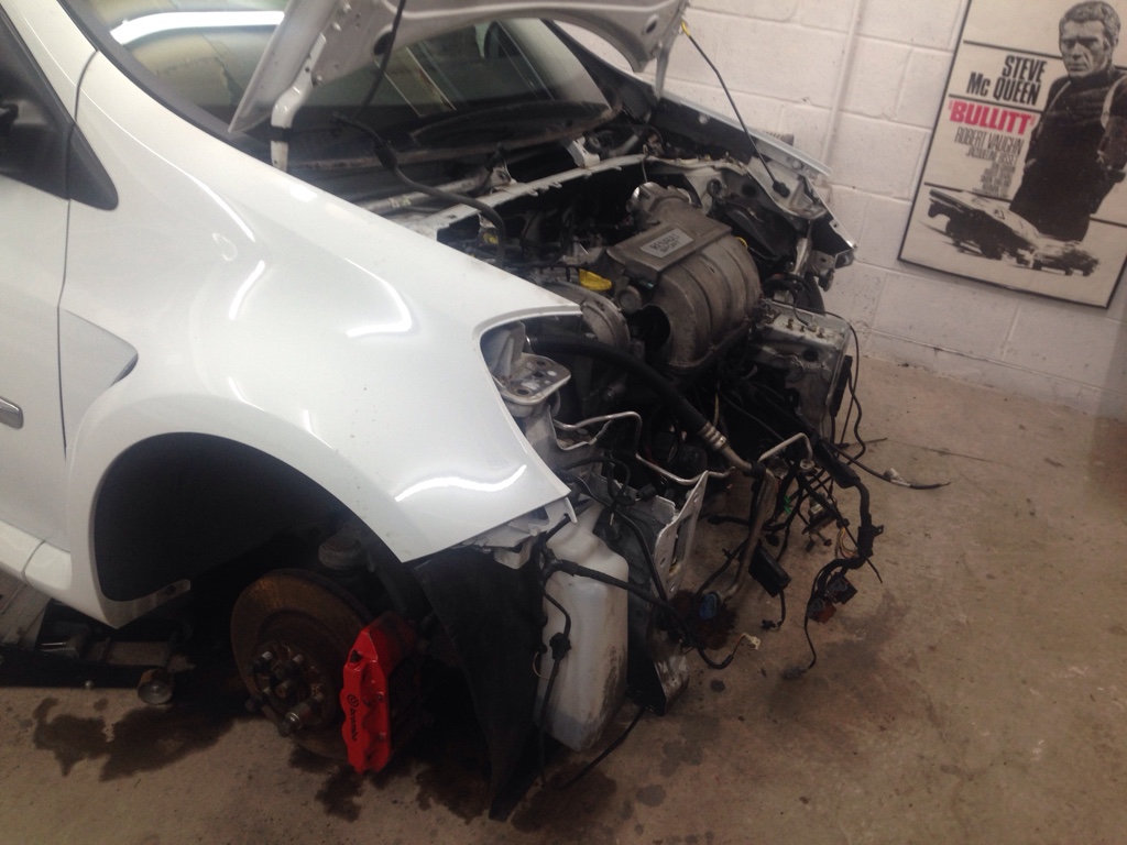

Engine is out! Pulled both front struts/hubs out as well to change springs, links and some bushes.
Pulled the AC pipes out of the engine bay too. Need to get the exhaust off and manifold out tomorrow and get the meg engine attached to its gearbox ready to drop back in.

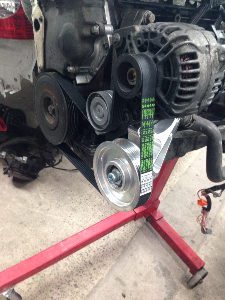

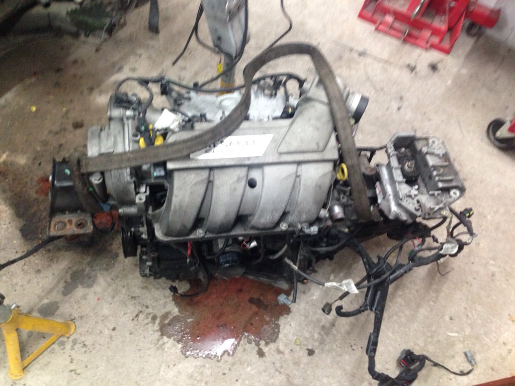

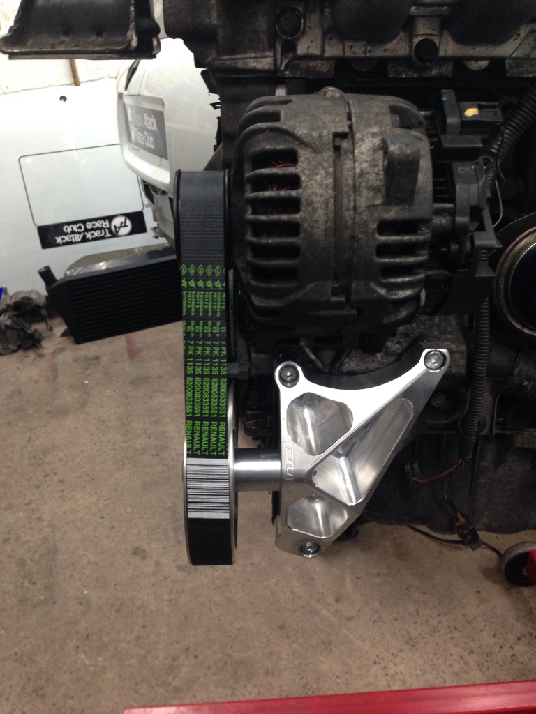

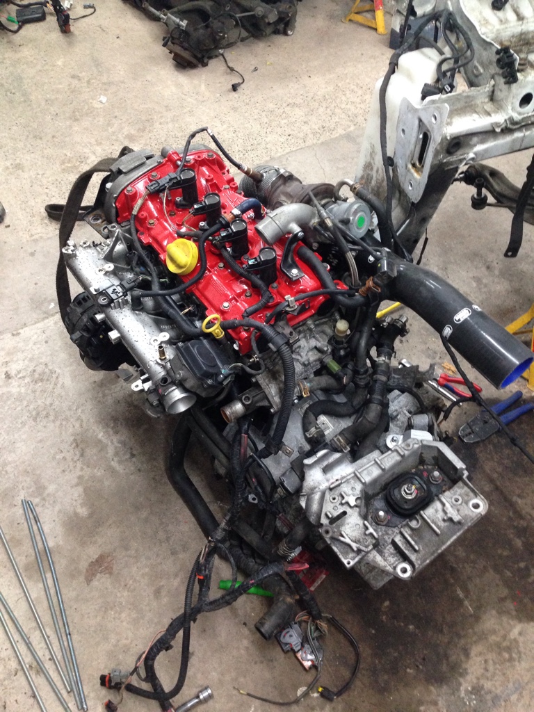

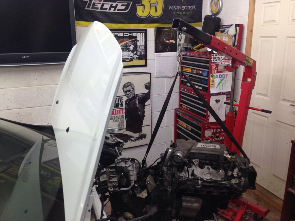

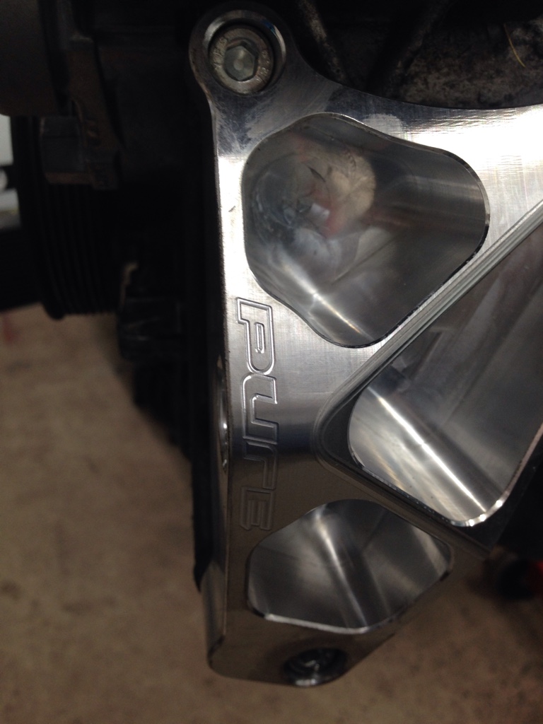

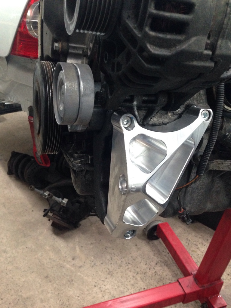

Clio engine is out, ancillaries and mounts swapped to Megane engine. Some shiny bits added along the way, Pure Motorsport AC delete kit is on along with new belt and tensioner obviously.

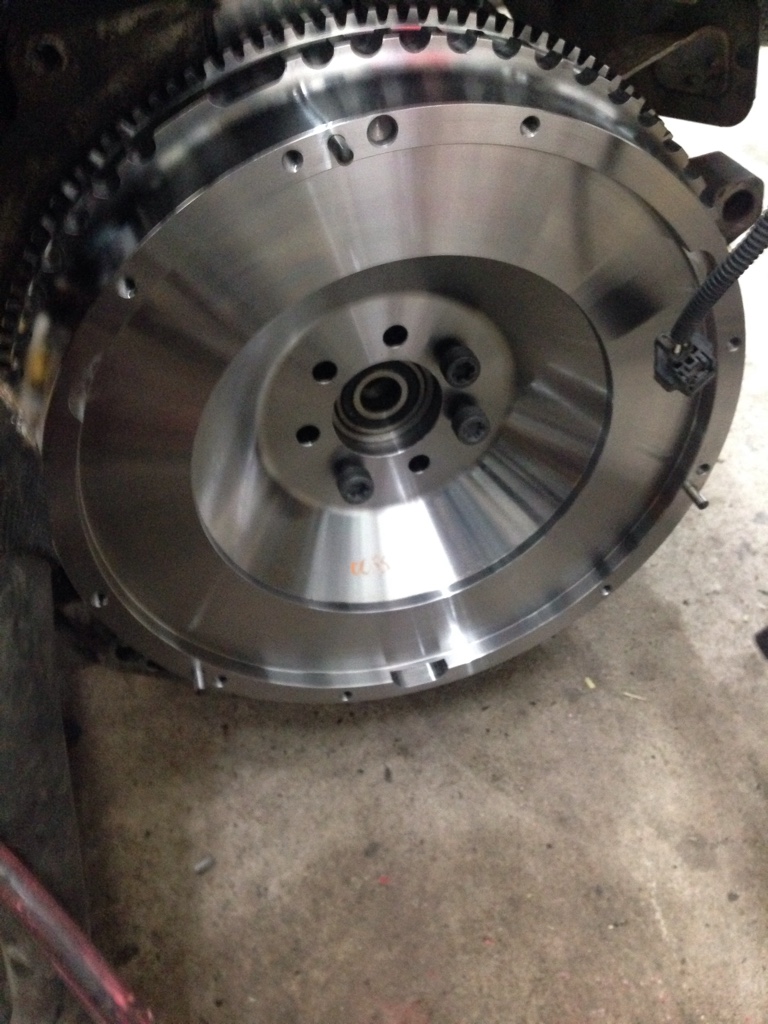

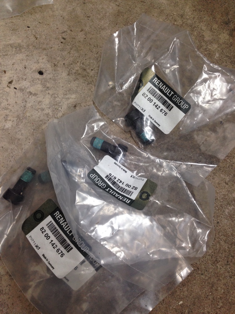

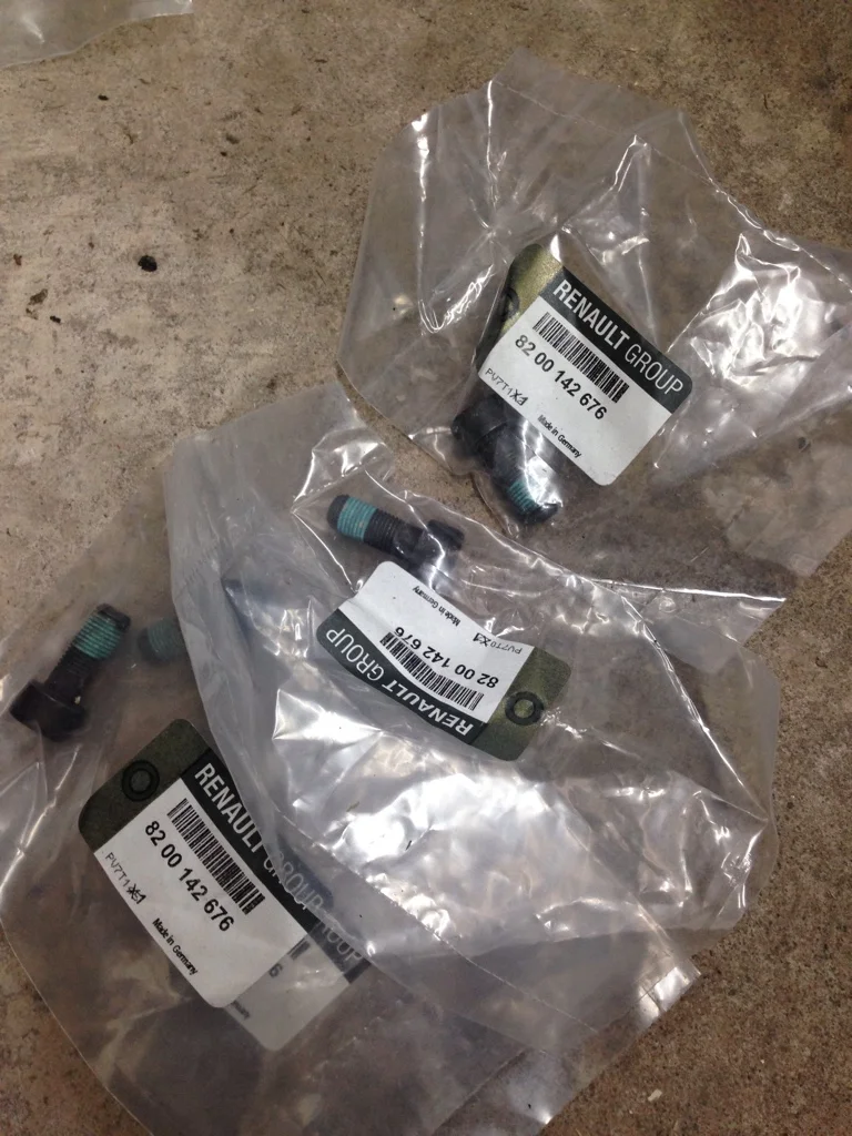

Lightweight Single mass flywheel and R26.r clutch fitted with all new bolts and slave cylinder.
Gearbox on, mount on and all sensors connected.

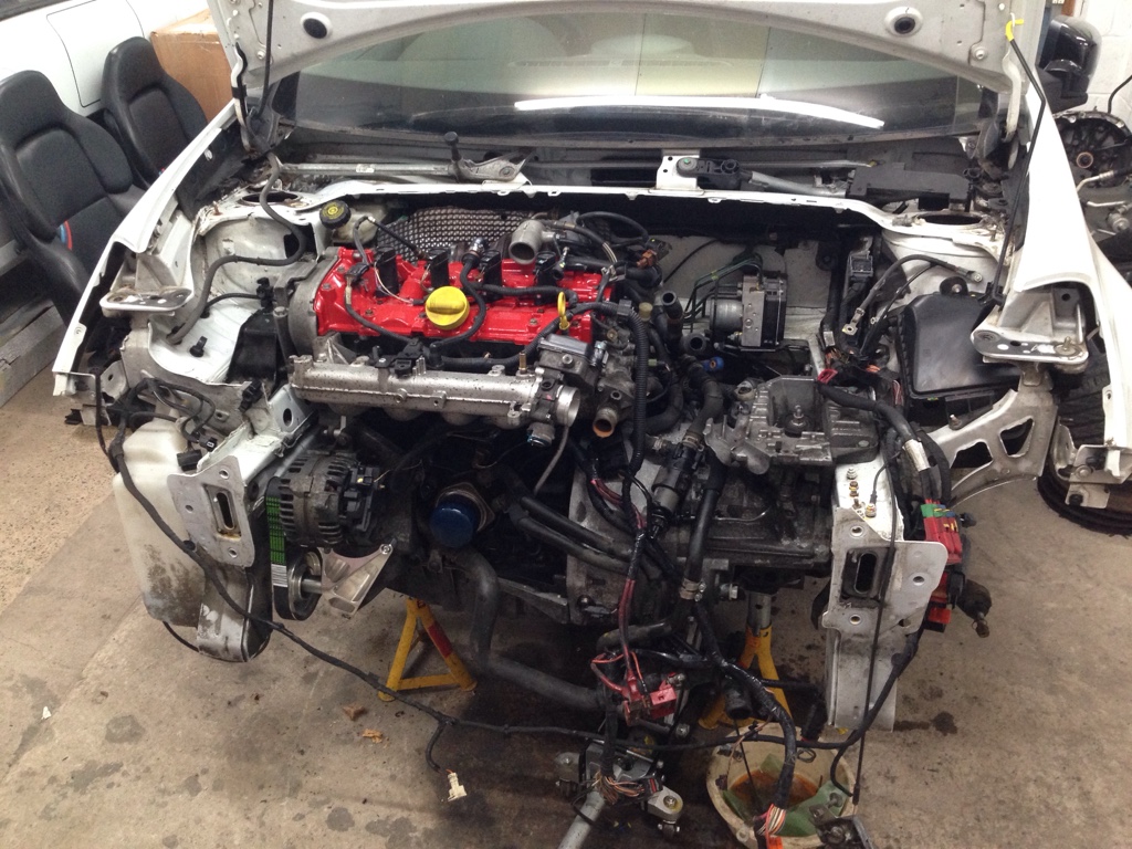

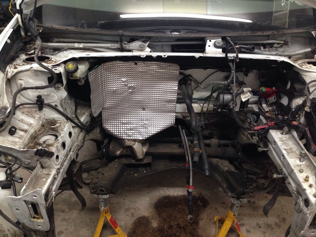

Rest of the bits stripped out of the engine bay, manifold and AC pipes mainly. Also the oe fibre sound proofing/insulation has gone and some Nimbus put in its place. It came off the race car so excuse the dents!

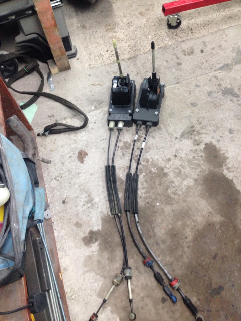

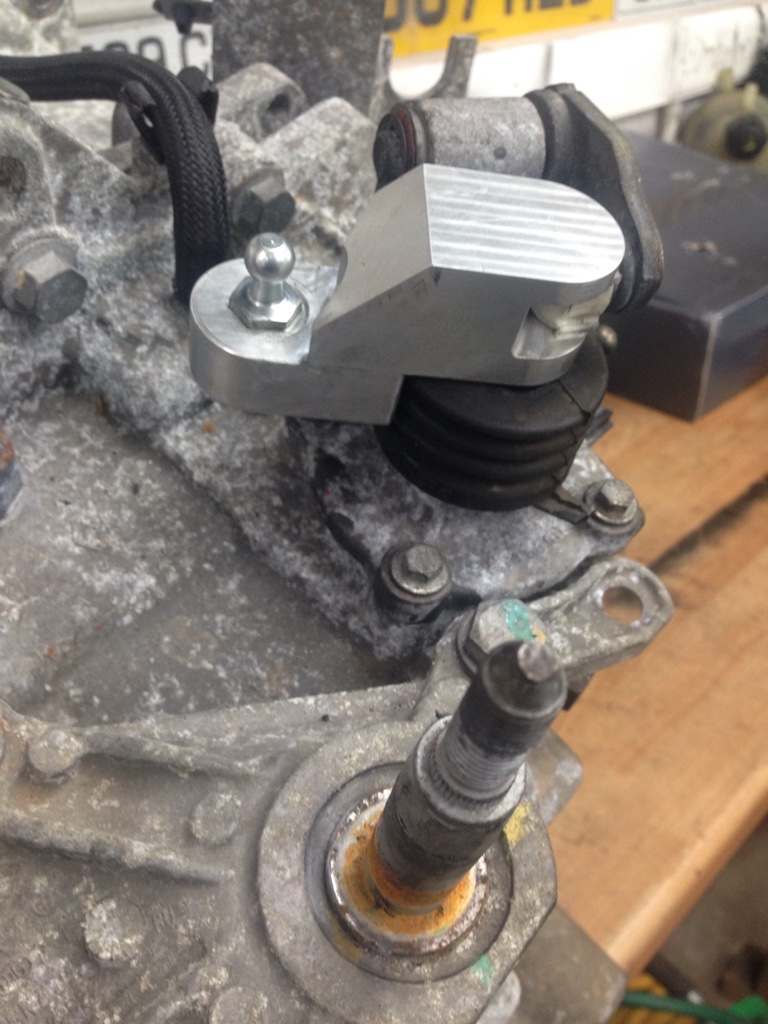

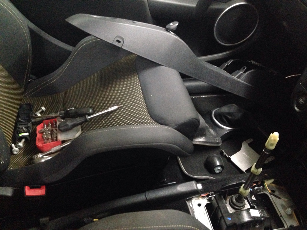

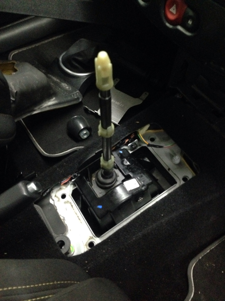

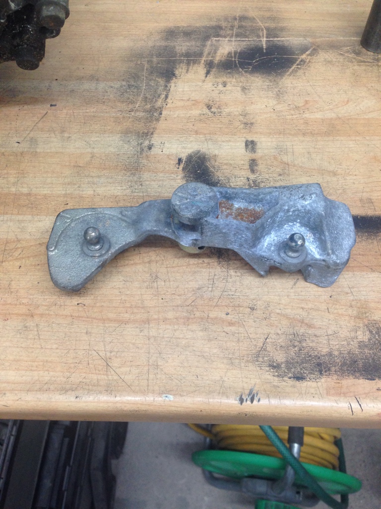

In addition to this I had to swap the shifter mechanism for the Megane one as the gear pattern is different. Meant console etc out, heat sheilds off.
Russ Rallye
The 2 shifter units together with cables, straight swap.
All finished and back together, excuse the tatty Megane gear knob, need to order a new one.

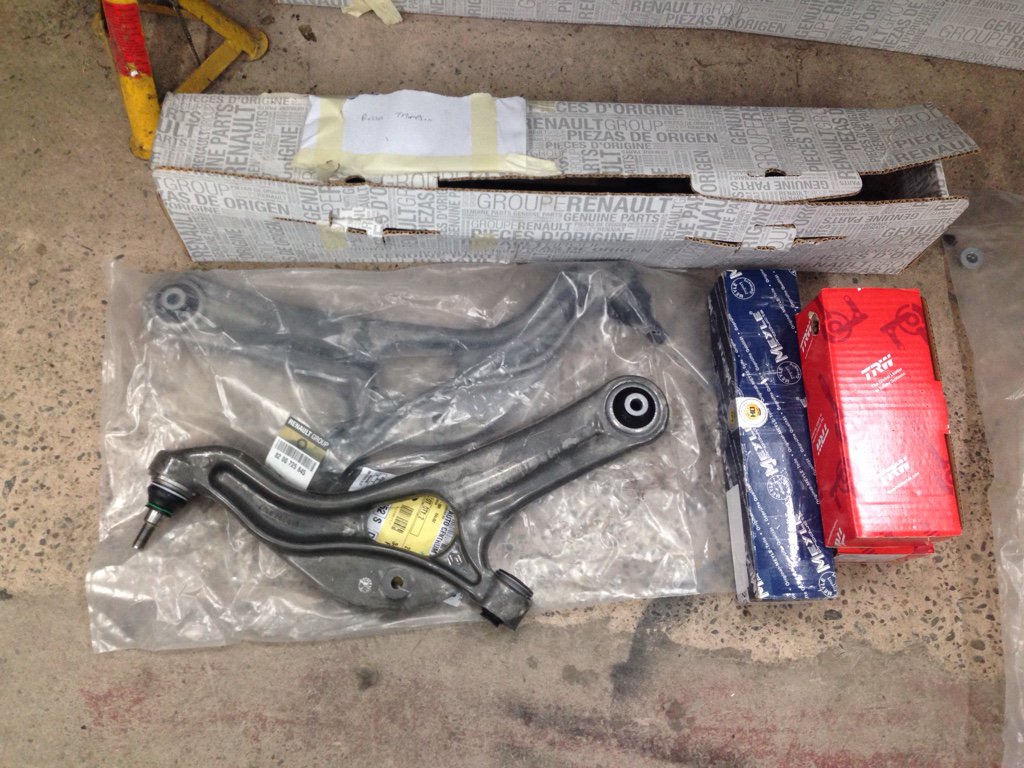

That's it upto date, hopefully get it fitted tomorrow. New alloy R26 rad is here, boost pipes are on order along with the bits to refresh the front suspension, top mounts, wishbones, drop links and anti rotation links. Need some front discs and pads + an exhaust but it's financially ruining me, whatever anyone tells you, this is not a cheap conversion if you do it right and I could of spent far more as well!

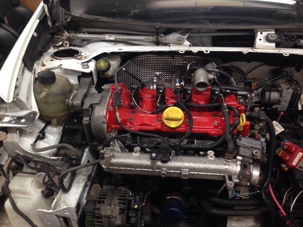

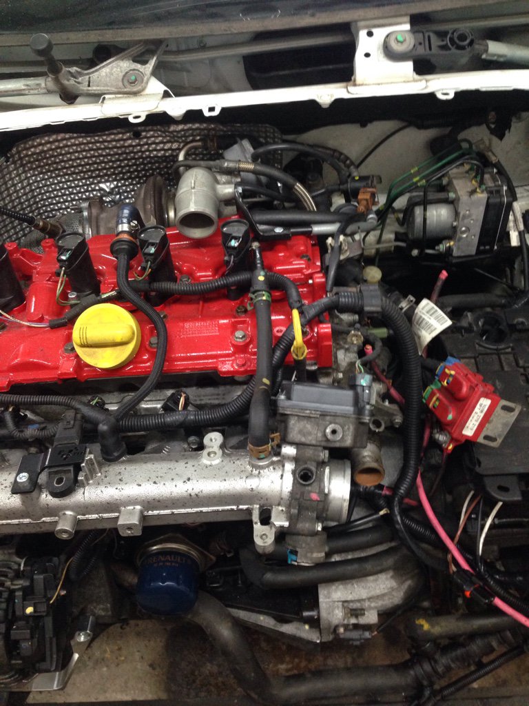

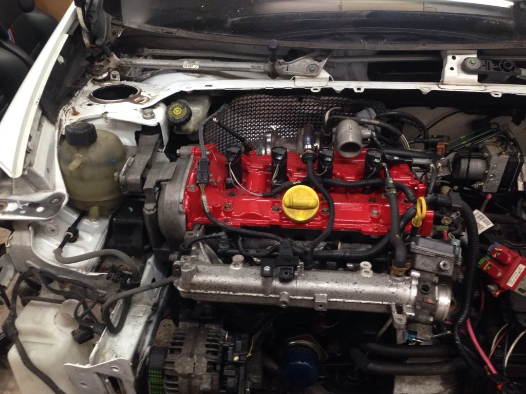

Well the engine is in.
That was the easy but really! All mounts back on, just using standard rubber mountings to try and and keep it nice on the road. Fuel line connected, coolant lines to heater matrix done, shifter cables on, need a Clip for one however.
Clutch pipe is connected but not sure I'm massively happy with it as it's extremely tight on that side now with the megane gearbox.
Chucked the front lower cross member on to have a look at how the megane rad will fit as its a fair bit bigger, might need to make some brackets or drop the cross member down a bit.

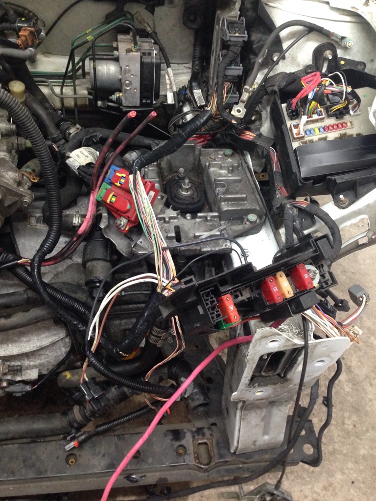

Got all the wiring to do tonight and get the battery box etc back in. The wiring isn't particularly difficult but trying to get it looking oe and tidy is the bigger challenge hence why it's stripped down quite a bit.

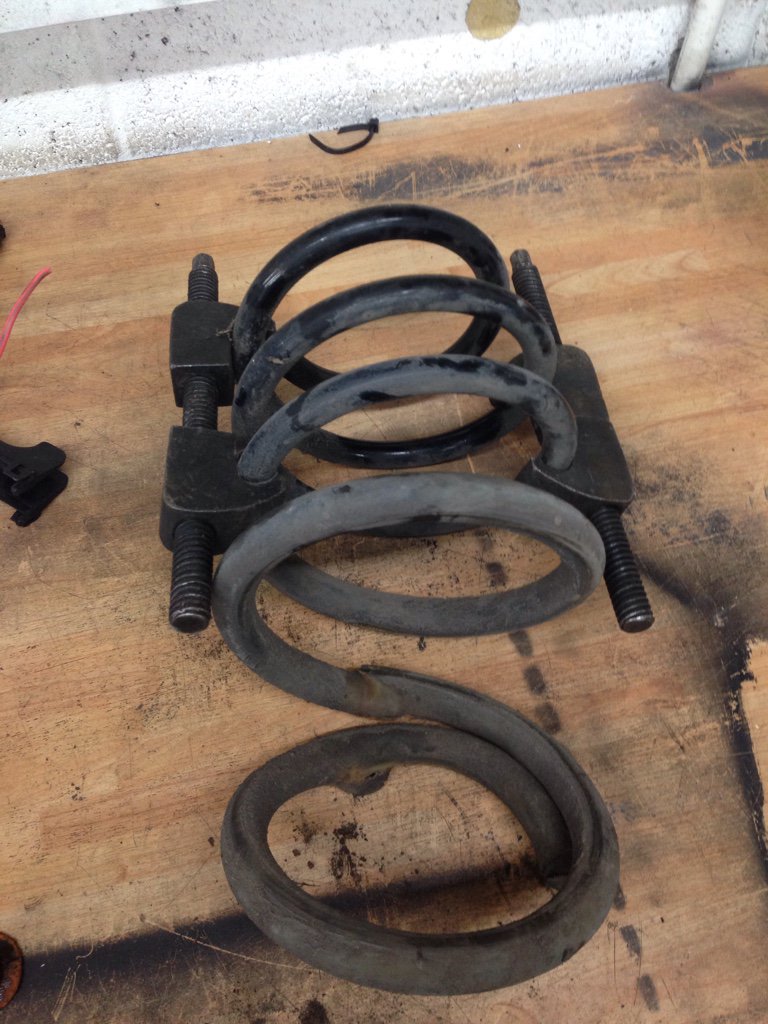

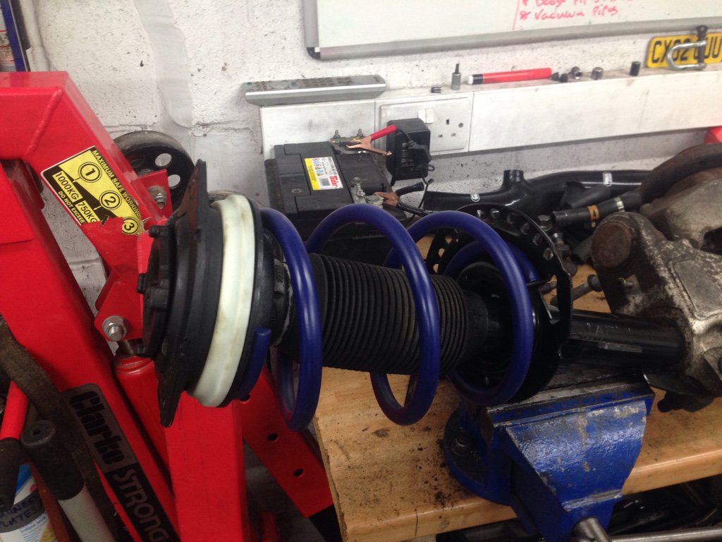

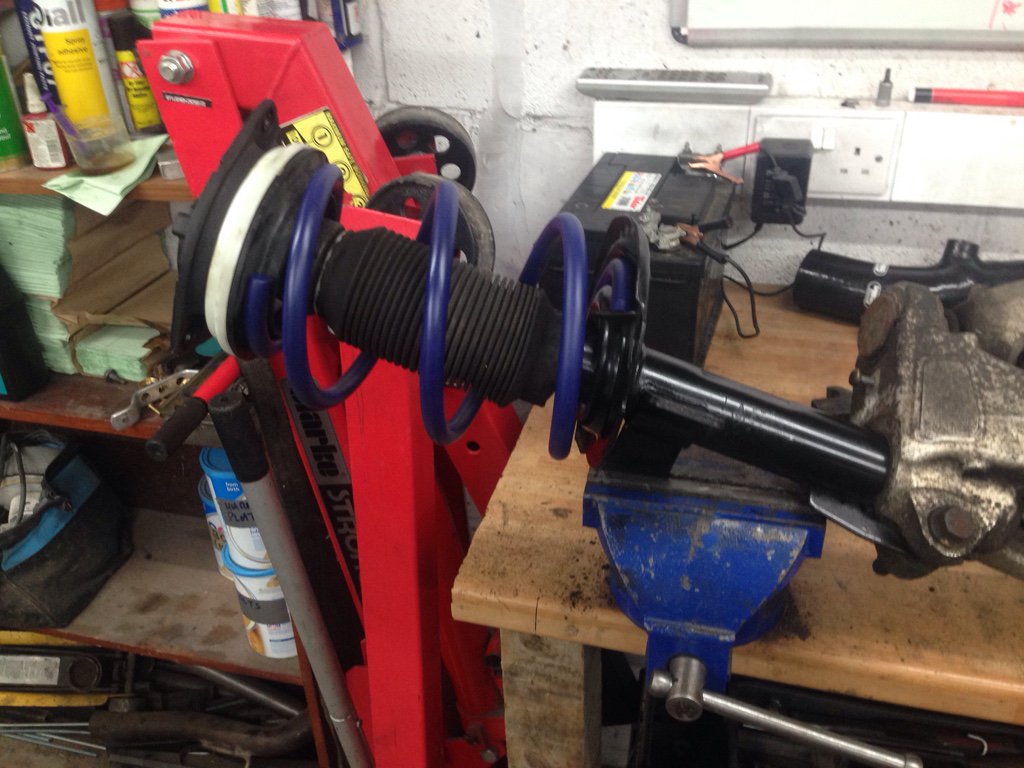

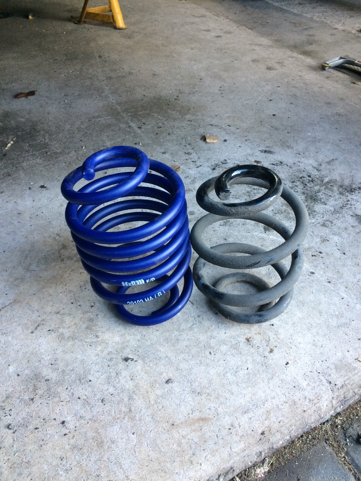

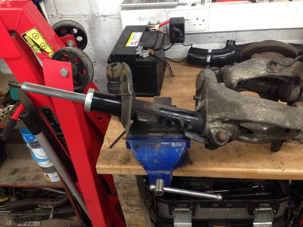

Couldn't be bothered to do any wiring tonight so put my H&R springs on my front struts. As you can see above the drivers side spring has snapped in 2 places at the bottom.
Gave it a clean up and refitted new spring and new top mount and bearing.
Got them put back on the car so at least I can put the shafts back in tomorrow and hopefully the new bottom arms and links won't be far away.

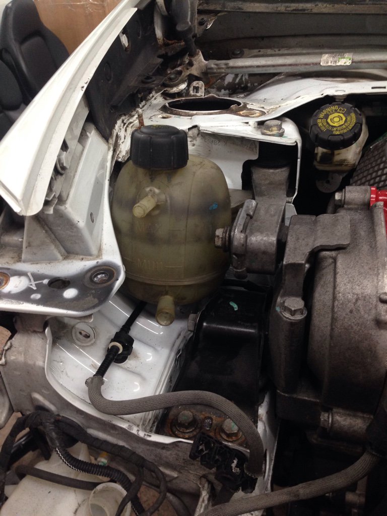

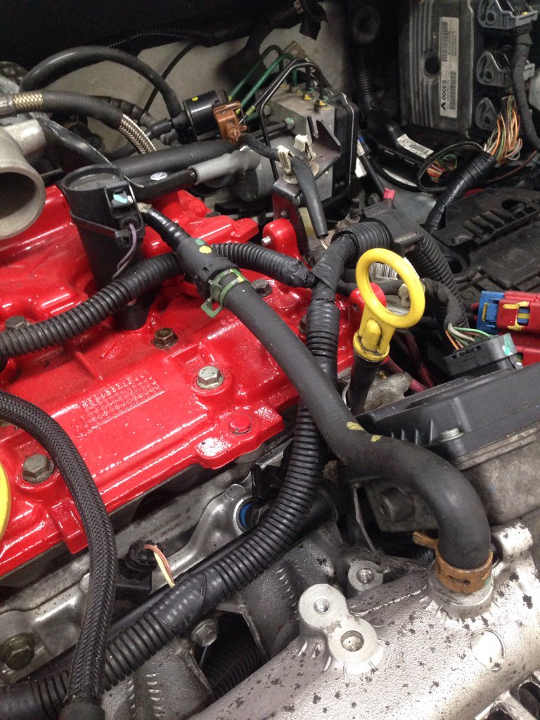

Rest of the evening has been sober messing around with the little bits. Had a trial fit of the battery box so I know what's going on there. Modified the servo vacuum feed pipe.
Finally got the header tank fitted as well. There's no room for the standard 200 one with boost pipes in the way so most people either relocate it behind the battery box which leaves even less space for an air filter or others have said about a 172/182 one on the drivers side inner wing. It's extremely tight and ive had to trim and p1ss about to get it to fit with the standard engine mounting and also so the bonnet shuts. It's fine now just need to clean the tank up as it was just a spare one I had laying around.

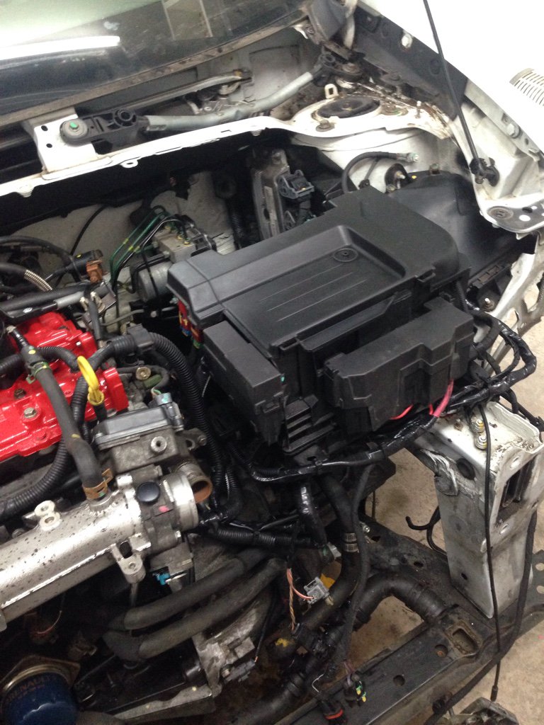

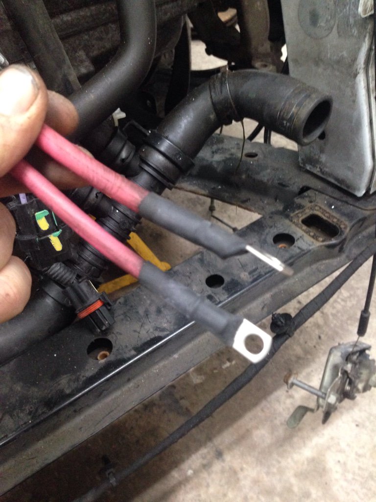

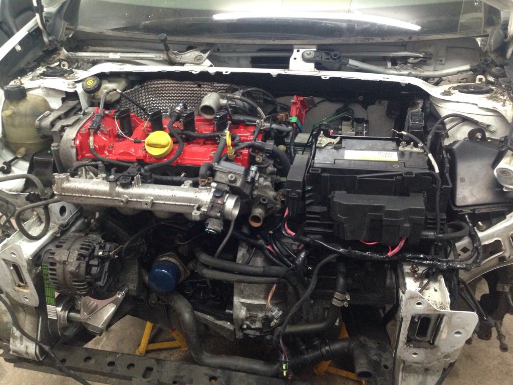

We're getting there, albeit slowly, I'm flat out at work and I've pulled something in my arm and it's really bugging me! Anyway!

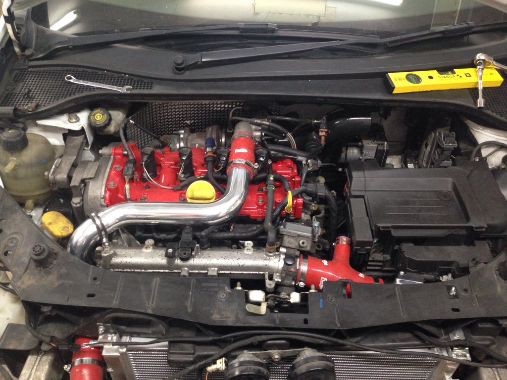

Got all the wiring finished
And the battery/box back in

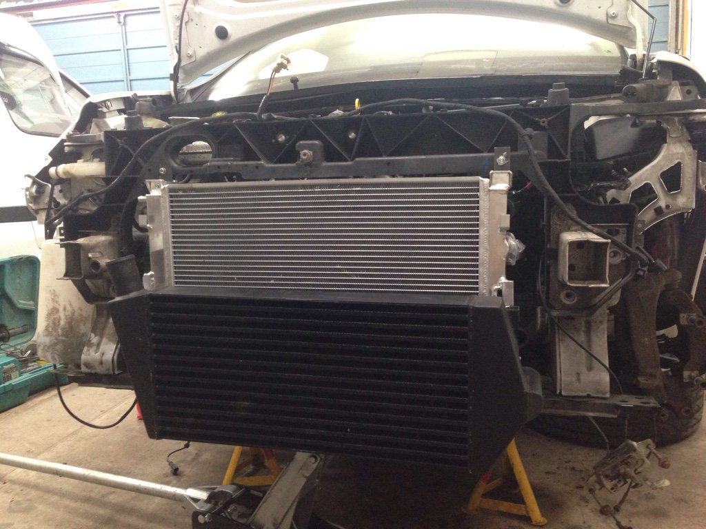

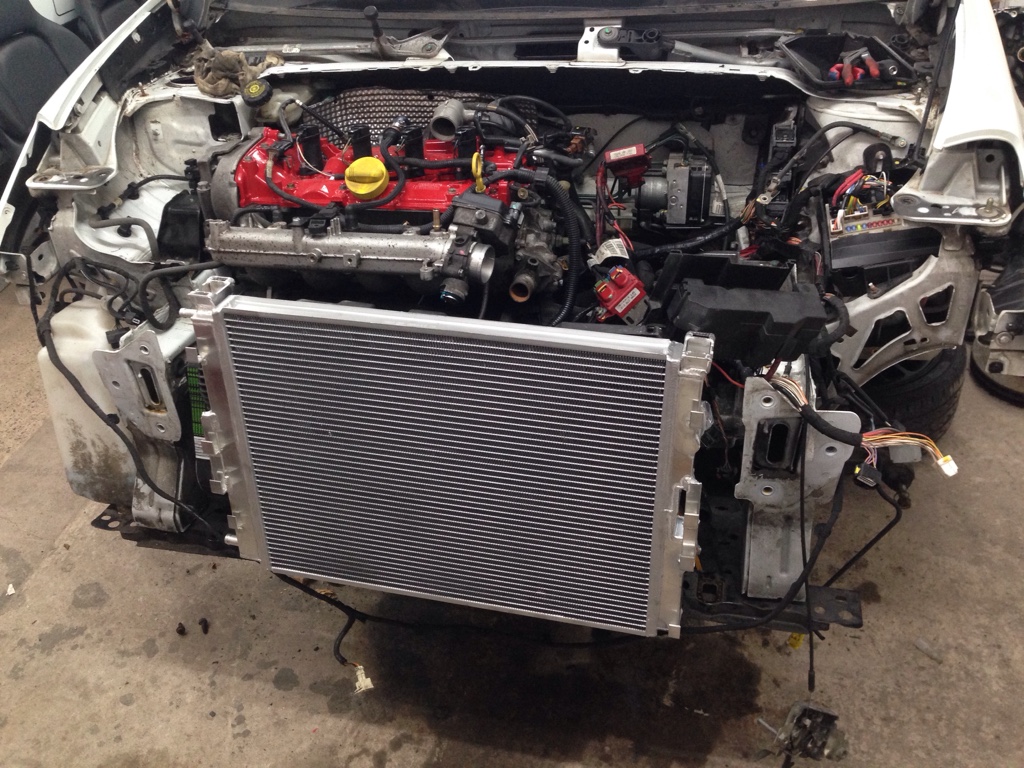

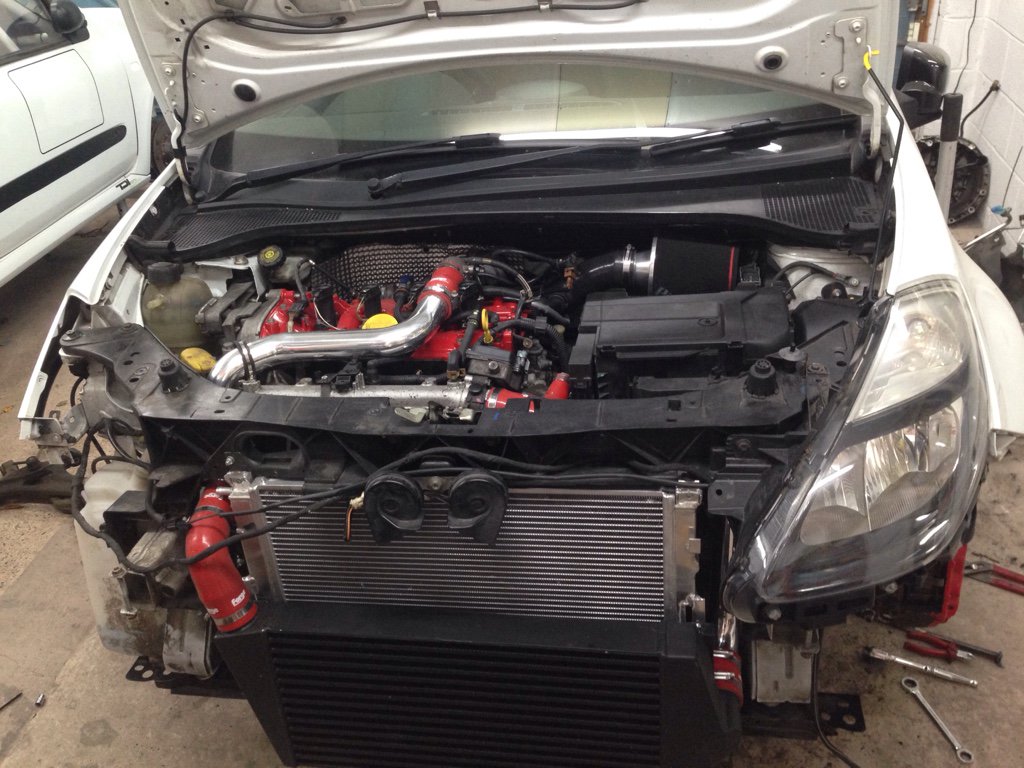

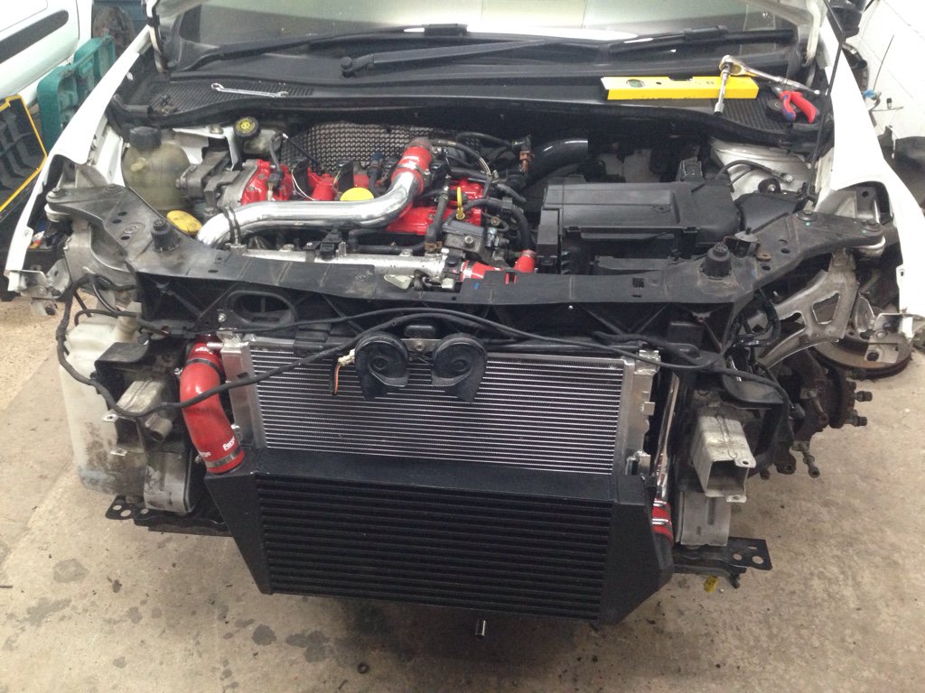

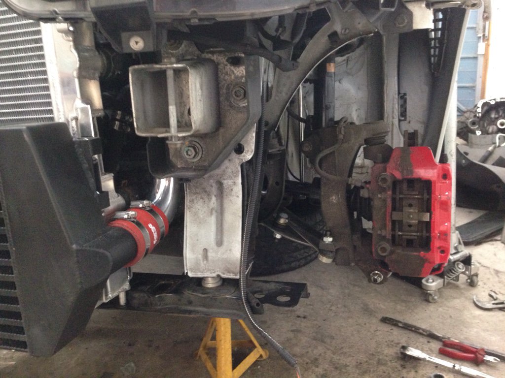

Had 2 goes at getting the rad and cooler mounted due it being a lot bigger than the oe Clio rad.
Take 1.
Didn't like it like that, as the bumper didn't fit and the alloy cross member didn't really fit either without being butchered so decided to trim the plastic slam panel back to get the rad higher and further back. Lower crossmember is modified too and brackets made up, real pain of a job and I'm not 100% happy with it so will come back to it once it's up and running.
Take 2.

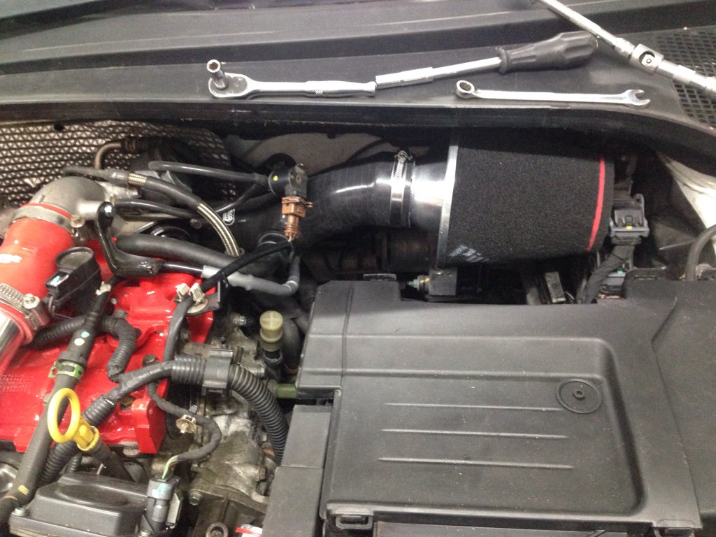

Better, everything just about fits now. Got the cooler on and boost pipes fitted along with the air filter too. It's all a tight fit in there now.

Brand new wishbones, arb drop links, anti rotation links and Megane driveshafts.

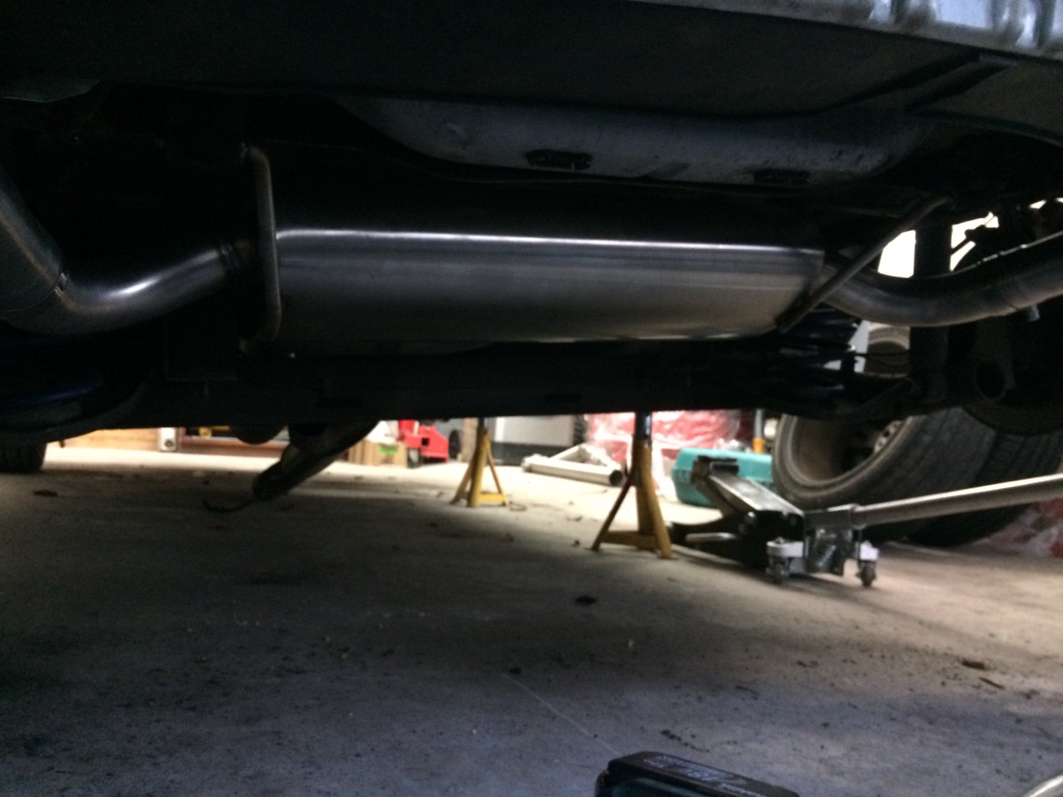

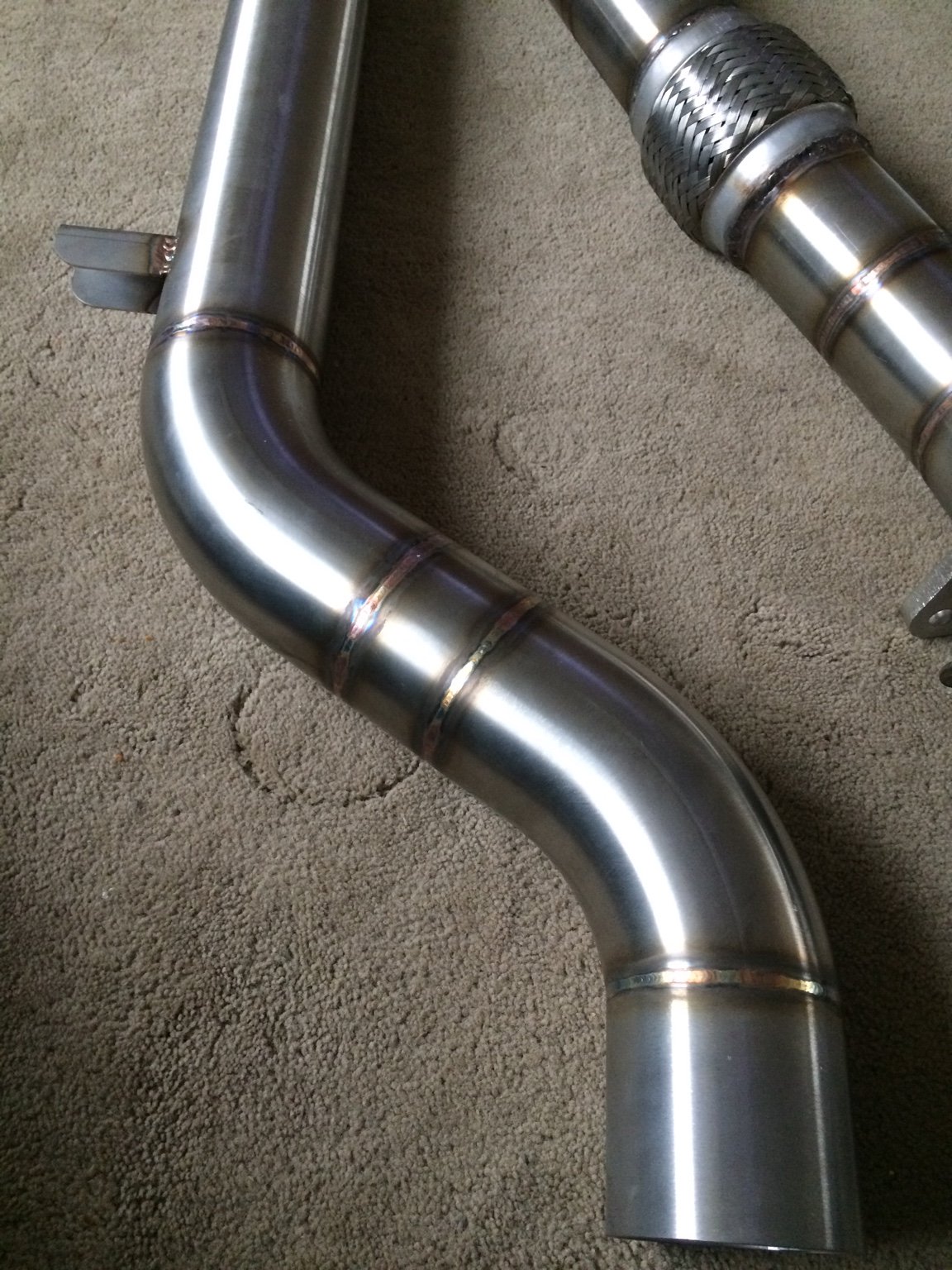

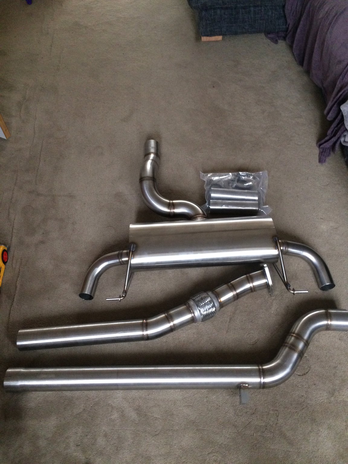

Got my new exhaust today anyway, good job the mrs was in otherwise I'd have struggled, the box is massive and I'm still on crutches!
The system it's self looks really good, 3" bore from down pipe back.
Welds etc are well finished.
Will hopefully have some updates next week and have a drive in it.

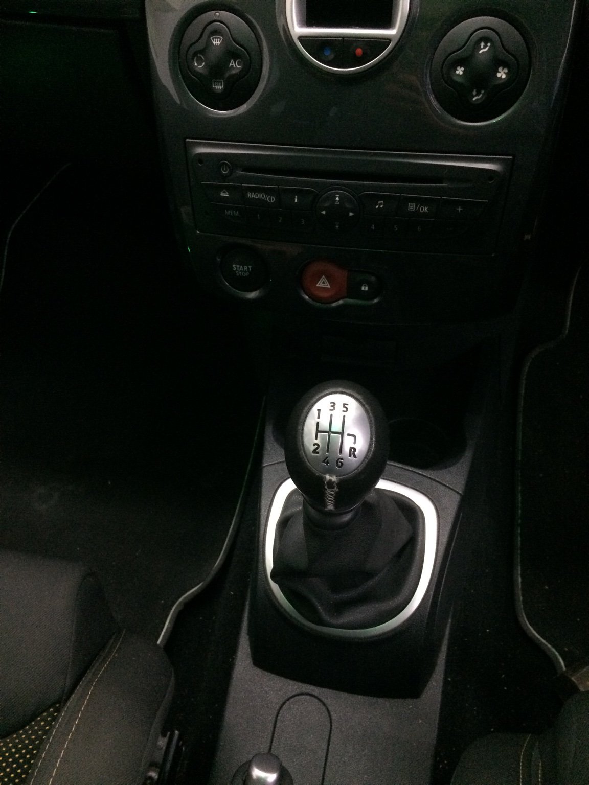

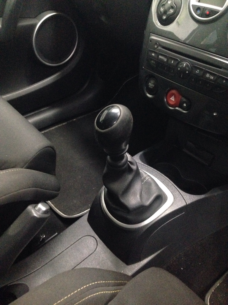

Major news alert!
Fitted the R26 gearknob!

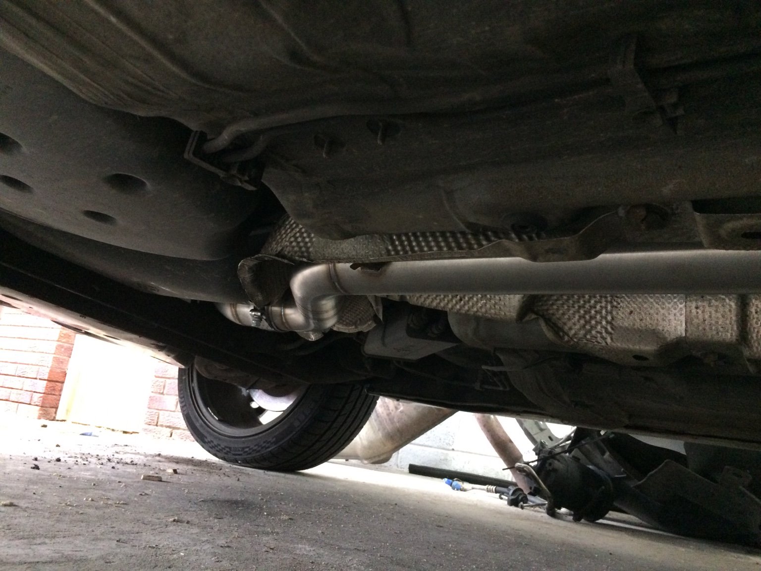

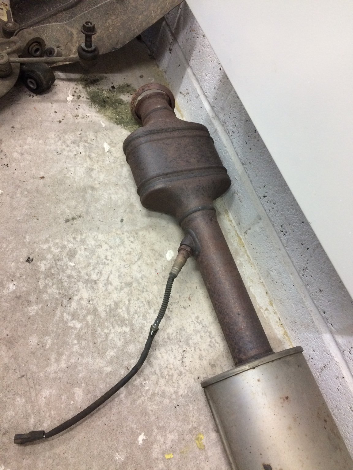

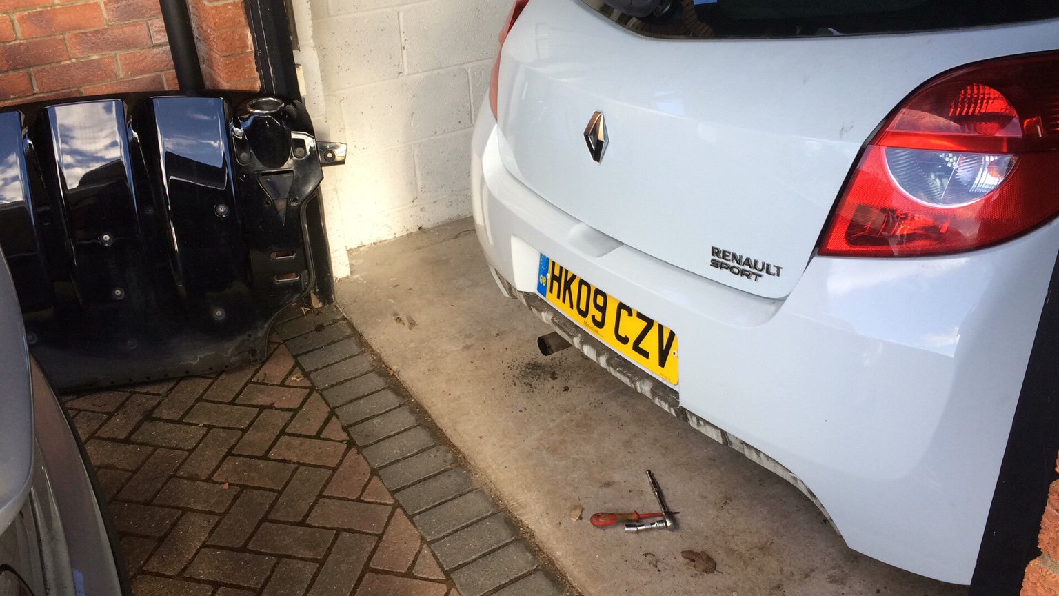

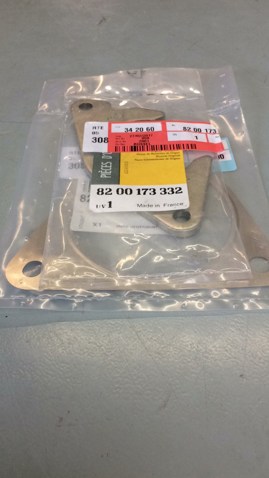

Once the big job was out of the way I started on the exhaust. Hardest part was probably getting the old one off the car.
Obviously needed cut between mid pipe and back box as it's once piece from the factory. Didn't realise the cat was part of the system as well.

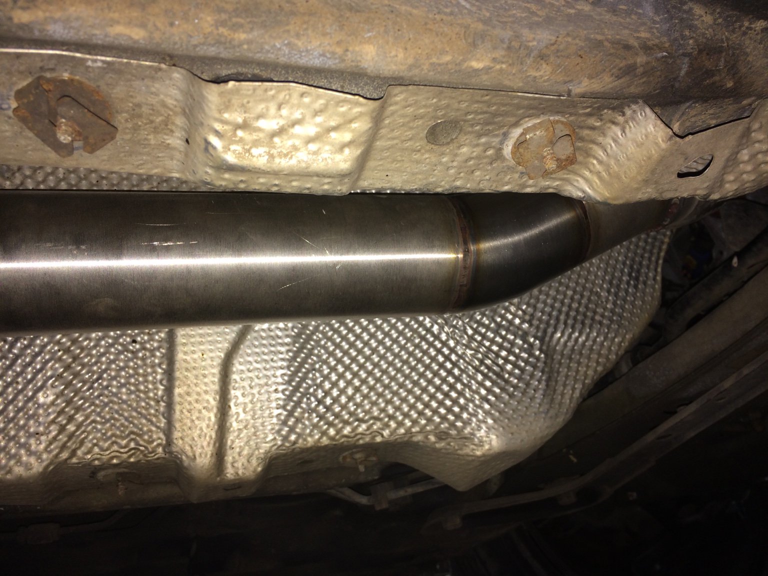

Fitting was straight forward but was fiddly at the front as the one of the threaded holes in the down pipe didn't want to play ball. A new gasket was fitted up front too.
Back box on
And the rest of the system
Chucked the rear springs on while I was under there to match the fronts.
