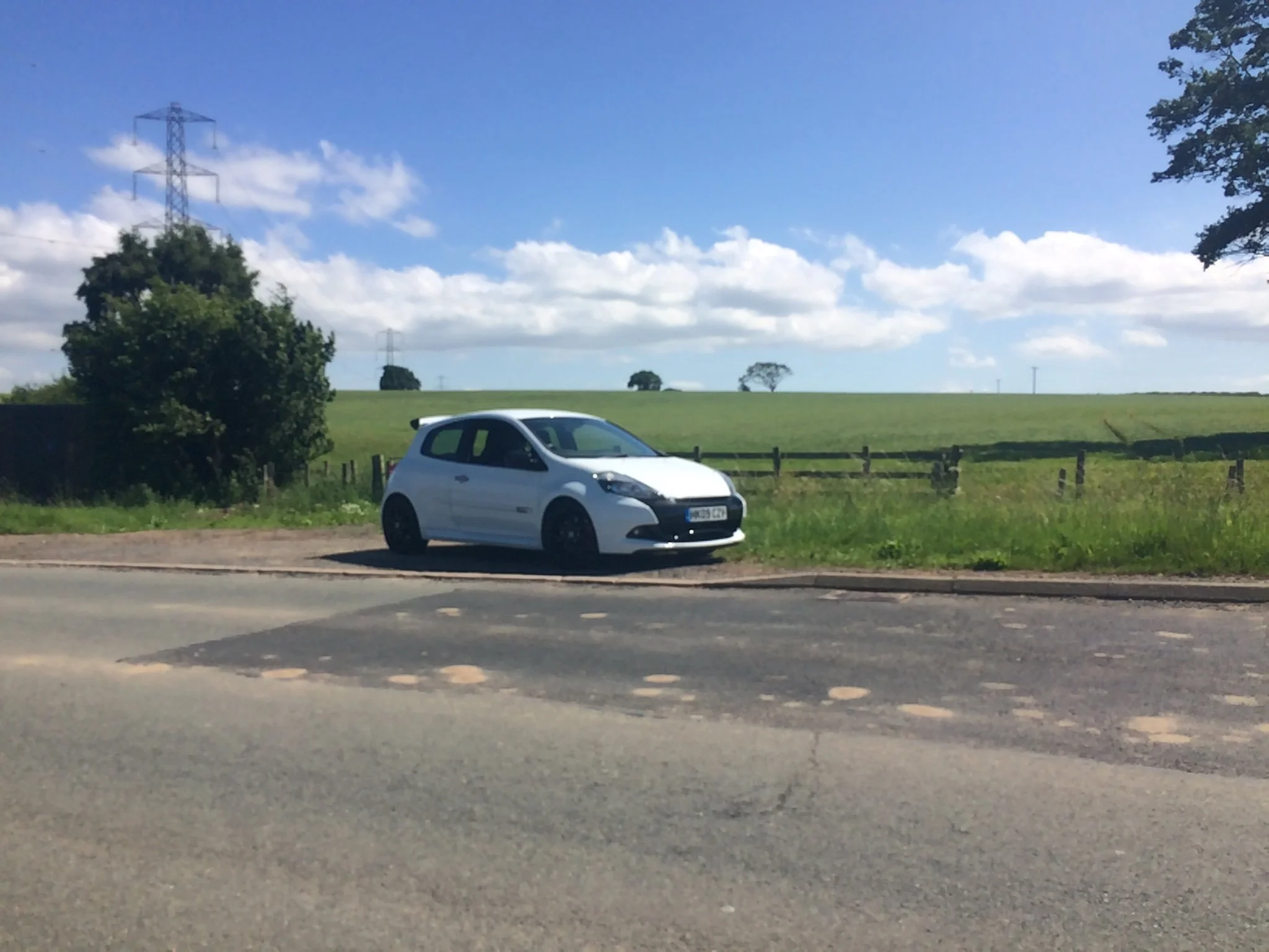

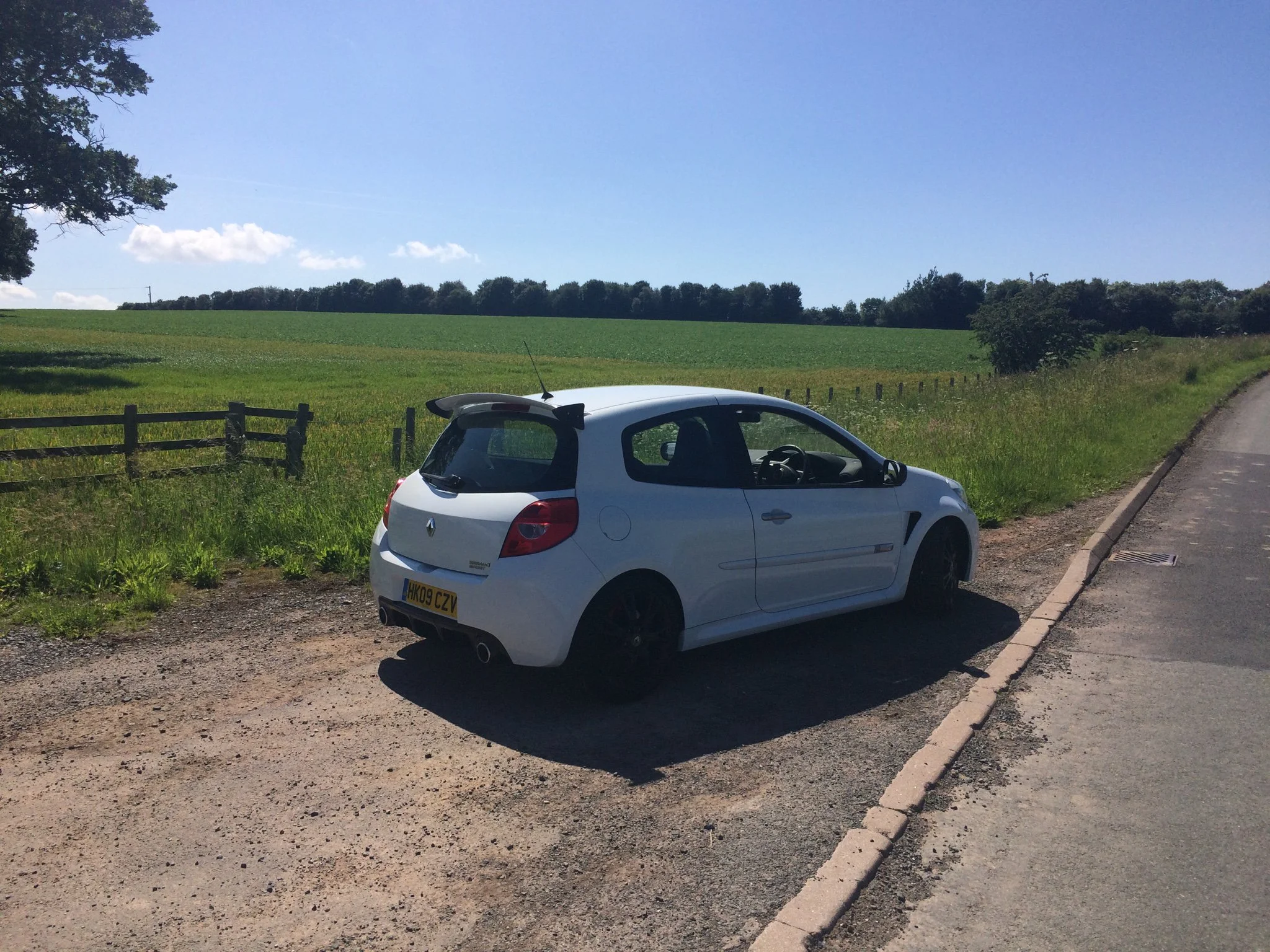

Picked the car up today, great job by Chris @ Efi Parts.
Had a run around the block, bit shocked at just how quick it actually is as a full weight road car, would love to build a lightweight race car with the same engine!
Cars home now and filthy as the weather has been awful.

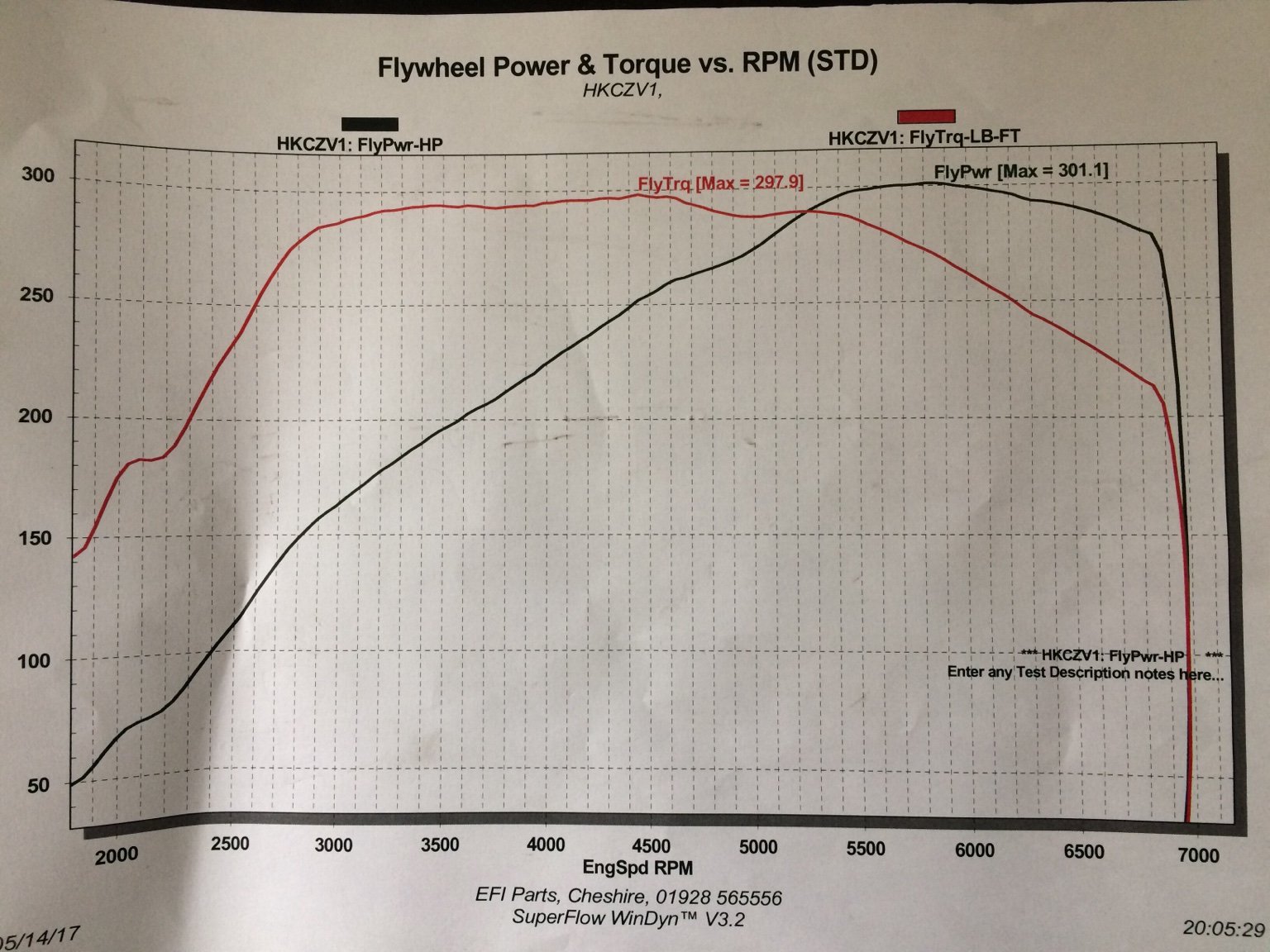

And obligatory dyno graph for those who like that sort of thing.
Going to spanner check it all this week and put some miles on it make sure it's all ok.
