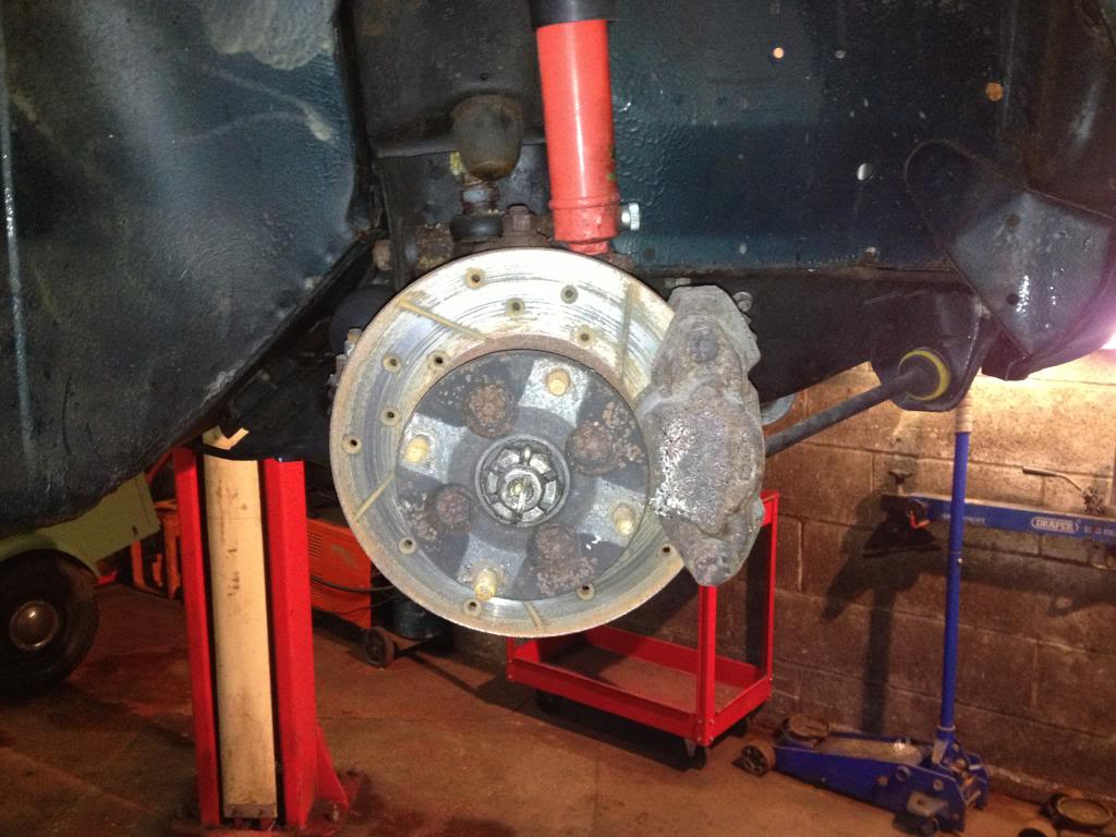

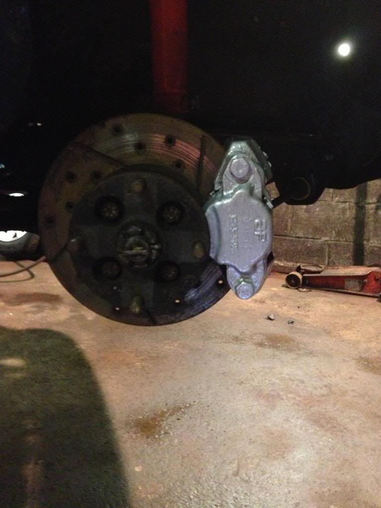

First up were the Brakes. After Standing for 5 years the front brakes were a little siezed on.. So set off to strip them out, clean the pads and calipers up, after eventually prying the Pads out I found they were EBC Green Stuff Pads which I guess is a bonus! Also Decided to give them a lick of paint to make them look a little better... The discs are still rather rusty but they should clean up with a bit of use
Before:
After:
Also did the rear drums but forgot to get a pic... That made Pushing it around FAR easier!

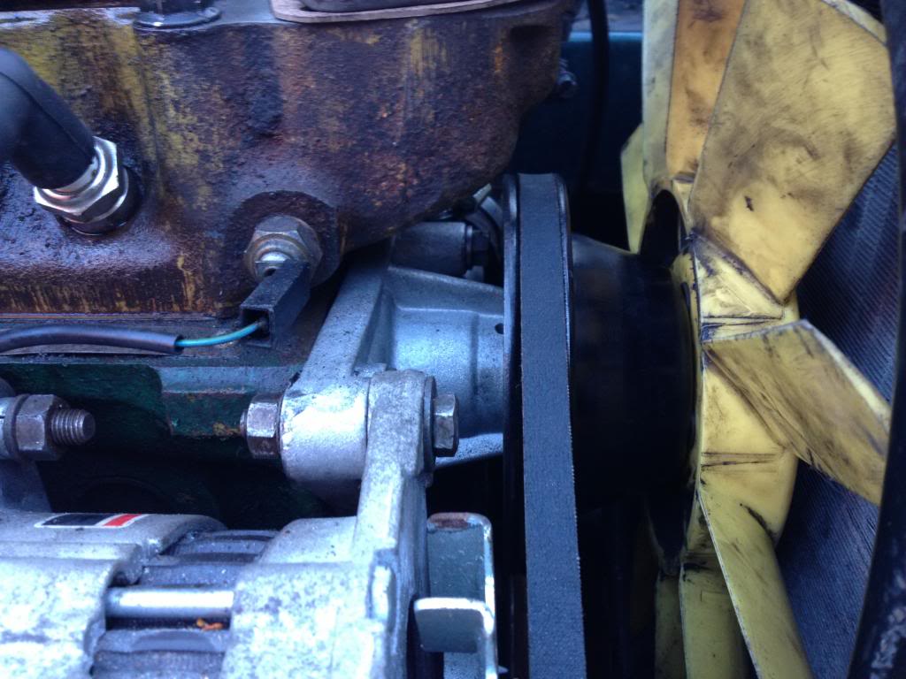

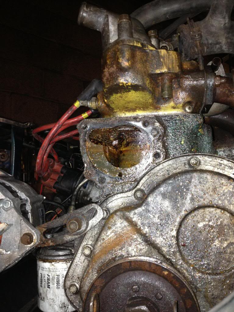

Next up I moved onto the engine.. The water pump wasnt far from being seized solid so off with the old one!
On with the New also threw a new belt on for good measure! (again I forgot to take a pic of the new one :eek:)

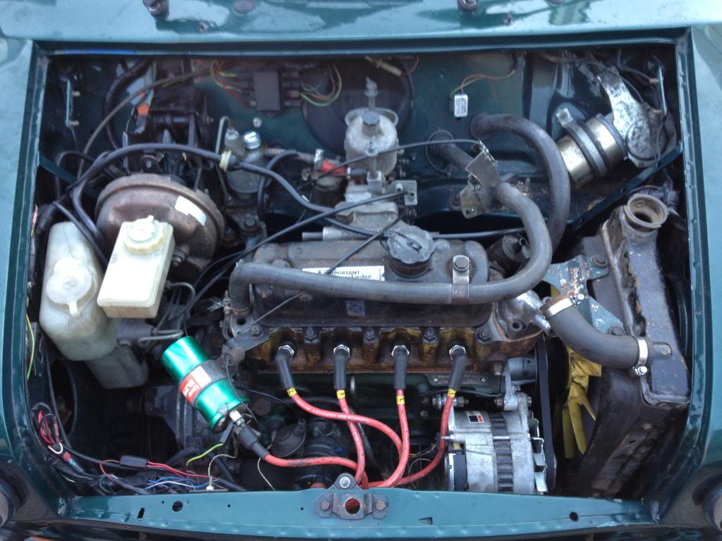

Once all that was done, I threw the radiator back in fought with the bottom hose for a good 10 Minutes.. What a cnut that was... Then set about setting the tappets as they were all miles out, then refitted the Rocker Cover, Its only a temp one as I will be ordering an alloy one from MiniSport!
Engine all back together!

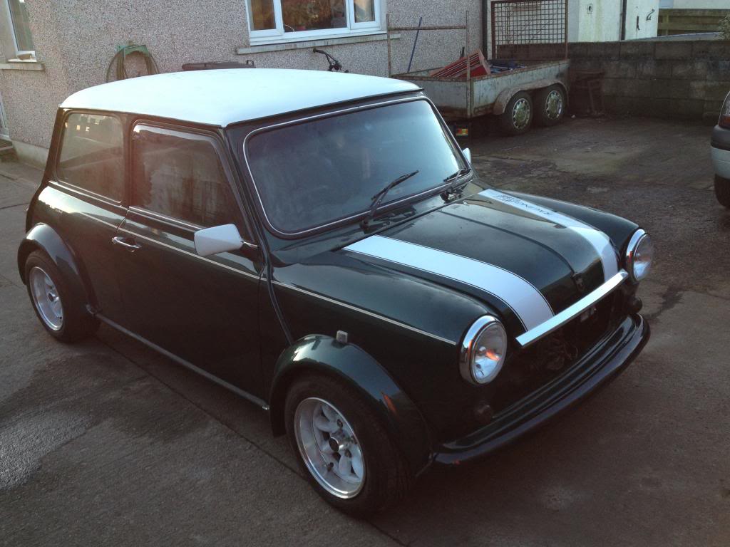

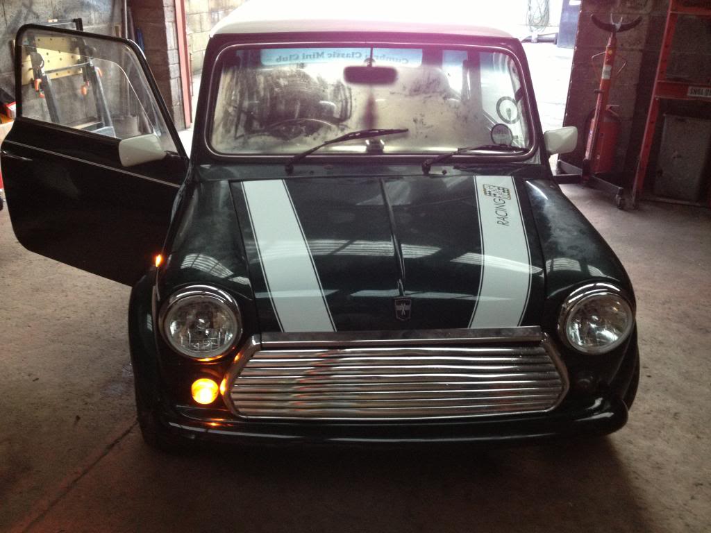

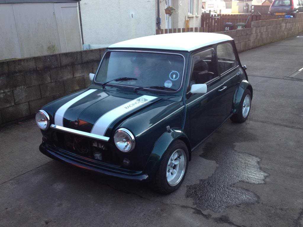

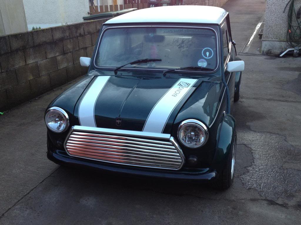

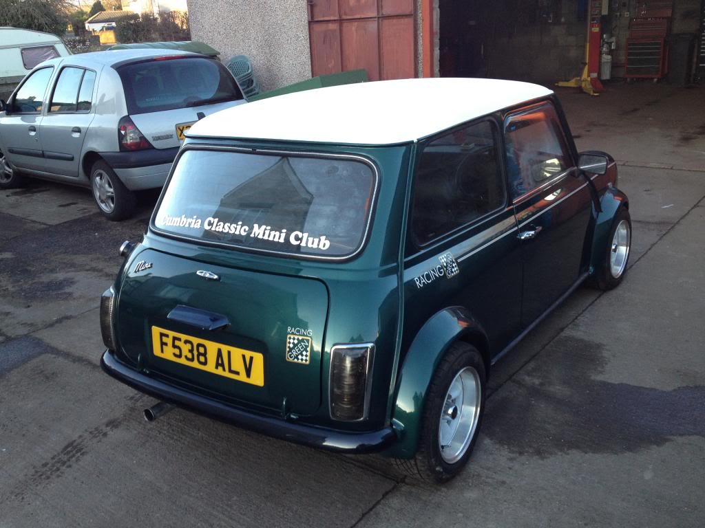

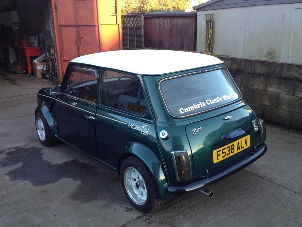

After that I left it for another day and put it all back together and got some pics in the daylight(ish)
I then remembered I forgot to put the grille back on :eek:

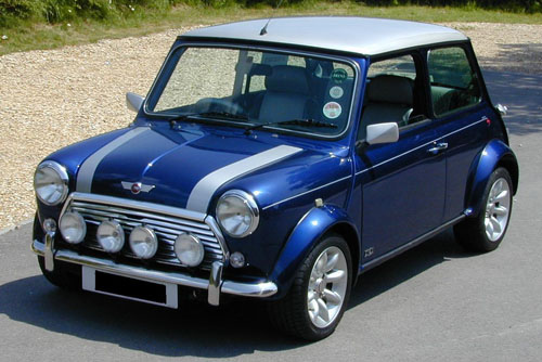

The front is missing something... Im thinking 2 possibly 4 Spot lights...
Also Chrome Bumper or stick with the Black?

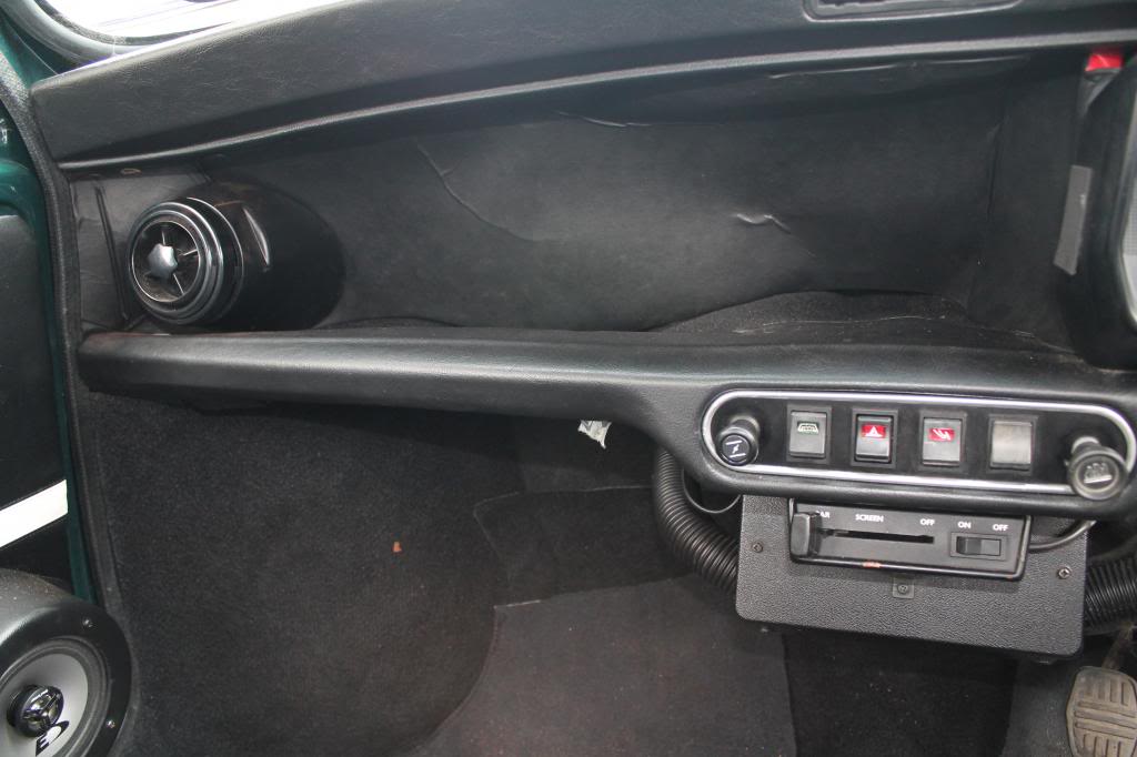

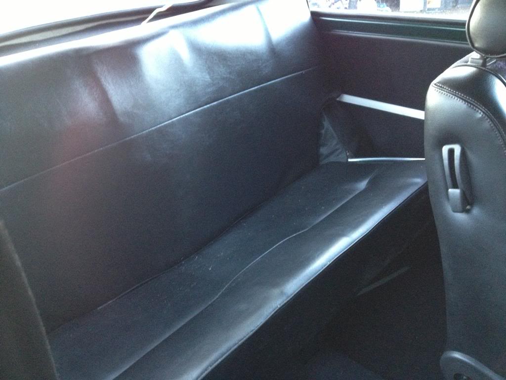

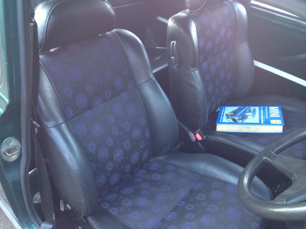

Couple of interior... Half Leather Fronts
Full Leather rear

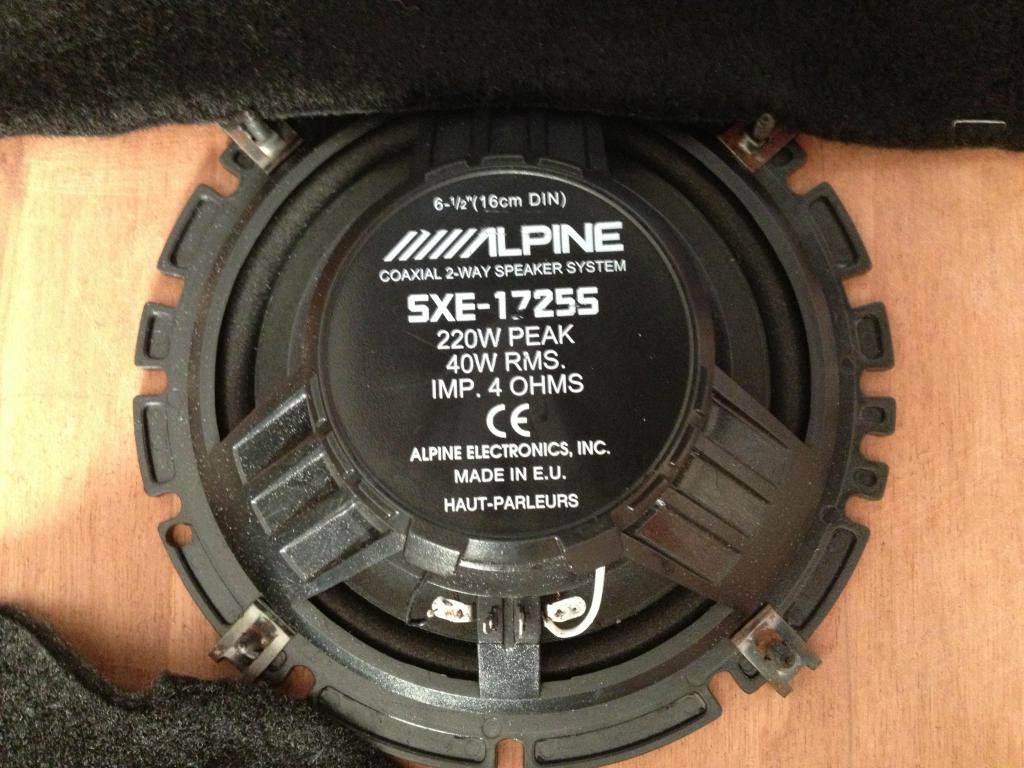

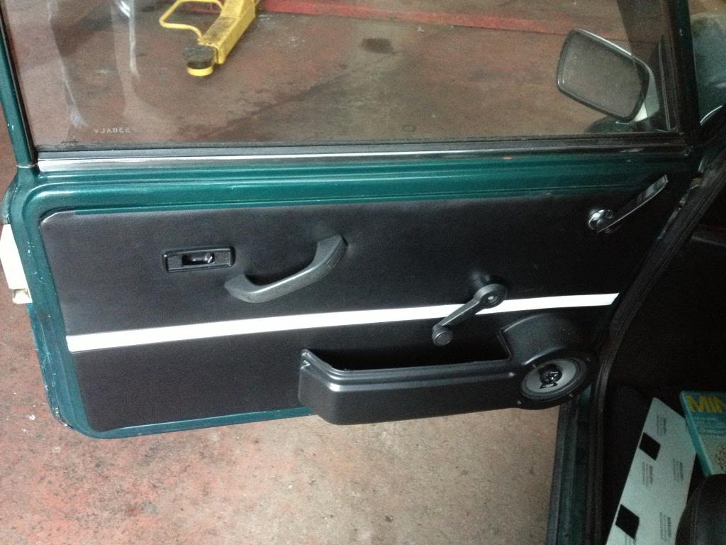

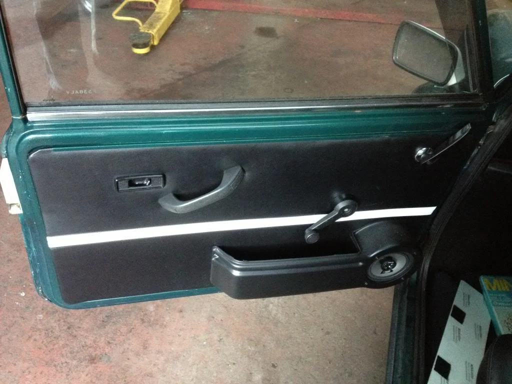

Also has leather door cards with some alpine speakers ;)

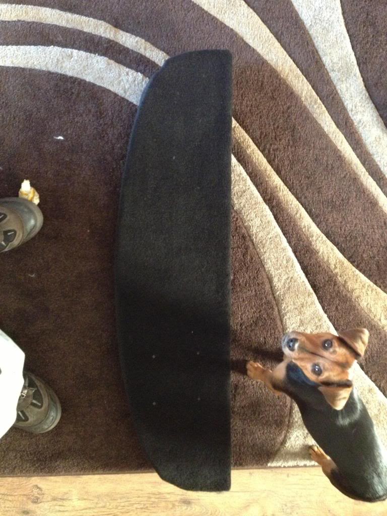

Even a stealth shelf with alpines :rasp:

Thought I'd Inform you, your front seat are from a 1997 Equinox Limited Edition :)
Get them re-trimmed in black leather :)

Oh and I love your dog. Awesome looking little f**ker.
She is rather awesome and massively cute :eek:

Definitely fit spots, although the grille on it's own does look sort of cool..
Im half and half atm.. Il get some Spots and fit them and see how I feel :rasp:

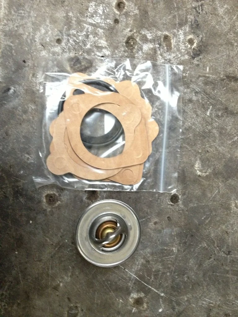

Couple bits arrived today
New thermostat..

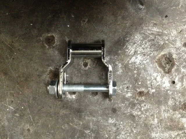

An adjustable bracket to lower the steering column

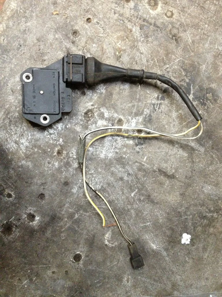

And finally sourced an Ignition Module!
So now im waiting on a new distributer cap and rotor arm so i can put it all back together again!
Im hoping to start it tomorrow :)

Well got everything fitted tried to start her up, still wouldnt go.. Checked for a spark at the plugs but alas no spark :(
So new coil ordered and should be here monday morning!
Tunst
  Focus ST225, Focus E
So yeah, I got her Running!
There was a rouge wire onto the Coil that I never noticed :eek:

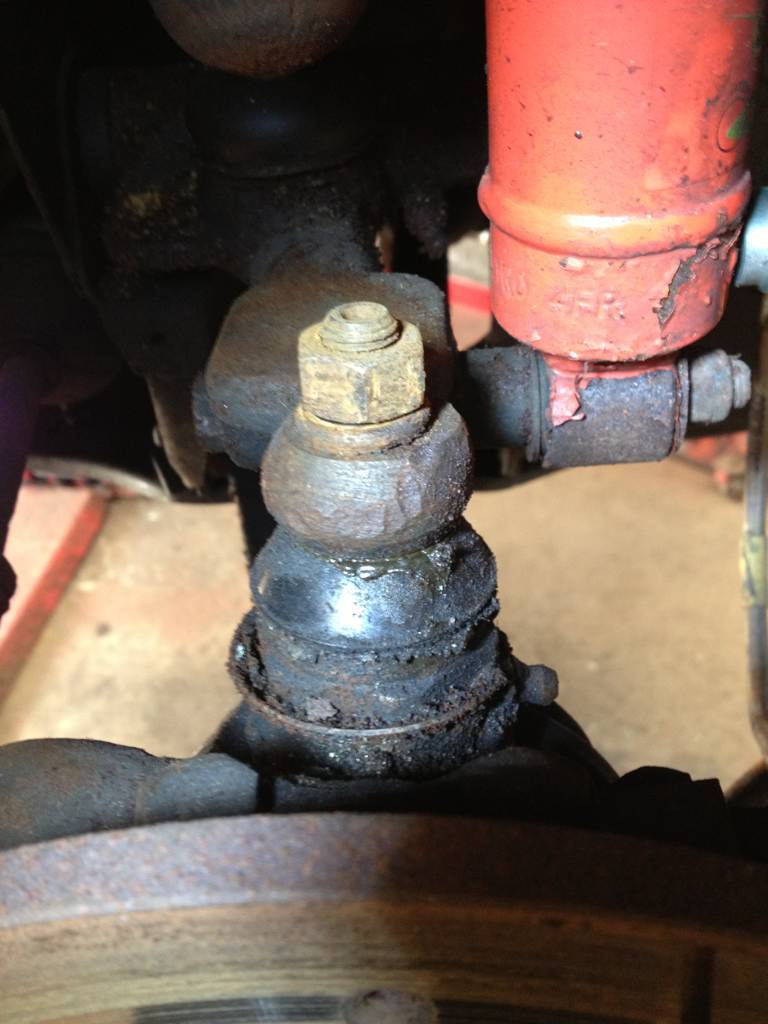

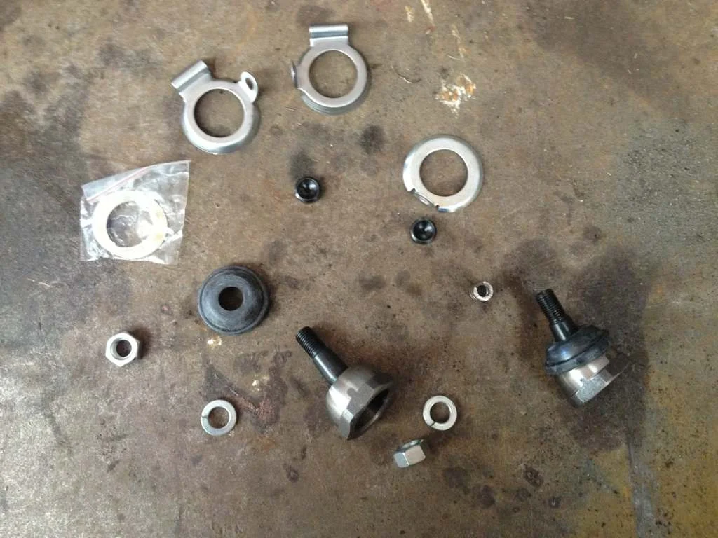

I Replaced all 4 ball joints, and a CV boot..
Only got a pic of 1 old ball joint and pic of the new ones to go on :eek: and non of the CV boot :(
Old balljoint..
New ones to fit
All that is left to do now is Change the drivers rear wheel bearing and sort the hazard lights then she ready for MOT!

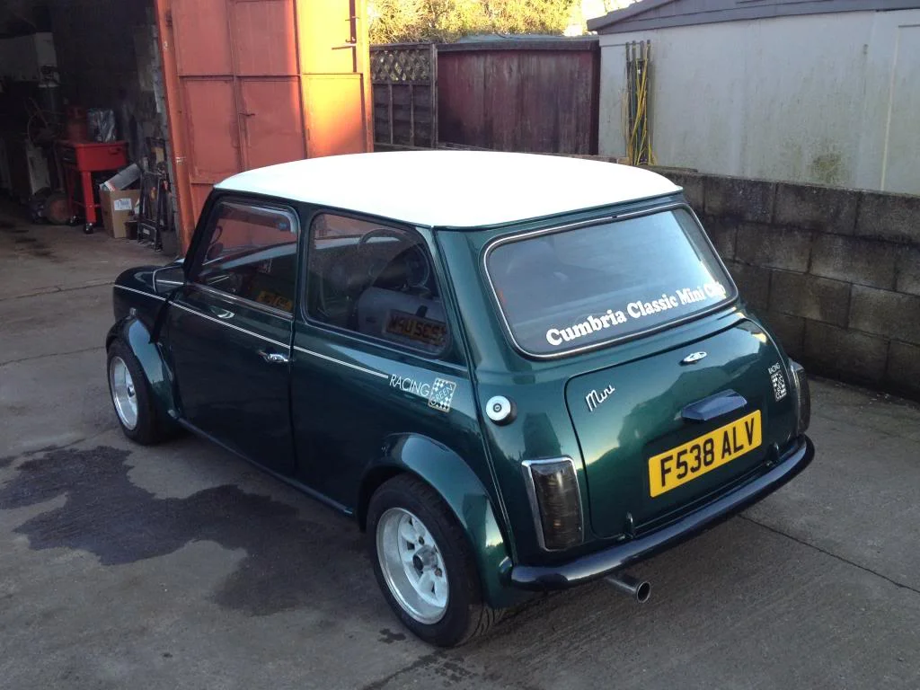

Also yesterday I FINALLY got it MOT'd passed first time with no issues! Bar an advisory on some welding which will be sorted this weekend!
Also later today I will hopefully get it Taxed so I can actually use it! The fueling isnt 100% so needs some tweeking so she running 100%
Unfotunatly on the way back I remembered about a rather loud knock the car made when you let off the accelerator, it was the engine stabilizer, to say the least the bushes were f**ked... Jumped on Ebay and got some new ones which should be here tomorrow! To add more insult to this, its to low :( The front wheels catch like hell on the inner arch when turning.. So need to find a solution to that too...
Awaiting its new bushes!
​Il get there in the end!
Once its taxed and running properly il give it a good wash and get some proper pictures up and possibly a decent drive by video :rasp:
