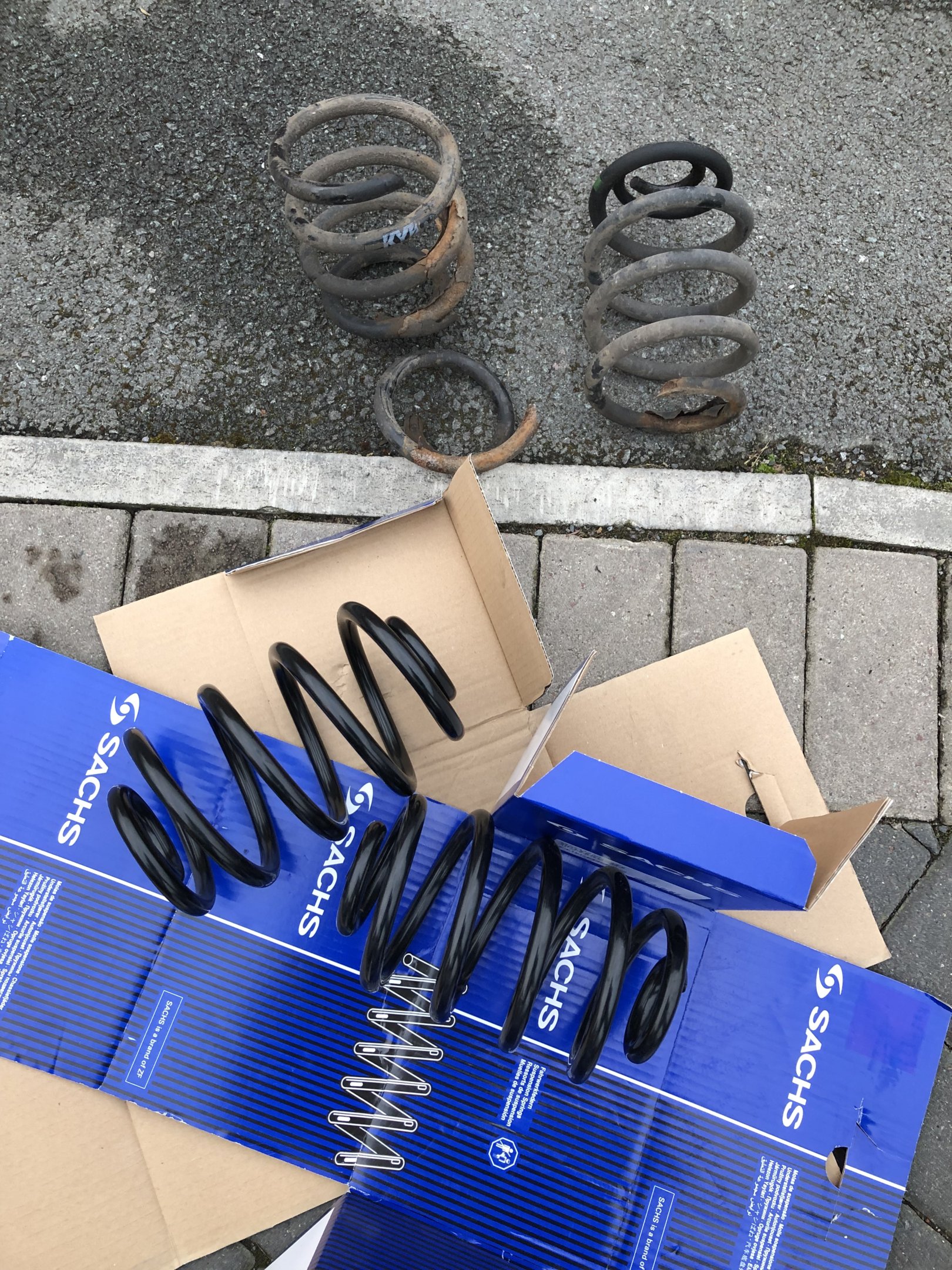

Here they are, before they were fitted the first time...
1408600
Austin-182
  182
Y
Left one looks bigger tbf. You got the rubber spring things on each side? Same shocks either side?
Yes mate, too and bottom of each side. You are right, the one on the left does look slightly larger, and not as conpressed ast the right one.
