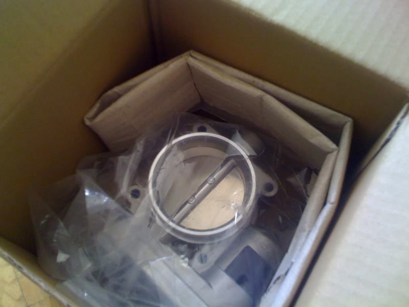

With the packed throttlebody.:

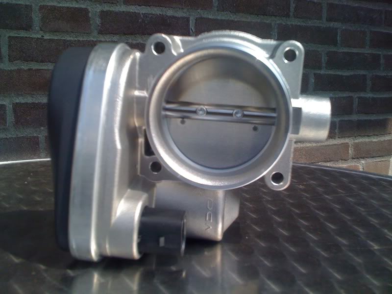

Quit a large butterfly.:

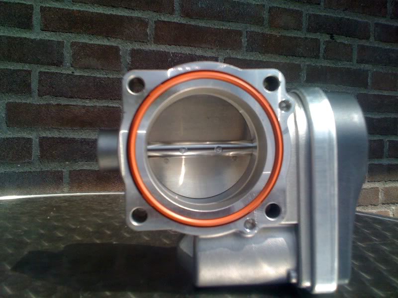

Assembled with a new seal.:

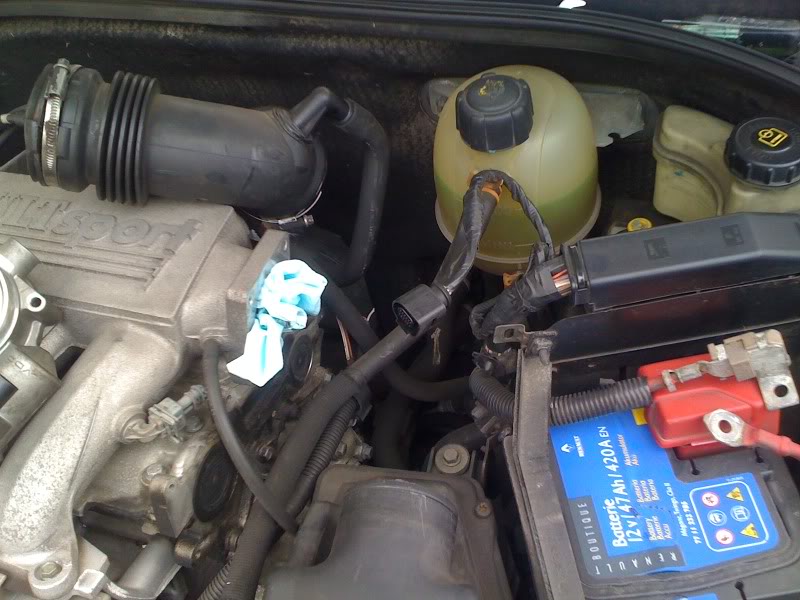

Took the old one off.:
Unclipped the wireloom connection, 2 jubilee clips of the airbox, 4 bolts on the old throttlebody... 1 bolts on the battery + wire!

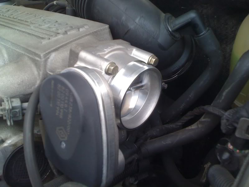

New one mounted.:
Cleaned the inners elbow pipe of some oil deposit from the crankcase/carter ventilation.
Mounted all hardware and started her up.
