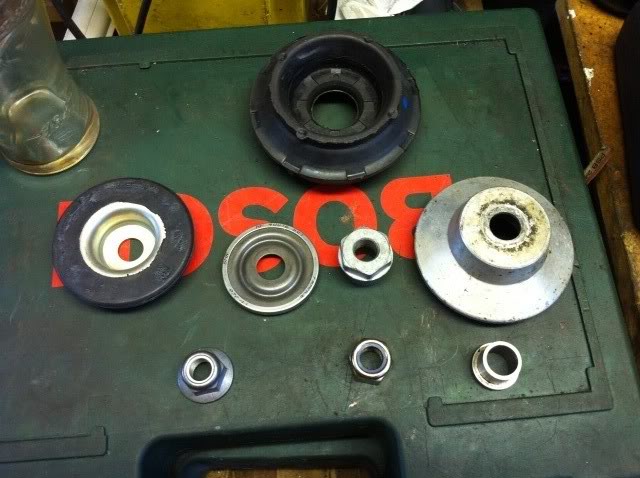

This is what ive currently got....
The silver cup is to sit on the spring... then the silver spacer infront of it? came with the coilover....
I had no topmounts on. The blue nyloc came on the coilovers when refurbed.
Now which order does it all go in???
cheers
picture:
Silver cup
bearing
rubber mount
nut (the one between the silver cup and bearing)
top hat (far left of pic)
then the other nut(bottom left of pic)
Imo there should be a little 5mm spacer between the silver cup and bearing??
The other spacer (bottom right) is off the old style top mounts and the nut next to it is not part of the top mount setup
its the new design topmounts to stop knocking apparently(from renault)
the nut has a spacer (between bearing and silver cup) has a 5mm spacer under it..
thanks dude:)
This is the order then
Silver cup
bearing
rubber mount
big nut with spacer
fit strut back in position on car
And that bearing is currently upside down isn't it? I hope so cos that's how my mate put mine on I think!
Or, as it currently is pictured, the bearing sits in the black rubber cup as they are now (but both those are upside down)
Yep they are upside down in the picture but anyone with a bit of common sense should notice when assembling. bearing always goes flat side down
Just to clarify when you have fitted the new spacer design the top mount ( in engine bay ) it will not sit flush with engine bay?
No they won't. That's what the spacer does as previously the cap would rub on the bodywork and cause the annoying 'creaking'.
Thanks, the thing is ive recently changed my top mounts for new and ive put them back together in the order shown, but ive used the original spacers as i was not sure they were ment to sit of the bodywork, but ive not got a creak i have a knock from the drivers side :s
Change the spacers over then or you can buy some washers off Cotball on here. These can helo get rid of the creaking.
