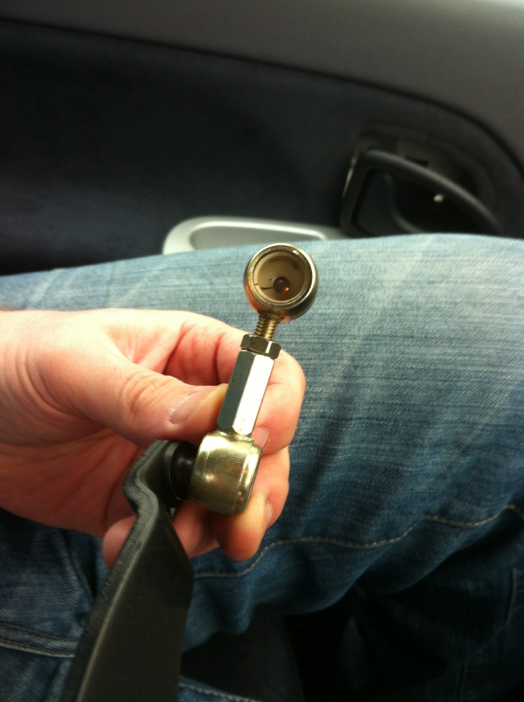

The offending clutch part, the rose joint part. Need to order a new one or modify this one to stop it from being able to pop off.
The clutch pedal hit the floor on a down change coming in to the bus stop. At first we suspected a knackered cable but with the bonnet up the cable was intact so then suspected the clutch itself, but instead it was just this little thing.
