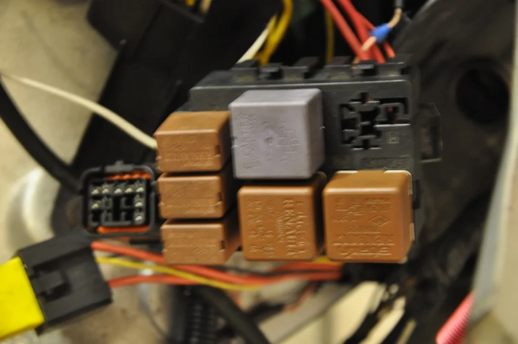

Starter is fine, but it looks like the small wire to the solenoid is buggered. Intermittent voltage when attempting to crank. Does anyone have a wiring diagram for which relay this goes to before I start disturbing the loom :(

Ah. Cannot remember the exact relay now Jonny. To be honest there aren't that many relays in the engine fuse box. I just tested for contunuity to find ours but you might not be able to do that if the wire is dodgy.
Will see of I can find a pic

Any help appreciated :) I just don't want to disturb Renault looms as we all know what that can lead to :(
Right mate on my car which has stock loom for all that stuff the relay for the white wire that runs to the starter goes into the middle of the 3 small brown relays in the picture

I had a feeling it was that one. Really appreciate that James, saves me a lot of faffing. I wasn't getting much/if any power across the terminals, so the main feed might be dodgy. I'll just have to wait for a reasonable day to get out and do some searching (bloody NW weather). Oh and put the starter back :mad:. Wish I had a garage :(, although the wife would never see me if that was the case.lol.

Tested the wire to the relay tonight, and the wire from the relay to the white plug, both show continuity. So i'm either going to put the starter back in and see if the fault has miraculously disappeared, or search back from the white plug to the UCH and barrel. Bloody wiring!

Have you tried swapping the 3 brown relays round? sometimes all it takes to get them going once they've got a bit sticky is a tap on a hard surface

That was an option, but there car is in bits so couldn't try that yet. It clicked when given 12V though.
