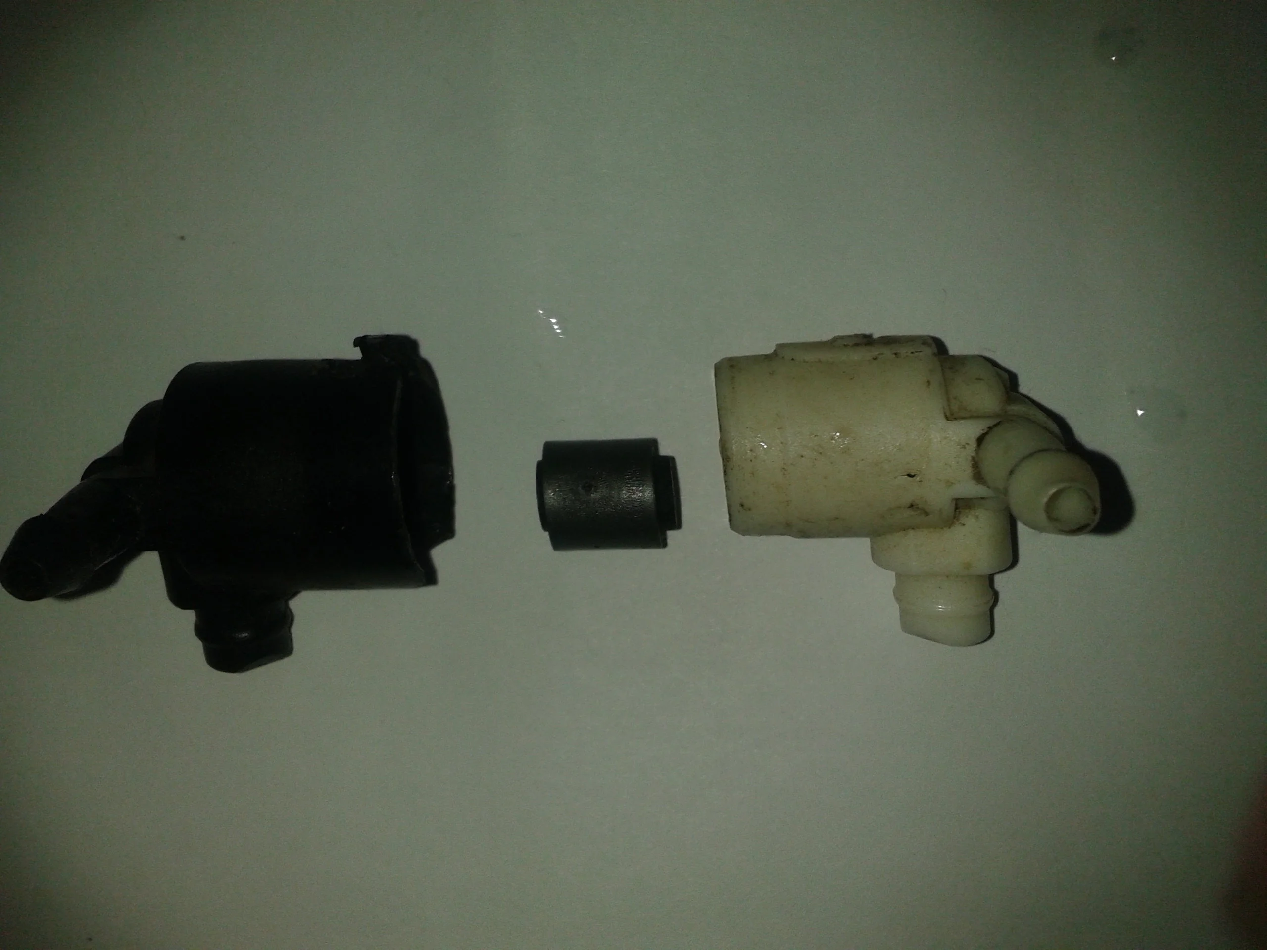

Hi Steve, no its a 172 standard, I have 2 pumps. I believe the one on the left is the windscreen/rear washer pump. I have tested for power to the plug but nothing. Thinking about it, didn't test the live with a known earth so I'm going to try a wire directly to the battery earth and see.
There is no permanent 12v feed to the pump, as the polarity is reversed depending on front or rear screen wash requirement.
This shoots the integral piston of the pump to block off the outlet that is not required.
Ah ok, cheers Steve, I took the washer bottle out and I have swapped the pumps over. Just putting it back together again. At least I'll have windscreen washers. I'll change the other one later on.

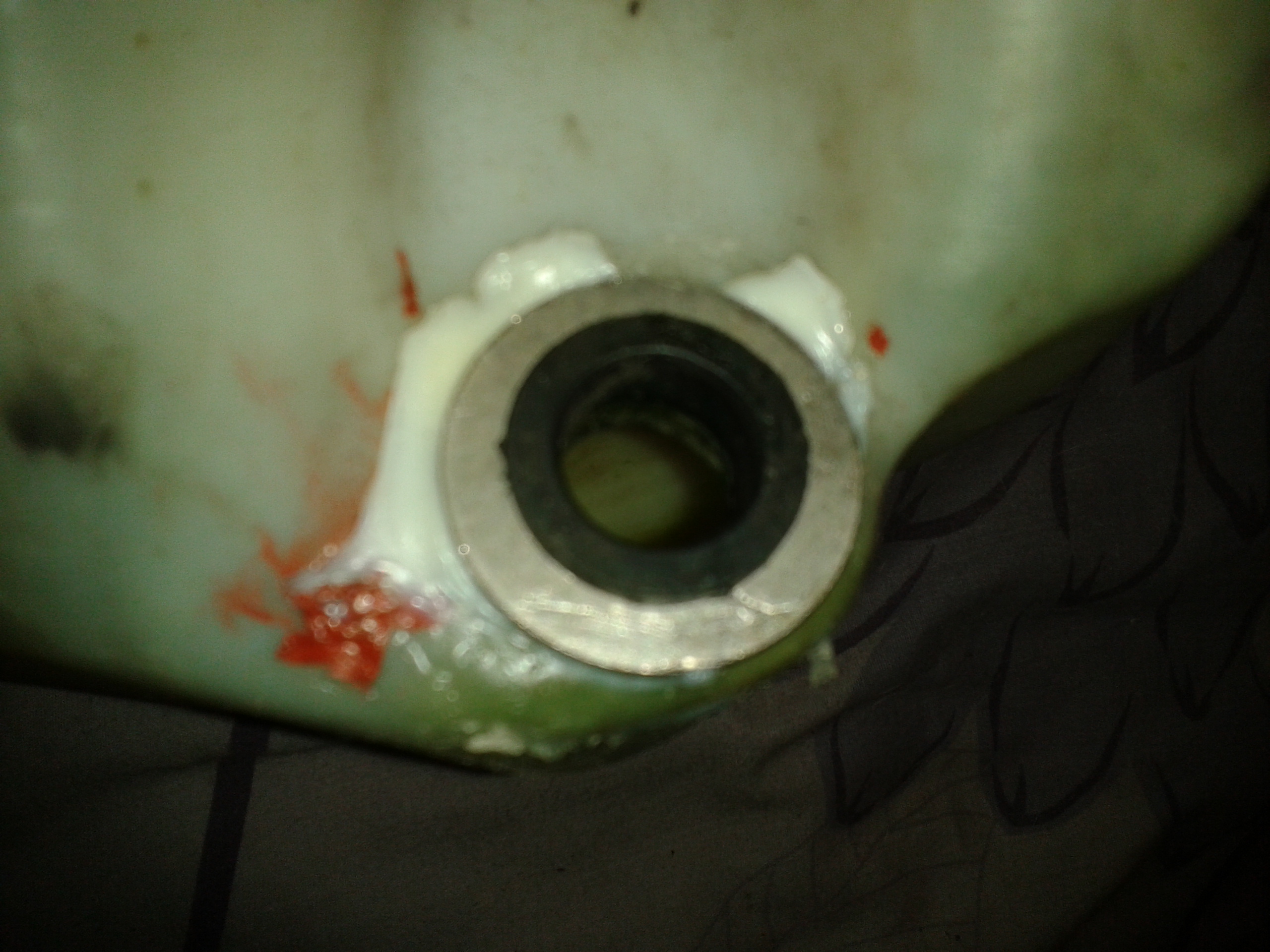

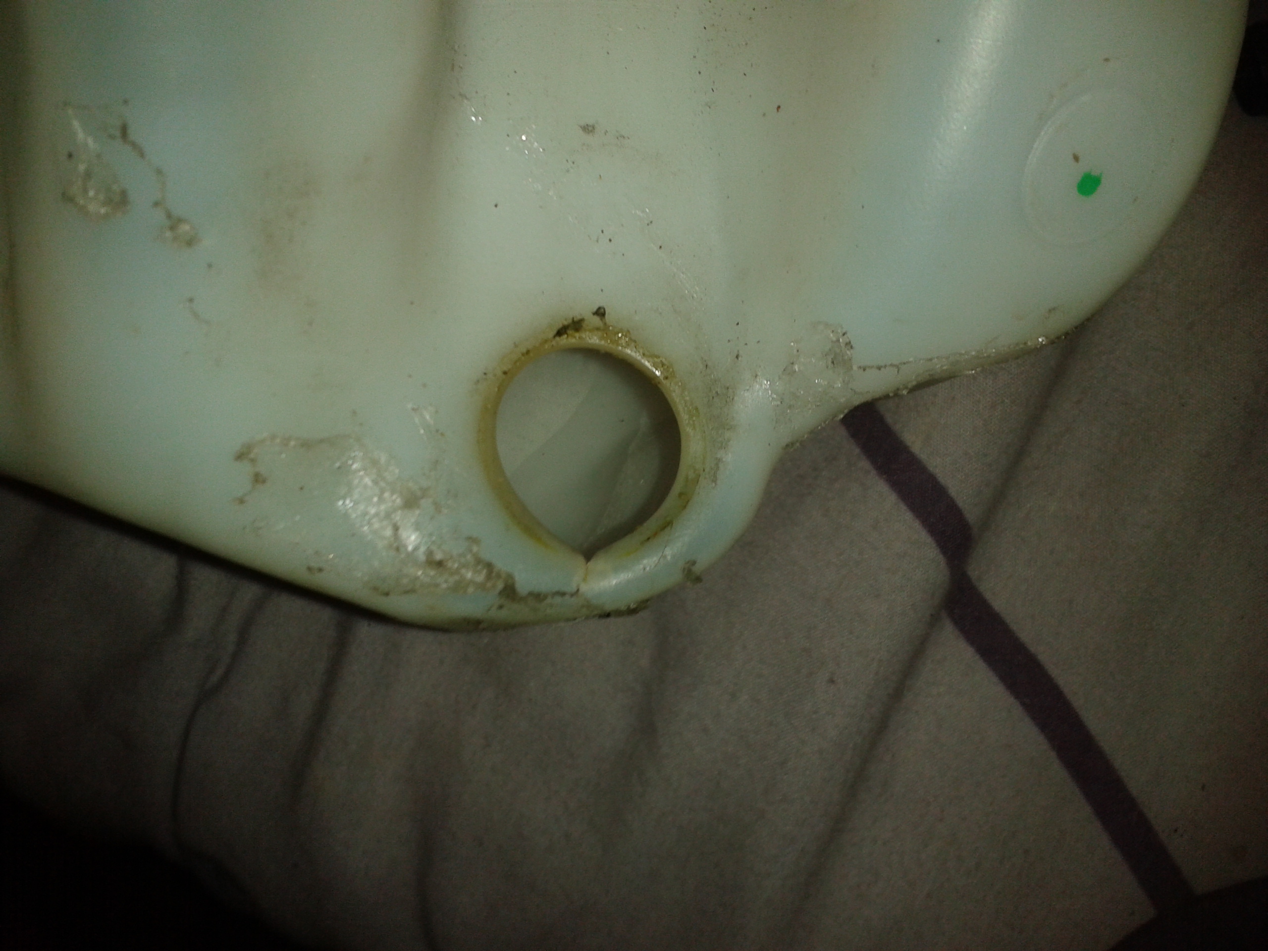

Brilliant, cheers Steve, my washer bottle leaks where the rubber grommet goes. It's split the tank so I've used some ct1. Great advice about the peg btw. I would never have noticed.
I stuck a washer to mine with no more nails (other brands are available)
