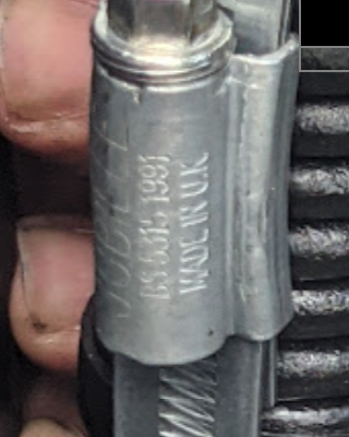

Obviously need a way of compressing the aux tensioner (heavy duty jubilee) and then just various spanners and sockets.

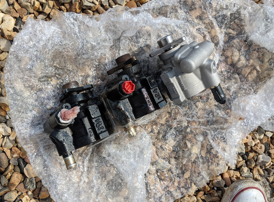

I did this on my driveway 4 times MLB.
Each time I changed the pump the whine got louder until the 4th time when in a rage I put the original back on and decided it was quiet enough.

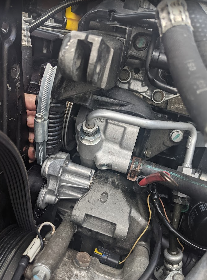

Slam panel off, aux tensioner compressed with jubilee clip, aux belt off, alternator out, aux belt tensioner off and you can wiggle the pump out, think I had to take the pullet off to get enough room but its not difficult.

Its an hour and a half on a sunny afternoon mate.

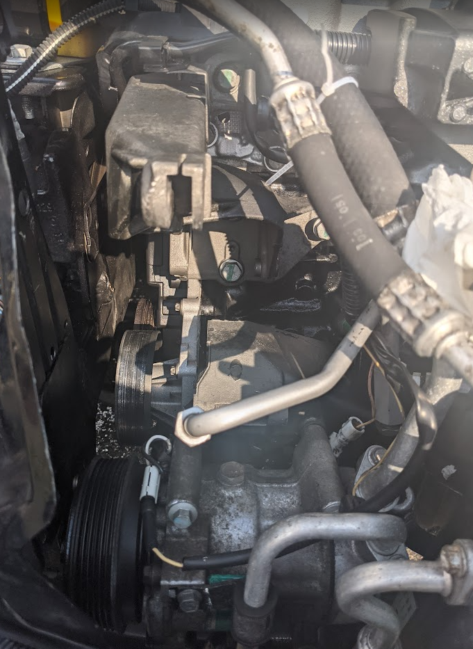

Except that I've got to take apart the contraption I built to keep the airconditioning and alternator together with the RS2 sitting on top of everything 😂

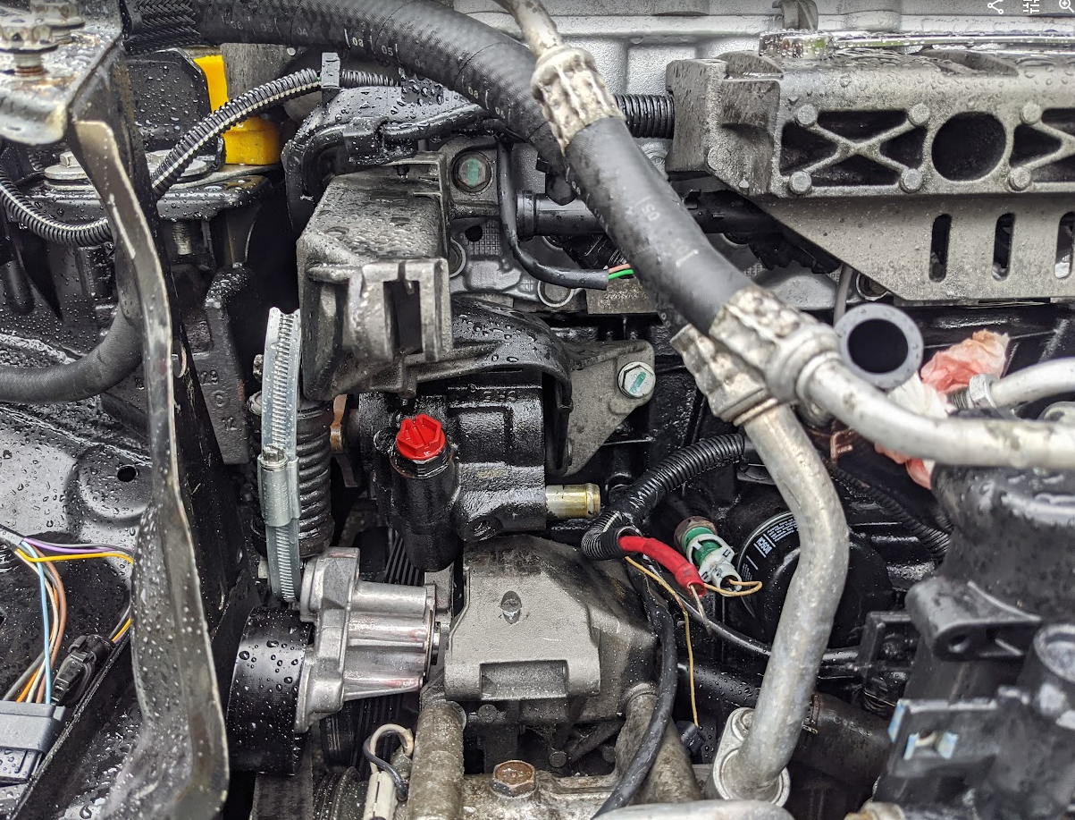

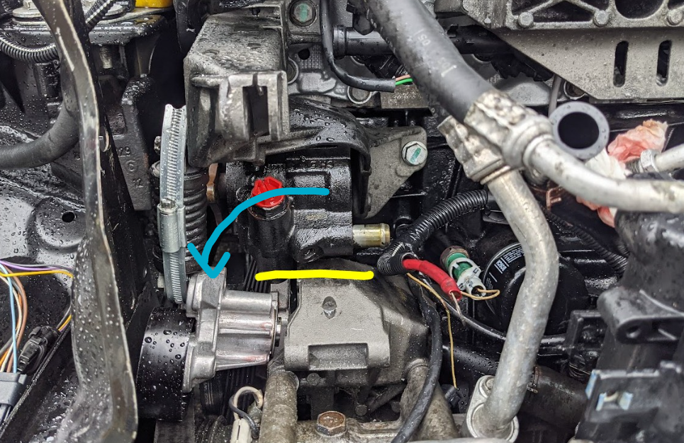

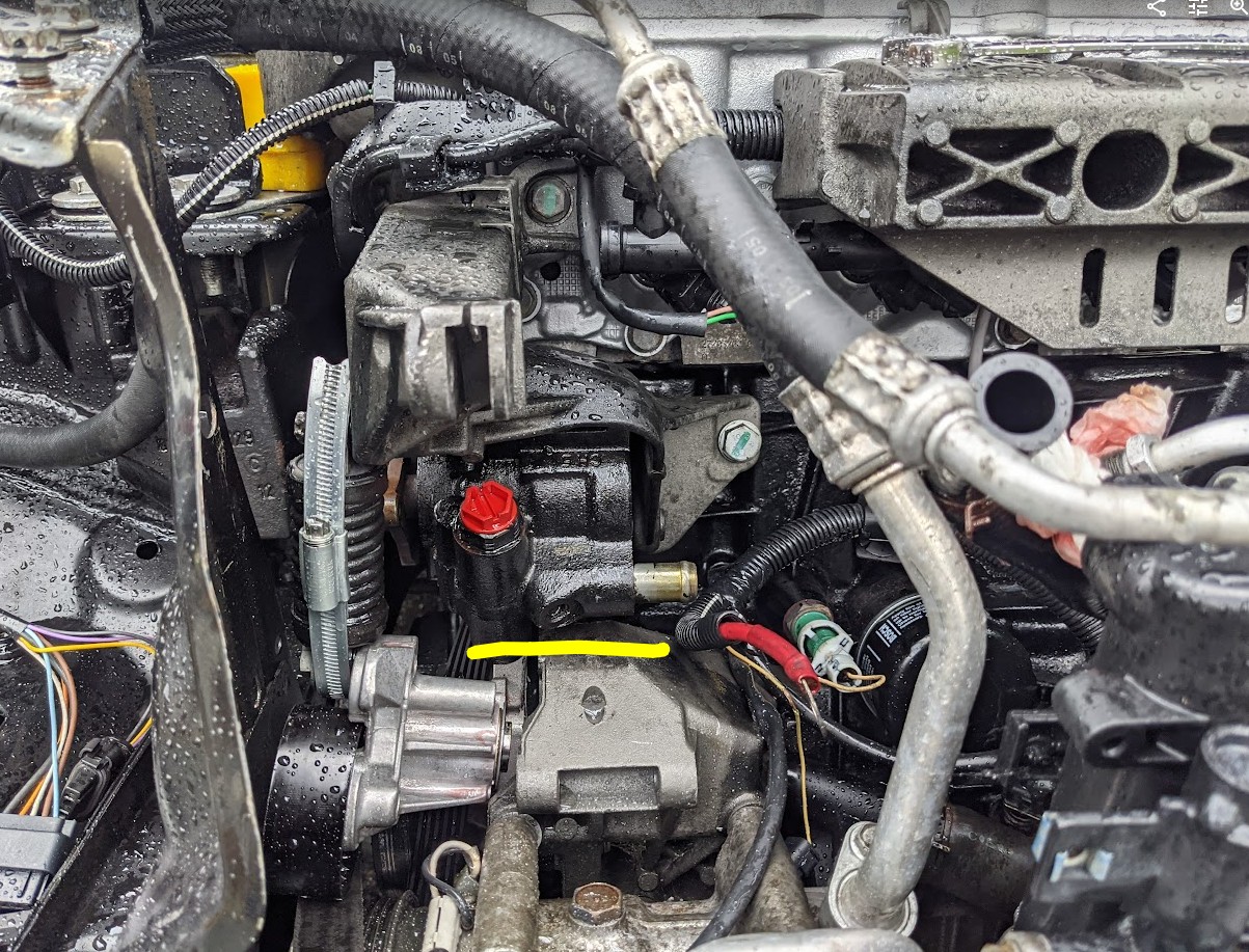

No mate. But I can remember it being a right wiggle to get out the bracket, i think i unbolted the pulley in place which let me wiggle it out, also with the tensioner fully removed.
Yeah we did the same and still seemed stuck, but came straight out when we removed the AC pump (his isn't connected, just acting as another idler pulley 😅)
Like there didn't seem to be enough room for it to drop down here
