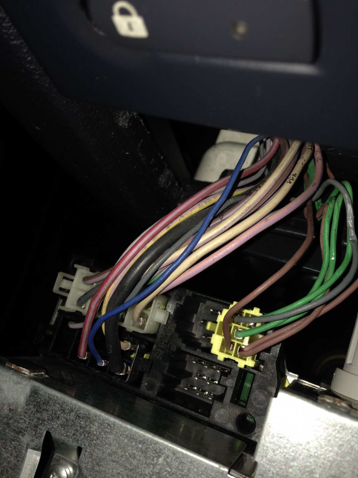

Have you actually removed the radio again and made sure the aerial connection to the back of it hasn't fallen off when you slid the stereo into the dash?
This is what I've got.
Please tell me there's just a cable in the wrong place.

It's the fact you must have disconnected the aerial from the other headunit too???
Can't honestly remember.
Having left it overnight and the cable hiding away out of view I must have just forgot. Just had the 3 connections in my head and that was me.
