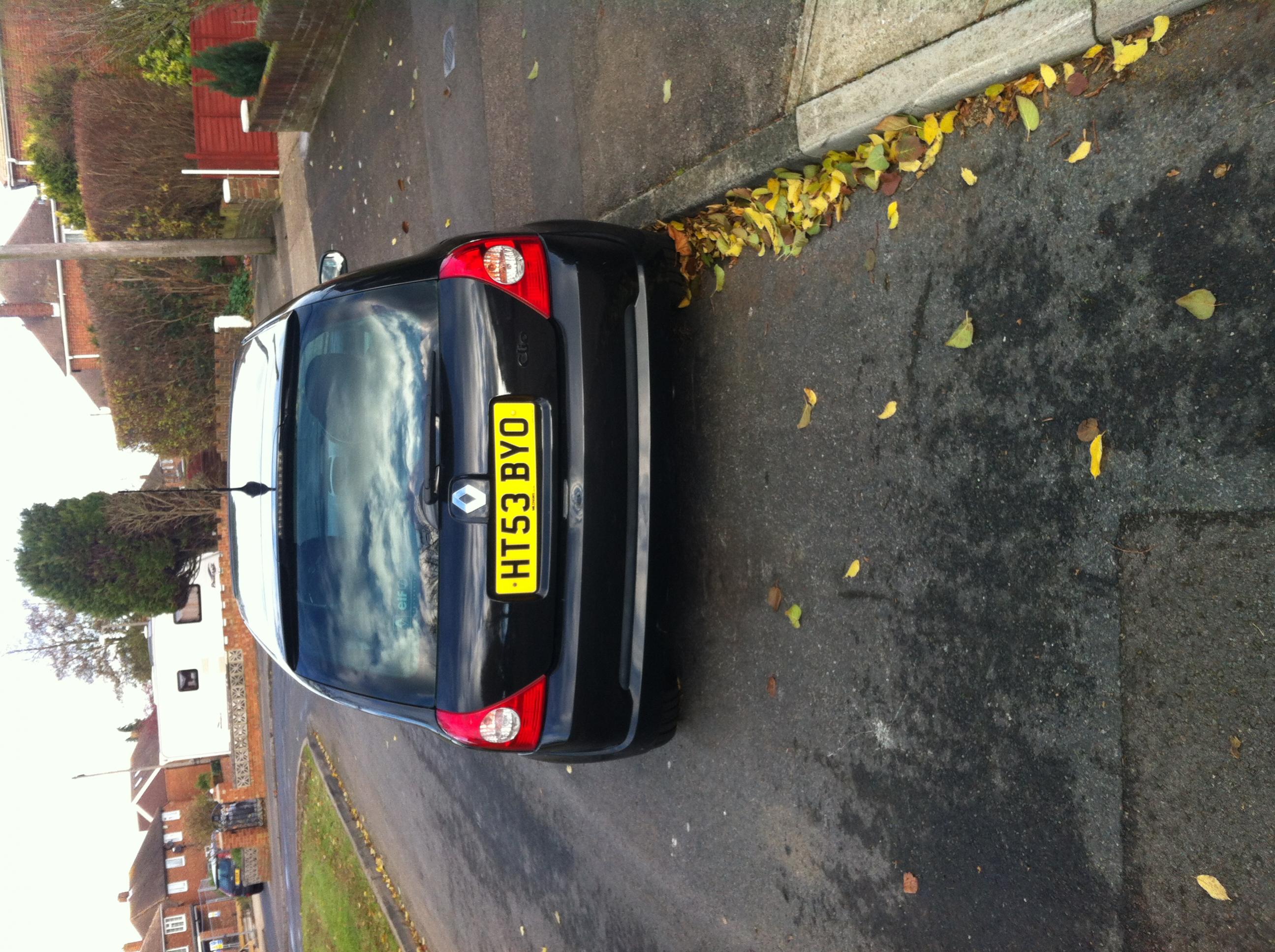

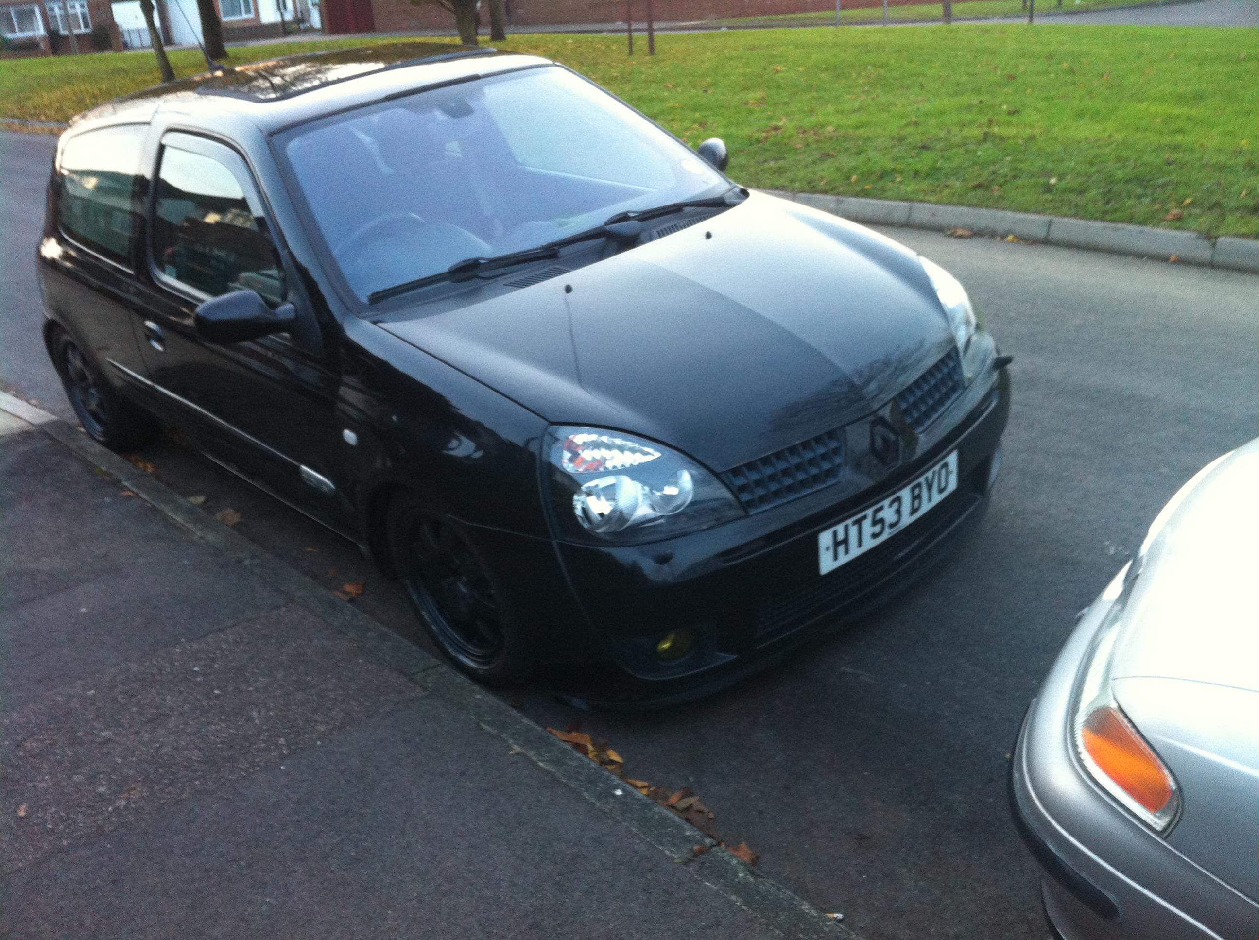

has anyone with a non sport that is lowered on coilovers put the sport front end, wings, skirts etc on as well? I'm tempted to do this to mine but not sure how the skirts will fair in regards to clearance over speed bumps etc

Mine is on 165/50/15s stretched tyres and lowered pretty low. Its not had any sort of conversion like yours so I would just be using spacers to try and make the wheels line up with the body work so they aren't sunk into the sport arches.

grazo22 I believe they are et38. Tbh they don't look that bad without spacers at the mo. Would look better with them but don't want it to rub as it's currently fine. So will defos need the arches doing on the back first. Wreckon if I get the sport front end 25mm spacers would do as they're more easily available?
Your car currently will look like it's got 10mm spacers on each side already then as 172 alloys are et 48.5. If you have a look at my thread your car will be roughly as wide as mine which has sport running gear and 172 alloys.
If it were me I would put the kit on, see what it looks like and then spacer if and as you need. Alex's car is 25mm spacers on the front but again et48.5 wheels
Go onto JJC, hub buddy spacers will see you fine at about £40 a side inc bolts.
grazo22 the main thing I'm worried about with the kit though is the skirts catching when I go over speed bumps etc as it is quite low, although they don't appear to go much if any lower than the metal ugly sills rather than just covering them up
