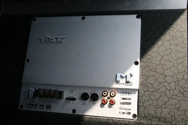

Here is the amp that I have now:

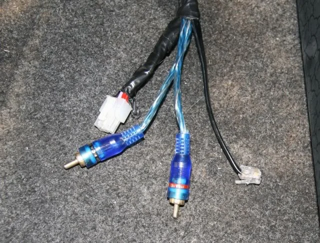

and here are the wires I was left with:
The connector on the left has three wires going into it (pink, black and red) which Im guessing go into the screw bits but really not sure.

you need to run a bigger power cable than that!!
youll need a multi meter to find out what wires what, usually, red is power, and goes to the battery,
black is earth and goes to the isofix bar mounting bolt, and a blue (pink in your case by the looks of things) one that goes to the headunit that puts a small voltage to the amp telling it to turn on called remote wire.
however the red wire you have there is far too small, running an amp that size through it would case it to heat up to the point of melting the rubber around and causing damage.
but a 4awg wiring kit, and pull the rest of the wiring out tbh. (apart from the RCA (phono) leads)
you could keep the pink wire and run it to the remote, but the rest needs to go im afraid.
also, that black wire that looks like a phone line can only be used with the previous amp, not the new one unfort.
The connections look a bit different! Not sure what the connectors used for your old sub are, Im sure someone will know though.
Normally, as you'll need on your new sub, you have
- The RCA leads going to the headunit.
- A single thin, Remote wire (usually blue)
- Positive power cable (red) going to the battery
- A Negative ground cable (brown) attached to some metal on the vehicle chassis.

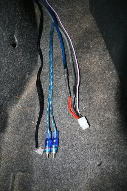

Ok, i stripped back the electrical tape to see what was there and this is it.
The darker blue cable says power cable on it. The lighter one is the RCAs, still no idea what silver, pink and black are for?

running that wire is possible,
however, the sub will cut out the second the voltage drops below a certain point,
which with such small wire, will be very often because the amp is so juicy.
if it doesnt cut out, it will create a large armount of heat, and you will risk a fire.
it will most probs create a lot of heat anyway so i really would recommend using that wire.
but if you HAVE to (and dont blame me if it goes up in smoke) cut the plug off the end, and bound both the red wires together and screw it into the +12v plug,
take the two blacks, bound them together and screw them into the GRND plug,
take the pink and screw it into the remote plug.
put the RCA's into the input plugs,
and bin/sell the black telephone wire because it wont work with that amp.

ooh didnt pay much attenetion to the second pic,
yes, you could well run it like that,
cut the red wire back to the blue,
and the black wire back to the silver
it will still heat up, because that looks like 8 awg
but shouldnt be to too of a dangerous level.
