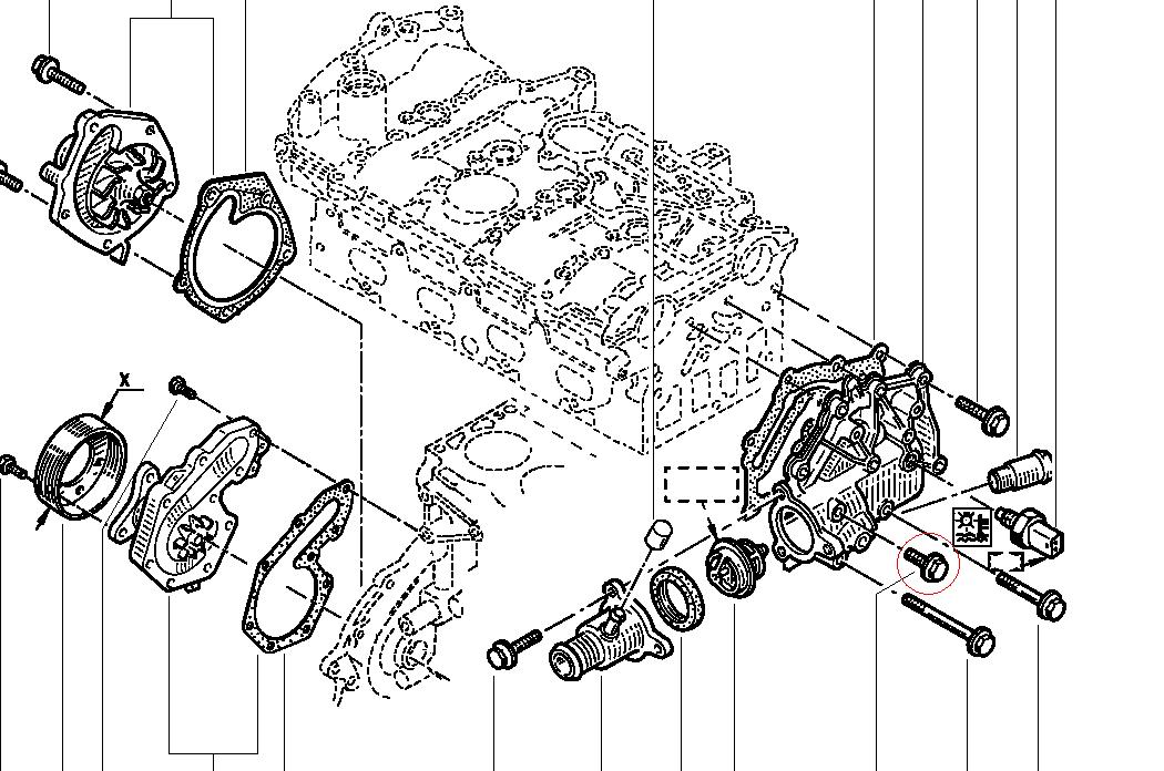

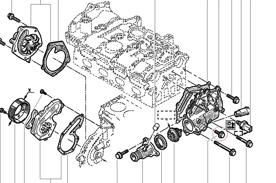

You can definitely buy just the thermostat, I did it on mine many years back.
DrR
  VW Golf GTD
Trying to see if I can find some pictures.
