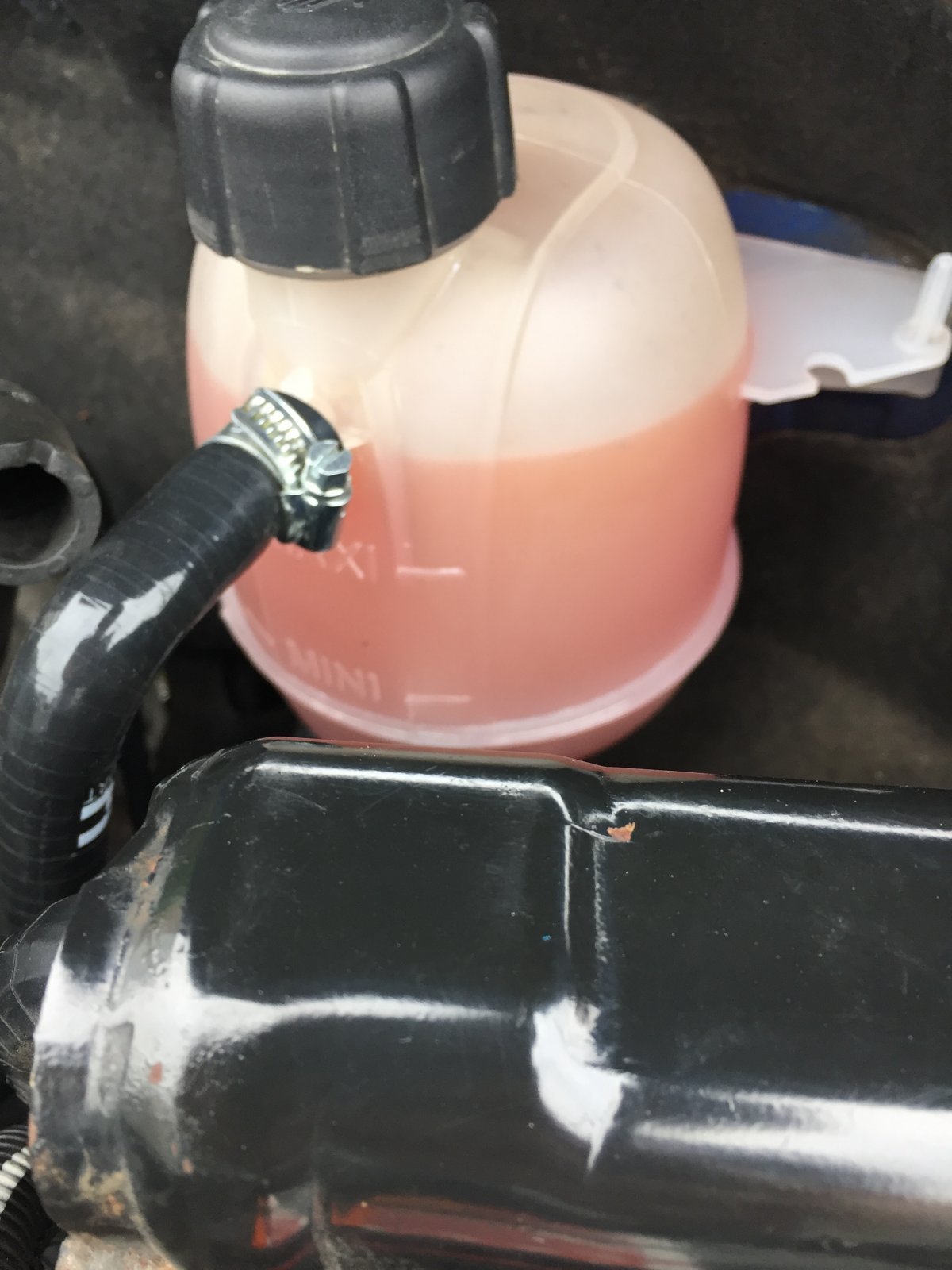

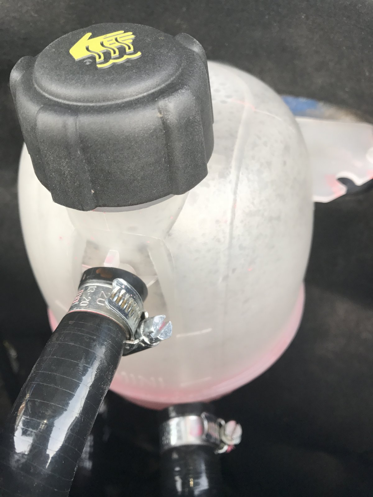

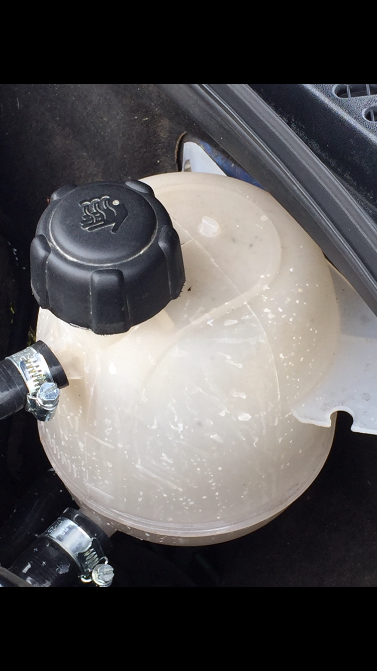

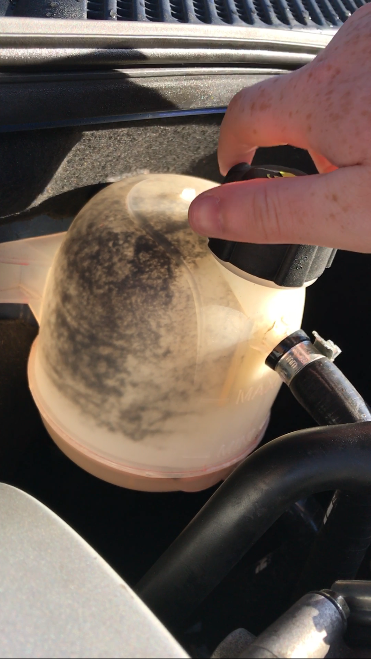

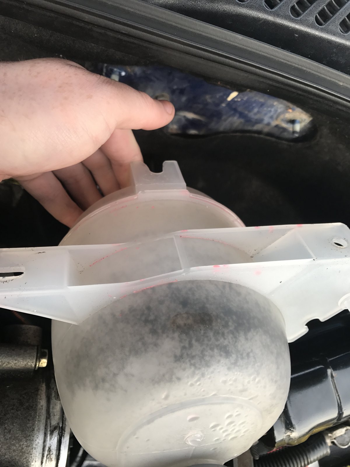

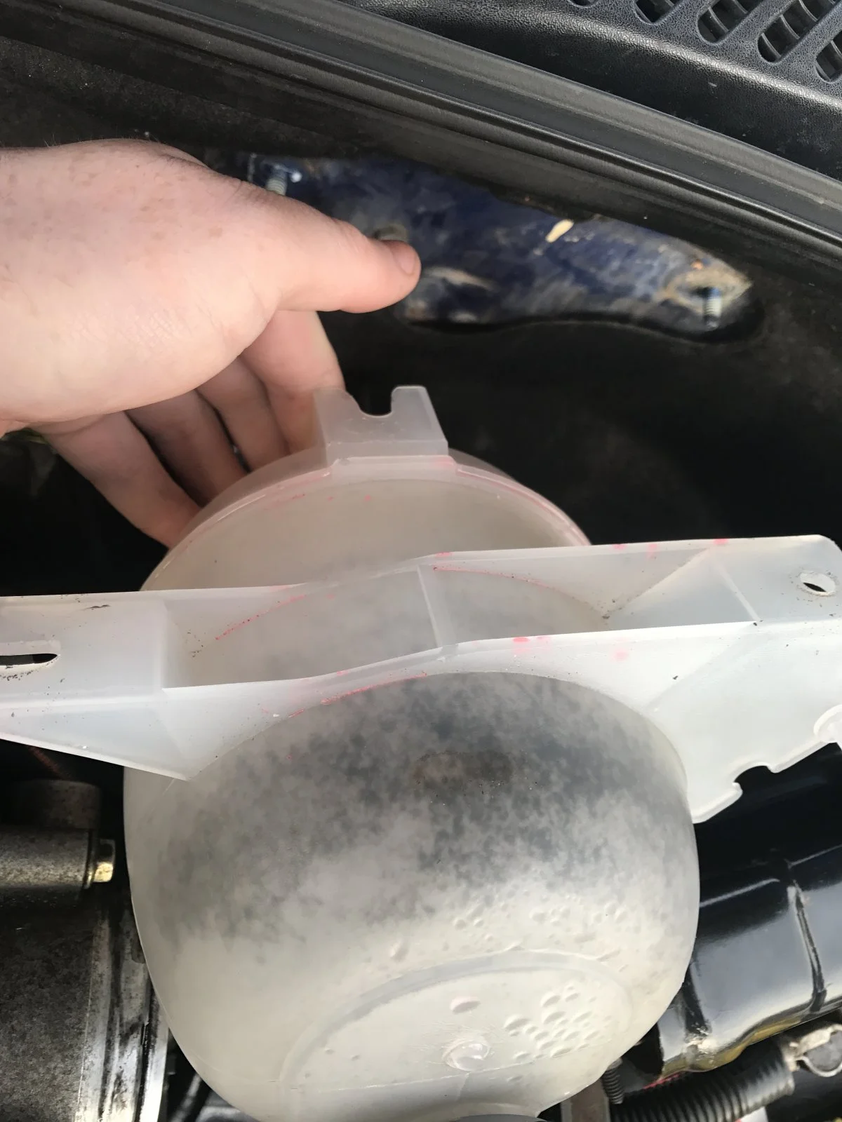

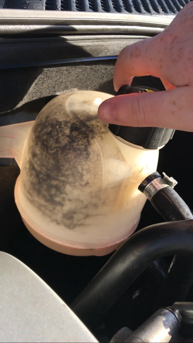

I feel your pain. My coolant stays clean but some s**t does make its way into the header when I get it stinking hot on track and stick to the sides. It's like a black sticky substance could be someone's put something in the past and it's being pulled through. I'm not sure. Will try and find a picture. Mine doesn't use oil and it's not contaminated. It's just bizarre.

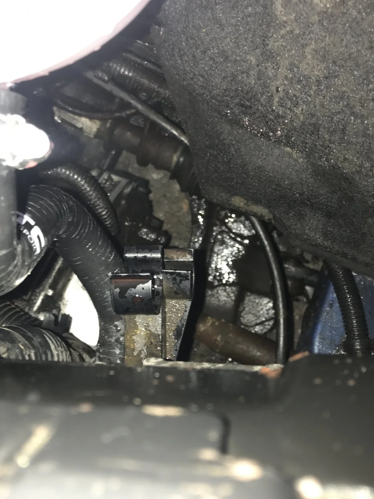

Flushing and bleeding the coolant system did jack all.

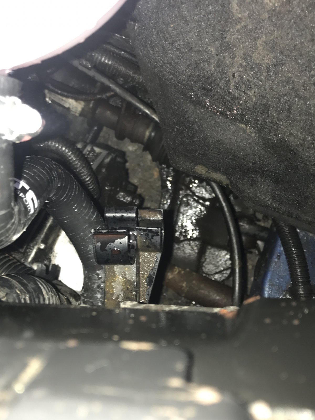

Header was topped to max yesterday from cold. Used the car for about 100 miles and it's near empty with evidence of coolant around the header tank (outside).
Loosing the will to live with it now. Can only image there's a problem somewhere in the block

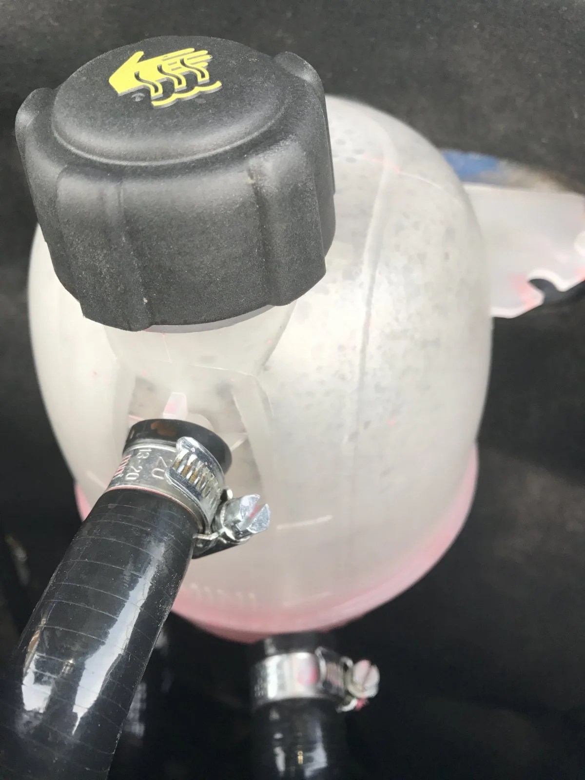

Chucking out enough on a 5 mile motorway blast 90mph (header was full when cold) to absolutely soak the subframe etc.
Something is really a miss.
