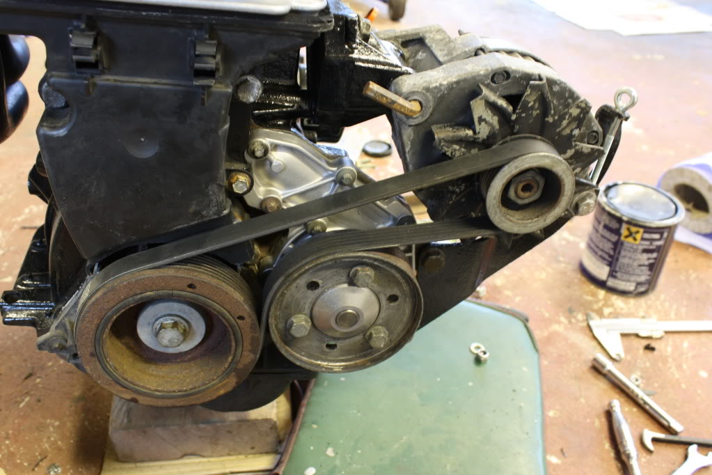

Yeah as above was still having issues before we placed the water pump, hence why it was changed.
It's routed the same as this as it's running EPAS @bashracing
