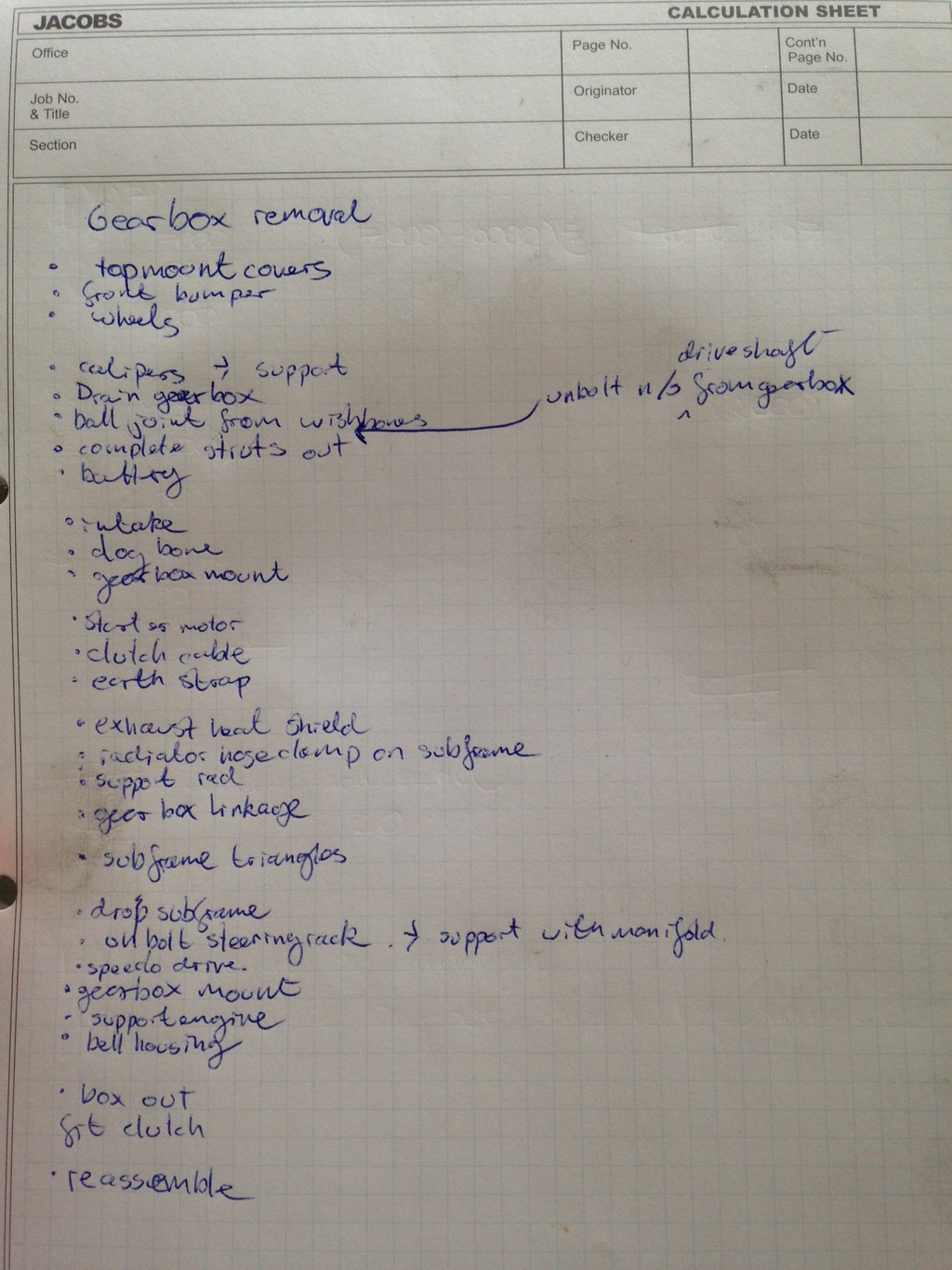

Depends how you do it but if you're dropping the subframe this is a rough guide.
You need to split the box from the engine to do the clutch, so yes all this bits need to come off first.
It's not a difficult job just long winded.
That's only if you drop the subframe completely but I really think that's the easiest way from my experience and takes hardly any longer than just dropping one side of the frame. Each of those jobs is pretty easy :) A couple of us did a box and clutch change in just over a day recently which I'm sure people would say is slow but when you don't have air tools is very difficult to do faster.
