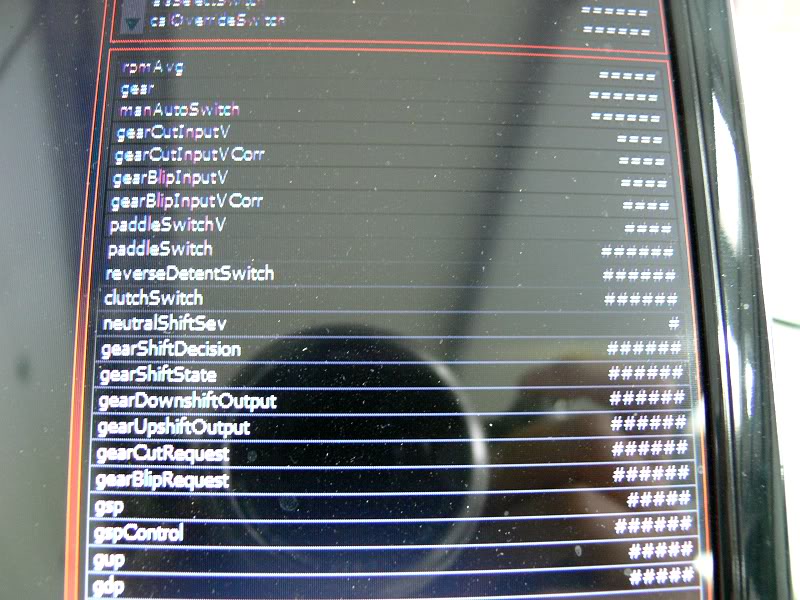

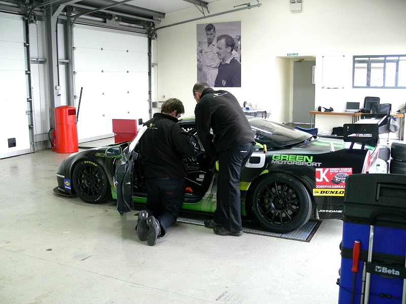

Plugging in the laptop, the actuator was overheating, despite being moved to the passenger floor rather than in the boot (near the engine). The boys played around a bit so my dad would have a better session.

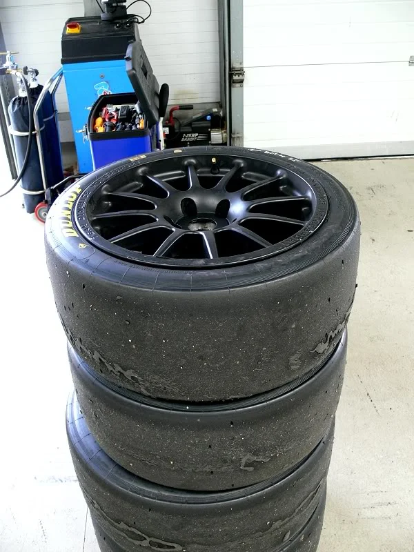

Just as the session was going to start, we got a thunderstorm! Cue tyre change...
Those Dunlops cost more than the wheels, eek!
So my dad went out, but unfortunately nothing had changed. Other than it had dried out and he had shagged the wets in about 20 minute of driving...lol.
I went out again next, accepting the problem. We could actually just turn the ignition off and on whilst on the move. The reason it would overheat is that it would switch off down the long straights (because it didn't have to change gear), and then suddenly wake up for another gearchange. When shutting down, it needs time to cool down, but it didn't get the chance, and so the issues. By randomly changing gear everywhere, i kept the actuator 'awake' and got round the problem with a mere one restart a lap. If anything, it was good practice, you don't always get a perfect car mid-way through a 24hr race after all!

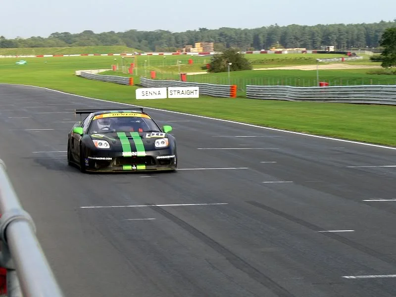

We then let our mate have the last session, where i got a couple of crappy pics on track.
After initial frustrations then, we actually got a fair bit of time in the car and i'm pleased with the potential she's showing. We plan to race it in a long race at Brands near the end of the season now.

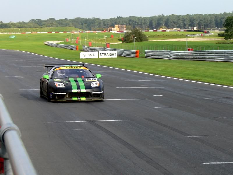

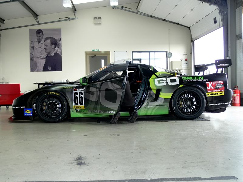

Didn't notice the Senna board, nice spot!
Thanks guys, thought the photos were pretty rubbish. Really want an SLR.

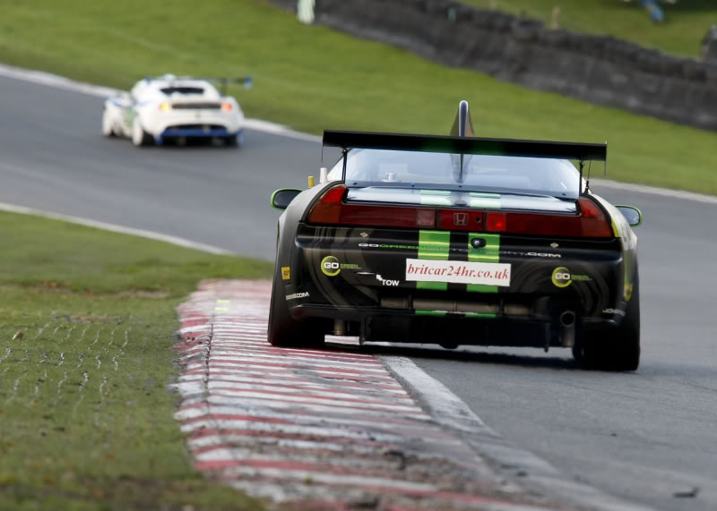

Forgot to mention that, if you look closely, the spoiler now has a tiny gurney spoiler on it held on by tank tape. Transformed the handling and stopped graining of the rear tyres; amazing what a little mod can do!

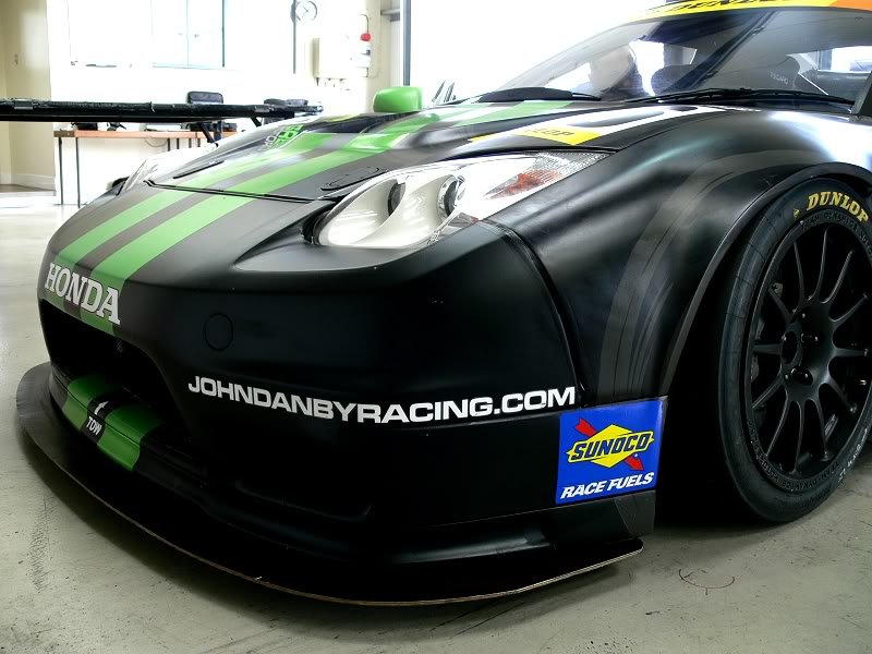

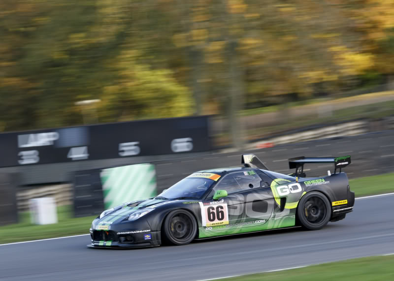

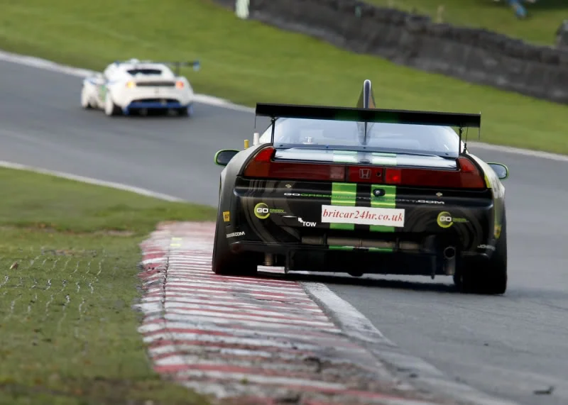

So things haven't been going that well reliability wise, as usual, but here are some cool photos Nick took at the weekend during testing. Note the grey lights - NSX-R lights are discontinued, but i will find a replacement!
The Lotus runs it close TBH! We weren't the only ones that had issues, but it doesn't make it a pill easier to swallow ...
