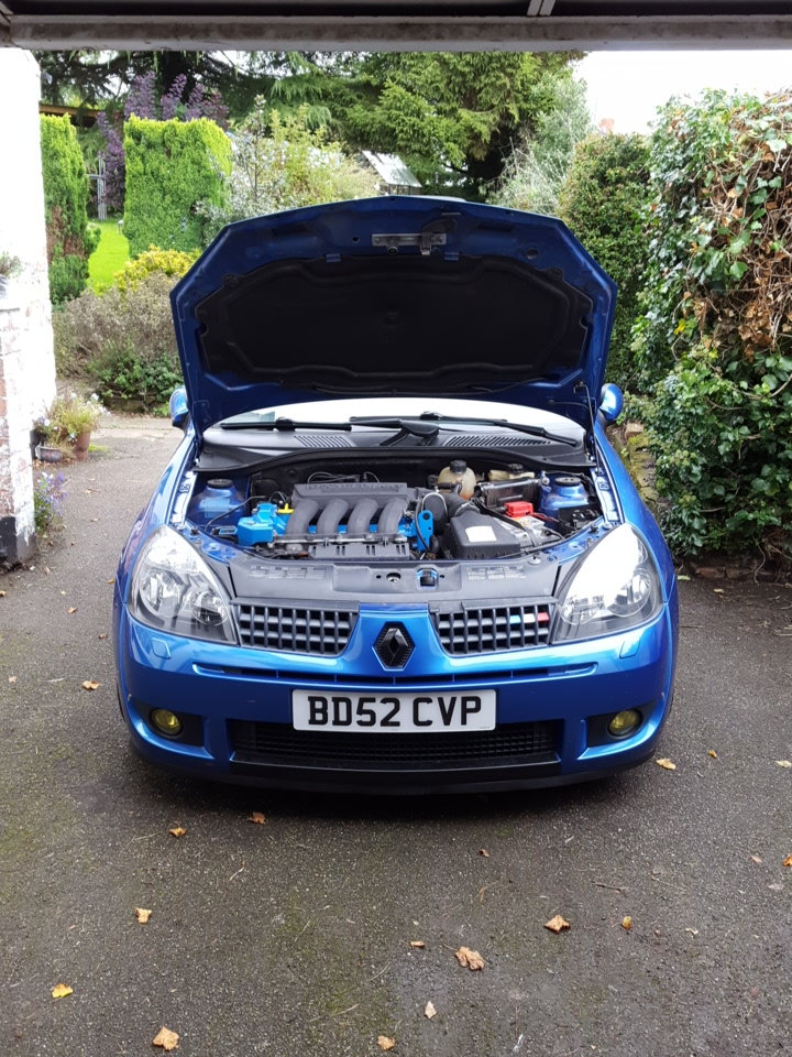

I changed my spark covers and painted my rockers & inlet just the other day. I sprayed the inlet mani, but paint the rocker in situ mate, just with a brush. You can't remove it as it pins the cams in place. I used high temp brake paint. Not the neatest job in the world but looks far better than before.
I also managed to snap the head off one the inlet bolts as well, funnily enough. Seems they're made out of paper mache! They're just a standard 10mm bolt but need a bit of length to them, I had a s**t load of them knocking around after breaking my old 106 GTi.

@James172C dude your engine looks well nice. I don't have a fuel line cover atm. Did you take of all of the manifold off including the underside bit that fits to the block?
How did you paint the bit next to the rocker? On the left. Engine mount bit was that just paintbrush to.

Manifold is just one piece mate. 3 bolts at the front, 2 at the back iirc.
I cheated and just painted the engine mount in situ with a brush- again not the neatest job just got to take your time.
People say normal paint is fine, but I went with VHT just to be on safe side. And I can pick it up just as cheap anyway!
Also , a word of warning, don't trap the HT leads under the inlet mani when re-fitting, it will likely cause a misfire. I did this and couldn't work out wtf I'd done wrong. You have to learn one way.

@James172C that's the top half there is a bottom half that does come off. Normal where people connect throttle boddies or ITBS. But I'm assuming you just painted the top Inlet in that case. I'm tempted to just leave the fuel guard off tbh. But I'm debating. I can always buy the bolts. Just another thing to clean up. And paint.
Well cheers I'll get some new 10 mm bolts when I can. Still need some bolts for air box though. They are those cursed hexhead ones. That are very rusty. I might just take them out give a measure and see if I can get anything close
Jamess182
Ah yeah, I'm with you now. Nah, I didn't both painting the lower half. I like the fuel rail cover but can't imagine it making a huge difference to the look if it was removed.
