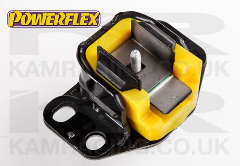

Yes, I have experienced this.
I have camber adjustable coilovers, and when running with negative camber, the RH driveshaft would bind when lent on hard in lefthanders.
As proof, adjusting out the negative camber stopped this, as it moved the wheel bearing away from the engine/gearbox assembly.
Your cheapest option is to see if you can move the engine over to the left, as the top RH head mount is slotted, and install one of Powerflex`s inserts.
Photo courtesy of Kam racing.

Yes & no, in that order.
Occurrence was just before the inside rear becomes airborne on left handers in my case, though I have read of at least one person experiencing the same
problem with the LH shaft on Paddock at Brands.
The standard mount was recent anyway, but if you are considering replacing the original mount & using the insert, you might as well replace it with a
Vibratec/K-Tec mount for very similar money.
The shaft on mine at the time was a low mileage (15k) genuine exchange unit, before someone throws after market shafts into the speculation, and the wheel
bearing had only covered 3k miles, and is still holding up 33k later.
