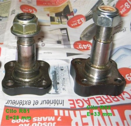

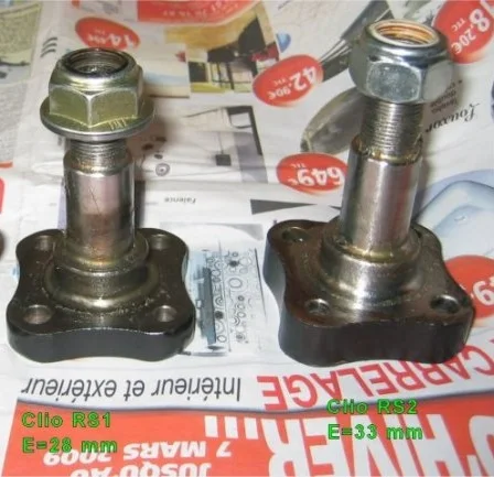

If you get a stub axle, you need to make sure you get the right one as 172 and 182 cup/cup pack ones are different (182 cup/cup pack are thicker).

Stub axles come in different thickness`s if you have a bent one.

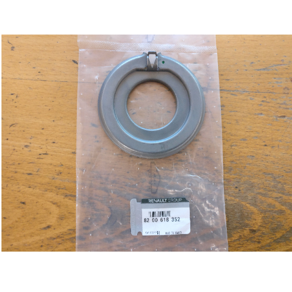

As I suspected, there is nothing wrong with the stub axle per se.
The problem is with the 2 pence worth mild steel shield which that is not supplied separately, but wreaks havoc with the ABS as it falls apart with rust, with
fragments building up on the magnetic reluctor ring, damaging the ABS sensor & bending the bracket already weakened with it`s own corrosion.
I`d be tempted to fit a new bracket, sensor & reluctor, and omit the shield.
172/182`s seem to get along just fine without one.

What is apparent is that yet again, Renault have stitched everyone up by not supplying a cheap piece of tin separately.
I found this Youtube video, which shows that all that is required is an ABS sensor, the shield, which acts as a guide, and possibly the reluctor ring.
Perhaps @Kev@KAM would love to get stuck in to this
Someone, somewhere is making these shields/guide plates.
I cannot find a proper picture of the sensor 479005024R, as people are using generic photos, and Bosch (0265008928) have not published one.
