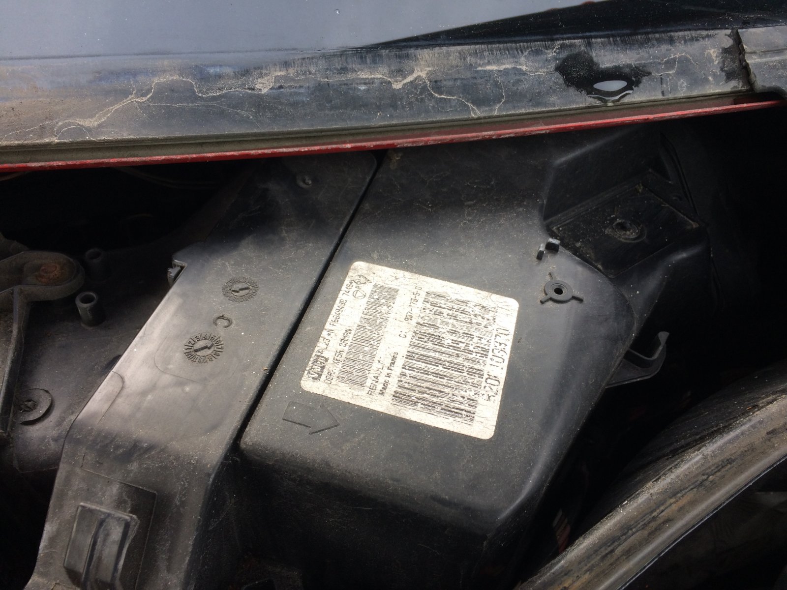

Has a no fan blowing heater problem. Did my reading regarding the resistor pack. Went to try the swap.. and doh... there isn't a resistor pack at all in whatever air system is installed in the car. The hole for it isn't cut out the box and there is no wiring.
So my question is.
1. Is this normal on a Trophy? I just assumed it had the same system as the 182 but without the climate control. My guess it's been tinkered with.
2. If it is normal what would be the fault then if Trophies don't have resistor packs.. assume some mark2 clios don't otherwise where did the air box come from?

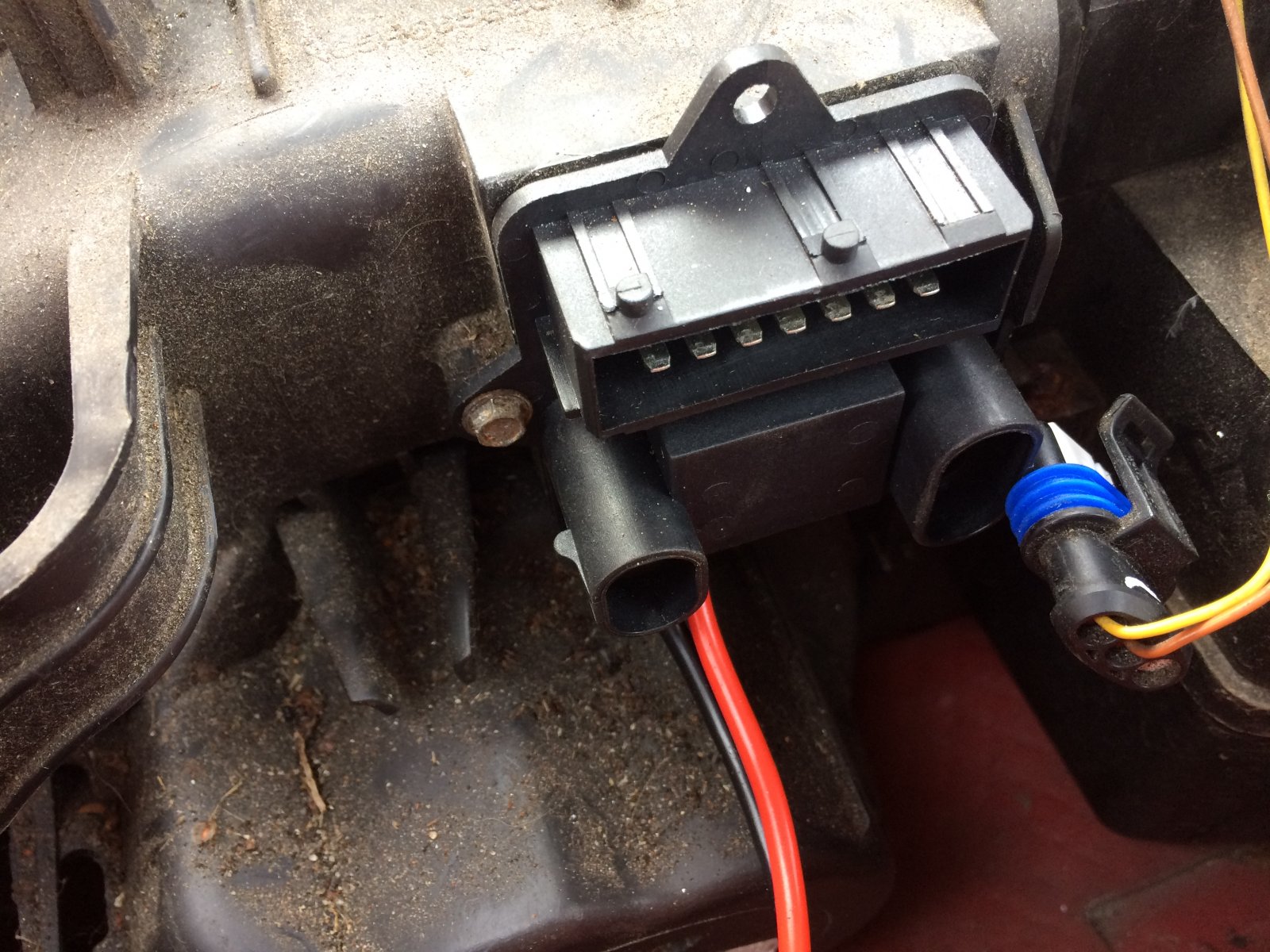

I stripped it all down and found the heater motor didn't actually spin with a direct source of power. I bought a s/h unit based on the part number. That does spin with the same direct power test. Unfortunately I'm
Not near the car to test it all out again.
