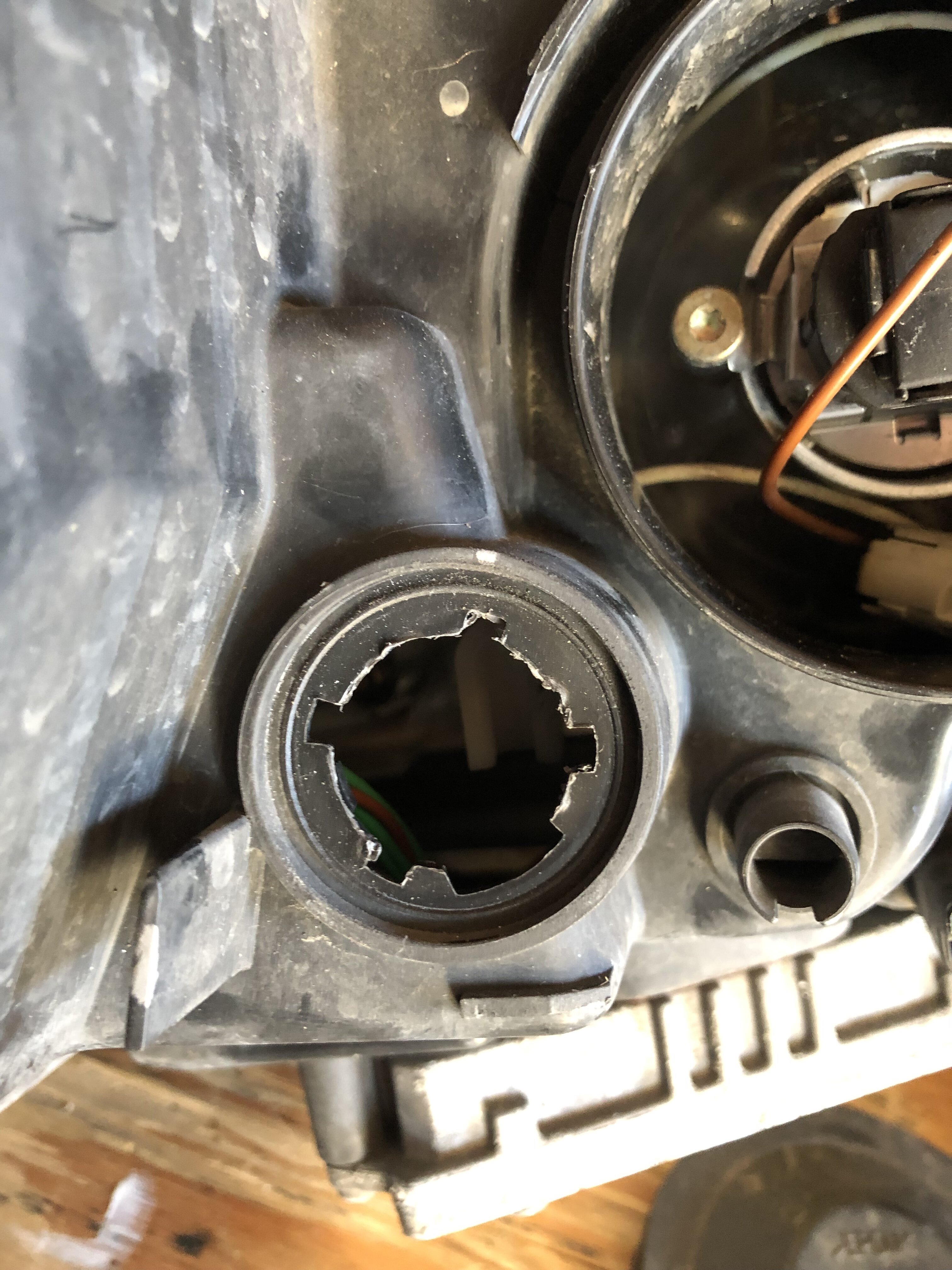

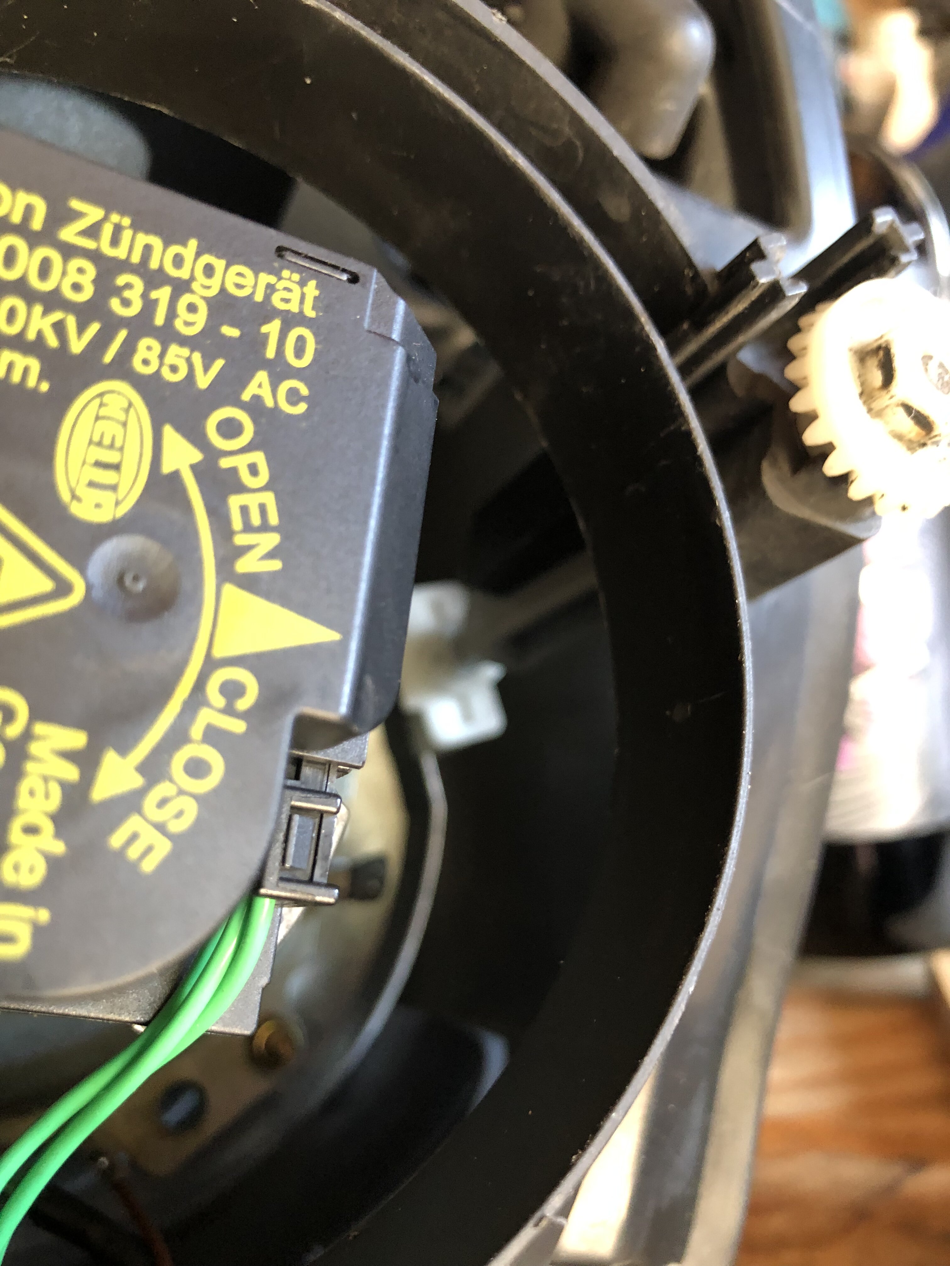

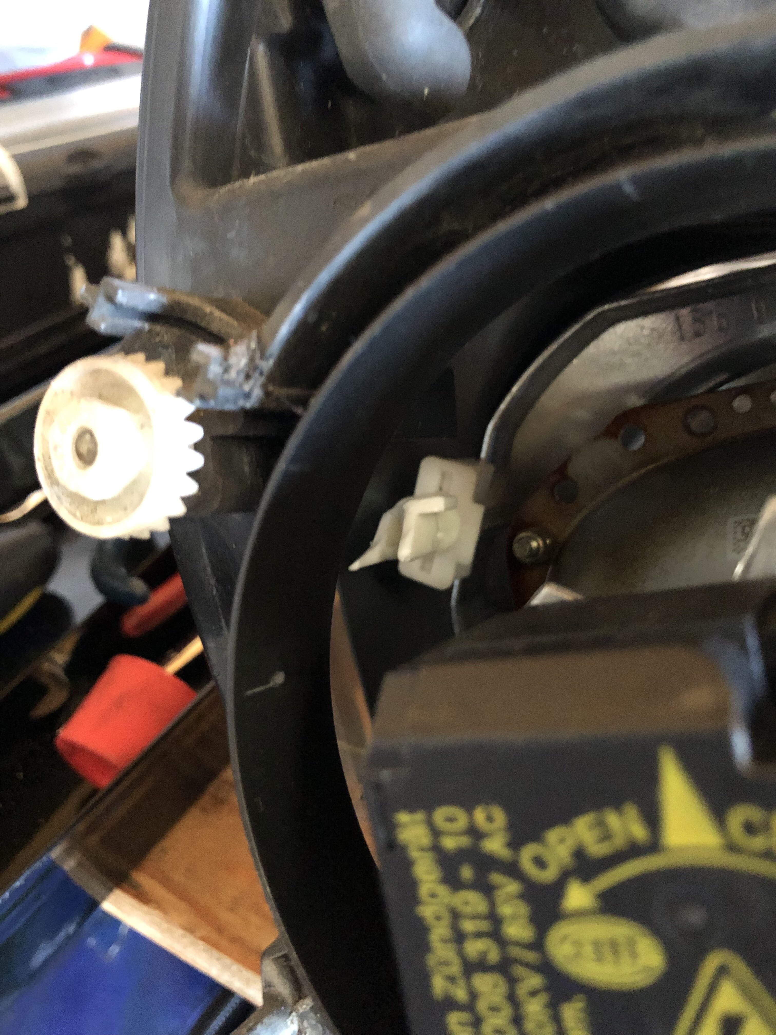

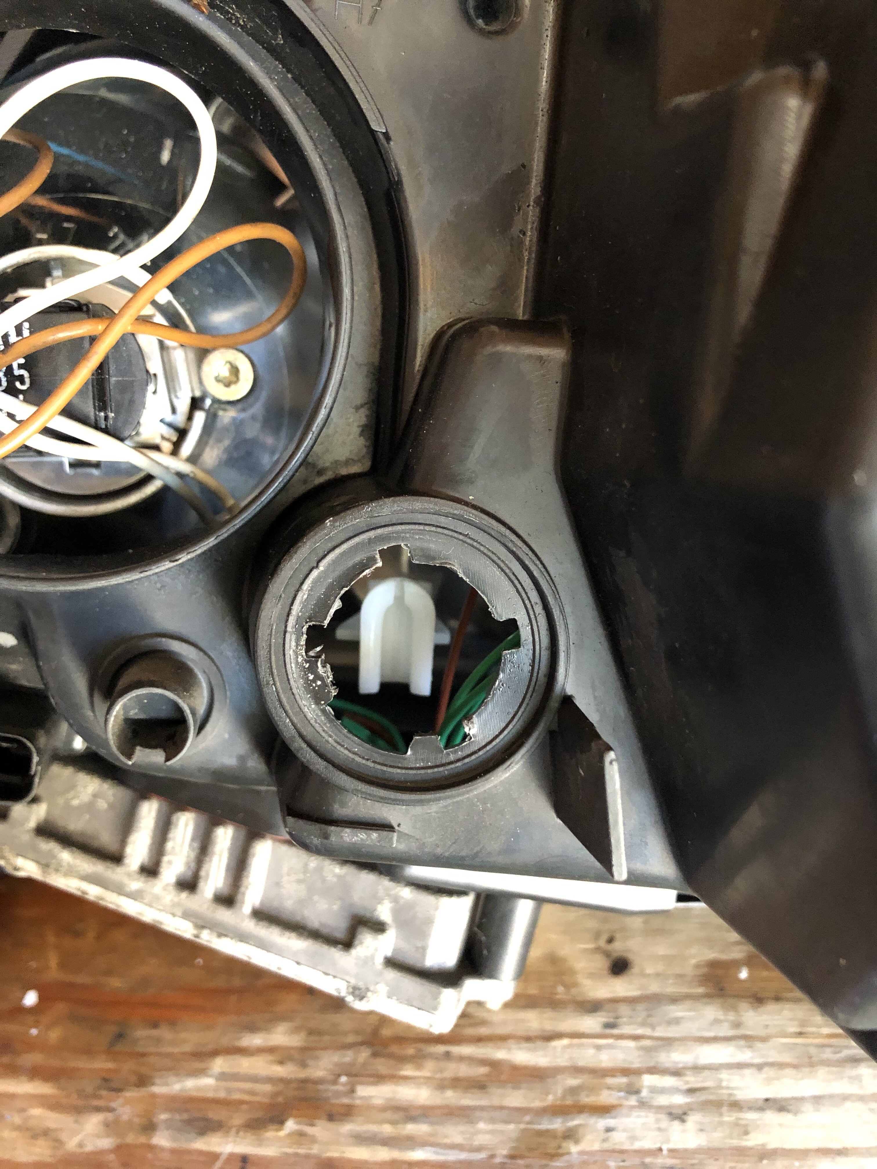

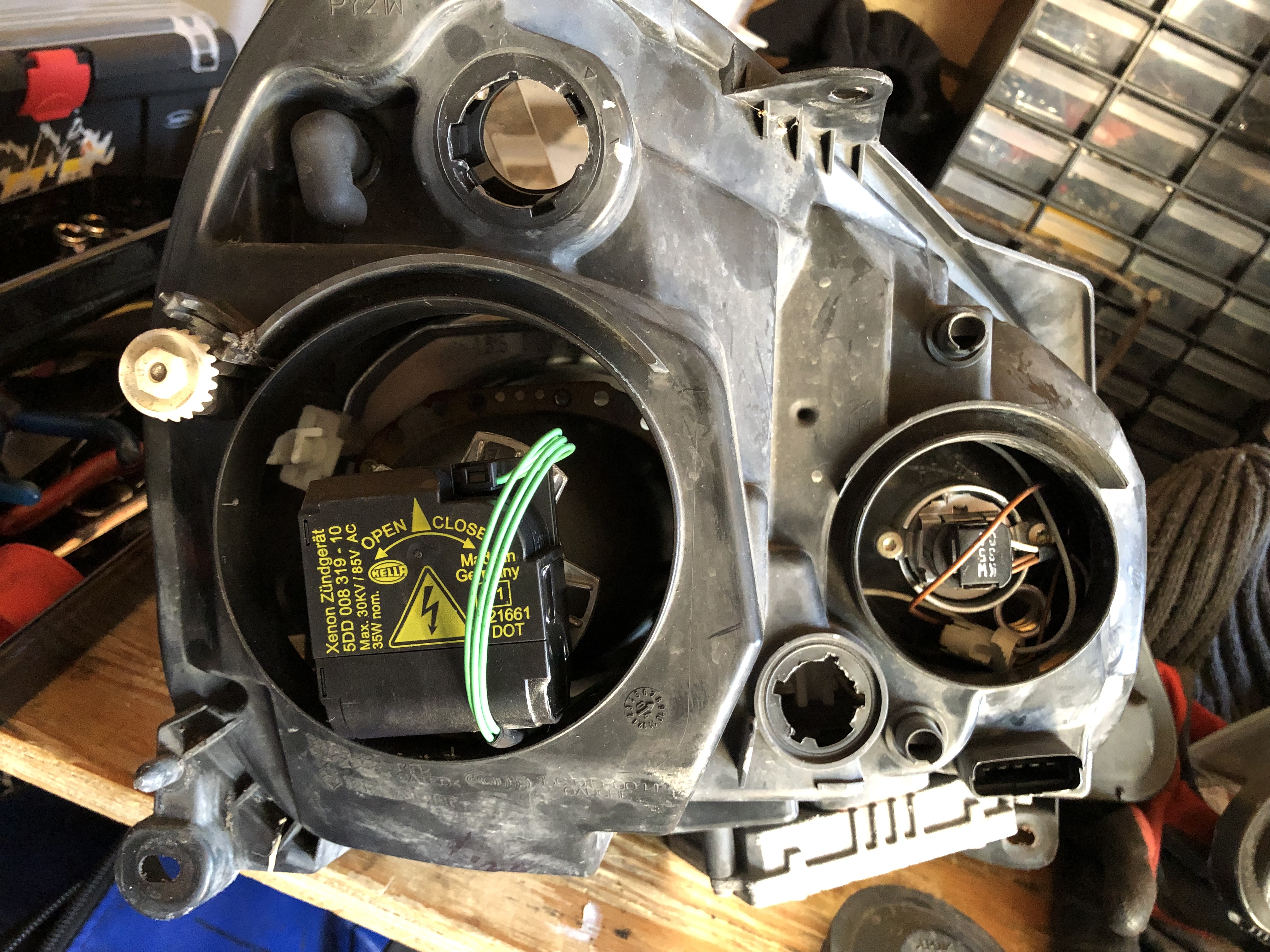

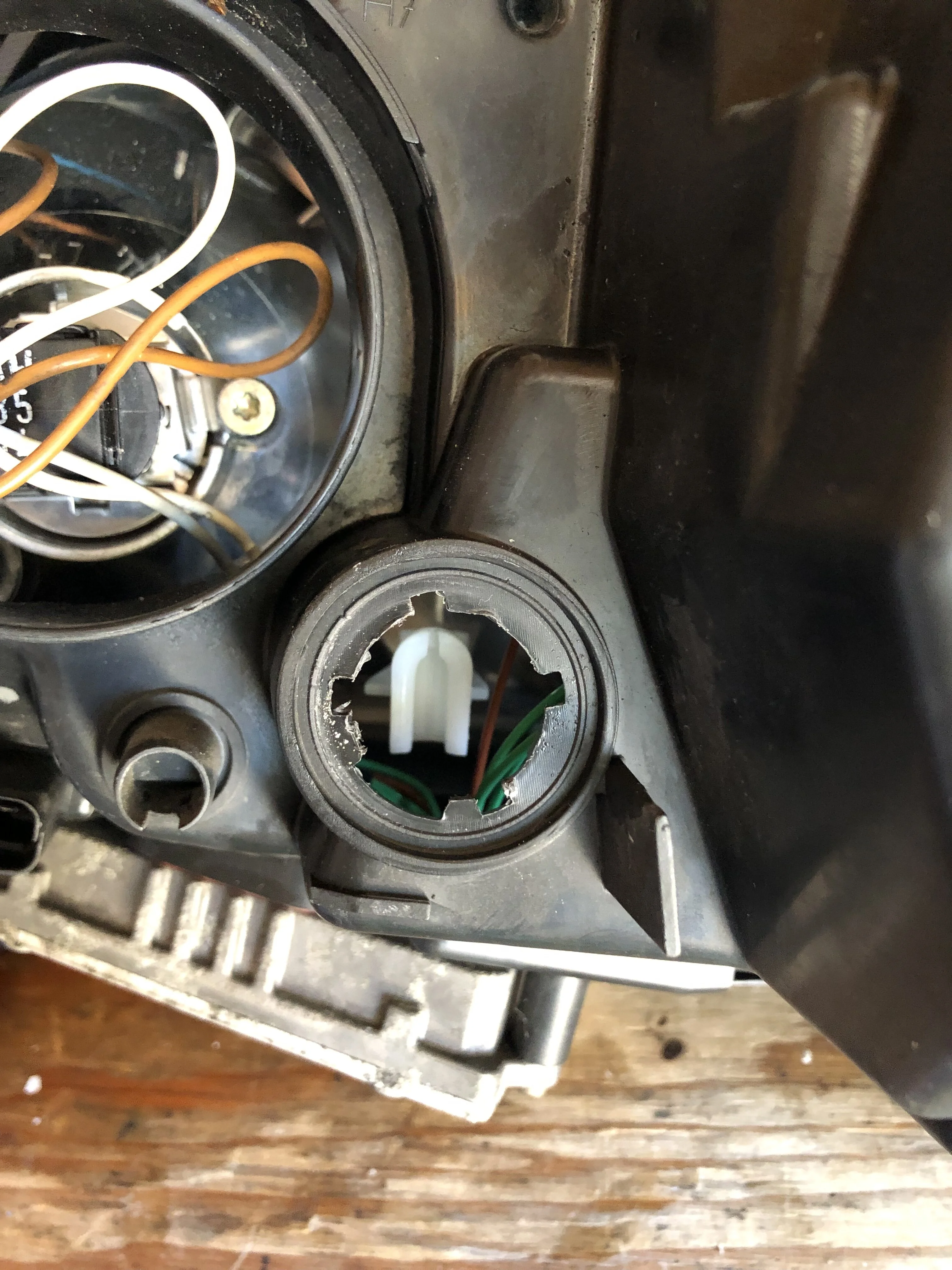

So I have a pair of grey insert Xenon that came with the car when I bought it.
From what I can see one adjuster is broken and the other is ok but it looks like I’m missing a couple other bits. Can anyone advise what bits are missing? I have the rubber covers and indicators holders.

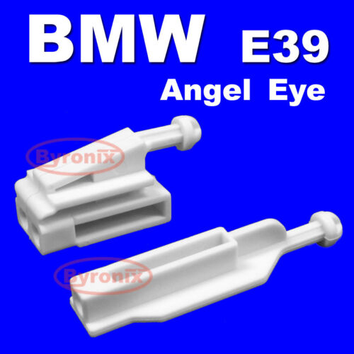

As I'm sure you b know the adjuster you want are these:
The other holes near the bottom are for the auto height adjuster. Without them the interior of the headlamp will bounce up and down. I have some spares if you need a pair mate.
Honestly @Porl I love you! Haha
