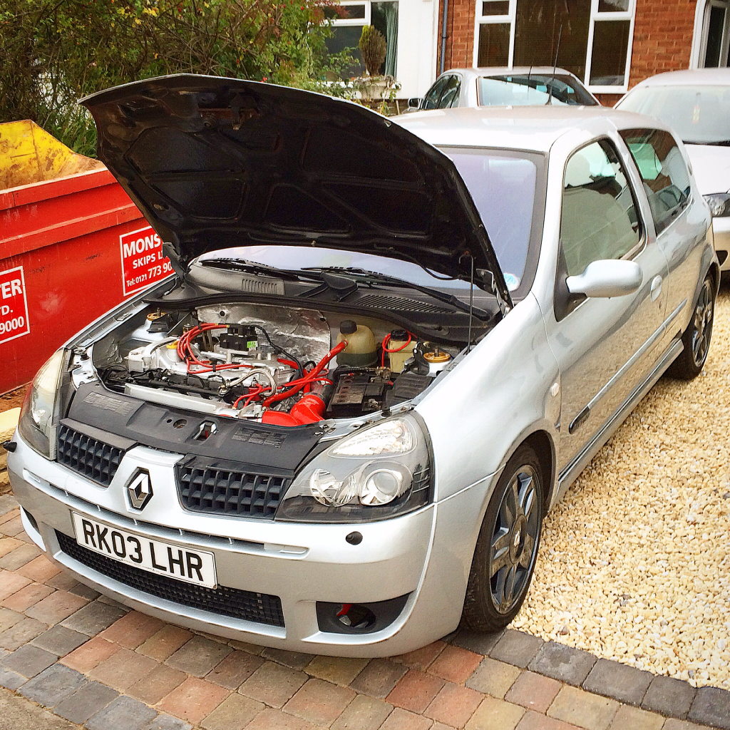

Off to efi parts tomorrow...
  Clio T 314hp c43 AMG
4 years ago I entered into the world of forced induction thanks to t.trophy (Steve Haswell), I bought his lpt kit of him that was once fitted to his trophy, It managed 222hp and was great, needless to say I was warned by Steve I'd want more so 4 years later and several thousand pounds....
In theory it's capable of 350hp but il let chris at efi work his magic and see what happens, fingers crossed and wish me luck because if it goes bang you may see a for sales thread pop up!

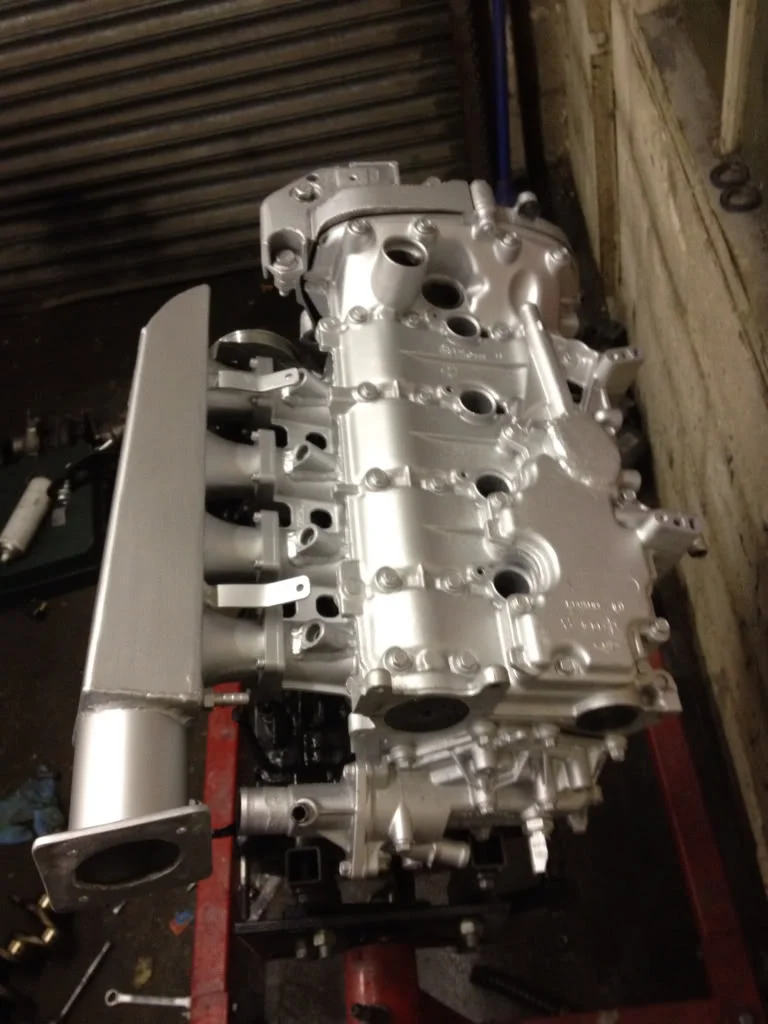

Thanks :approve: Gt2860rs fully forged engine and a direct to head inlet from focrs based on jenvey throttle body trumpets.

Thanks mate, me to! He made a start on it today... Base map, adjustments to the fuelling, some bedding In time, bit of a issue with the inlet I fitted as the angle of the injectors isn't the greatest for the amount of fuel il need to flow, but Chris is trying is best to work with what he has.

What angle are your injectors? Any pics?? Also what injectors are you using?
Ive got a custom inlet too but hope I've not got any issues. Did a lot of research before making it so should be alright.
There to steep and the fuel is wet walling? I assume it's gathering in the base of the trumpet on the manifold when spraying, it was made by focrs I think he may have assisted with yours? I'm pretty sure the angle is standard jenvey, could be wrong... Problem is I don't il be moving up to 630cc injectors because of this and sticking with 480cc meganes, Chris knows his onions so it's in good hands.
  172 cup, Impreza P1
Similar to mine from that pic so might have the same issues. What injectors are you using? 630cc dekas?
As above possibly have to stick with 480cc and focrs made the inlet, not for forced induction though.

Would have put the injectors on the second part of the manifold rather than the Jenvey manifold which is mated to the head. Would be a lot better as they look to close to the head.

From the research I did it can help cool the valves by spraying the fuel onto them. As long as your injectors have a wide spray pattern.
On my inlet, I had not choice as the fuel rail would hit the plenum back plate. (mine are in the same place as this)
I guess no choice on my inlet either, can't fit them into the trumpet, anything that aids cooling on a project like this is good, it all helps.

inlets look awesome think he needs to make one for mine ;) ...good luck with your mapping
Think he's got another one ready. Then you can fit the ph2 throttle body and not have to use the smaller inlet on the megane manifold.
You'll need a megane flange as I got him a clio flange waterjet cut.
I'd use the ph1 as I'm on cable now and the wirings been cut lol
Guessing that's for bolting to the head?
  172 cup, Impreza P1
Yeah, its the head flange. Different bolt spacing on the megane but if I can get a megane gasket I can get one made to suit.
