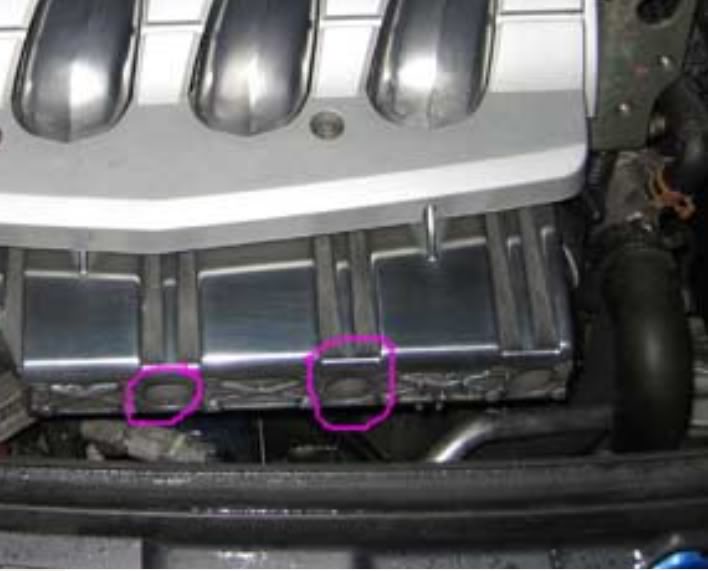

good morning,i need help as i dont know what oil to put in my 172 clio as it needs some putting in? and im just about to go and buy some and also is it possible to change the filter yourself?

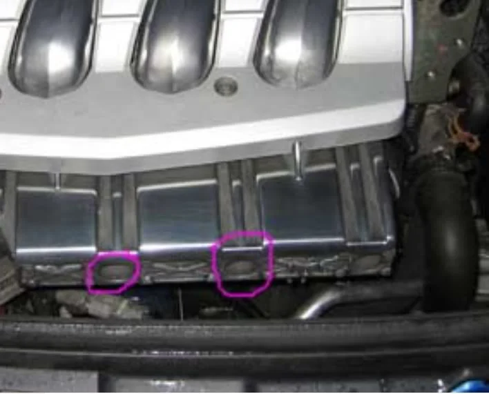

You want fully synthetic 5w-40 oil . Yeah it is possible to change the air filter yourself , but its a bit fiddly . Easier if you remeove the fuel guard protector which is 2 x 10mm bolts shown on the pic .Its 5.1 litres if you change the oil filter and 4.75litres if you don't change the oil filter , keep an eye on your dipstick as you fill it up rather than the oil level readout on the comp .
