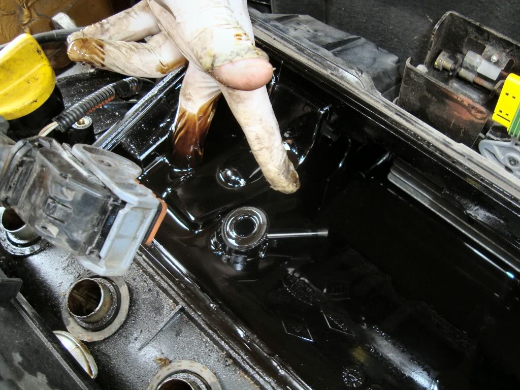

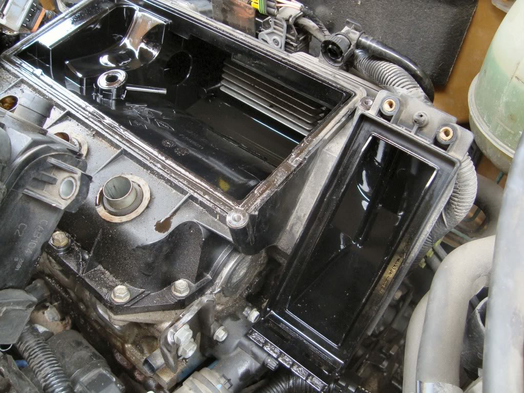

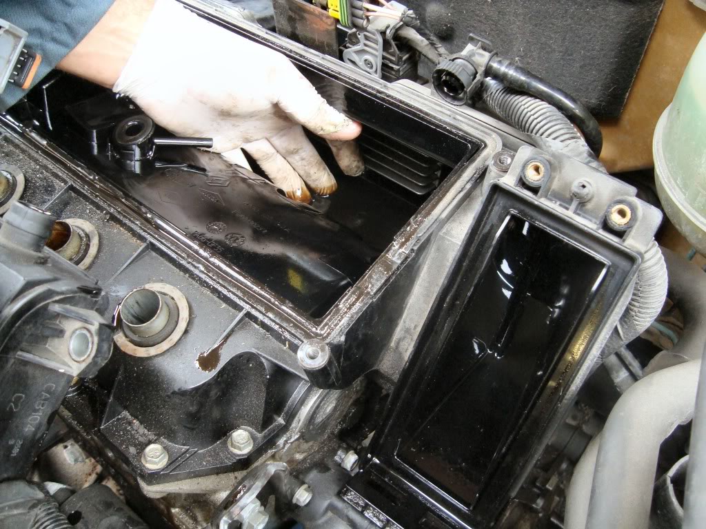

Here are a few pics of the oil.

cliokiz, there is a breater pipe on the left side of the engine (driver side) this is where the oil came from I think because if you look at the first picture the little well where my finger is, you will see that it is higher up than the rest of the oil to the right, so must have been comming from that side.
I will grab another photo of this pipe when it's light. Who knows how much over filled it was, as I have no idea how long it had been leaking from the air filter box before I got the car.
