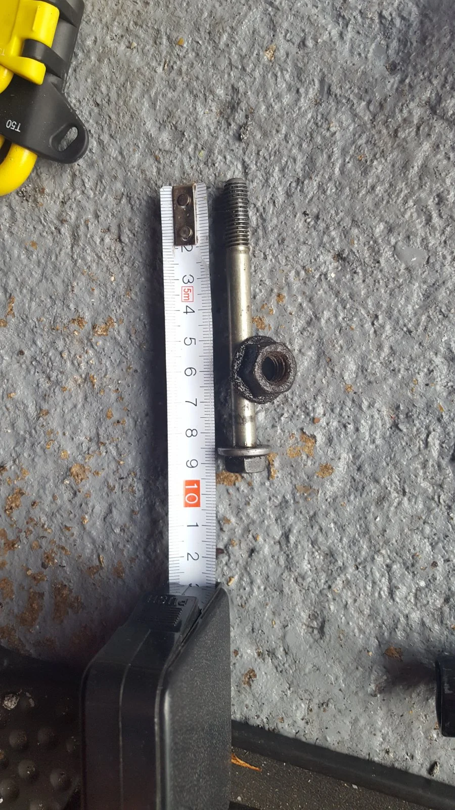

so I take my engine undertray off and it's covered in oil aswell as the sump etc and gear linkage etc..but then i find these 2 suspicious looking items on the undertray
they don't fit together so that's worrying me more.

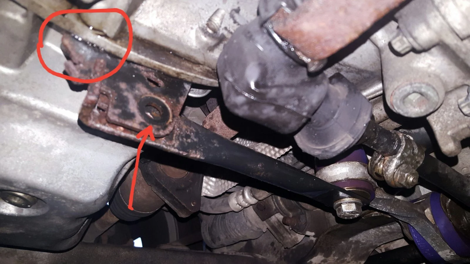

after cleaning the excess oil away 2hours later I had a look and found oil collecting here (red ring)
and is something missing from the dogbone?
so I have an oil leak
big bolt missing
small nut missing
somebody please help me haha

nut goes with the bolt that's missing off the dogbone bar, to find the oil leak best to clean everything first and check again after a couple of days, could be from cam bungs or anything below them.
bolt could be from a few things but can't place it 100%. not sure where the tape measure goes either.

cheers for that tape measure comment :tonguewink: I used some wd40 degreaser to clean the wet oil areas up but will have to wait till the morning to see what remains.

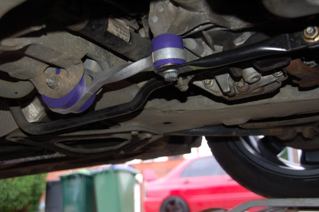

can someone show me how the dogbone bar should look?

just stick bolt through the hole in the bar/bracket.
check the upper bolts on the lower inlet and make sure they are all there.

@flebay nice thanks for that I'm definatley missing the bolt from the dogbone bar!
would that explain my recent on going small oil leak?
