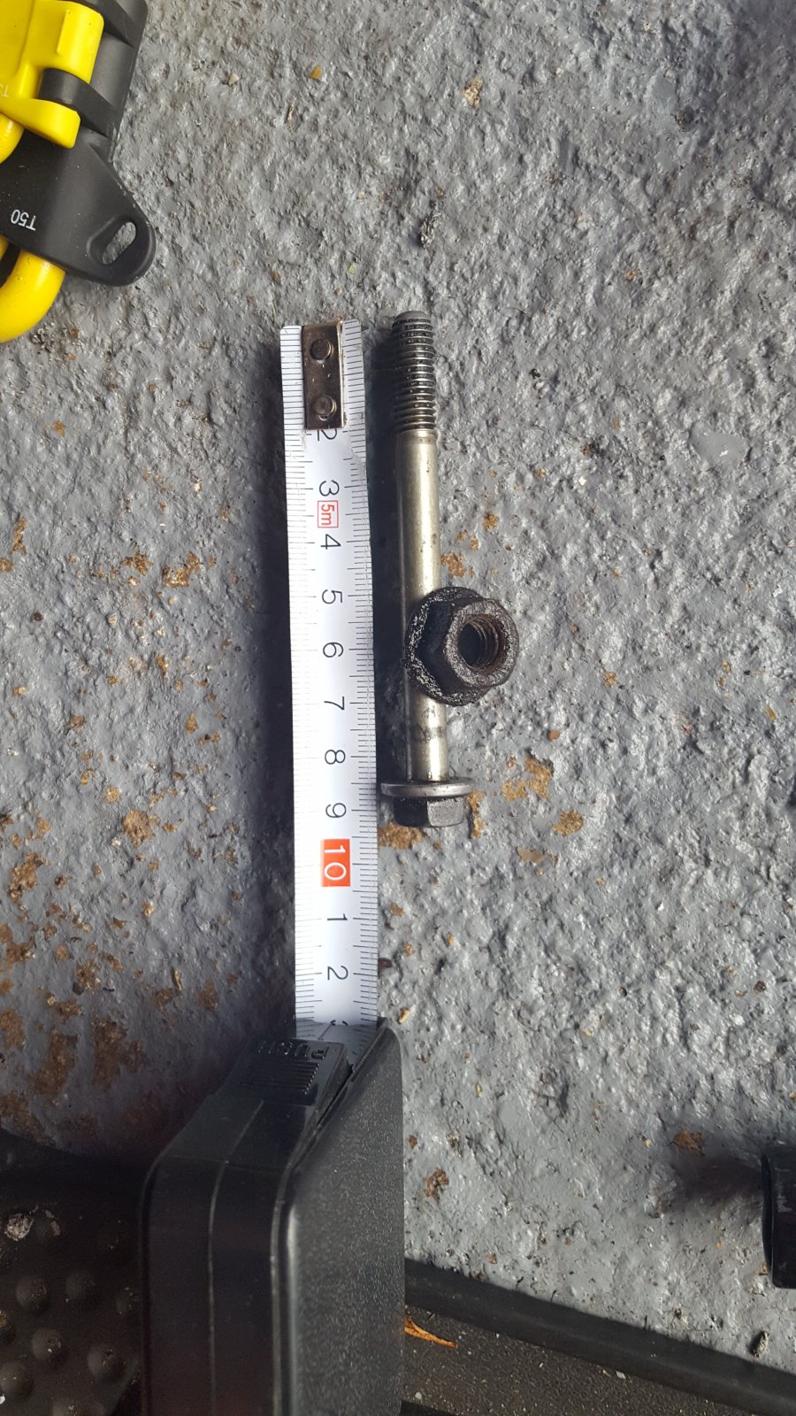

so I take my engine undertray off and it's covered in oil aswell as the sump etc and gear linkage etc..but then i find these 2 suspicious looking items on the undertray
they don't fit together so that's worrying me more.

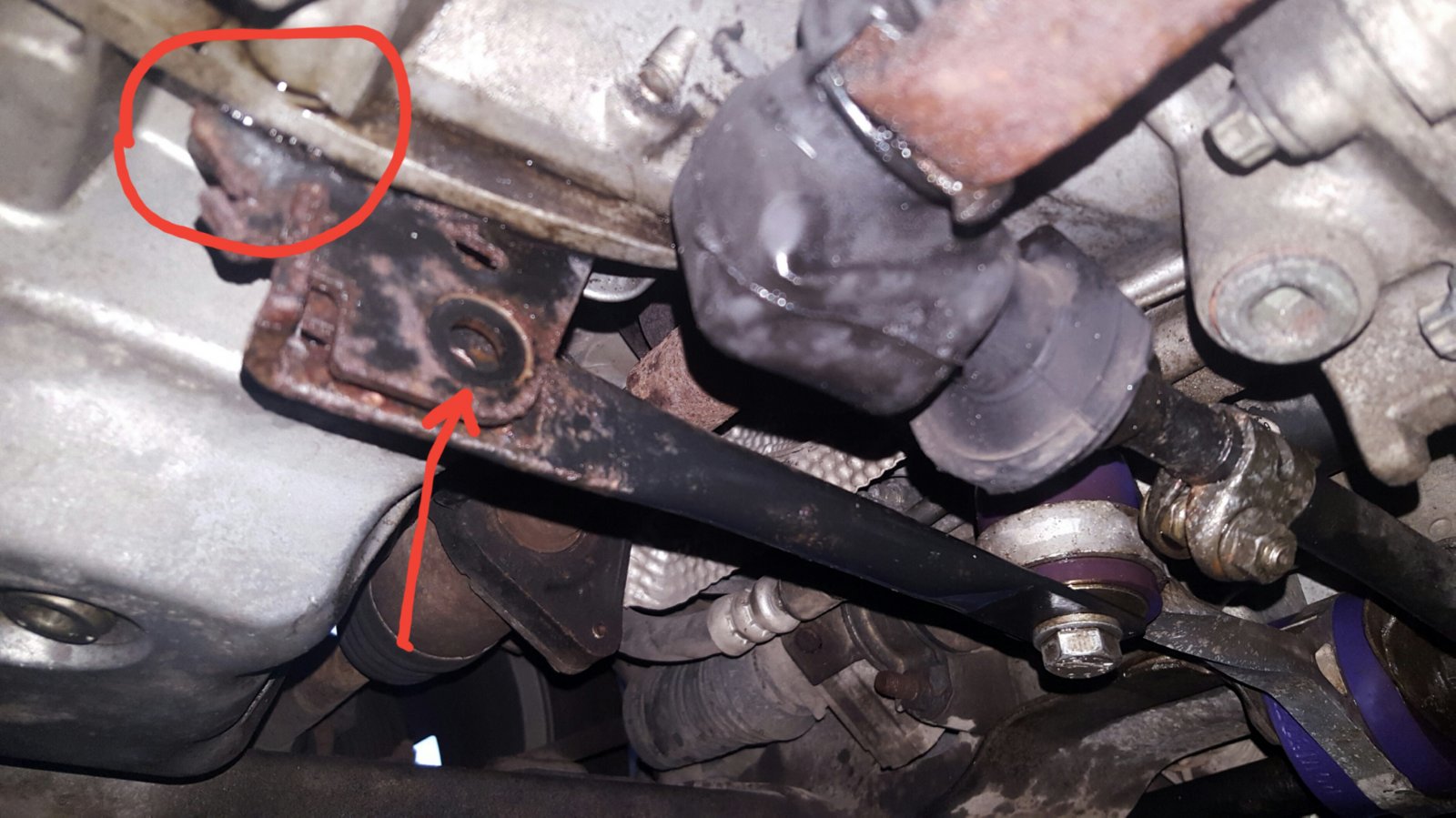

after cleaning the excess oil away 2hours later I had a look and found oil collecting here (red ring)
and is something missing from the dogbone?

big bolt missing
small nut missing
somebody please help me haha
nut goes with the bolt that's missing off the dogbone bar, to find the oil leak best to clean everything first and check again after a couple of days, could be from cam bungs or anything below them.
bolt could be from a few things but can't place it 100%. not sure where the tape measure goes either.

can someone show me how the dogbone bar should look?
as for the bolt? the only work I've had done (4months ago roughly) is full cambelt serivces etc, oil and spark plugs etc, new altenator, new battery, engine mount and dogbone.

just stick bolt through the hole in the bar/bracket.
check the upper bolts on the lower inlet and make sure they are all there.
I had oil leaking badly on the cam belt side.
I spend hours looking and i could not see where it was coming from and it turns out it was the cam seal on that side so while it was in for the cam belt the whole lot was stripped and new cam seal replaced along with sump gasket, I believe the oil sump and pump need to be removed to change the seal.

@flebay nice thanks for that I'm definatley missing the bolt from the dogbone bar!
would that explain my recent on going small oil leak?
@flebay I'd already done that cleaned away and waited for the drip return.
I ran the engine on tick over for 15mins to warm up and the oil drip was dripping every minute or 2 when warm? (but no oil light or warning like last time)??
I can't seem to trace where it's coming from though? it looks like it coming from between the engine and gearbox casing if that's possible?

Could be the rear main seal or the sump gasket.
