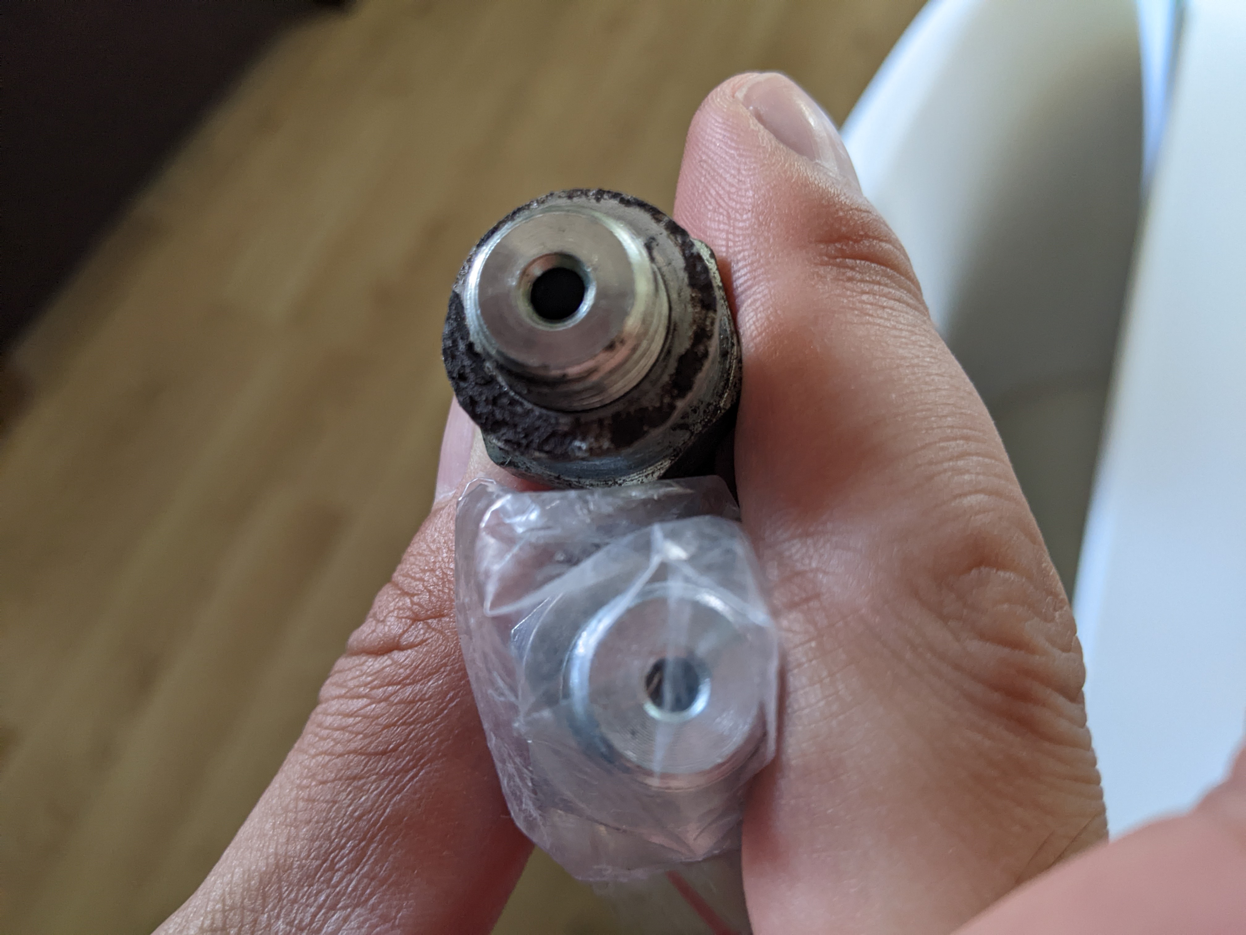

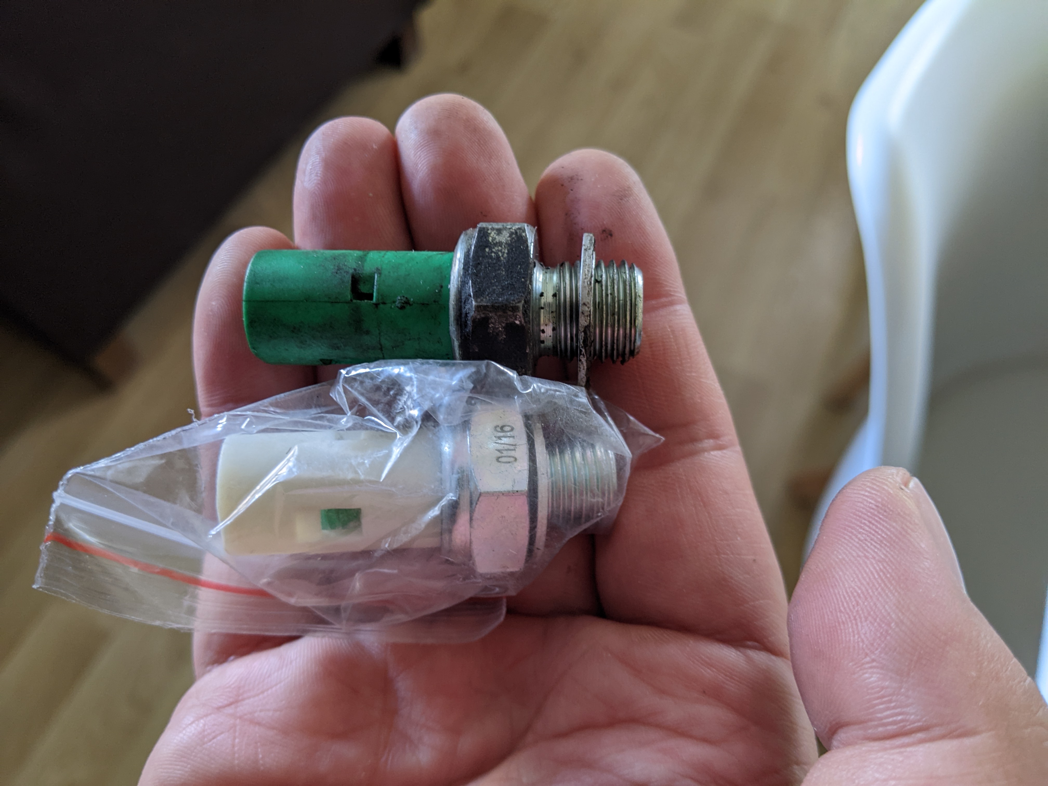

Hi all!
I have been getting the dreaded oil + stop light intermittently with my 182 even though it has been pressure tested at Two Techs with flying colours. I have realised that I have the green body oil pressure sensor installed on my car (8200671286) which seems to have a different plug + pressure of 0,20 BAR vs the 182 grey body sensor (8200671279) which has a BAR rating of 0,50. Anyone else come across this or been running the green body sensor on their 182 without issues?
