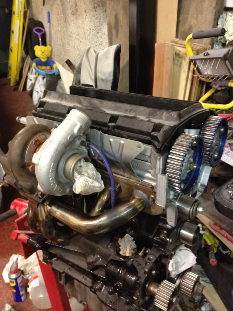

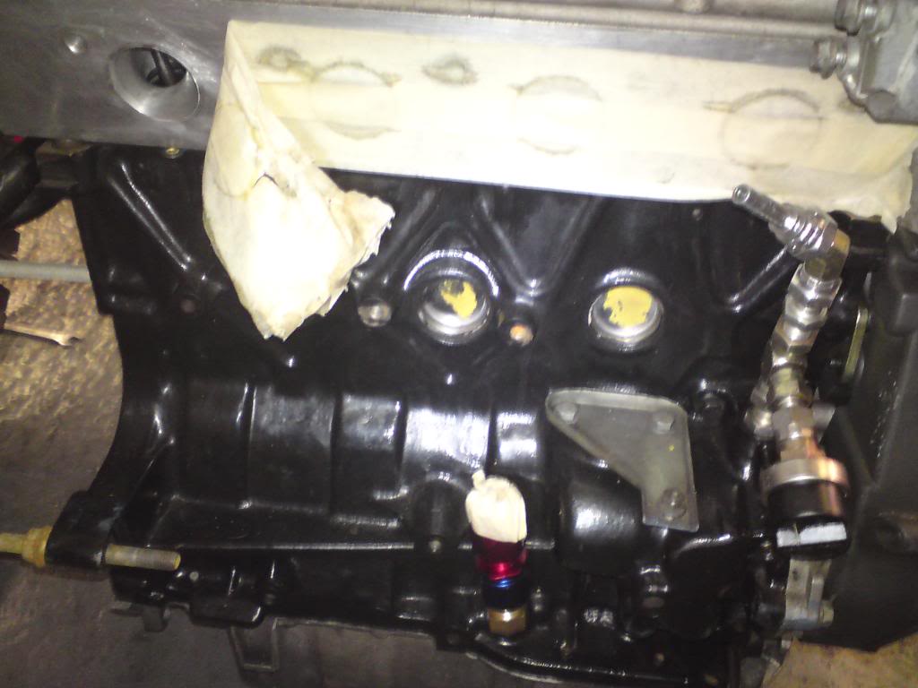

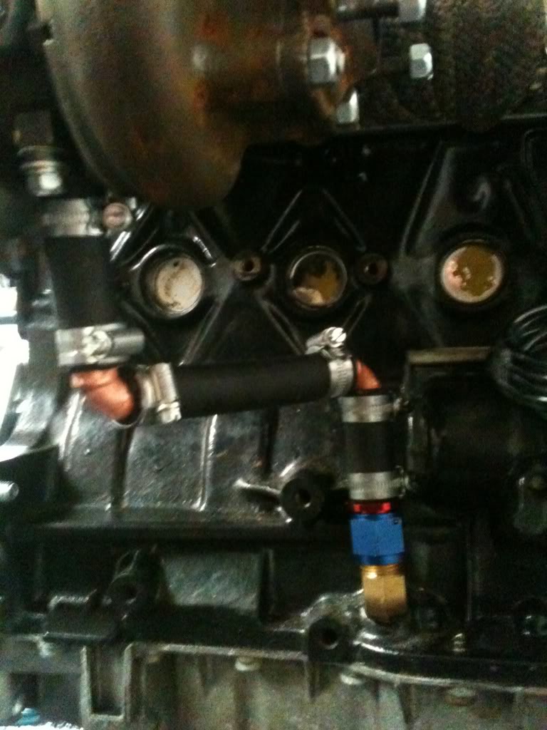

  BMW 535d
Considering mine is an F7R too
That last picture, I mocked that up ad a template and took it to pirtek to make a proper one. As long as it falls and theres no where for oil to collect then thats all that matters...
Oil return was a pig for me too
It is shaped like that because I have a williams box so it had to be like that to pass the williams starter motoir

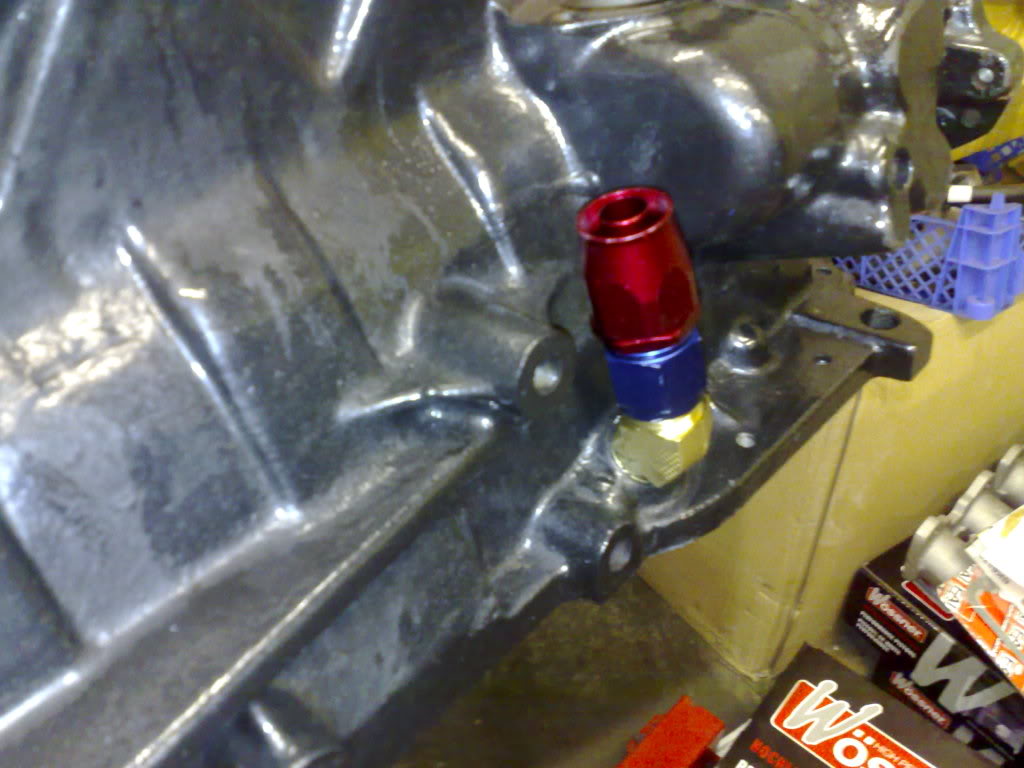

  Ph1
Top of the sump is fine.
No need to pay silly money on the fittings either.
Go to a engineering place rather than searching anything ''car'' based. I got mine for about £1.50 - Equivalent ones on ebay are a tenner for exactly the same thing

I have plenty of similar fittings but I had reservations of having a nut inside the engine that has potential to fall off
You don't have a nut inside the sump. Tap the sump, screw the fitting in and locked / sealed in.
If it was to fall off which it wouldn't, it would fall out the way

I wouldn't do that, what If the nut falls off? Mine is tapped and lock tighted been fine for the last 4k miles and that's with only 2 threads in the sump.

I have the same fitting as Andy used. In my built willy engine it's drilled into the flat spot but i have a LC meg. F7r too.
On the bottom off the block there is a hollow piece (dent/dimple). With the sump off i felt thats exactly where a bridge for the crank support bearing is. But just next to that dent on the right ive had enough room for 3 fingers before the crankshaft hit it.
So that would be the ideal place imo, enough room to use a nut on the inside!
