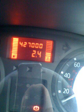

My old dCi clio was on 253k, both 172's I have are on 110k and 113k and I've seen plenty of 130k+ Clios that still run better than those on sub 60k miles

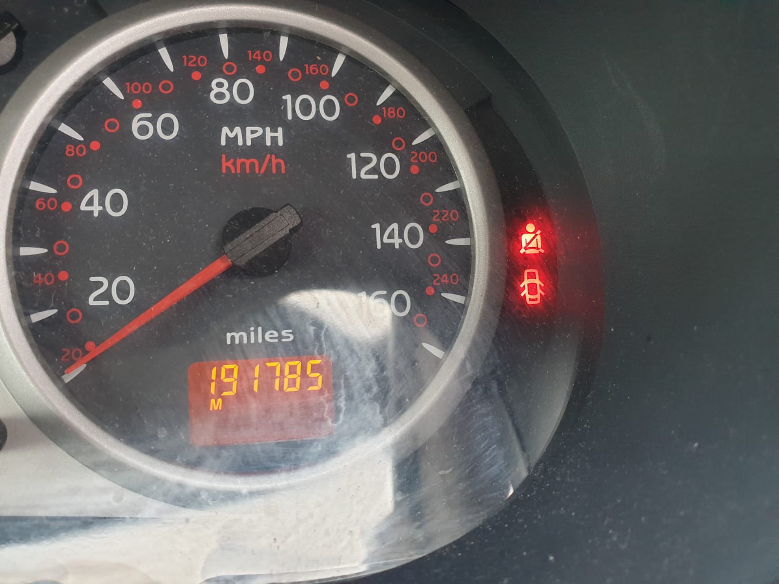

As above, comp test it and if that's okay just keep topping up. Mines just starting to use half a litre or so between oil/filter services now which I do every 6k. 192k on original engine though so think it's entitled to drink a little now!lol!
Is that 192k miles

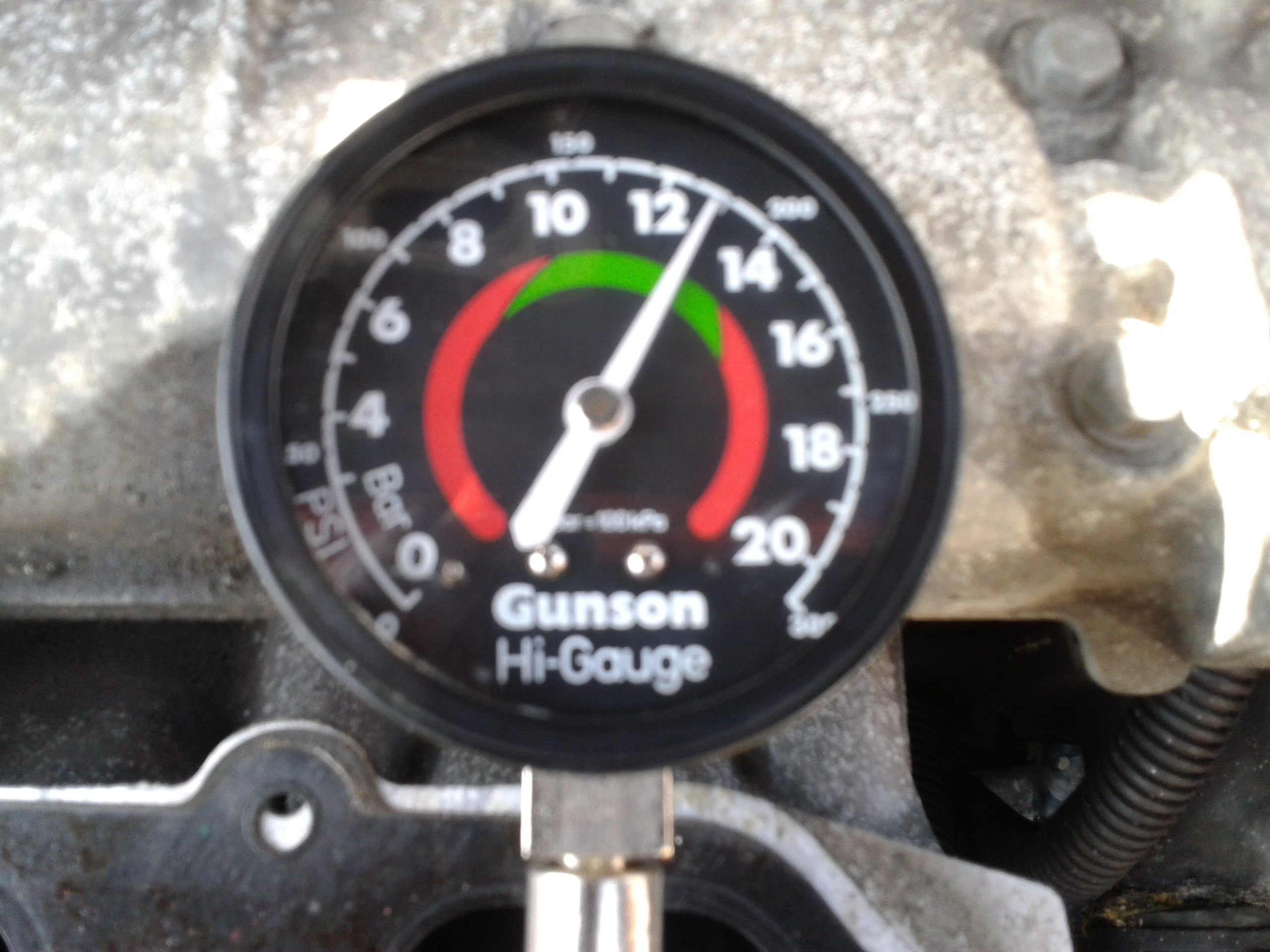

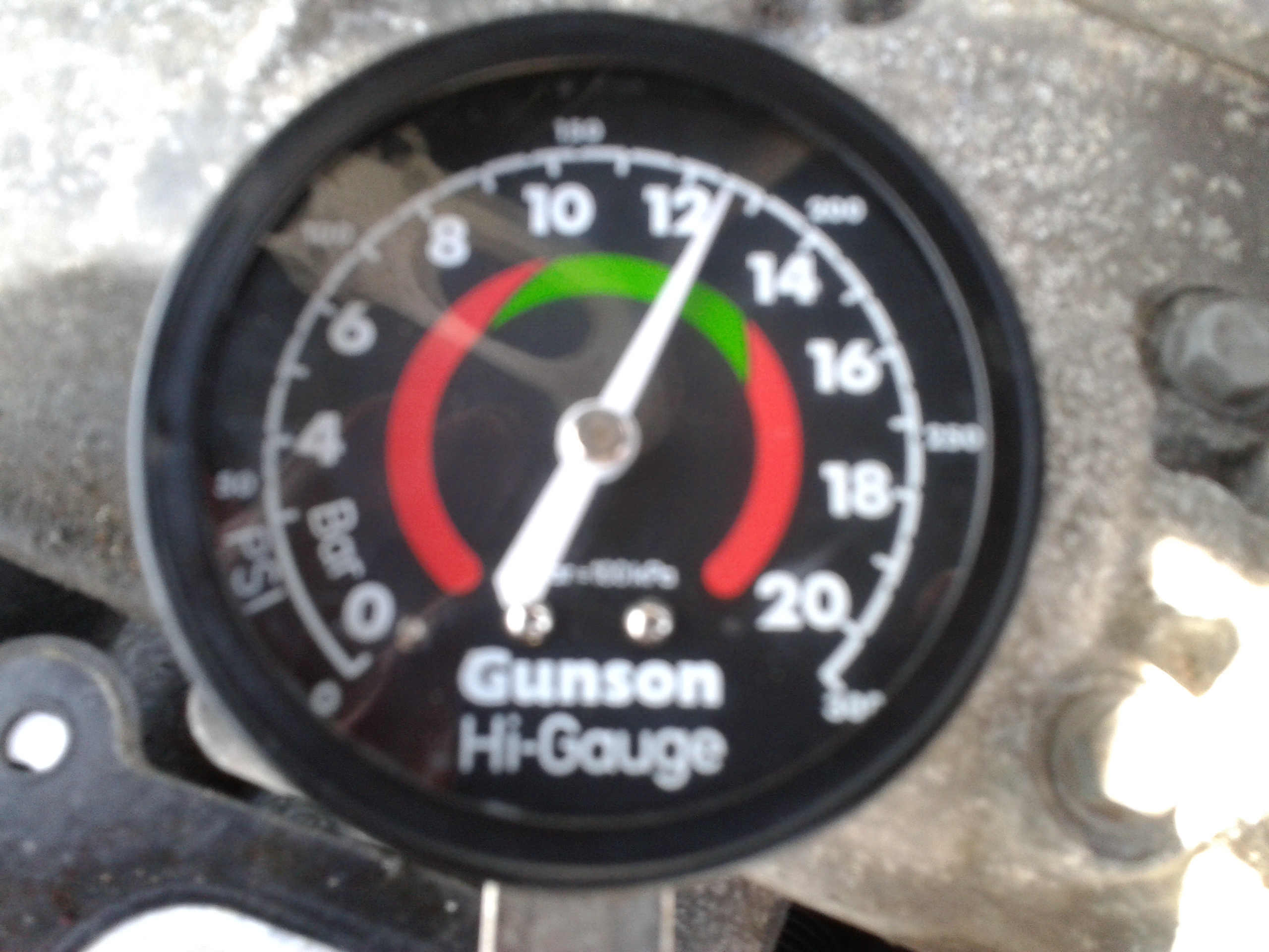

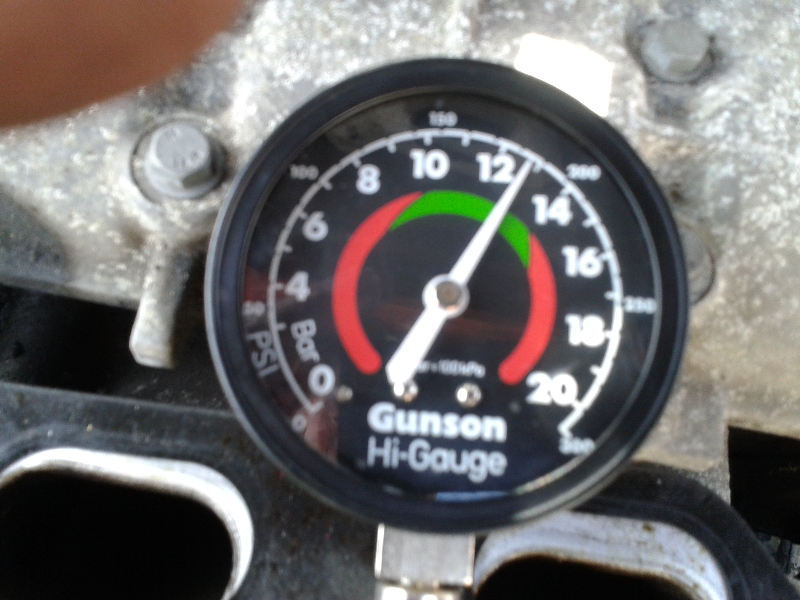

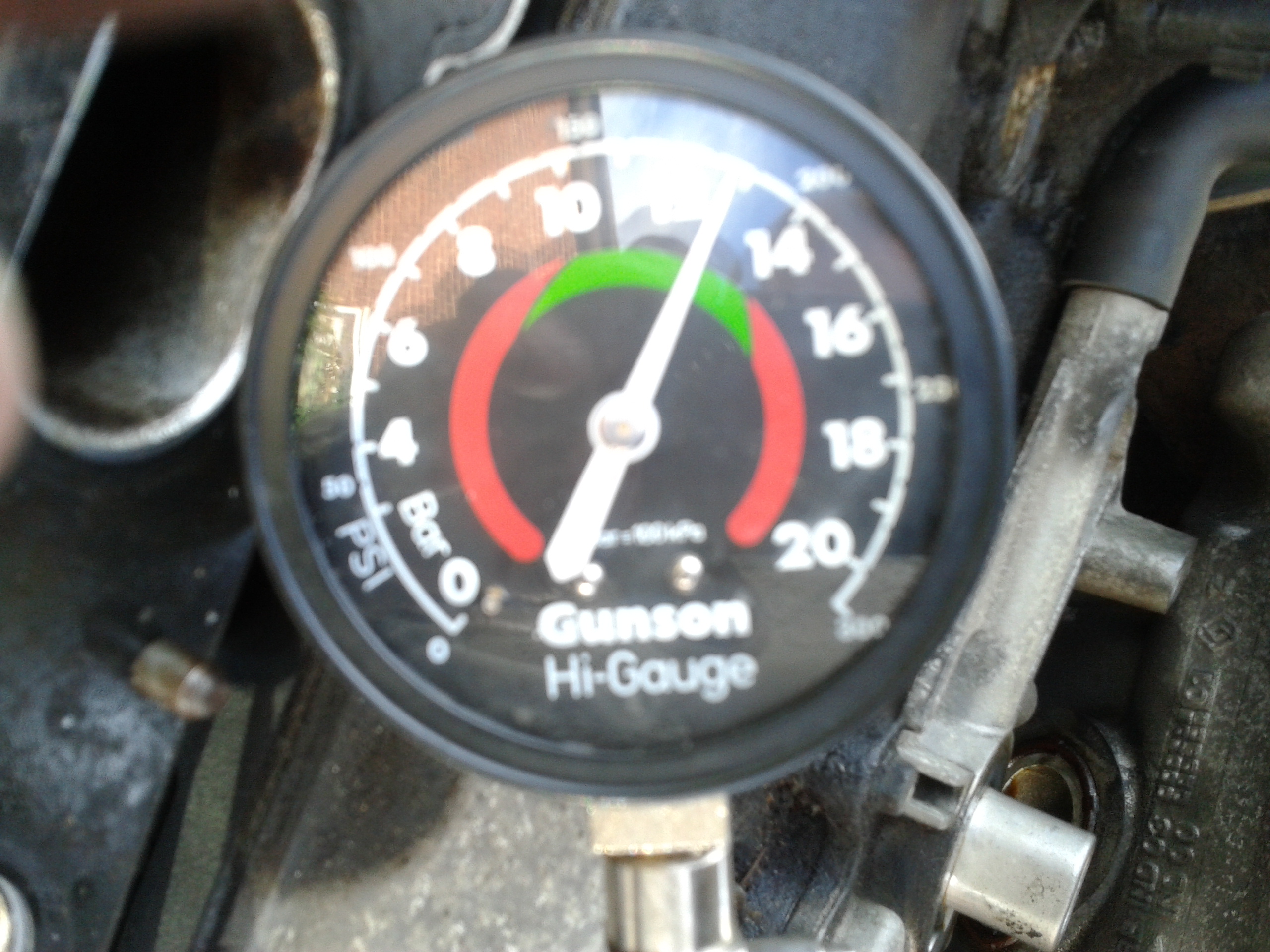

Something like this.
Not bad for 130k miles. 18-09-09 CYL 1 compression.jpg18-09-09 CYL 2 compression.jpg18-09-09 CYL 3 compression.jpg18-09-09 CYL 4 compression.jpg
