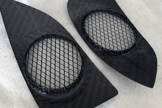

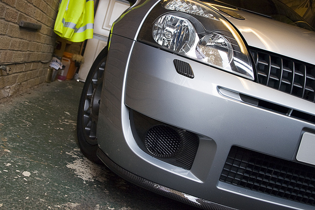

The mesh over the brake ducts is a good idea. I'm scared in case I get a bird ora squirrel down mine. :eek:
How did you get it to stay in place?
Really is a fine example of a cup! Credit to you mate.
They're bonded into place. :)
You can just about see the adhesive on this photo of the reverse of them.
Very neat!
I have the ducting bonded onto my covers so might not be as straight forward. I'll need to have a think about it.
I was trying to prevent ripping apart what I had already bonded but might come to that.
I'll see if I can do it from the outside without making it look sh*t.

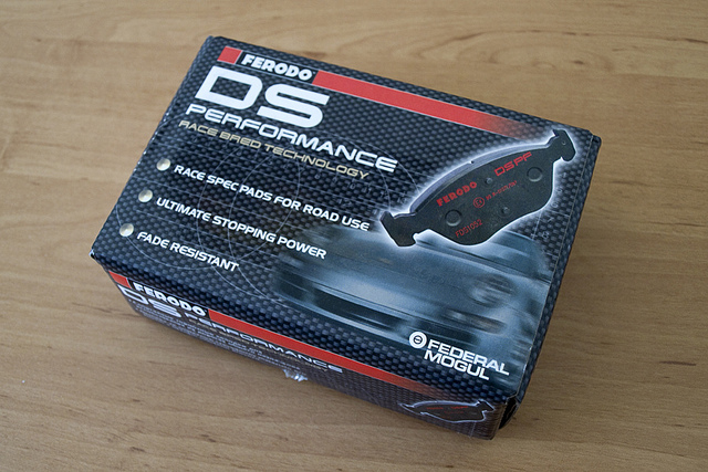

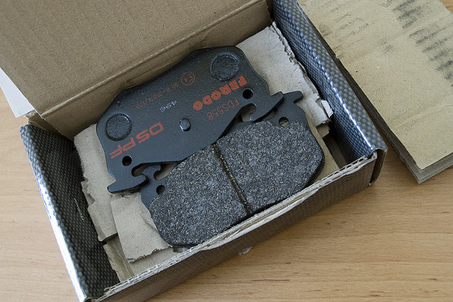

Ordered some Ferodo DS pads for the rear. Went for the DS Performance, as opposed to the DS2500 I have on the front.
Nicely priced at under £50.
Hopefully they'll arrive before the weekend, so I can get them on! :)

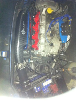

Did it myself on Tuesday and Wednesday night, around 5 hours altogether. Not bad really considering I haven't done anything like that before!!!
That's a crap photo though!! I bought some gunk tonight in halfords, and ordered a wire dremel set which fits on a drill so I can clean the rocker cover and paint it red, prob do the throttle body as well. Booked in for mapping end of the month, TBH it goes well now!! Did you notice a big difference after mapping?

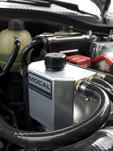

Silly question I am sure... With the catch tank, one pipe comes from back of engine to allow oil to flow in... Where does the other pipe go?
The one on the right of that picture is just a breather pipe that originally comes with the RS2, As the mocal catch tank dosent come with a blocker I believe Ollie popped the breather pipe there instead. You dont necessarily need one as the cap on the mocal catch tank is breathable I believe.
Re: Ollie's Silver Cup - JMS RS2/428s/Wilwood/2118
So it's really just a vent outlet?
Ideally it needs to be blocked (to my knowledge). But sticking that RS2 breather pipe will do the job until you can source a blocker. Ive got the mocal catch tank ready to go on as well, just need to source someone who will sell the piping for me
definitely dont block it!! it need to be vented!! If it's blocked you will create a large enough crank case pressure to blow out oil seals
On the Mocal tank, it is a breathable cap.
I didn't have a blanking plug for the second inlet. It doesn't hurt to have the breather filter coming from there. (especially given what Danny's just said!) :)
True!! Where did you get the extra piece of pipe from the breather to the tank Ollie? I need one from somewhere
I can't remember the name of the place I got it from off the top of my head, but I'll dig the receipt out. It was something like AT or APT.
You could choose whatever diameter and length you wanted; really cheap too. :)
Thanks m8, I'll have a look on google
