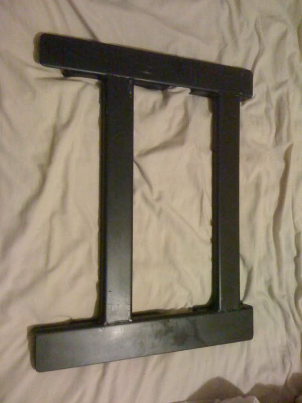

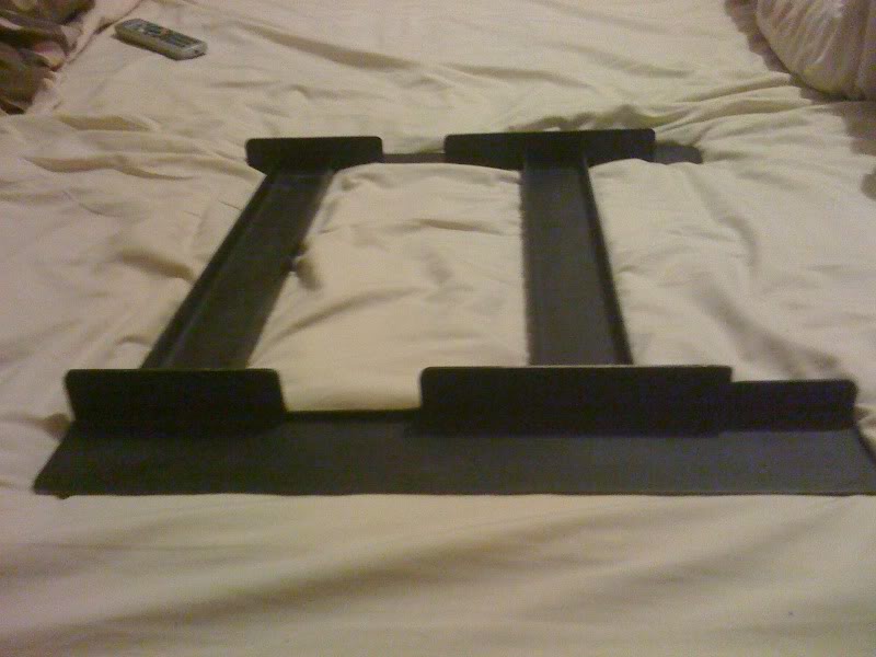

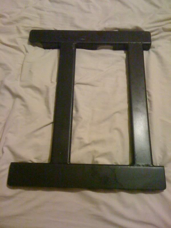

A few iPhone images.. The camera's really do suck on them!! lol
The frame shown below is the drivers side..

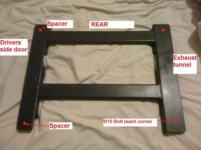

I also machined two alloy spacers to go on each corner of the door side frame (Not shown above)..
As there is a 60mm step down from the exhaust tunnel side to door side, this keeps the frame one level surface rather than having a step down with the cross members.
